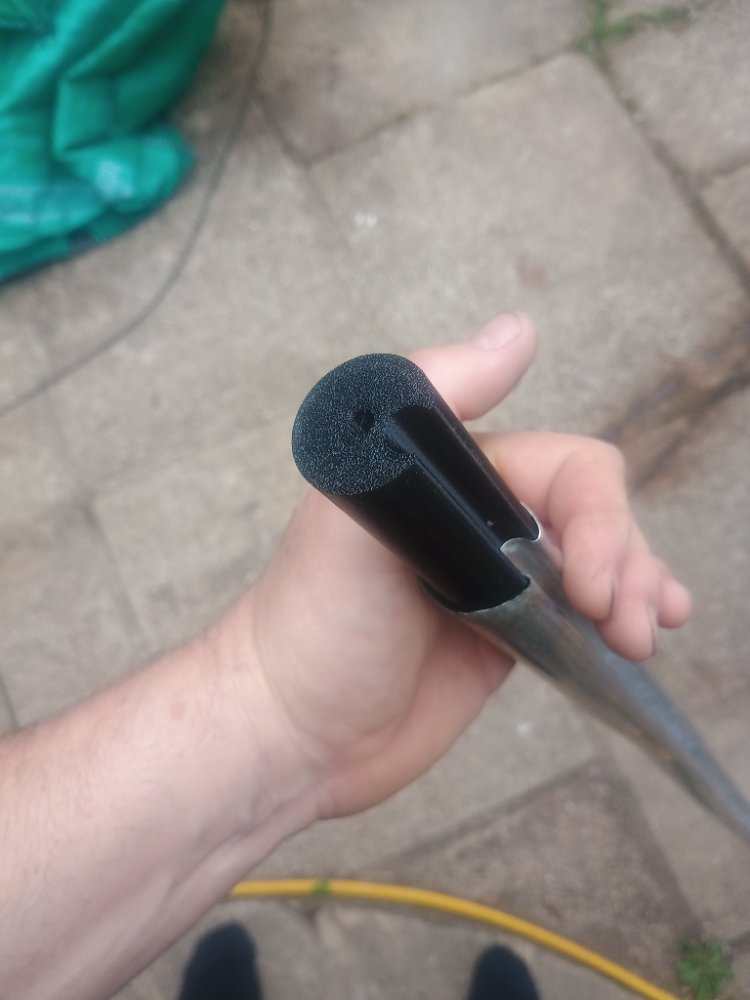

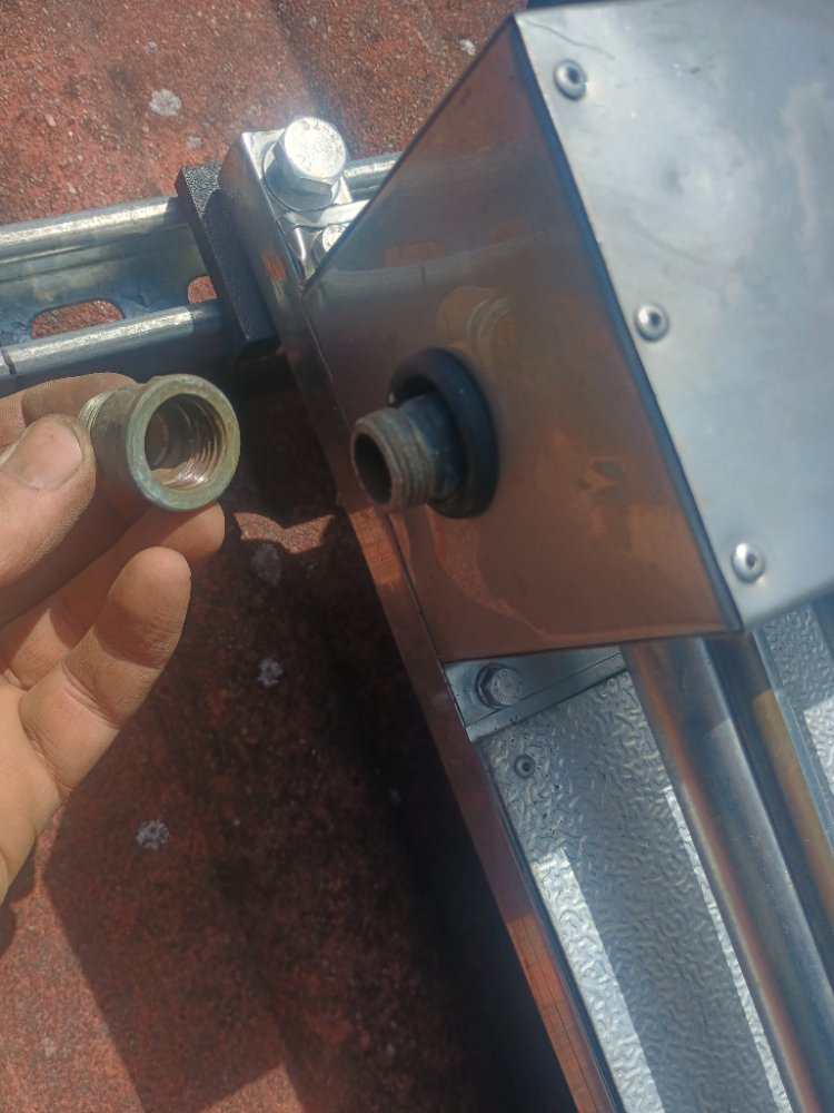

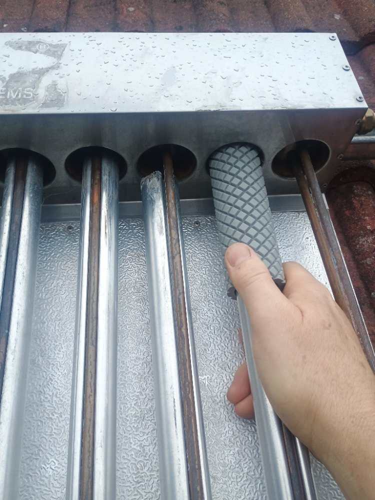

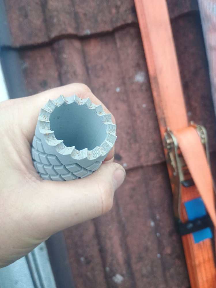

Waiting for my AliExpress solar shade "blankets" before I put the two tubed panels up. As for the pipes to connect the panels together I'm not sure 🤔 I've bought some Chinesium, corrugated solar pipes but don't know if they're man enough. The white "top hat" insert seems to be some sort of silicone rubber maybe? People elsewhere have suggested just using 15mm copper instead of the corrugated tubes?

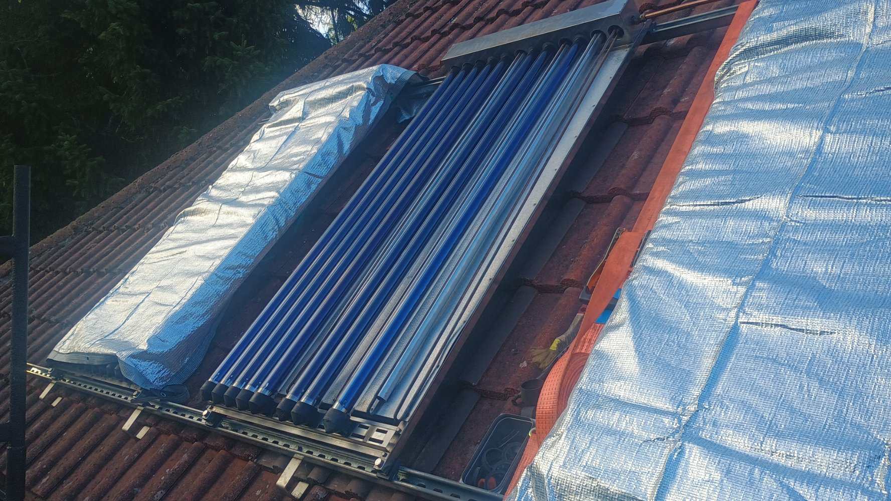

I'm guessing nobody usually does this but I'm intending "shading" the installed 3 panels temporarily when done with a "99%" solar reflective blanket(s). Probably secured with bungee cords. This so the unfilled panels don't overheat. The idea being I can finish the roof side pretty much, have all the tubes up there, fitted and safely out of the way. Then concentrate on inside the loft which is another mission. I'll fill the system later on.

Decided I definitely want to get a proper ladder between the panels and at each end. Meant extending the unistrut by 880 mm. Of course now the end overhang looks a bit silly so I'm debating adding another bracket at each end
