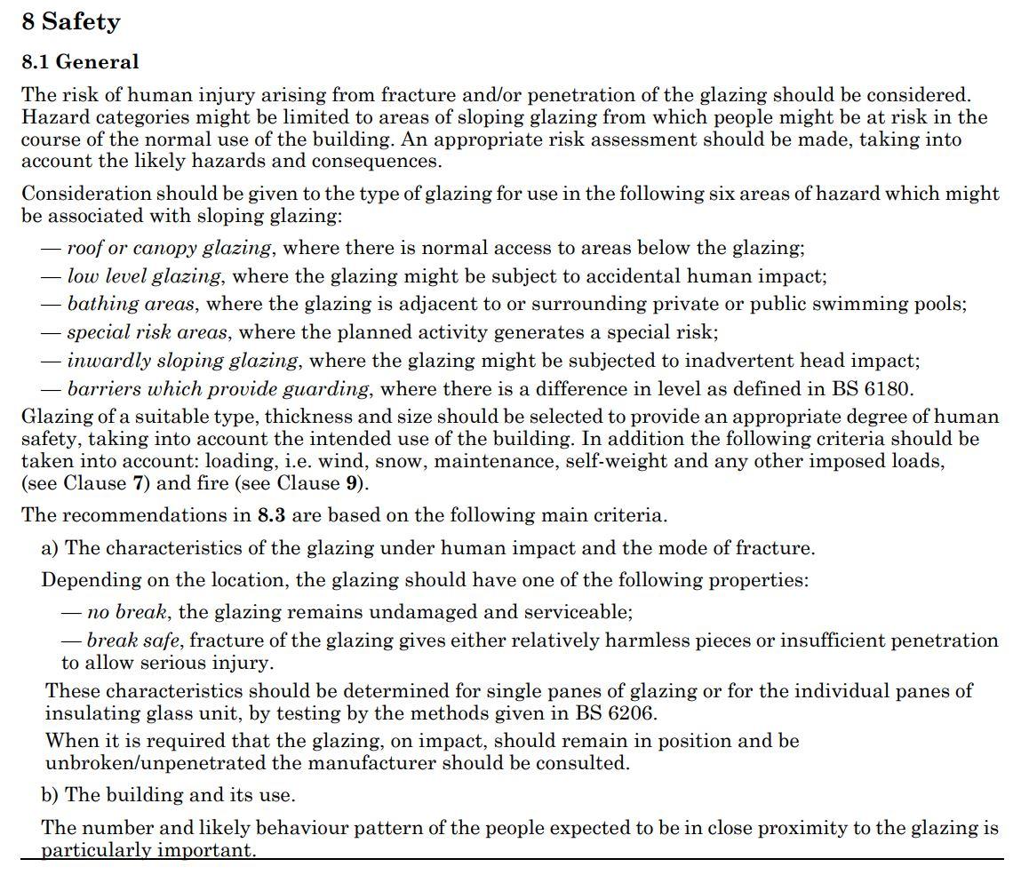

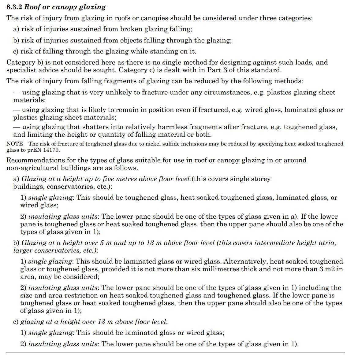

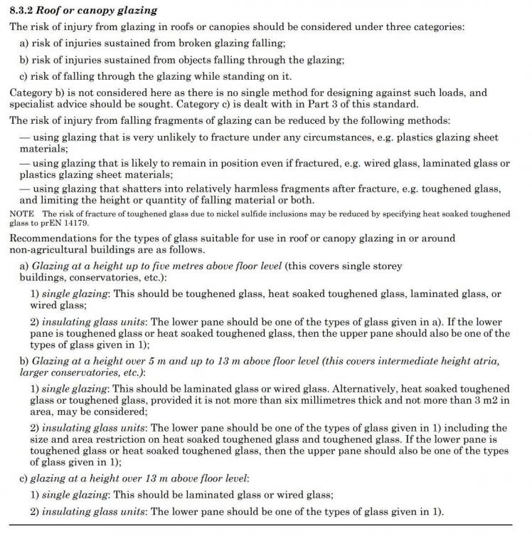

Paranoid about spontaneous failure of large skylight
Ian replied to hendriQ's topic in Skylights & Roof Windows
Yes, you're correct. Commercial projects almost always carry higher risks than domestic so it will depend on your attitude to risk whether or not you wish to exceed the minimum requirements of the Building Regs. The relevant guidance is in BS 5516-2 and it takes a risk based approach. Below are some extracts relevant to your build:- 49 replies
