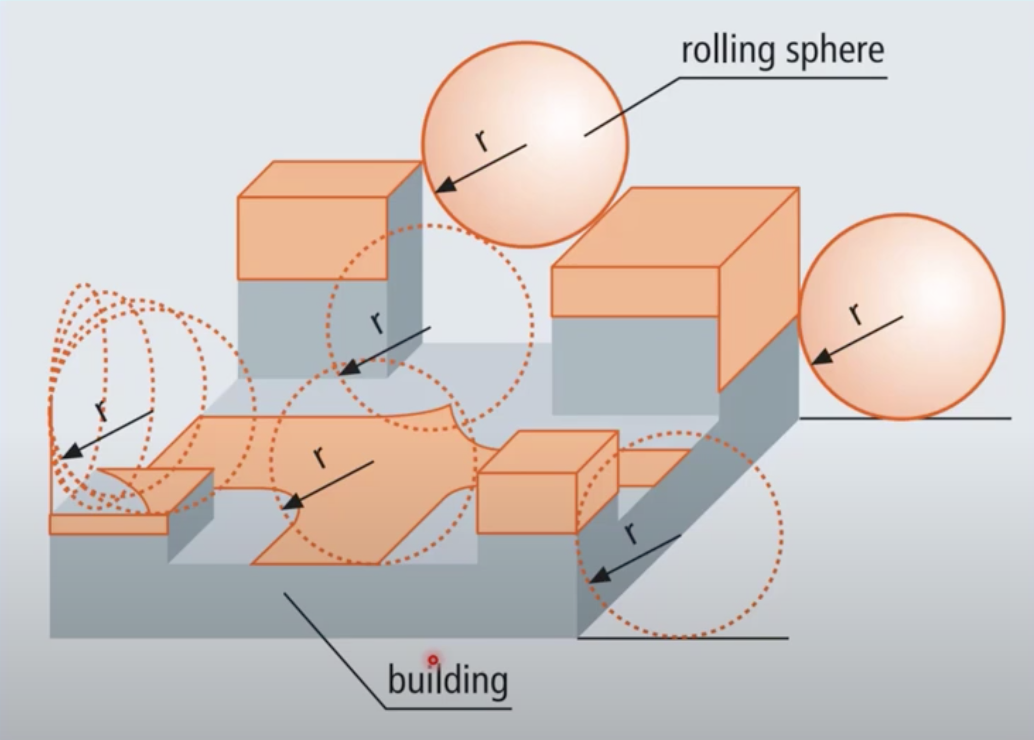

  5. Ah, I badly misunderstood the principle - it's called rolling sphere, and the important part is that it's not just 50m between houses, but if you imagine a ball of paint of 50m would it be able to paint any part of your house. The problem is that from this system, it seems to me every house known to man probably needs some protection unless you're the house from 'up' Trying to understand a bit more...
  6. Actually, the closest higher point than my house is 47m away from my house. I guess I can barely scrape by with that.

  8. Coming to the same question - does anyone know some 'rules of thumb' around what constitutes good cover for your house? My house is arguably sliiightly higher than the closest other houses, but there's a 4 storey flat about 100m away with a big honking tv antenna on top. Am I good?

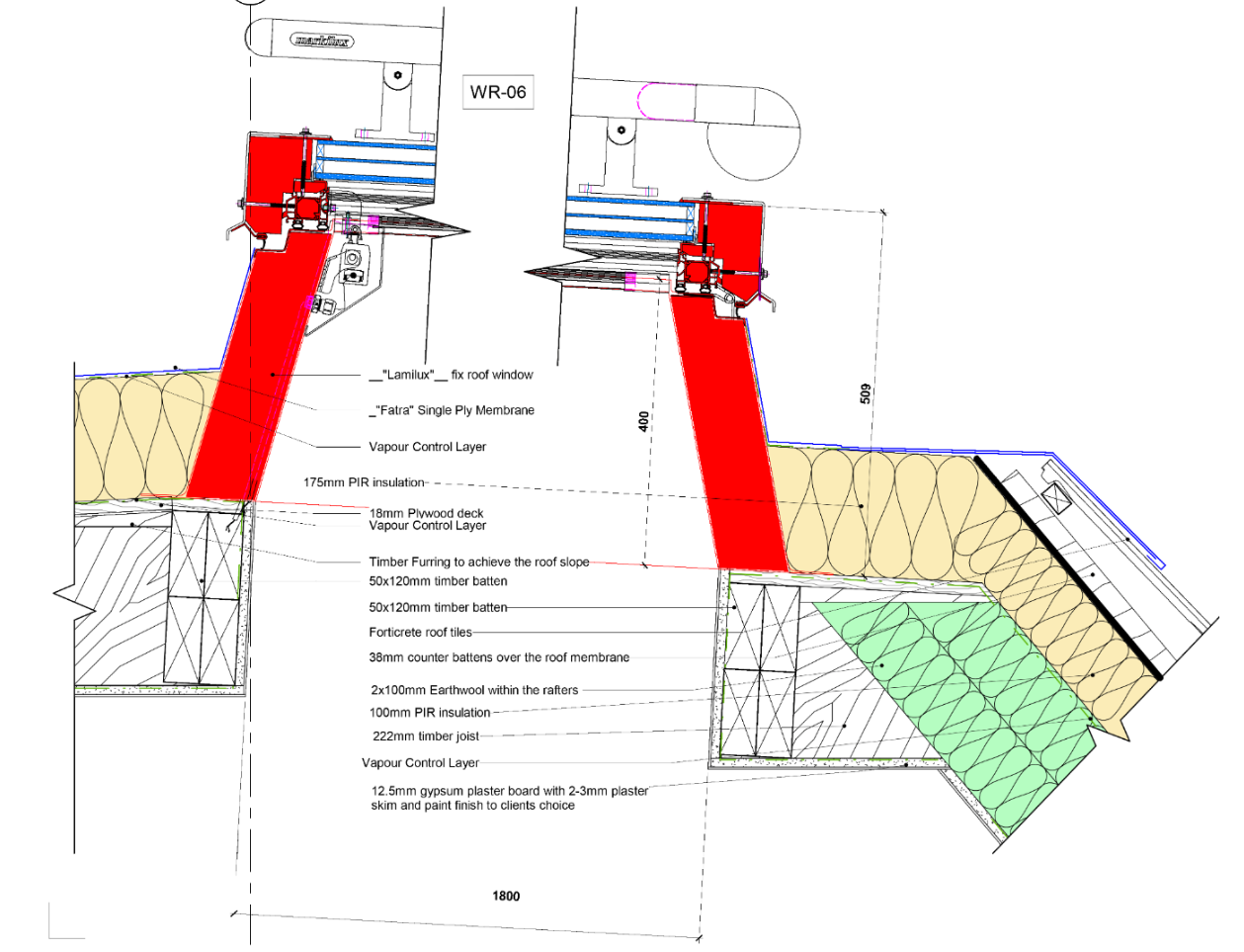

  9. The question sounds almost obvious but my solar guy said the GSE is interlocking to ensure watertightness. Sounds sensible by itself but does a roof (the 'top layer' of course) need to be fully watertight? Or do you think you managed to keep watertightness without using GSEs the way they are intended?
  10. Somehow the builder thinks the GSE thinks *have* to 100% click together and I imagine in your case that's not the case? Or is there some 'clicking correctly' happening but you had to somehow trim a few edges?

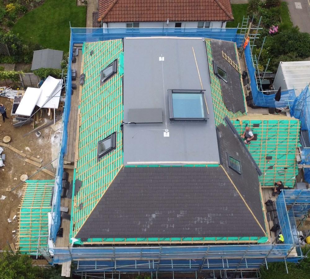

  11. If you take a look at my current roof: I'm sure most of you will agree there's theoretically enough space to the left of the left window. However, I'm told that GSE flashings connect together in such a way that you can't 'stagger' them. Can anyone confirm or deny that one? Does the 'top' panel have to be straight under the bottom panel? And if it is possible, maybe some description I can take to the builder

  17. So, a big honking white thing, in a green place (aka garden) is not ideal. Putting a tarpaulin over it- also not ideal. Does anyone know if a Mitsubishi Ecodan comes apart fairly easily so a painter can just strip the white bits and spray paint them? Or will I be left with a few pieces that are anchored to the device in such a way you can never safely spraypaint without hitting sensitive bits with your paint?
  18. Reviving an old one but here's a thought: A conditioner temporarily prevents the scale from sticking to things. I believe it crystalizes it somewhat. If this water is exposed to open air it will start to scale thigns up again. -> Any water that gets swirled around in open air (kettles, dishwashers, drinking glasses, showers etc) will scale-ify your things. A softener permanently de-scales your water, but in exchange makes it more salty, which might be a negative taste-wise, and I heard (anyone confirm?) that salty water might also affect devices negatively. It's certainly true that oceanwater is much more harmful to 'humanmade things' - boats, houses than eg rainwater. So, would it perhaps make sense to do both? - Shower: softened - Dishwasher: softened (a compromise) - Kitchen (drinking) tap: conditioned - Washing machine.. Or is there no point in conditioning once you have a softener?
