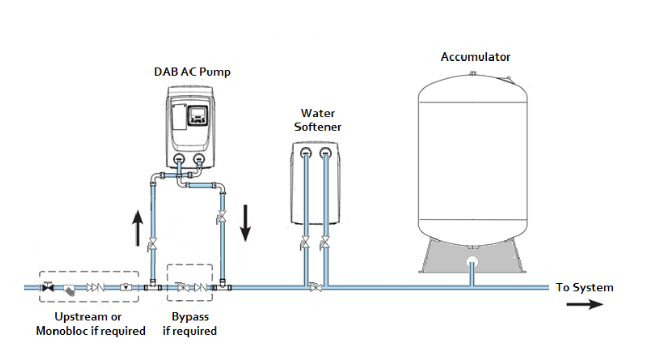

  3. This is my basic setup - my question is: If Mains water pressure falls away - which components (if any) would prevent water flowing from accumulator back into the mains grid? Will the pump prevent this, or is every standard house stop cock built to prevent this flowback? Putting the question slightly differently - if mains pressure drops to zero, how much water can I get from my accumulator before my house water also stops? (the acc is 200L in my case) Maybe the answers are obvious (200L!) but I find often there are sneaky things that change the answer dramatically
  4. One thing I was thinking of is asking to install a one-way valve on these outputs? Would that solve some/most of this issue?
  5. Well my current setup has made it visible, and it .. visibly overflowed.. once already. (due to pipe not dropping steep enough, fixed that now) Are there official "separators" in plumbing? Types of one-way valves that will make sure that water can 'never' go up the wrong way? This is a super newbie question but I imagine that just demanding to put 2 of those in the two lines of the softener will address most concerns?

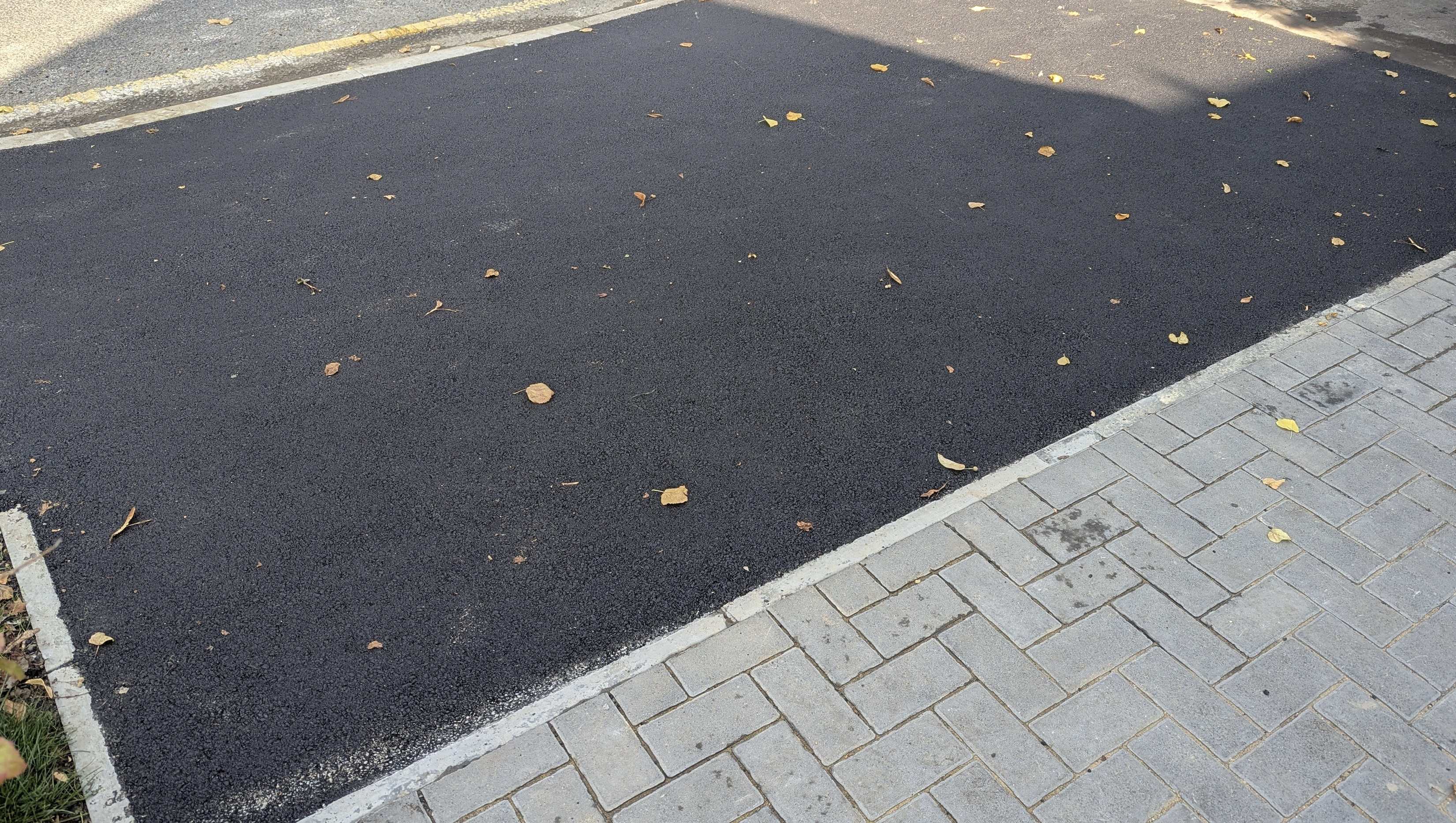

  11. Council builders just came by and finished my driveway (kerb lowering but they redid most of it). But no note left - what guidance do we have for how long this needs to dry/set? 3 days? 5? week? Depends on how rainy? With a previous (poor) job, I had some paving that when you put your foot on it and twisted, you could easily twist loose stuff 1.5-2 weeks later, but maybe that's normal? Suggestions? When can I drive my car over this? (not to mention: people in spikey high heels?)

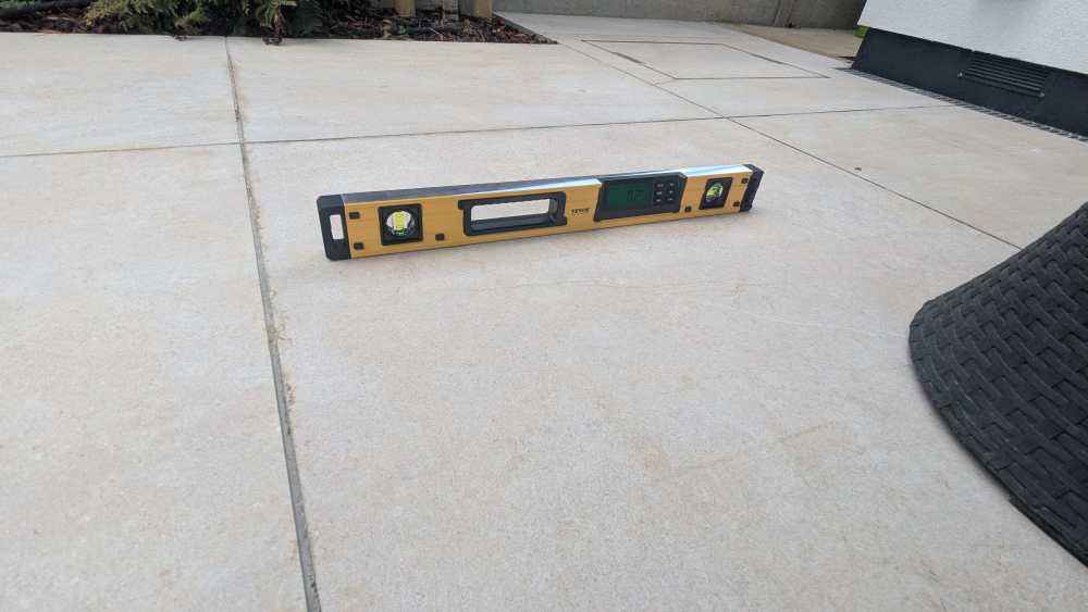

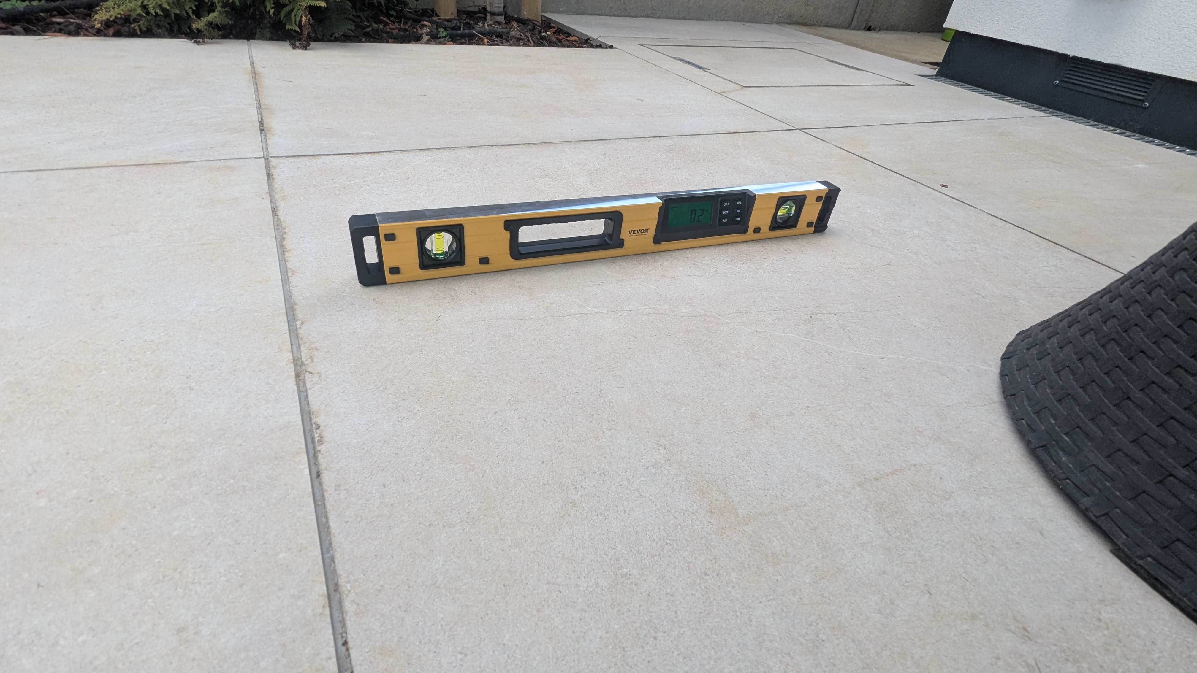

  12. Small followup, while my measurements turned out to be.. uh.. not great (with all the tricks in this discussion I arrived at about 0.5%) - but I bought myself a calibrated level, pretty cheap too from vevor. Reality: - 0.2% (the level is more accurate in degrees mode, this particular tile is 0.10 degree which is about 0.18 % I think it's safe to say this patio is flat. But if I get my builder to re-do the patio (they will be very excited about this).. should I still push for angled towards my french drain, or angled away from the house? I think french drain is probably still the better idea, it catches the water (for my underground rainwater tank) not to mention that the grass is on clay, and not great at absorbing water. Or?

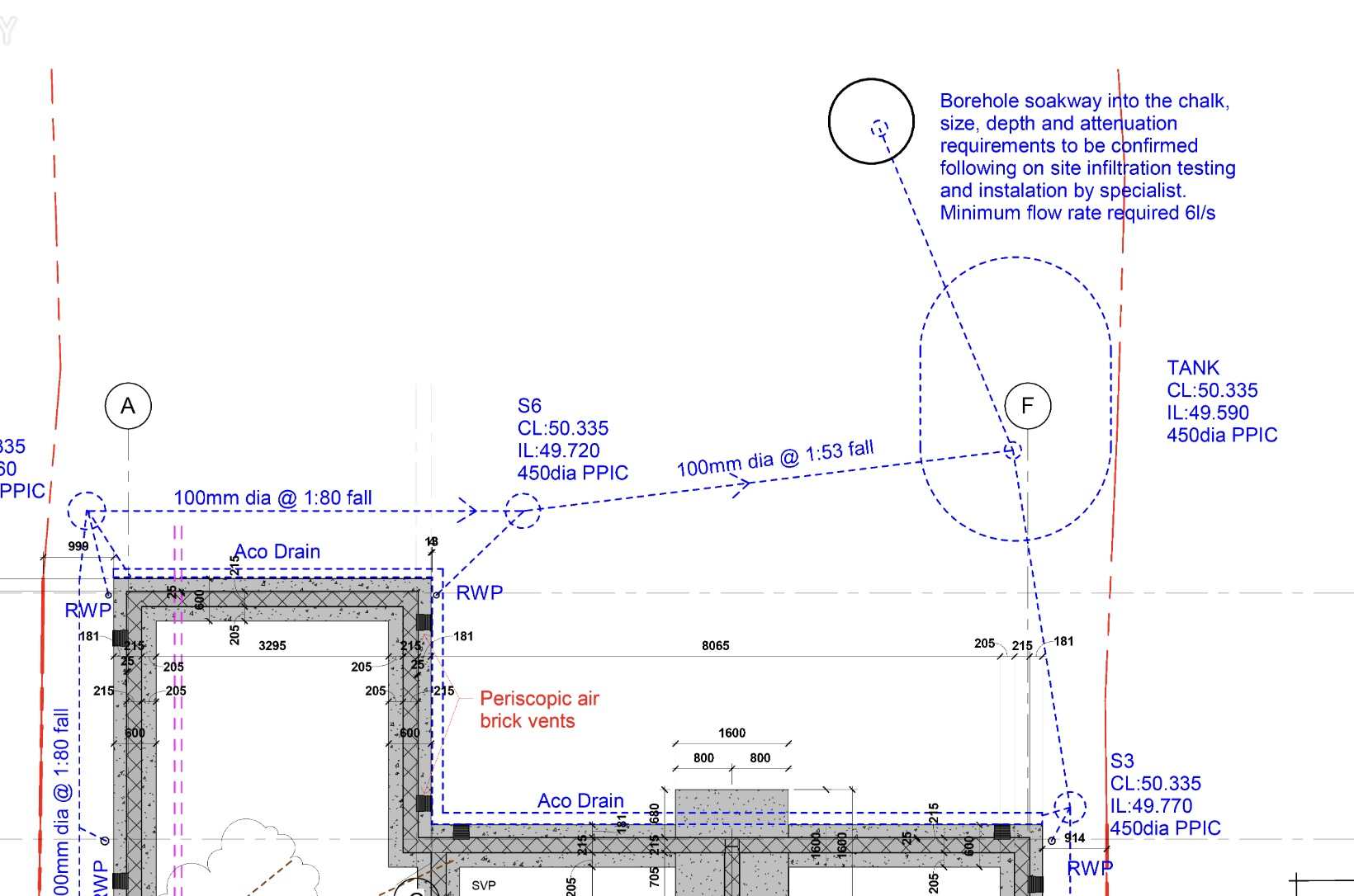

  14. Even when ACO drains are present? I somewhat see the point but I have a full rainwater harvesting system (big tank underground etc) so presumably catching all the water I can seems reasonable.
  15. I think you're missing the point that indeed the current paving is effectively flat but was certainly intended to be sloped. Instead, IMO, the paving should have sloped towards the ACO. Or would you disagree?
  16. Well, this would be true if we weren't trying to catch the water in the aco drain?
  17. Yes, this is indeed a concern for me, I'm pretty sure the aco drain (I keep saying french drain, not sure of the difference) goes to the rainwater harvester. Should certainly be careful with 'cleaning liquids'.
  18. Interestingly though, I don't think I've ever seen my french drain be wet at all, even during downpours. This suggests that the direction of the patio fall wouldn't influence this either way Well, I somewhat have the choice, currently the patio is basically flat (to my best guess maybe 1:200 angle away from the house..) so assuming we do something at all, I might get a choice.. but for now an additional issue for me is that the turf and underlying clay right next to the patio really don't want to absorb any water, not to mention I want water to be sent to my harvester tank..
  19. Just reviving this thread one more time to make sure my brain is set out straight. Would you agree that: - If the house has no drains, it's reasonable to angle patio away from the house, to prevent standing water to seep into the foundation - If the house has a full french drain around its perimeter (that goes to rainwater harvester), it's reasonable to angle the patio toward the drain to catch the water? tx
  20. Many sources on the internet (...) eg https://forums.moneysavingexpert.com/discussion/6467233/patio-slope-towards-house seems to claim 1:80 away from the house seems reasonable, but it might be somewhat old knowledge, in particular if people don't have french drains. 1/ You don't want water pooling against the house, so angling away makes sense, but we specifically have french drains to catch water, I can imagine angling toward the house would be logical in my case? 2/ As far as we can tell the patio is essentially flat. Some angled a little one way, some angled a little the other. (strange). 3/ Our grass is a little high 'above' the patio, perhaps the soil of the turf is 0.5-1cm above the level of the patio. It sounds somewhat 'sensible' that this might push water back but on the other hand wouldn't it literally act like a sponge and possibly even suck water in? End of the day, still trying to figure out what's reasonable, my best guess is that "flat" is unacceptable, and the choice of angle towards, or away from the patio both has some pros and cons, but given I have a french drain that's directed to my underground water tank, it would be reasonable to expect it to go into the french drain. Given that (and given the concrete, then clay foundation) it seems like drilling a few holes wouldn't make a big difference. Would re-laying the patio be the only solution?

  23. Just a quick update, I had a garden guy over (not really an 'architect') but to his understanding patios should be angled away from the house and 'into the grass'. Of course with my grass being on top of pretty serious clay he wasn't 100% sure. My contractor says they did a "1:80" slope (which is 1.25 percent) away from the patio, but as far as I can tell at best it's flat. So I am certainly still confused. The patio is porcelain tiles though so it wouldn't be a huge problem with eg weeds/fungus taking hold.
