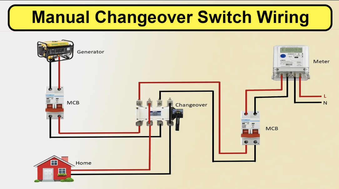

  2. It's not a generator - it's a solar inverter with batteries. But (.. gray area speaking here..) - the principle is the same, the EPS out from the inverter just provides 3-phase 400V, and will start doing so when you push the button, so to speak.
  3. Note I have to have 3 phase, but other than that, sounds good. Do you guys have any wiring diagrams that you used and are happy with?

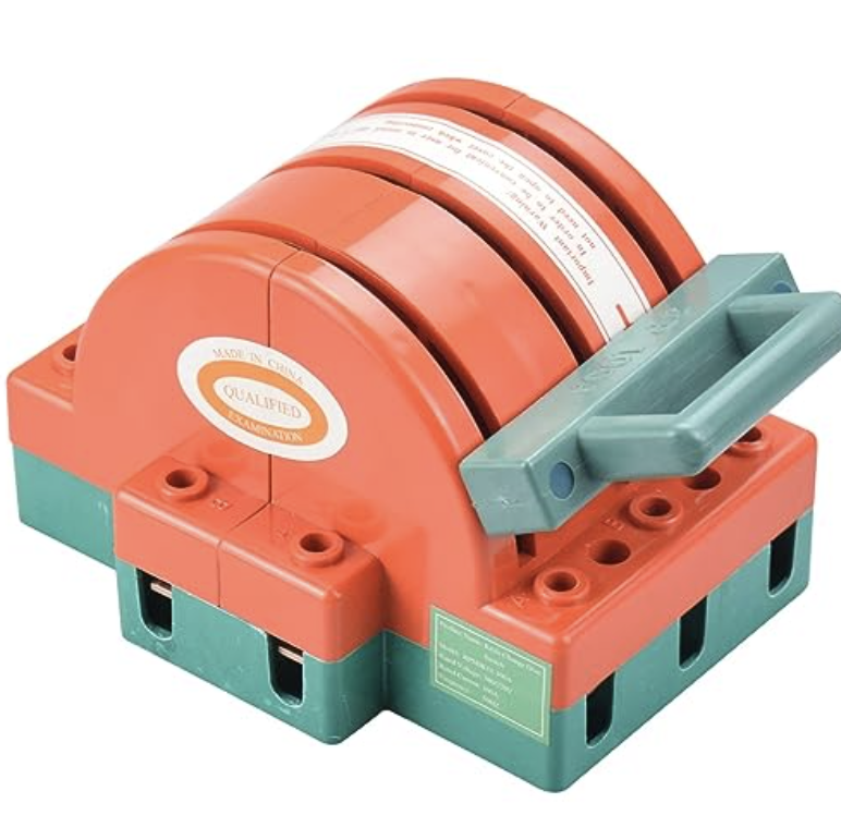

  4. (I debated putting this in the solar forums but none of them really apply here - and this is, I think, equally applicable to e.g. diesel-powered generators) The basic idea of switchover is this: With a switch like this I feel somewhat cool frankenstein (seems like frankenstein also has 3 phase!) but many manuals I find suggest that you make things really clever with a secondary consumer unit and select some special critical loads (fridge, networking maybe etc) to be put on your backup. All well and good, and generators (or solar inverters) have their limits of how much they can provide and/or how long they can provide it for but: 1/ Am I correct that specifying specific eps loads will limit you in what you can run in grid outages. (everything that is not an EPS load can't be powered during outage- TV, kettle, if I'm feeling bold) 2/ Is it true going the EPS load way is very complex - tons of extra cabling with separations etc? 3/ Do I need a separate Earth Stake - if grid is really gone you can't depend on its N and E either, I think? 4/ Is it hard to make this automatic? The most obvious way is to have an Automatic Transfer Switch - which will detect grid and if no grid switch to backup (turning on the backup is another matter, but can perhaps be achieved independently..) Anyone have experience with suchlike?

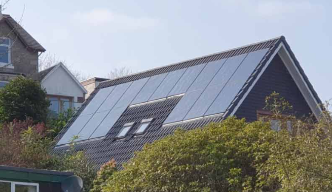

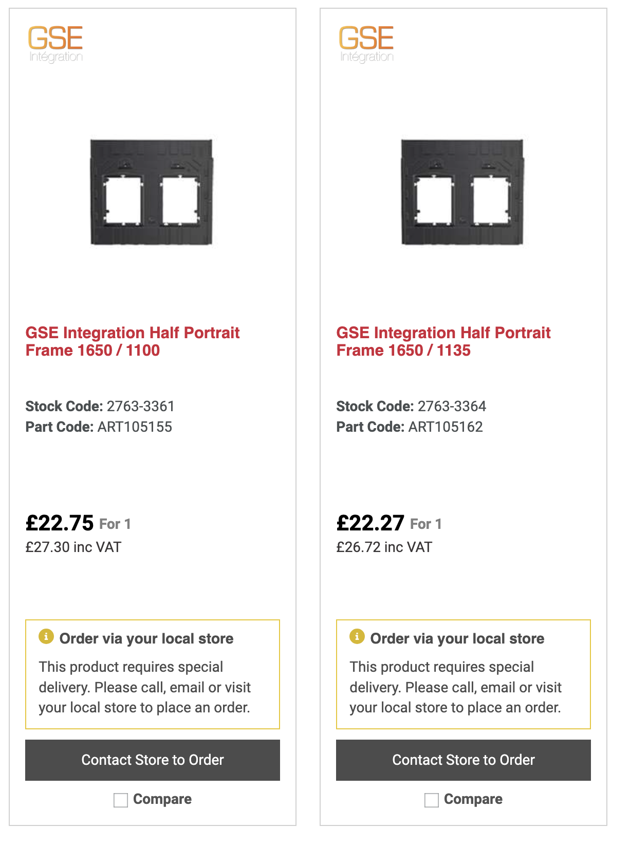

  12. https://www.cef.co.uk/catalogue/products/5178047-half-portrait-frame-1650-1135 22.27 😃 But I still frankly haven't heard a good reason why to do GSE in the first place - what's your take on that discussion? Piece of plastic, nail the panels through it, Bob's your uncle?

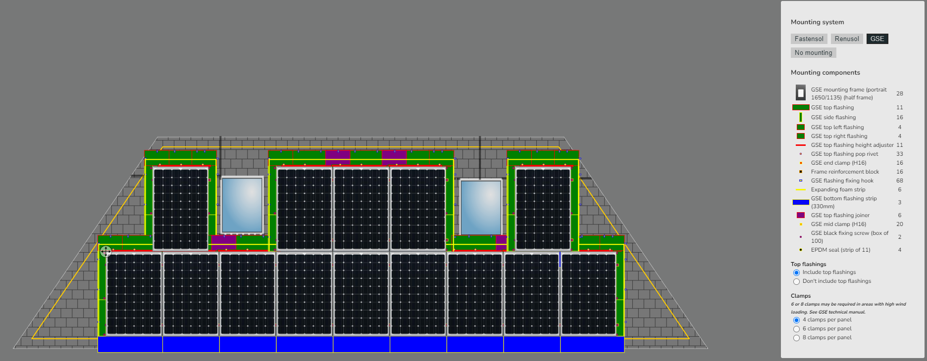

  14. One more update. Here's my final math: Item Brand Model count Power TotalPower Cost exVat Total Total if 32 panel Panel JA JAM54S-30-420-GR-BF 23 420 9660 83 £1,909 £2,656 Inverter Solax X3-HYBRID-G4-12.0 1 12 12 1953 £1,953 £1,953 Battery Pylontech force 14.21 Pylontech force 14.21 1 14.21 14.21 4397 £4,397 £4,397 Mounting kit GSE mounting kit GSE mounting kit 23 £98.00 £2,254 £3,136.00 Subtotal Mat £10,513 £12,142 OH/P £841 £971 Install est 4000 £4,000 £5,565.00 Total ex VAT £15,354 £18,678 Sooo that seems to be half the price of my faithful installers and much better 'side gear' - 14kW battery, 12kW inverter. That's all from https://www.itstechnologies.shop/products/420w-mono-perc-half-cell-mbb-black-frame-gr-mc4-solar-panel - they have all components I need, and that fit together (some inverters only want to work with their own brand battery etc). Might even get a small discount for doing it all together.

  16. So... if you were forced to install a solar array into your roof... would you use GSE at all?

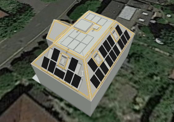

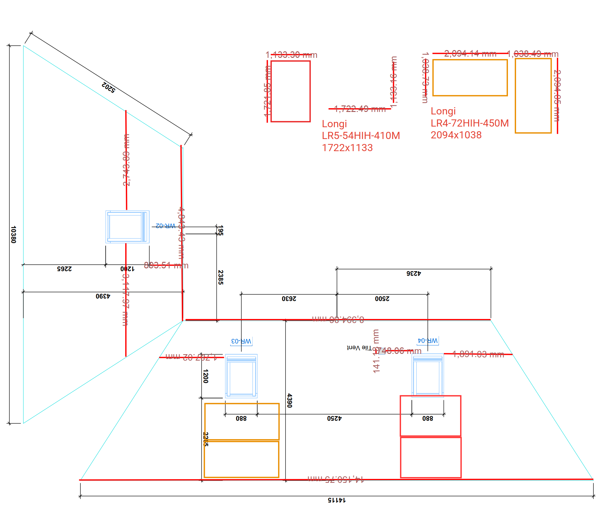

  17. Nothing is obvious for an amateur, I appreciate you taking the time for this! Well, as mentioned the landscape ones are too big, there are no GSE trays for this. (which brings us back to the discussion if one needs GSE at all... Other than some of the guiding lines it actually is symmetrical, no? Here's a bit more tidy version: Here's a real picture that's "curving around a window'.. I'm not sure if it's "ugly" or "okay" but this roof is pretty far off the ground so I'm not sure it'll be too horrible.. And for what it's worth it's pretty similar to a design we got from a professional installer, who is proposing 30,000 for this one. (ignore the panels on the flat roof)

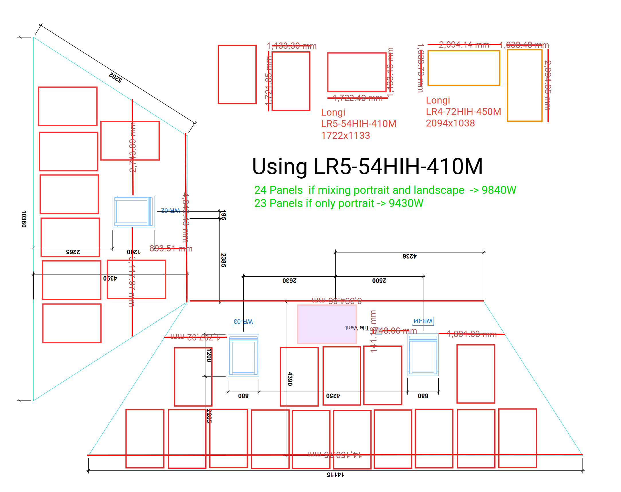

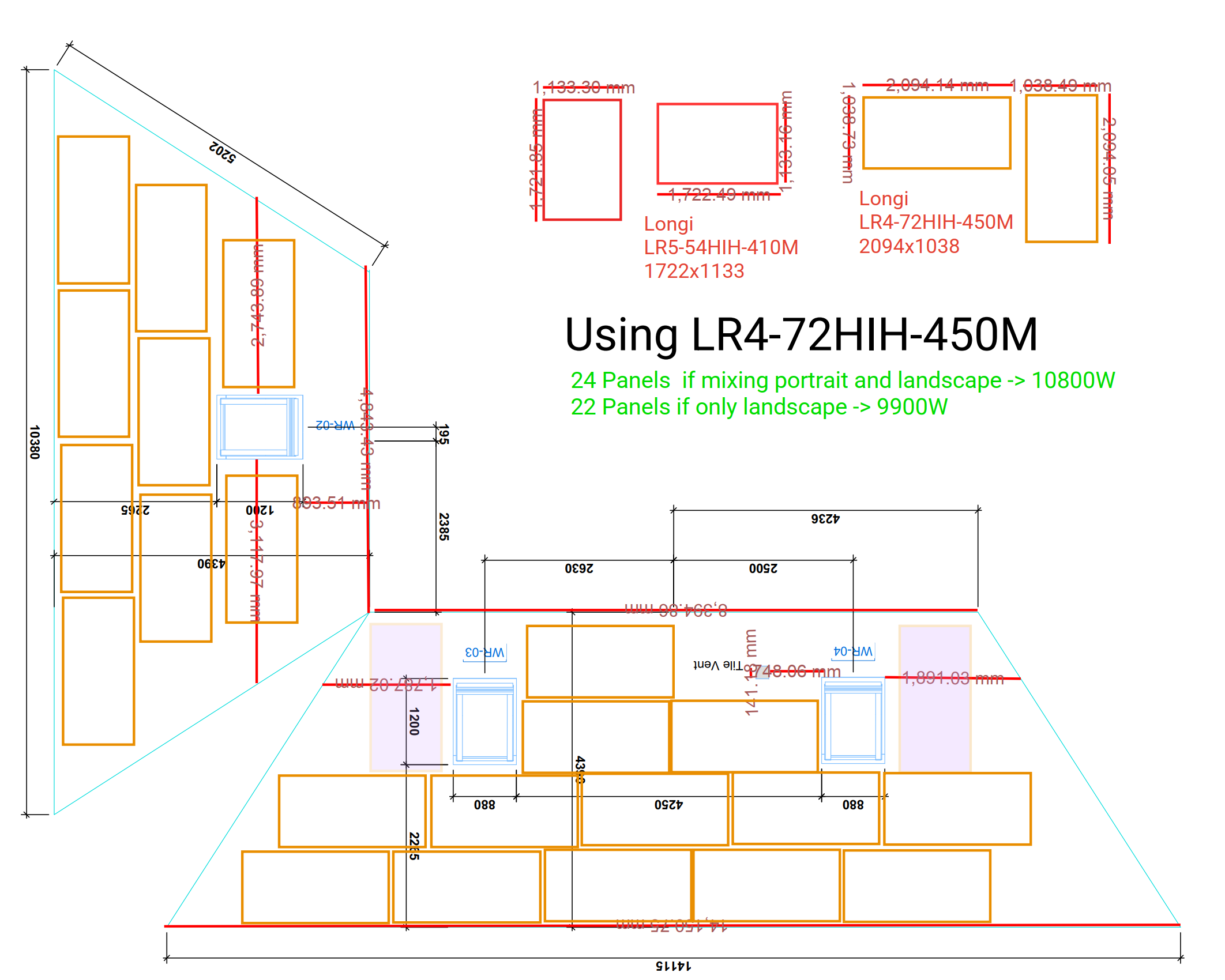

  21. Here's the difference between using the larger panels and the 'standard' panels: Mixing Portrait+Landscape, 450M (Big - 2094x1038): 10800W Landscape only, 450M (Big - 2094x1038): 9900W Mixing Portrait+Landscape, 410M (Standard - 1722x1133): 9840W Portrait Only 410M (Standard - 1722x1133): 9430W All in all even the 'standard portrait' approach is not terrible, and there are good tolerances around obstructions, windows etc. Perhaps I should just stick to standard portrait...
  22. I think.. you mean lenghtening a tray? Maybe so.. not sure if it's going to be too resistant to the elements? Eh I guess it's plastic.. but it sounds like a huge hassle. Of course, but in my particular case Here is one of the reasons: the "standard" sized longi (red) is very tight, probably impossible to fit under the window in my roof since it's 1134 wide. The yellow "long" one is 1038 wide. It probably fits (citation needed..). Problem is that at CEF at least, the only trays they have are: 1650x1100 and 1650x1135. Neither match *any* solar panel that CEF has on offer. Or am I missing something? Tradesparky has many more options but still strangely nothing that *exactly* fits to any of the known sizes. Are we by default expected to start cutting these trays to size? I guess the main point of these trays is to protect the roof, with the white bits safely covered by the panel, and the black bits protecting the roof?
  23. After my math-doing in this topic: I agree it's not worth it. I was under the impression that better performance panels already exist in Asia, and it seems that it's simply not true, there are just different sizes, and _perhaps_ slightly better prices if everything turns out amazingly but it indeed doesn't seem to be worth the hassle at all. My main concern right now is designing panels that fit optimally in a roof.. I think I am close to a good solution but it's still pretty difficult to figure out. For example - I think this panel - the longi 450 might fit very nicely on my roof in landscape mode, but I can't find confirmation that there are GSE trays that will match this size.
