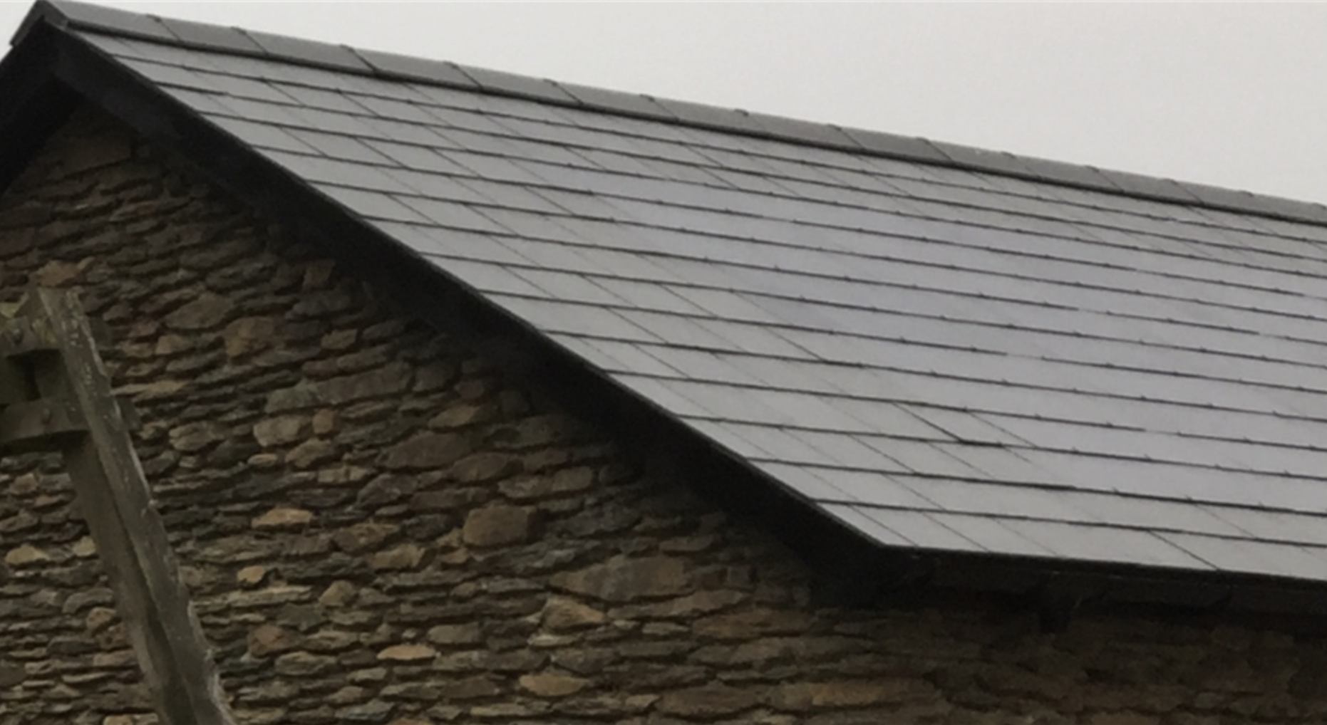

  14. I just realise there is one important extra option I failed to consider. https://www.gb-sol.co.uk/products/pvslates/default.htm - solar slate tiles A very important fact about these is that it sounds less fraught to get these right, since you can treat them as normal tiles, no weirdness around flashing, trays etc etc, so safer to DIY? To my math, - the SE (main) roof is 48.1 m2 - GB-Sol says one 'unit' replaces four 500x250 slates, covering an area of 0.2sqm - Therefore we'd need 240 units, at GBP59.50 each, 28W each - Roof's power would be 6720W, materially higher than what I managed with panels (5100, maybe) - The SW (side) roof I make about 33m2 -> 165 tiles -> 4620W Total roof = 11340, price 24097 GBP. 11.3kW is much more than anyone else could fit on this except a company that I think made a mistake in their quote. There's other solar tile companies out there too - one Rest of components (from midsummer) Qty Item Unit Line 1 SolaX X3 G4 12.0kW hybrid inverter £2450.00 £2450.00 1 Emlite EMP1 Three Phase meter £116.90 £116.90 1 Label sheet £2.52 £2.52 2 AC isolator - Projoy 20A 4-pole £8.40 £16.80 1 SolaX Triple 5.8kWh LFP Battery (Master Console) £2702.00 £2702.00 1 SolaX Triple 5.8kWh LFP Battery (Slave Console) £2226.00 £2226.00 22 Tigo Retrofit Frame Mounted Optimiser TS4-A-O £53.20 £1170.40 4 Pair of MC4 connectors £2.80 £11.20 1 50m reel of 4mm2 solar cable £42.00 £42.00 Total (ex VAT and delivery) £8737.82 This ends up at 32834 GBP ex delivery ex VAT ex install, so certainly pricy, but I care mainly about "per kwh installed" which is lower than contract and artisan. Of course it does drive the total price up, but I could consider doing just the big (SE) roof, get 7KW, and use the remaining forticrete tiles on the SW roof. Here's my pricing spreadsheet - I've anonimised the company names (Orange = estimate) company (panel) price ex ohp install (if not inc) # panels power total kwh battery kwh battery price/kwh panel price/kwh notes A (Canadian) £22,769.00 21 430 9.03 10 500 £1,967.77 - dubious if 21 can fit B (JA Solar) £24,514.00 16 370 5.92 10.64 608 £3,048.12 - pricy per kwh Easy PV (Eurener) £16,210.00 £2,000.00 26 340 8.84 11.6 500 £1,403.85 - small panels 1x1.6 - requires verification (minor flashing clash) C (Solaredge) £31,738.00 21 405 8.505 13.8 500 £2,920.40 - premium brand GB-Sol Tiles £32,834.00 £2,000.00 405 28 11.34 11.6 500 £2,560.32 - tile system GB-Sol Tile (SE only £23,017.00 £1,500.00 240 28 6.72 11.6 500 £2,785.27 - tile system Of course aesthetics are important: GSE Flashing Solar Tiles

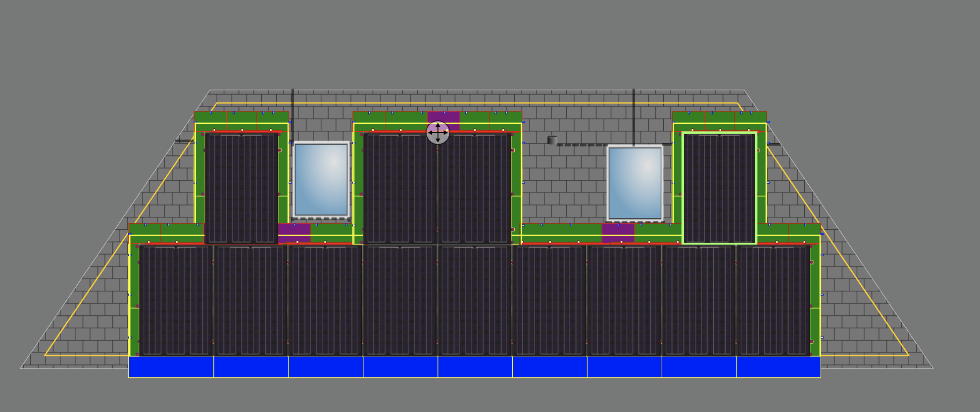

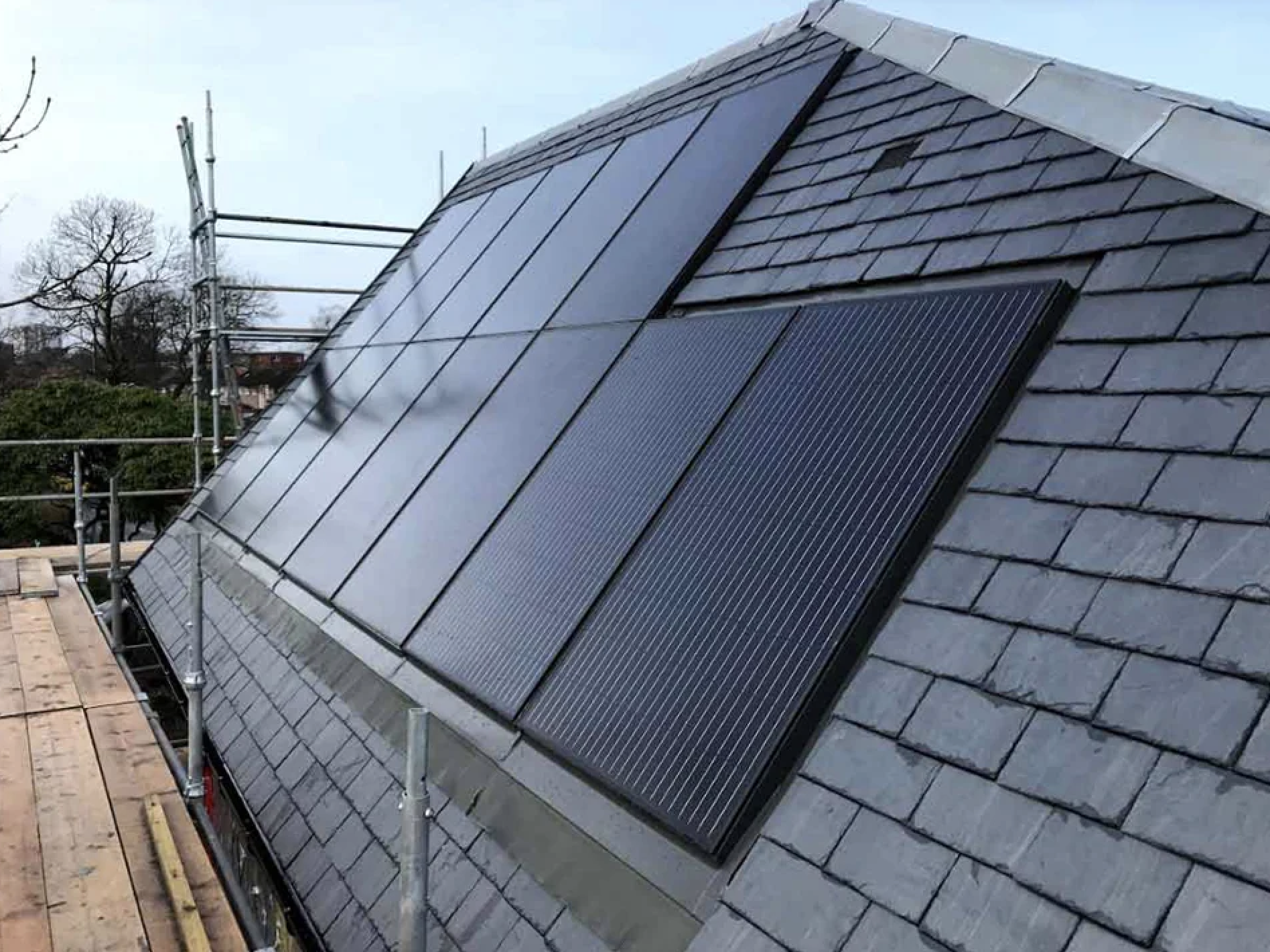

  16. I think that's a good idea, what I'm concerned about is that designing in-roof panels (e.g. GSE) is hard. Meaning, of course putting one 1x1 panel into a 10x10 roof is easy but if you want to fit as many as humanly possible how can you fit the most panels without running into trouble on-site etc. Does anyone have experience with e.g. https://easy-pv.co.uk/ design vs reality? For example the panels fit within the limits, but the flashings overlap the edge, is that ok...?

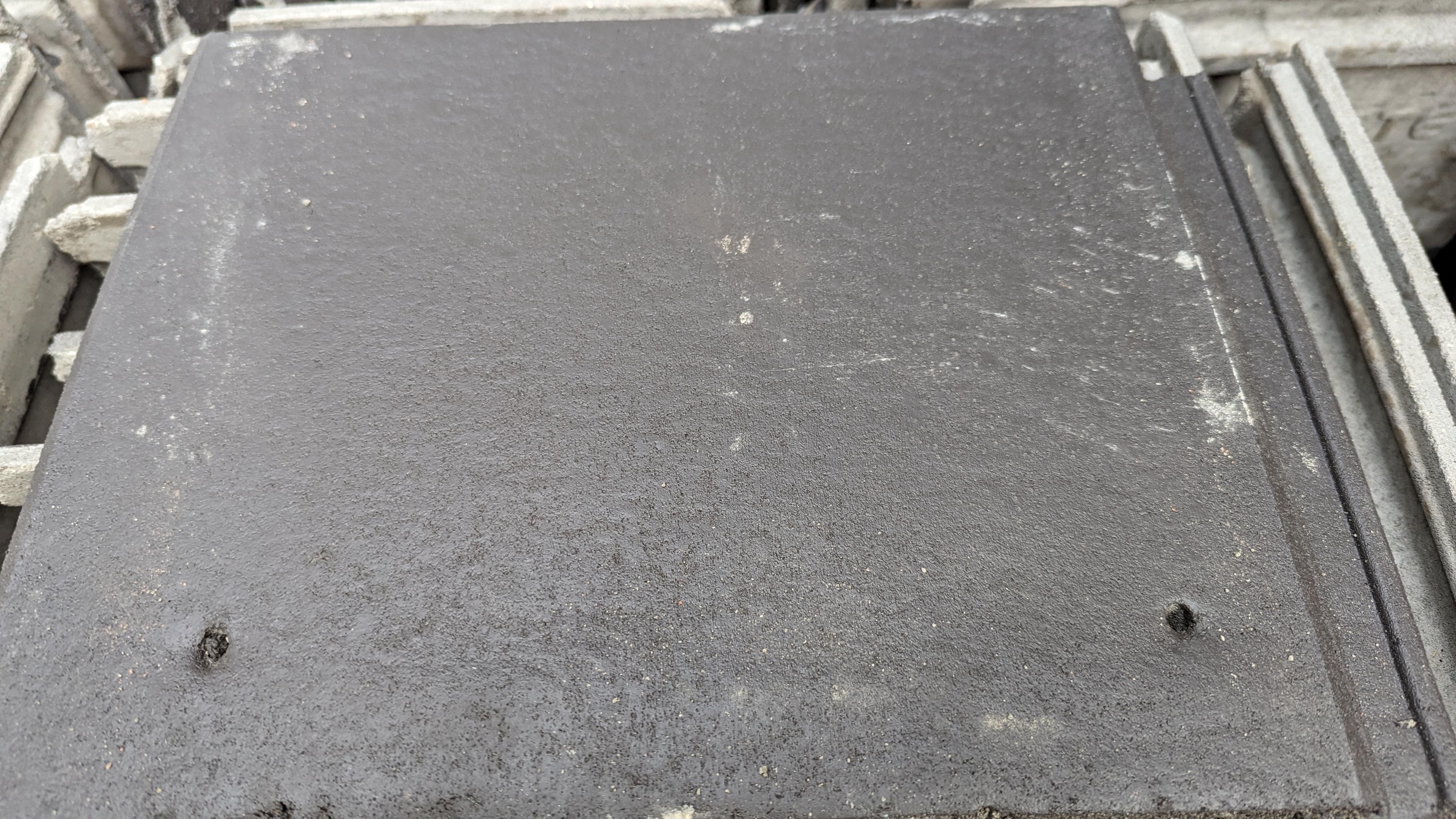

  22. good point, indeed the tiles that look like someone spilled thin white paint on them might indeed just need a powerwash. And seriously: would that be a theoretical option? Getting someone with a pressure washer? Or will that do damage to tiles that dont expect this? Ha marley was my 2nd choice as well! "glad" to hear it's not my bad life choices. I was, and sorta-kinda still am convinced that concrete are a pretty good choice for tiles, but it is a bit grating This is an interesting one, indeed I would say that literal dirt might accrue on the scratches 'fixing' this by dirtying the tiles. another option, literally spray painting the roof? Would that be a stupid idea? Frankly, yes with my drone it's easy to get close enough to see the tiles are 'weird' and/or scratched, but from the ground I didn't notice until I was told to look for it. Up close: Absolutely, the amount of unusable tiles was high for me too.. so far the supplier has been fairly good about it.

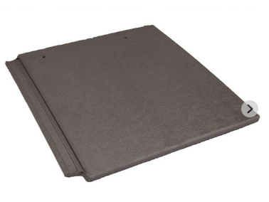

  23. The tiles I've selected (quite a while ago at this point) are forticrete - https://www.roofingsuperstore.co.uk/product/forticrete-sl8-slate-effect-concrete-roof-tile-pack-of-108.html And a good amount of them look great, but a large amount of them have all types of "white" on them: My question: What's reasonable to expect? Of course the picture on the site is 'perfect' where arguably more than 50% have some level of either "white water stains" or some type of scratching: Could it be a good few raindrops will clear this right off? Or if not, is there some way to fix this e.g. I dunno, spray paint? Or should I complain? Frankly, from the ground level it doesn't look too bad since the viewing angle is pretty shallow, but not a great way to start your new roof..
