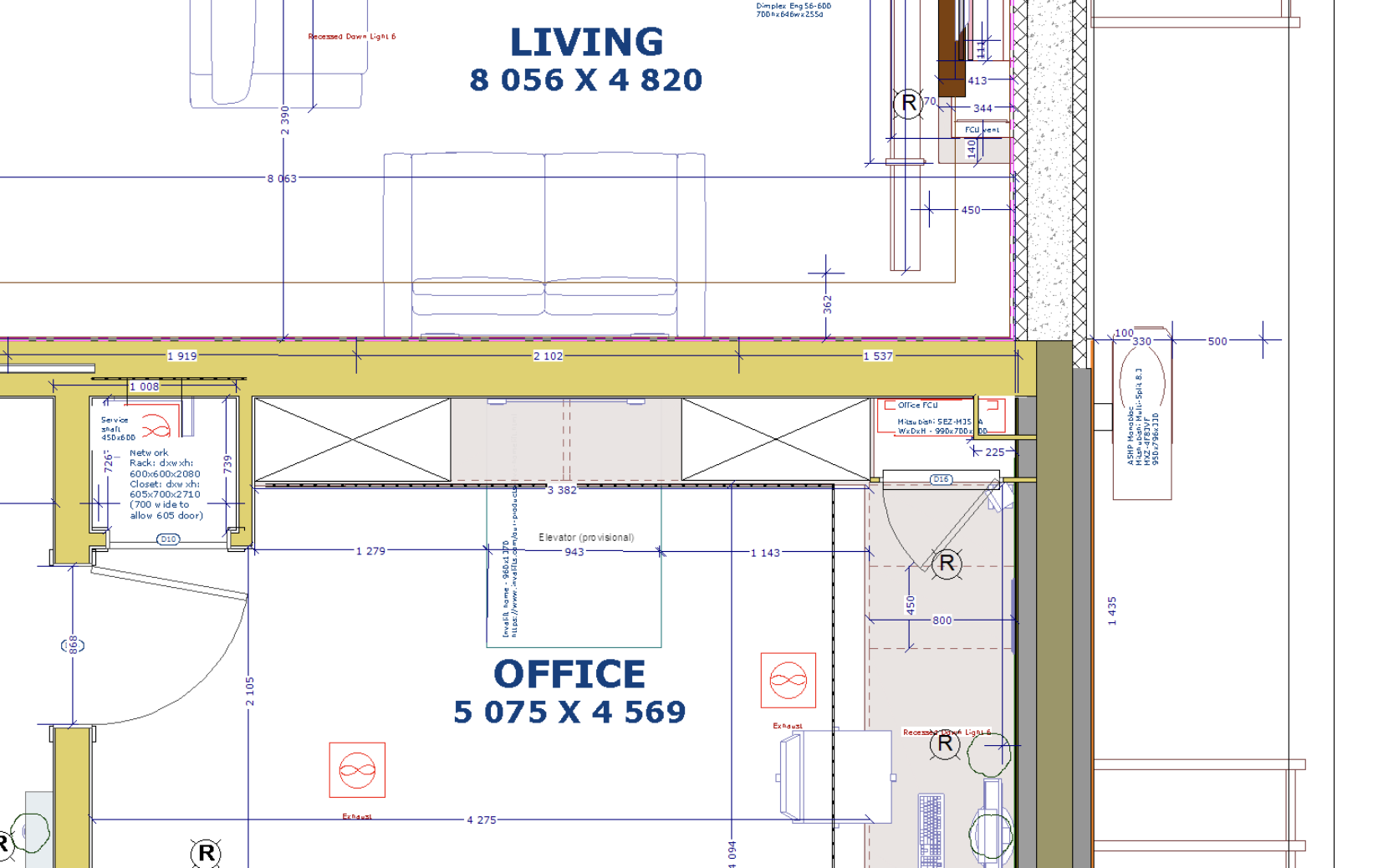

35Hz Vibration noise & dampening?
puntloos replied to puntloos's topic in Air Source Heat Pumps (ASHP)
I am imagining (ha, I thought I was having tinnitus) it was everywhere, but very ambient hard to hear, but my office desk is 2m away from the outdoor unit. One day I was standing in the networking closet (far corner of the office, near door) and it was loud there too. -

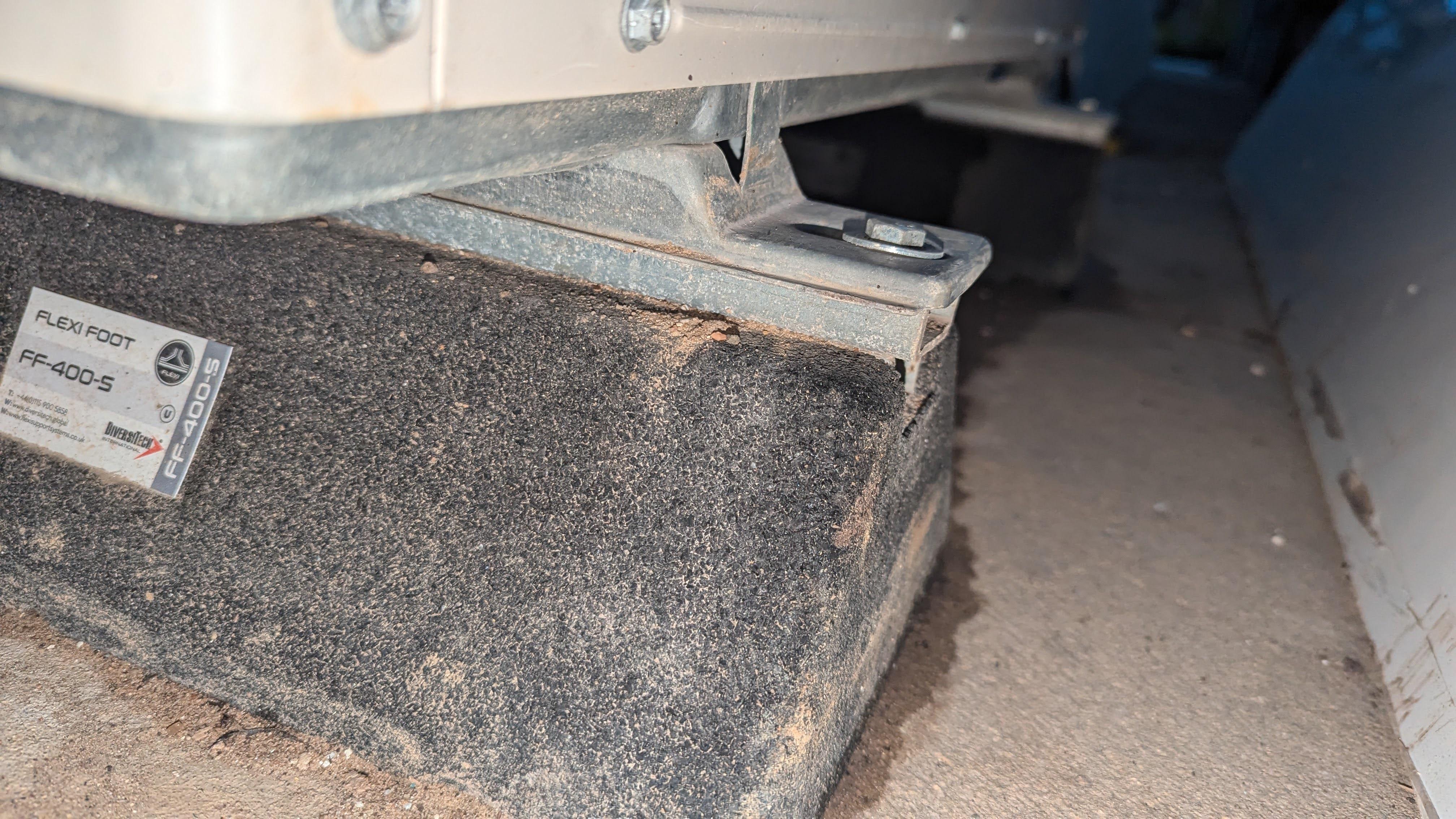

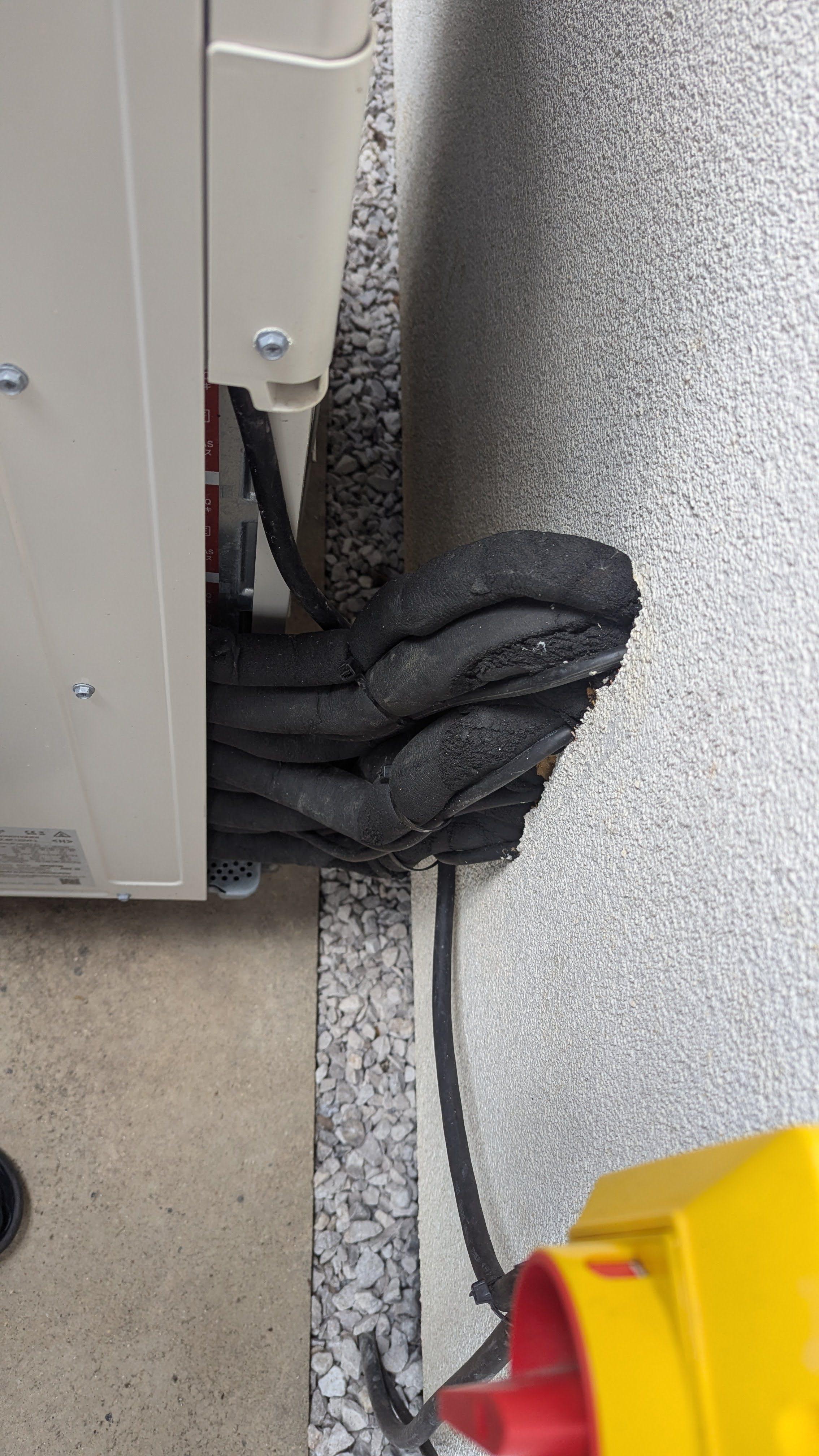

My ASHP is placed right next to the house (as I imagine many aircons are as well), on some rubber-ish feet. (thankfully not wall-mounted other than the pipes going into the wall.) https://www.dpbuildingsystems.co.uk/flexi-foot-400mm-with-strut-ff-400-s-en Apparently my device's fan runs at 35Hz since especially in the adjacent room I can feel/hear, even measure the vibration quite easily. My question - is there anything I can do to improve the situation? Any type of further de-coupling? Can I upgrade the flexi foot thing somehow?
