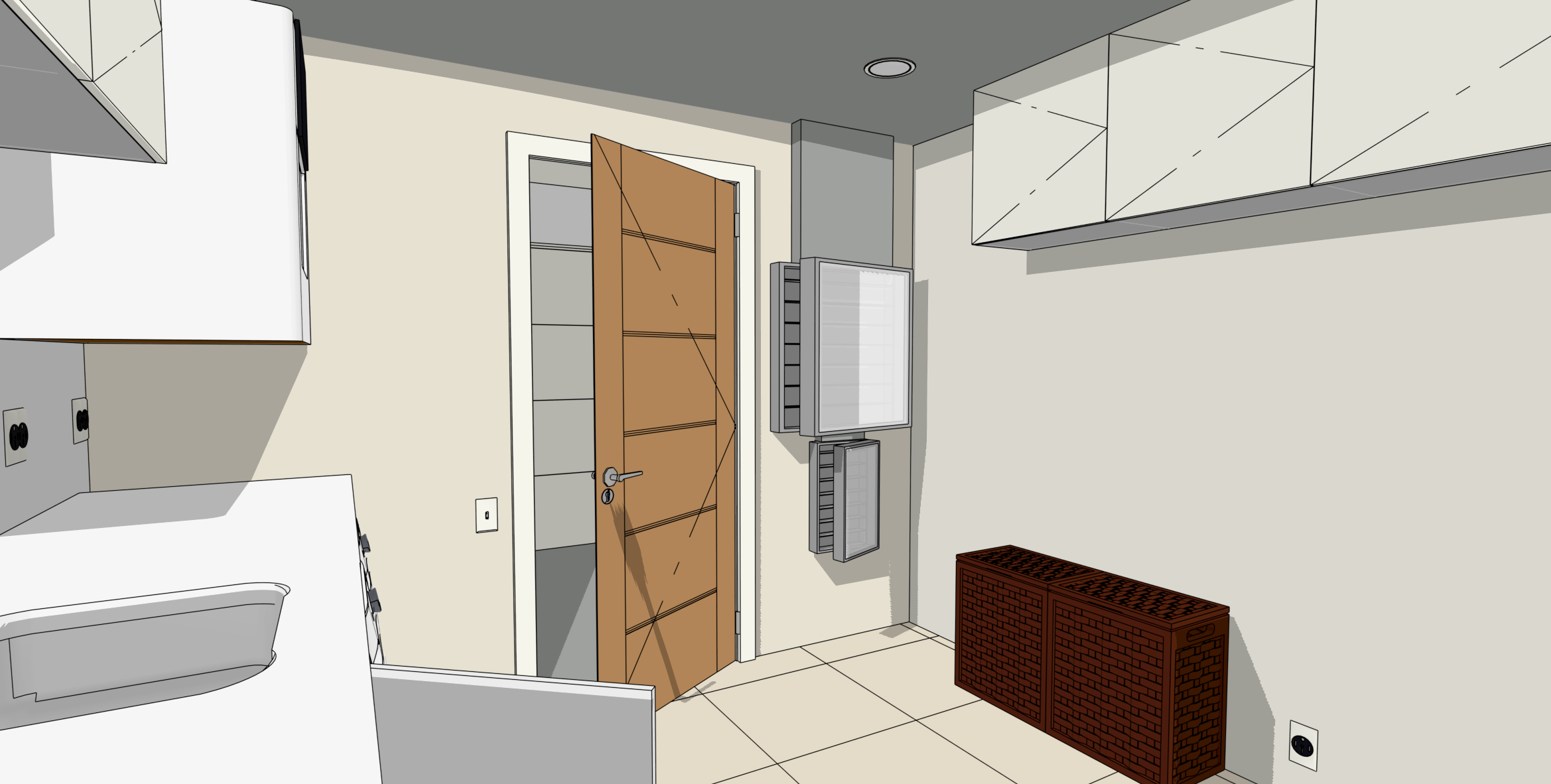

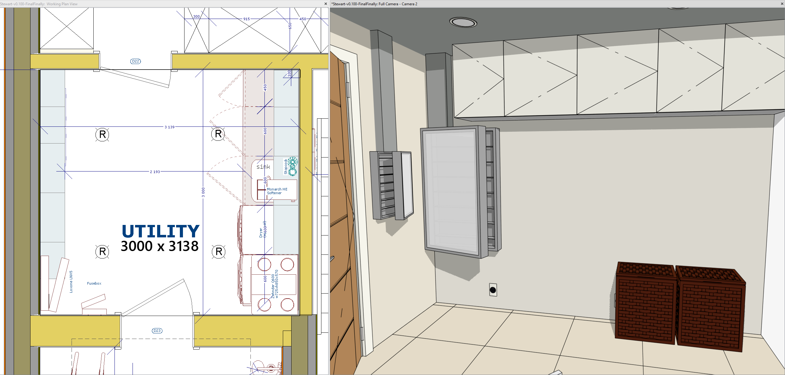

  1. OK an updated design, then: - LXN5 - with the 200wide, 100deep cable trunk on its left side. - CU on the other wall. - Units arranged to avoid the trunk. Is this serviceable?

  5. This idea - LXN3 above consumer unit. The alternative is to have the loxone box on the other wall, but I'm hoping I can route the 240V up and either through or around the loxone box. Would that work? (I don't think I'm allowed to reverse them, consumer unit has to be between 450 and 1200 mm above ground?)

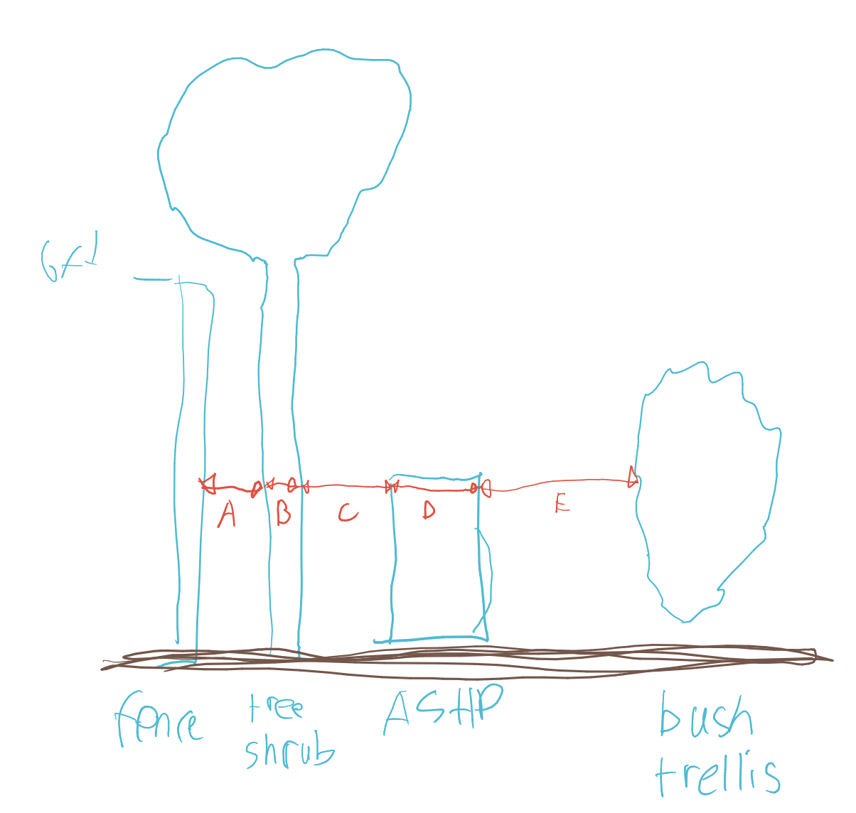

  9. So placing an AC or ASHP outdoor unit has a few sensitivities I'm aware of: 1/ Permitted development. In many cases for ASHP you have to place it 1M away from the edge. -> my understanding is that this requirement can be waived, if we prove the device is quiet enough - below ambient outdoor noise - anyone know more detail? -> For Air Conditioning there are no requirements that I'm aware of. Anyone know differently? 2/ Device needs room to breathe from the back - 300mm is sufficient (but what about 'tree trunks'?) -> Putting plants closeish behind is fine, but what about the roots disturbing the concrete? 3/ Device needs room to breathe from the front - Mitsu's latest model specifies 600mm minimum I think (plus with passivhaus I don't need it running on 'max') Just visually this is what I had in mind A=100mm B=100mm C=100mm D=480 (Mitsubishi Ecodan 8.5) E=600mm

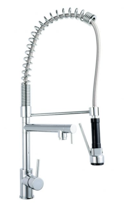

  12. Surprisingly (?) this brand was my default go-to and they do not have pull out nozzle that has an on/off switch! Basically you just turn on the tap with the main control and then water will come out. What I really want is a button 'spray/pause' to control the water flow garden-hose style.

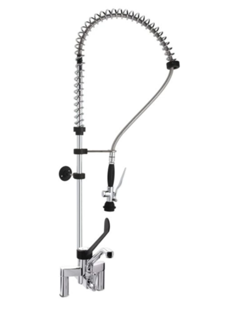

  15. Kitchen taps are harder than I thought. I just wanted a tap that: 1/ Has a long, flexible hose to reach all corners of a large sink 2/ Has a "go" button (so single hand operation. Many taps just run, and you can maybe modify the stream type) 3/ Mixer (hot&cold, obv) 4/ Ideally also a pot filler but this is optional This is the tap for me... https://www.limekitchenandbathroom.co.uk/monolith-hygiene-lever-pre-rinse-tap Or perhaps even better: https://www.reginox.co.uk/ariege-ch Has a pot-filler and has a single-hole, yet it is a mixer tap.. Except: 1/ Is this brand any good? How do I know? Should I just hope? 2/ Will this fit (mounting holes? Water pressure?) Halp?
