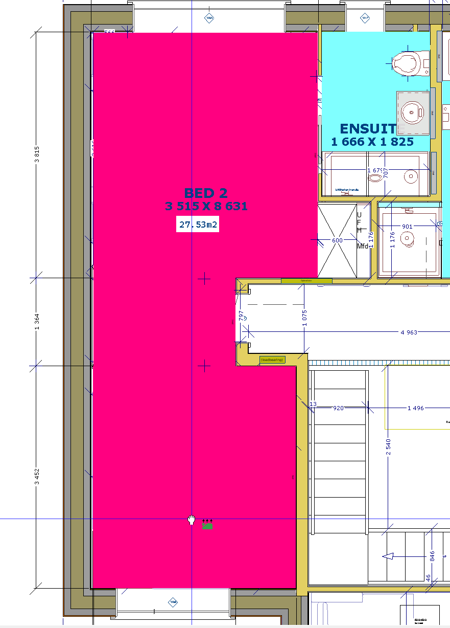

Designing room for our currently 6yo kid. Question is which floor type, or combination of floor types, is best for him? The two options 1/ Amtico - (83 GBP per sqm for Spacia, inc install, inc VAT, inc underlay) - Indestructible, almost - Looks modern, solid - Super easy to clean 2/ Carpet - (59.50 GBP per sqm for good quality, inc install, vat, underlay) - Best foot feel (and we don't wear shoes in our house) - Harder to clear - Dies quicker especially if rolling a desk chair over it all the time Because we have a large room for him, we are considering doing carpet in his sleeping section (top) and amtico in his play/work section with desk, desk chair(rollers!) opinions? Do kids even like carpet? Other than price any hidden/unknown upsides downsides?
