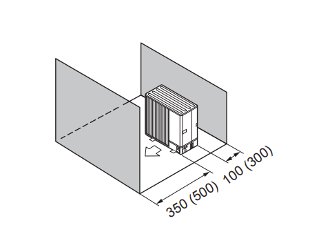

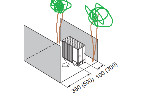

My ASHP (mitsubishi ecodan) has this in the manual: My main question really is, can I plant some trees right behind the ASHP, e.g. With the trees basically only being 'trunks' (and not impeding airflow) around the ASHP, and the foliage just above the 6ft fence? And of course some tree with a non-invasive root system that doesn't undermine the ASHP? This is from a 'street planting' site:

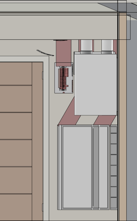

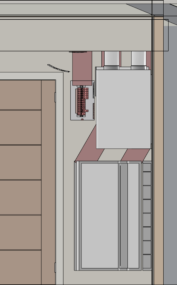

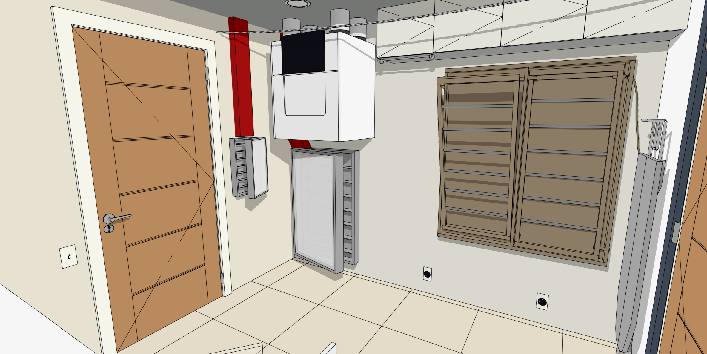

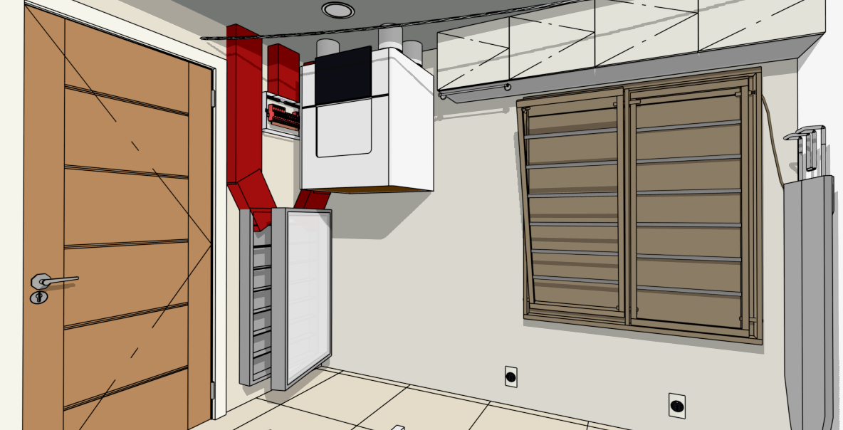

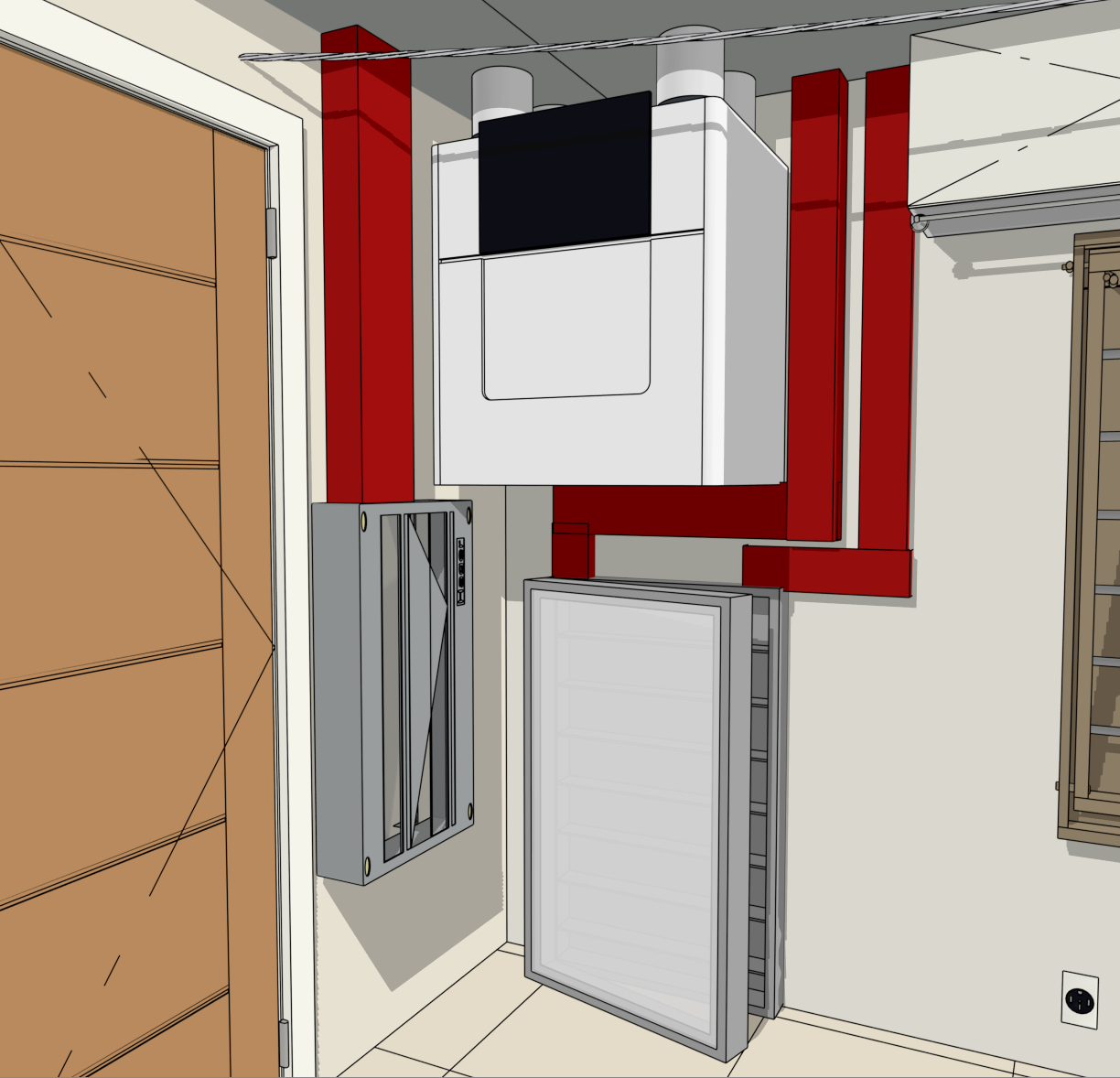

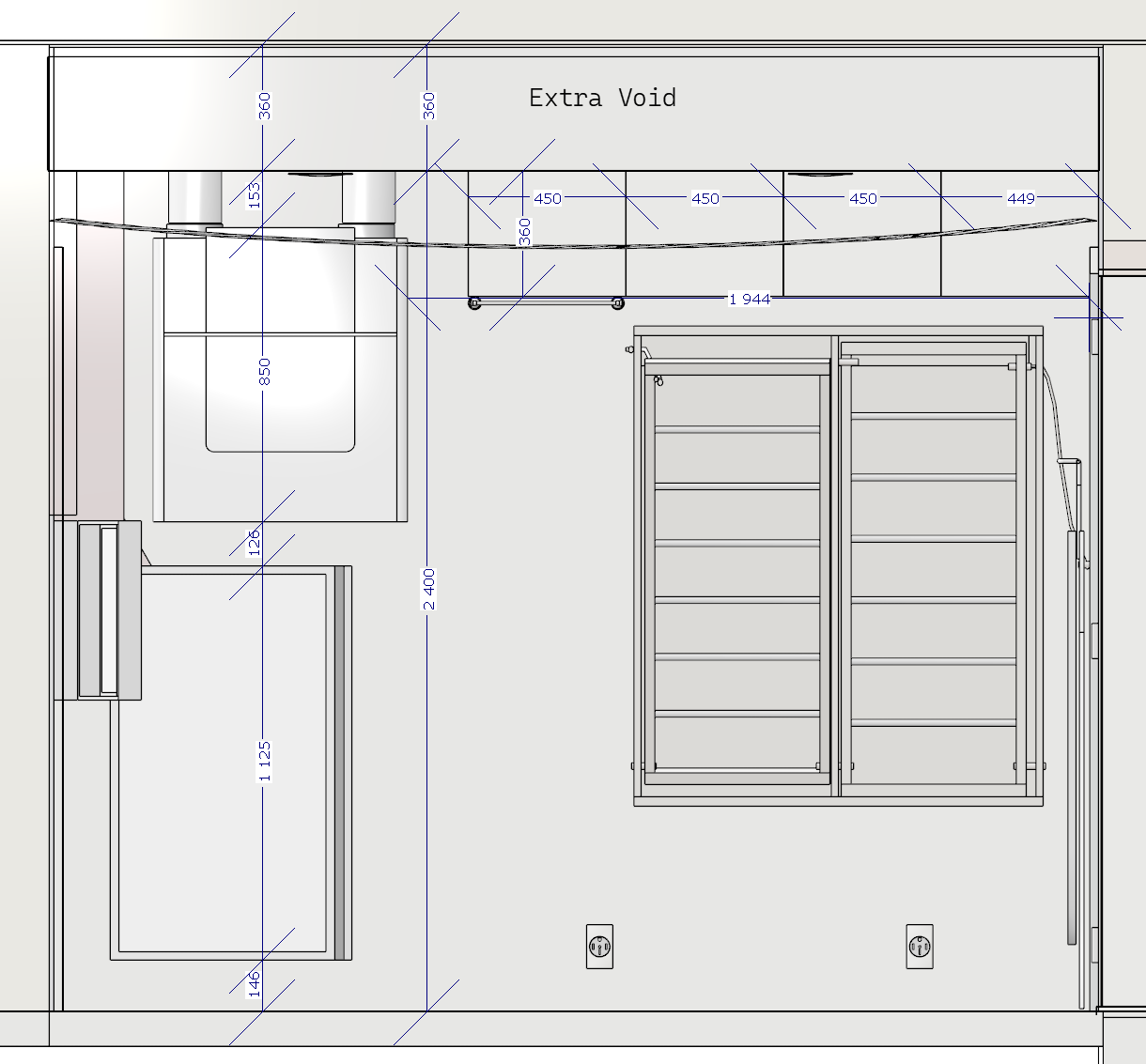

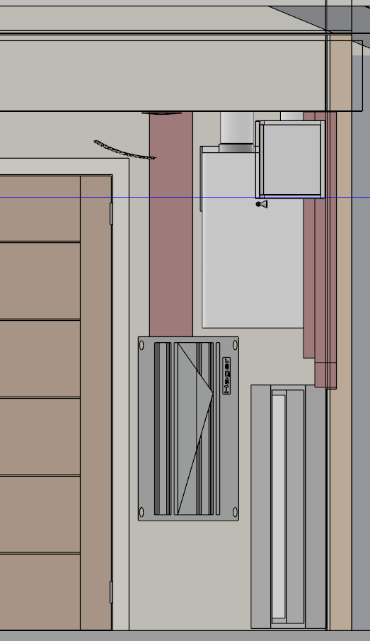

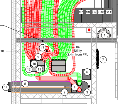

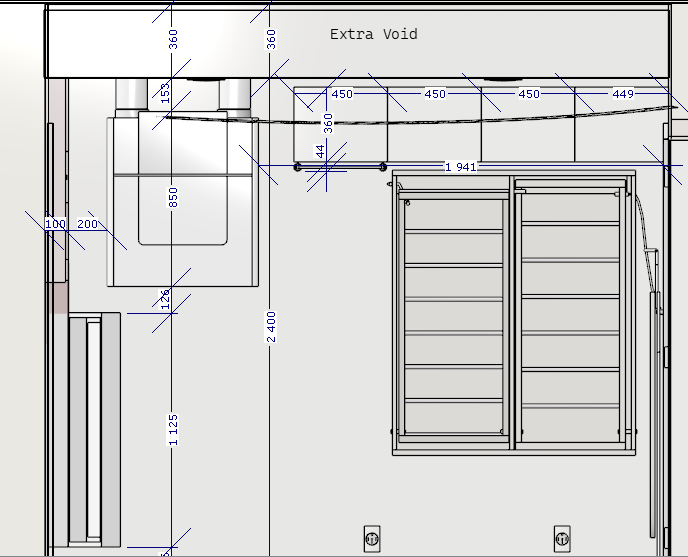

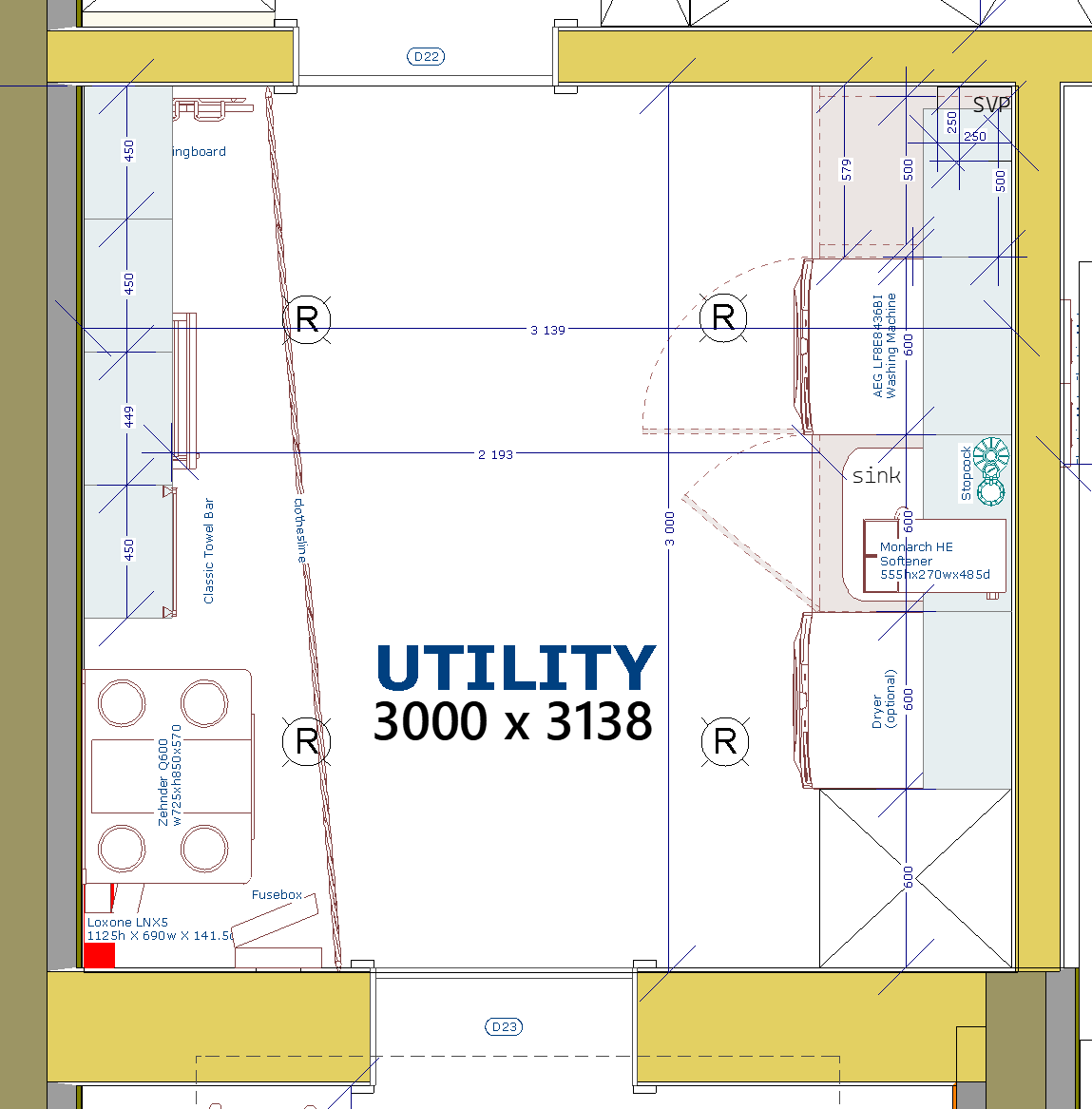

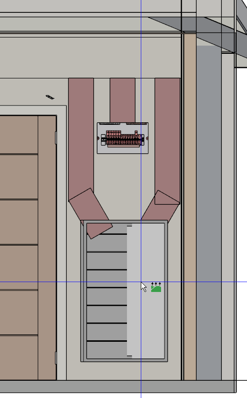

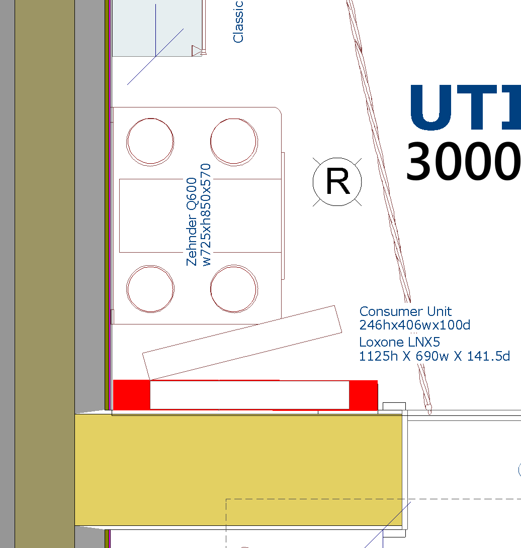

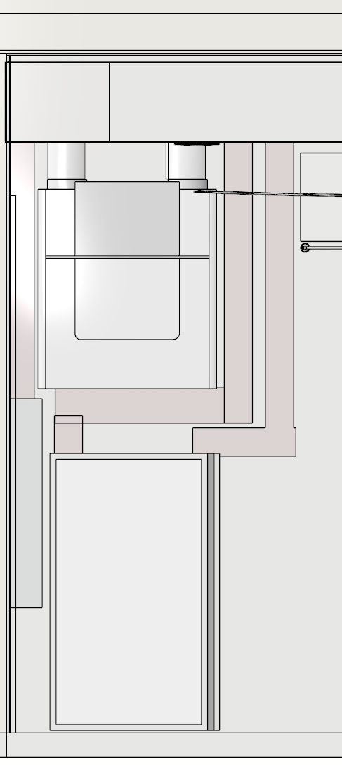

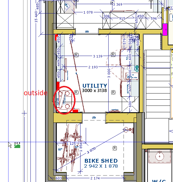

Same. We have 2760 ceiling + 150 void and we're dropping to 2400 (so a 510 void.. for....: boom. (the MVHR has been relocated to the left, after this design was issued) As for CU: Oh dear, we also have 3 phase, well, I'll use the spec of yours for now (I'm sure the elec team will pick a correct one, I just don't know which) And then rejigger... again: - CU on side wall, but does not clash with MVHR - MVHR 100mm off that wall, so opening it will be unobstructed - Loxone under MVHR, should be fine if the device is 99.9% drip-free with the enthalpic thing - LXN5 sits on floor, allowing for a decent-ish space to route the (red) cable ducts. One of our main goals is to preserve as much standing space as possible so the wall units end at 2000, and loxone, cabling is all thin.
Zehnder Q600 with EE indeed, no condensate drain Worth a check - will do. My understanding of height limits is that while "1.45m" is a sensible implementation, anything below 2m seems allowable. A normal human should be able to reach without ladders, and well, most humans can reach about that. I don't know! My site manager thinks it'll be a 'standard size' - about 460x240 - but he is no electrician so will have to verify. That's a tough one. Normally it would be partially obscured by the MVHR, but if I give.. 200? 300mm clearance between them that seems.. usable? Or? IF it is indeed a standard height ('one row' - which is 240mm) then it could work nicely if it's mounted vertically Like so:
First off thank you for your detailed answers and tips @Dan F, I really appreciate the amount of questions you bring up that I as an amateur never thought of I think you're right about the loxone, but I'm assuming this is in hand How about this arrangement then? My main concern is that I don't know how much a MVHR can 'obscure' a consumer unit. Yes, we do have attenuators from Zehnder - Zehnder confowell 625 with 12 outlet and Confowell attenuator, 235 deep, CW-S 625(990323505) Not in the A2A Fan Coil Units though, would this type of device also help with FCU?
