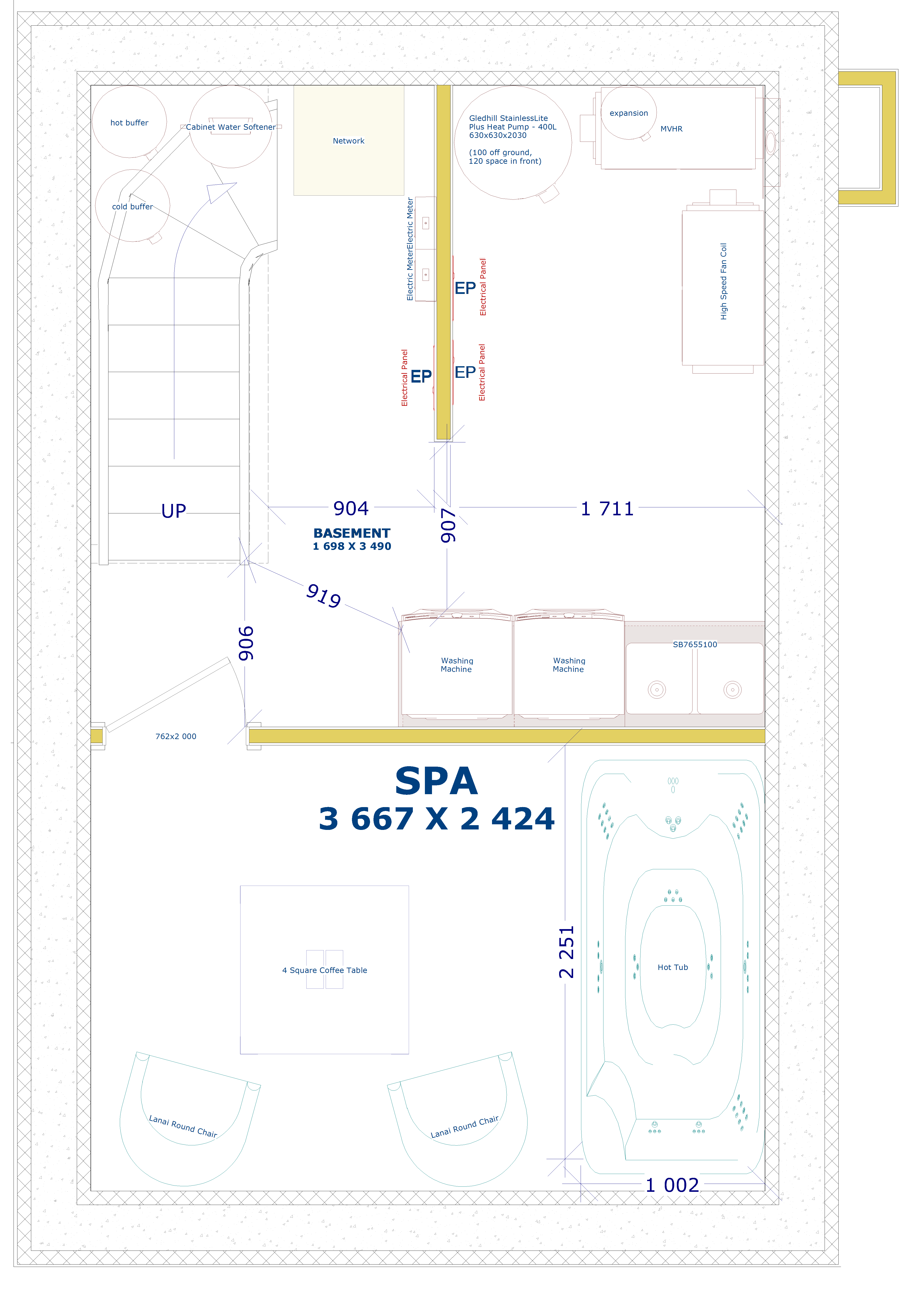

I'm still toying with the idea of a basement. One of my M&E team says that having all plant (MVHR, chiller coils, cylinders etc) in one place will make the plumbing meaningfully simpler and more efficient. Same really with smart home networking etc. Having simplicity over complexity. Also given the size of my basement I probably can even fit a spa - but that's not really a selling consideration. Anyone have any insights on this one? How much better is having a central plant room vs having all the services stuffed away in under stairs cupboards, eaves etc etc? Design: (the yellow 'ear' is the full-house-height service shaft - 600x600ish

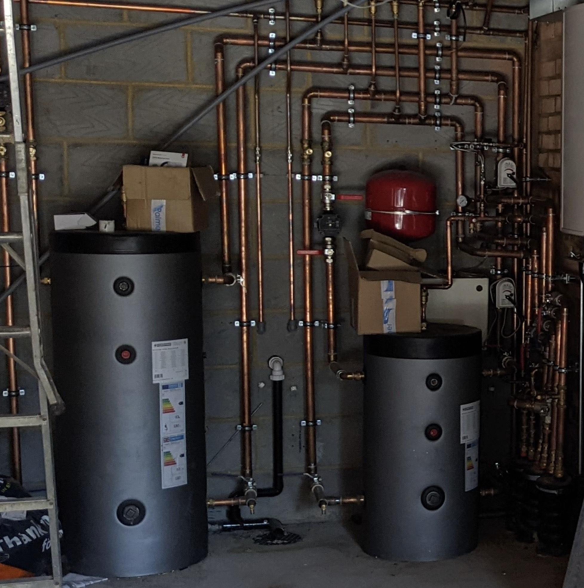

Recently saw a design of a house that had: - ASHP - Hot water main cylinder - Hot water buffer - Cold water buffer Can anyone tell me what the 'point' of these buffers is? Obviously they can somewhat act as 'heat/cold batteries' but no idea if that's a big deal or if it's only going to help something in the most extreme circumstances (such as hosting 5 extra guests, or the hottest/coldest days of the year?
