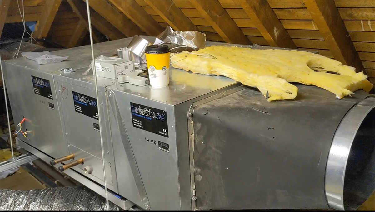

Pictured is the 14kw cooling unit (effectively a fan coil unit - the two copper pipes take the coolant (water I assume) - but with high speed air to service a house). As you can guess the output duct is 300-odd mm.
My house has designed a pretty major service shaft (600x350mm) which should theoretically fit at least one of these insanely insulated (300mm?) cold air hoses that comes from a house central chiller coil w/ high speed fan such as https://www.invisible.ac/#product My question: When the cold air comes down from the loft, where, and how does one split these pipes? Do you put 'one hole' in every room? or smallish (100mm?) pipes through the void?

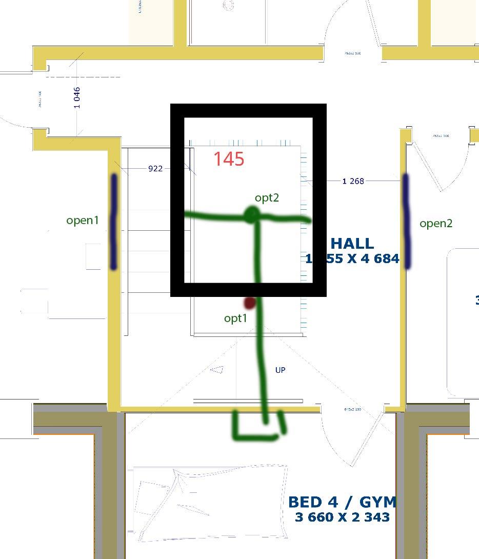

Ha, that all brings back my highschool weight physics math. Ouch, all forgotten, but I mildly recall the gist, thanks. I think if I do this I would probably do well to do a beam-trolley, possibly house the motor somewhere as in my graph, and a snatch block on that trolley... would that make sense?
No reason, amateur design on my part. Are you saying regulations are not ok with this?

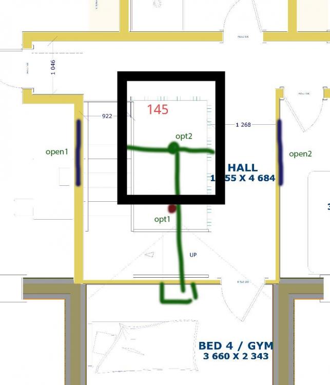

So.. @pocster mentioned he has a winch. I'm tickled by the idea. I have 4 challenges: 1/ In general, getting heavy stuff up/down stairs 2/ Chandelier in hallway, ideally central to the stairwell 3/ Getting stuff into the basement (as @Ferdinand noted, perhaps a removable slab in the hallway floor?) 4/ Getting stuff into the loft My full height hallway (ground floor all the way up to skylight) has 2 options I can imagine: 1/ one spot where I could theoretically attach a winch directly to my ceiling ("opt1") that can go straight down without hitting walls or stairs. - It's not central to the hall though, so that is probably useless for the chandelier 2/ Cut across the skylight (in black, obv). A bit uglier, but perhaps not the end of the world. - Can be central to the hallway - Motor could even be hidden in 'Bed 4' My questions: 1/ What would you do in general. Is this a good idea? Which one (opt1, or opt2?) 2/ How far can stuff be pulled off-center from the winch? If something is dangling from the winch, can I pull it 1m to the side? 2? 4? When does this become unbalanced? 3/ The loft walls are indicated (open1, open2). Both about 1.8m away from the winch point. would it be doable to pull stuff into the loft 'hole' from there?
The tricky part there is that our hallway (that goes alll the way up) is above. I suppose..... that doesn't *necessarily* have to be a problem to have the winch be 8 metres ... hm. Are there stairs that can have a piece "easily" removed? Or would you recommend 'middle of the hall'?
Where exactly? Above the top of the stairs? (like so, the coathook indicating position) Can we even pull out the stairs to make way for things going up or down?

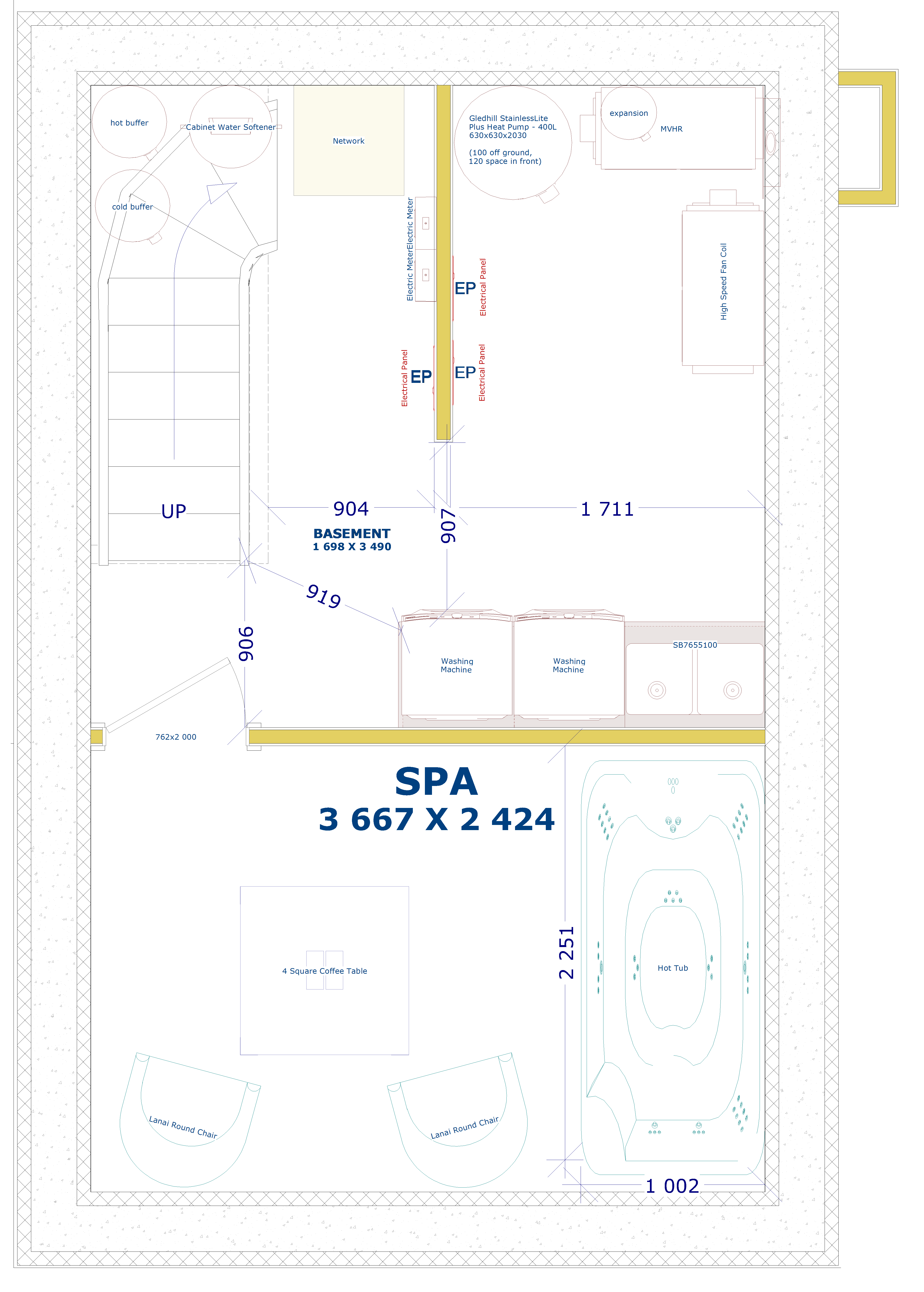

Good point. The one I had in mind - https://www.thehottubwarehouse.co.uk/product/the-bliss/?sfw=pass1627298380 - is 150kg dry weight, 5000 quid. Will 4 burly guys/gals be able to do this? Will my stairs actually hold 4 burly guys and a 150kg bath? Absolutely true. Yep, full sumppump system planned anyway , not in the least because also the chiller coil, washing machines need it.
Is there some way to work out which type of stairs can fit which types of furniture? I've never seen some easy way to predict if a "standard couch" can go up a spiral staircase, for example. My current conundrum is that I am tempted to put a hot tub in some spare basement space, where the stairs are 1m wide. (in the current design!) Of course I can put the tub in before sealing up the basement somewhat but what if it springs a leak or gets embarassingly grotty? How can I be 'reasonably sure' that I can get it out? (note, this is an 'under stairs' stair, so the right wall is just a flimsy wall that can be taken out.. my *hunch* is it should be doable.. or?

Yes the 600x600 was intended for those huge insulated air pipes. Was somewhat (re)debating a dumbwaiter as well (for the laundry) but I'm not sure where I can fit it. Current (v. provisional) basement design: (with the yellow thing being the 600x600 shaft. (dodgily drawn but you get the idea) St Albans area
But in my particular situation I actually am designing a 600x600 whole house (vertical) service shaft anyway so by itself it's not a problem to accommodate. Not sure I'm wrapping my head around this yet. Of course(?) MVHR can .. HR - so indeed pulling hot air from the loft doesn't seem too crazy if it's available (I do have a central hall with skylights all the way up, could even consider trying to pull away heat there. But for "harvesting cold" into a cold buffer I think we can certainly see the same principles apply, when immediate cooling is needed, have a bucket of cold water at the ready - possibly collected at night - rather than doing this when the heat is greatest not to mention elec. prices are highest (but I guess also solar is highest) But when it comes to cold buffer, I am certainly planning either a central coil beast Perhaps AND / OR - augmented with per-room fancoils and possibly cold water UFH (not a fan, condensation.. but might be controllable)
