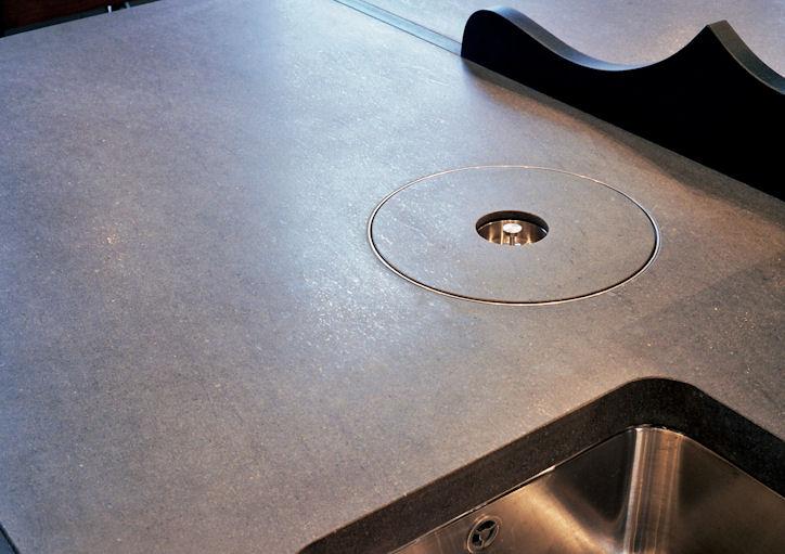

Cleanable Waste Chute next to cutting board
puntloos replied to puntloos's topic in Kitchen Units & Worktops
Ha, true for normal caddies as well though. Yep smells and cleanability are the main concerns here, and especially with a chute I worry that the sides become very grotty. -

Why not? ? Problem with this is that you are actually in the way of the pull-out while prepping. You don't want to have to stand back, just to slide the food 'into your lap', no? OK to be fair I sort of understand that there's a certain aesthetic reason against having a hole in your worktop, plus if you need a flat surface, this hole (and the 'lid') might interfere. But I could imagine finding the 'right place' and 'right size' might just work. -

After a private discussion with @ryder72 - we were wondering: - Assume a prep area on an island - The prep area is (say) 600mm deep (this comes from the depth of a hob plus a small rim in the front of the hob) - The full island depth would then be about 900mm (assuming a 300mm half-depth cabinet attached) -> Can we create a "food waste" chute in a 300mm half-depth cabinet that is Cleanable? Would this work: https://binopolis.com/wesco-ergo-master-worktop-food-waste-bin.html? Other ideas?
