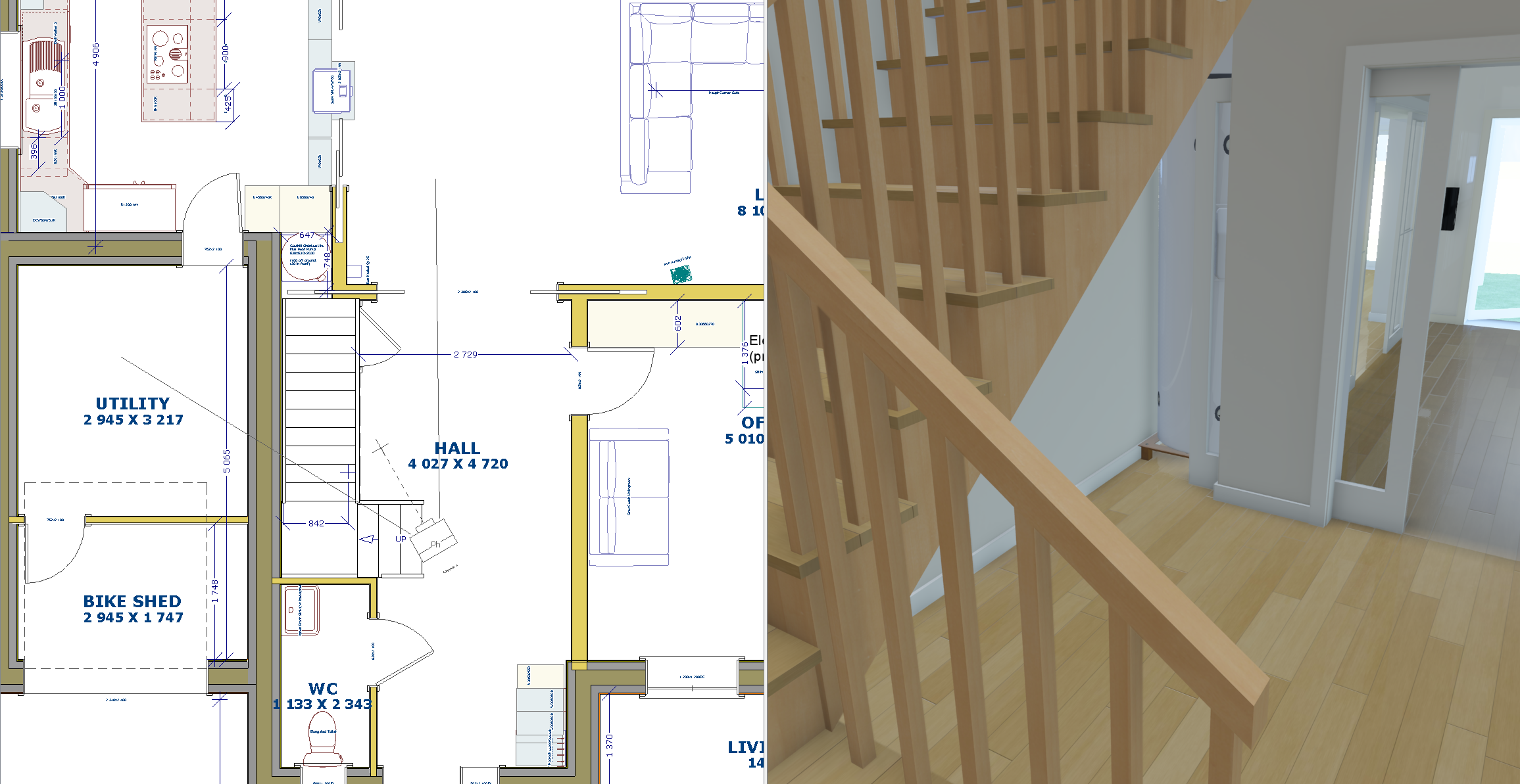

Depends on their size I suppose? Looking at https://www.gledhill.net/products/alternative-energy/stainlesslite-heat-pump/ - and speaking to the manufacturer, they say it should fit fine in 647x750 (pipes/gizmos sticking out in front) lifted 100 off the ground. That leaves about 530(h)x650x650 right above it. Alternatively, we do have the actual under-stairs cupboard (but with the challenge that the pocket door needs to be able to close!) Note: I left *zero* wall between the kitchen unit and the cylinder. This will surely mean that kitchen unit will be warmer-than-normal but as long as nothing heat-sensitive is stored in such a cupboard that should be okay? Or? Define 'short' really. Sometimes I treat myself to one big bath (1h?) and a longish shower afterwards (15m?) (sorry eco-police.. it's rare, I promise). True. Ha, no idea, I assumed PV (being Photo Voltaic) meant they don't also do hot water, but in short sure, if my panels generate water as well then might-as-well? -

@oldkettleand @SteamyTea advising me on hot water. I've got a crack team here! Agreed that the straight run has some benefits, frankly I can't even quite remember why we figured moving the door towards the livingroom was better. Shuffleshuffle. @SteamyTea so you're suggesting a standing cylinder in that cupboard, perhaps lifted 40cm off the floor so it can be accessed easily? -

Meaning in-wall room? or in the actual cupboard? with 2700 ceiling height, I'd say theoretically 'yes'.. -

https://www.telford-group.com/product/tempest-heat-pump-indirect- That one? 400L? 500L? And would it be OK in the loft, ideally on its side? (so under the eaves)? -

With a hot water return the actual location is a bit of a non-issue, is it not? I'm thinking indeed the manifolds might be cleverly fitted in the newly created space: -

Can't argue with someone with your nickname on this subject. I suppose one key question for me is primarily where to store the "gubbins" - things like manifolds for UFH and MVHR, and the actual cylinder. I always assumed: - Connecting the ASHP 'warm water line' very close to the actual monobloc will be important (long lines seem harder, both for insulation and just transport reasons) - Connecting the cylinder close to that connection seems like a good idea. - Same for UFH manifolds. So, that location was pretty much the optimal place. But would it perhaps be almost as good to have the UFH manifolds be there, but the hot water storage in the loft? I'm sure it will require more pipework but will it be "systematically worse" or just takes a bit more effort by the M&E guys? -

I guess for ASHP-provided water the water is cooler so you need more? True, although for the viessmann there is some gubbins on top of it, but in principle agreed, not a ton of access needed. Still, walling it into a cupboard is a bit of a bet that indeed you don't need to touch it.. -

Eh. 250 is pretty generous, but still, the house is pretty large-ish at this point so certainly if some big family wants to move in it'd be severely lacking so "something" would have to be done. Perhaps a bad assumption on my part. I assumed upgrading water storage with an extra cylinder isn't hard... Heh, well both people recommending this one didn't actually sell the device.. the main "pro" reasons were that having the cylinder and "hp parts" (not the compressors of course, the monobloc is in the garden) together would be a fairly nice way to solve a few problems surrounding installation and more importantly heat loss. Also the device does have a hot water return as well as cooling function which IMO is fairly important. Where would you put the cylinder then? Loft? OK but then there's a bit of wasted space (still, prodave's idea might just work..) -

Very interesting idea... this might actually fix quite a few things. If anything, nothing stopping us from putting the ASHP where we previously discussed, and indeed have it accessible if the pocket doors are closed.. Might have to ponder this option deeper.. -

It's 222L, so sufficient for 3 people, but the house indeed is large, we were thinking if needed a secondary cylinder could go in the loft? What to do with the extra depth then? This was somewhat debated when talking to heating guy. The device should be pretty much silent (maybe a pump) and pretty well-insulated (also compared to the hob, the amount of heat it puts out is not a big porblem). So I agree with the 'sense' but I'm not sure there really is a big downside? My only concern is indeed the kitchen space is sorely needed so I'd prefer to indeed have a more 'kitchen-y' use, but in a way it can be recessed out of the way, if only we could provide proper access to it.. Nah it's perhaps an unfortunate angle but the side of the fridge is dark, it's not inset. It would impact a car though Hmm something semi-movable (like a fridge) might indeed work there, so it can be rolled out of the way if access to the ASHP is needed.. Ha. No. -
Take a look at the attached image, in particular the weird kitchen corner, which is 647x600. What "clever" thing shall I do with this corner, and where to store the ASHP A bunch of notes - The viesmann 222 ASHP temporarily put in the middle of the room is 60x60, and could actually fit in that corner but then suddenly you can't put any cupboard in front of it - Also, there's a walkway above that spot, so I guess pipes would have to go up-and-over the pocket door into the stair cupboard - The ASHP could fit in that stairs cupboard perhaps? - The door (to utility) can be anywhere. - Utility ideally should remain empty (since we could make a garage out of it, it has sort-of sufficient size, 5x3) My ideal solution is to have some type of cabinet that conceals the ashp, but leaves it accessible for maintenance, but perhaps a 1200mm deep cabinet exists?
