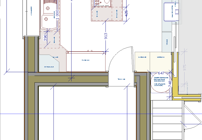

  14. Yep. Interesting factoid. OK, I guess I'll stick with inward then. Yeah that was what I was 'suspecting' but having zero actual experience... Sorry you have nonzero actual experience

  16. Cool, I'm not a builder so I have no idea if there are any "hidden snags" that I'm not aware of. Does drilling into an 'unprepped' doorframe hurt the insulation, does the door fit so tightly you can never make it work if you try to mirror it.. etc it indeed sounds straightforward but things can turn nasty
  17. The door to my garage currently goes into the kitchen, and given the garage is outside the thermal envelope, I assume the door has to be built 'very well', sealing properly, insulated etc. But.. We don't tend to put a car in the garage anyway, so the garage door "banging into the car" is not a thing yet. It might make more sense to have the door open 'outward'. Q: When the mood strikes and I buy me a car I care about getting stolen (or more likely: a future buyer of the house has one), would it be 'doable' to reverse that garage door? Obv not expecting it to be super straightforward but can a professional do it properly without having to knock out the entire wall or cause other wanton destruction?
