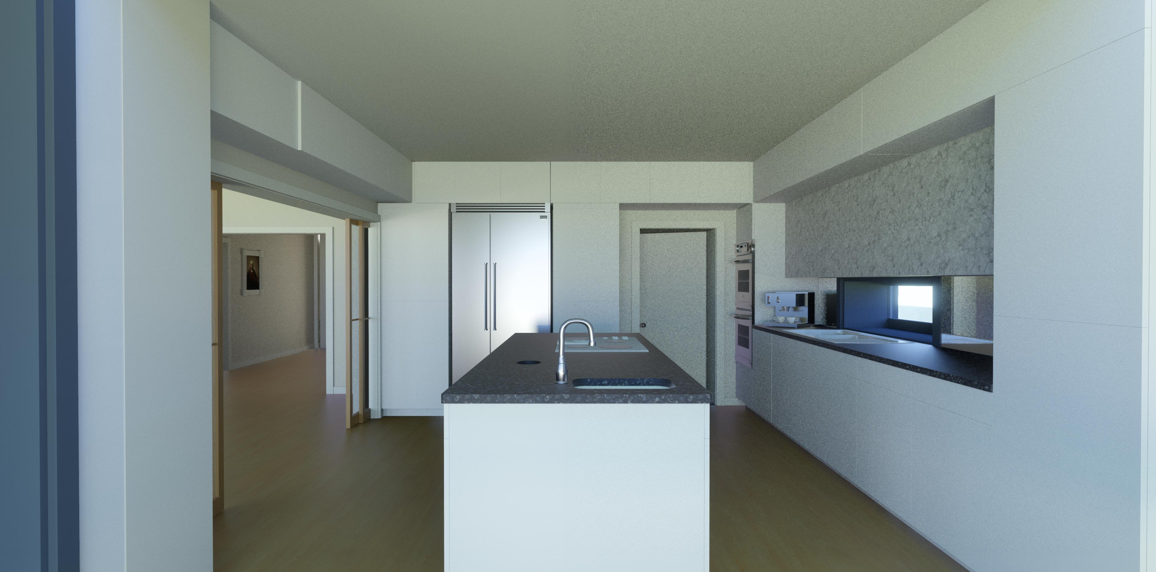

  7. Yes, I'm 6'4 - wife is tall too (but not Dutch tall ) So you'd indeed go for a 1000-deep island.. interesting. Possibly worth doing.

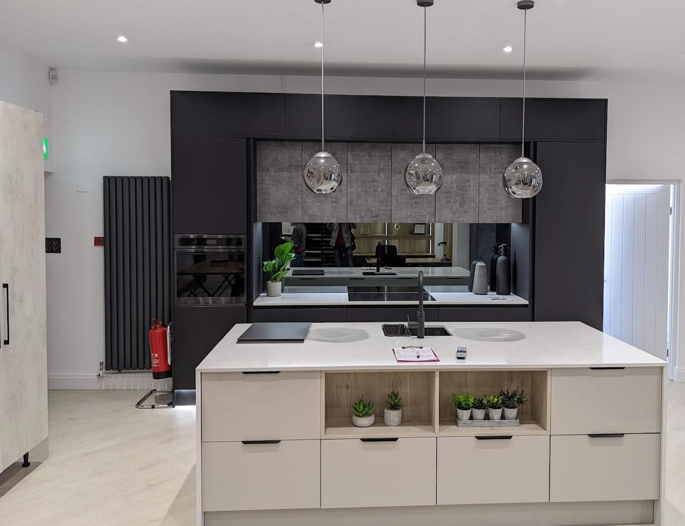

  11. Wow indeed we are pretty similar there. The reason we moved the oven towards the corner was because it tightens the work triangle and if it's open, you don't have to walk around it with difficulty. Why did you choose the right section?

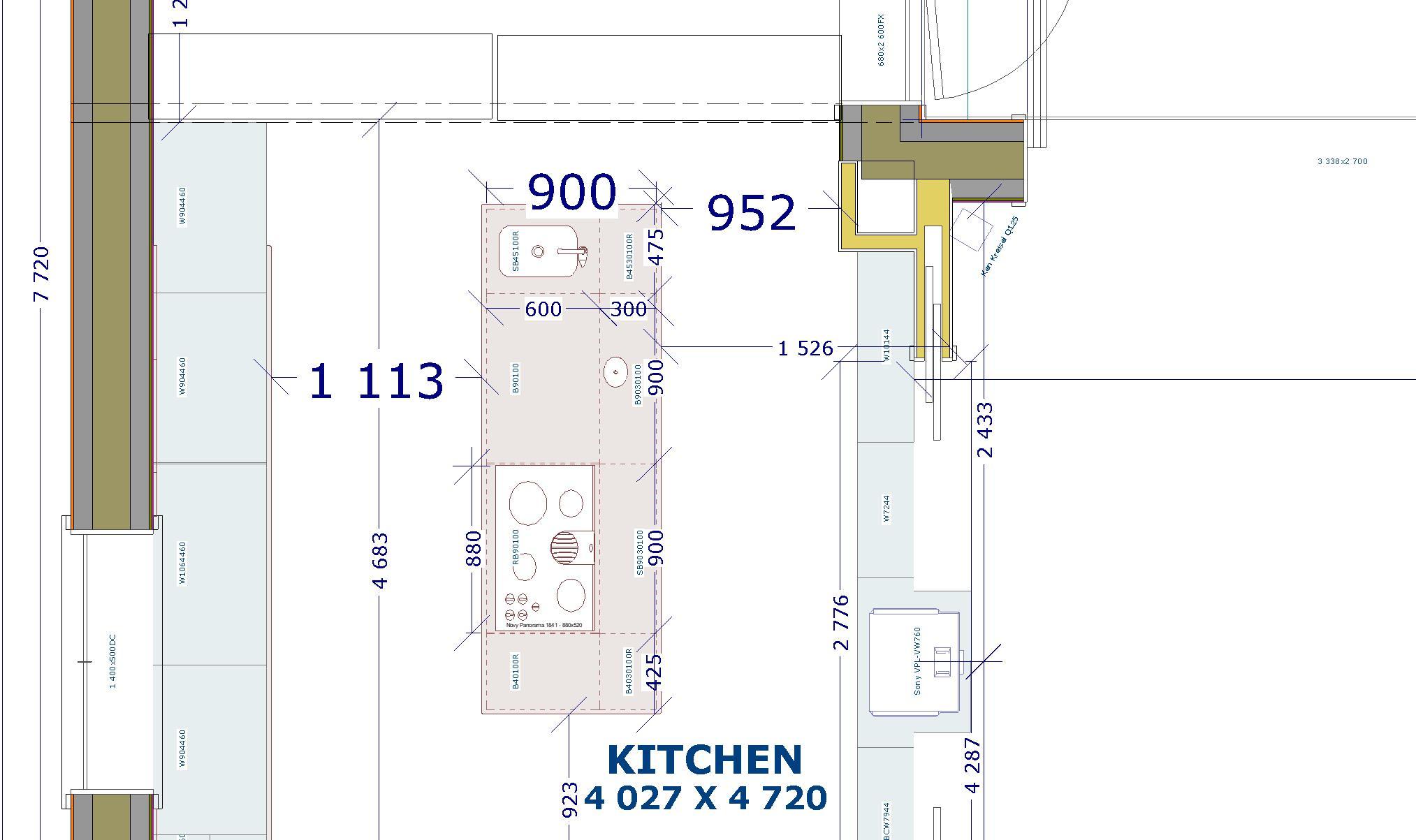

  13. This one looks pretty 'built in' even if it is freestanding. I wonder if the doors will actually open. That's the crucial challenge I think, doors that 'try' to expand beyond their footprint while you open. My samsung needs about an inch beyond their width when closed. Ah - it's this one: https://mahajanelectronics.com/products/siemens-iq700-built-in-freezer-212-5-x-60-3-cm-fi24dp32 - Rs. 489,000 in gbp is about 4700gbp

  16. fwiw here's part ins piration - the heights of the cupboards, worktop, wall units etc are all exactly the same as my design. Including the top of the units are indeed at 2m70 which is what we have too.

  20. Dear reader, take a quick look at this kitchen map. The 3 highlighted numbers. Should I; 1/ Leave as-is. A generous walkway behind the island 2/ Make walkway 1000, make island 100 deeper 3/ Make walkway 1000, make walkway between the service shaft and island 1052? (and.. why?)
