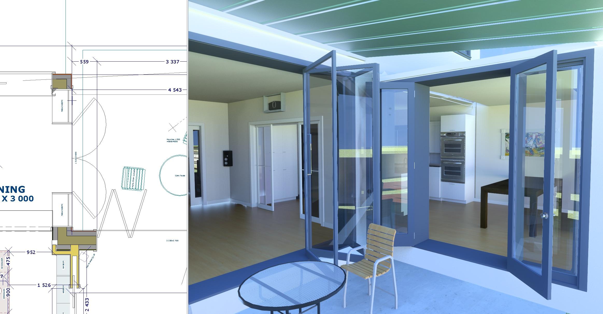

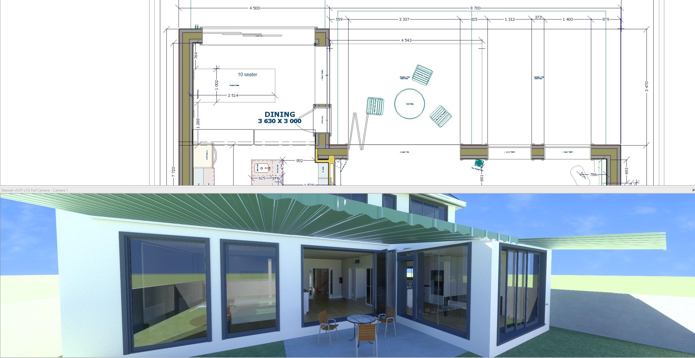

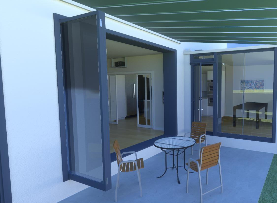

Update: we think maybe this might be an improvement: Given that the door gap as currently depicted (of course my version is less precise than the real design TBC) is 2090 and the average door is 765mm- 765*4=3060 I might have to make the right window slightly smaller than the right door. The improvement here being that the door doesn't clash with the folded bifold. Not perfect, they can hit each other, but in the final positions they tuck neatly against each other. -

My ground floor is 2.7m ceiling height. And, having full height doors and windows is a bit of a statement But: 1/ Should I worry about U-values? I'm certainly aiming for passivhaus (but not super concerned to miss it somewhat). Will a 2m high bifold ....be dramatically better than 2.7m? (note I'm not too worried about solar gain since I have awnings everywhere..) 2/ What about price? I know that the brand I was/am thinking of - Centor 405's does have even 2.8m tall ones. But do they typically have standard sizes or are they made to measure and you're mostly paying by m2 3/ What about ease of opening/closing? 2.7m means 35% more weight of the doors presumably.. will this make the bifolds meaningfully difficult to open/close? Any other challenges I should worry about? 4/ What about 2m with a 'top window' above it? Probably quite pricey.. not sure if it's a big benefit? Will it be even doable with very deep (465mm) window depth due to insulation?

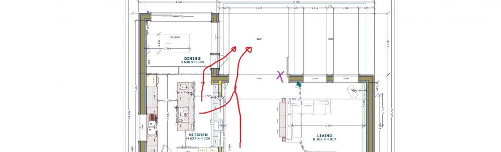

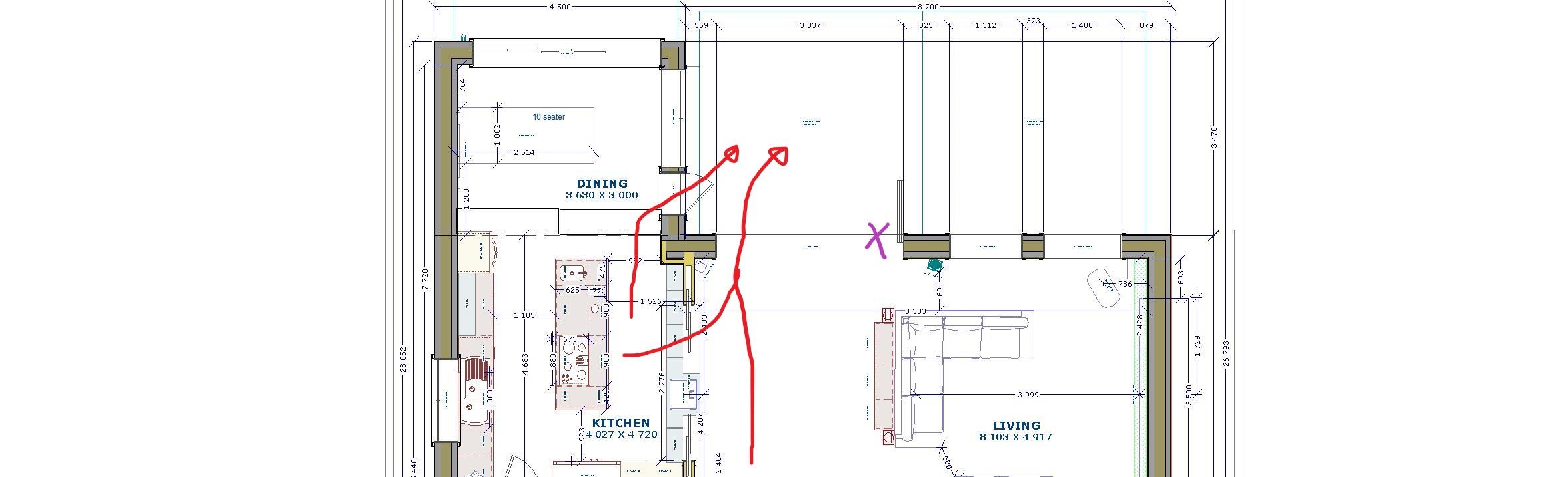

Take a look if you would at my current rear design. See if my thinking makes sense The things I'm balancing: 1/ I want a quick walking path to enter/exit into the garden, which means a 'standard door' (not a slider, but the end of a bifold is fine) needs to be in the corner - close to the kitchen. The purple 'x' kinda feels too far out of the way, especially if you're coming from the kitchen 2/ Putting a bifold with the 'single door' either in the dining room or in the living room gap, will hinder the terrace when they are open 3/ Instead, folding at least one bifold into the corner feels more elegant, so I guess the other gap needs a door: -> Will that work? Is my 3D program rendering this OK or (especially since the walls are passivhaus thickness!) is there too much clunkiness here? 4/ We don't care too much if the rightmost door should be a slider or a bifold, but a slider seems somewhat better, although the bifold could fold into the corner as well.
