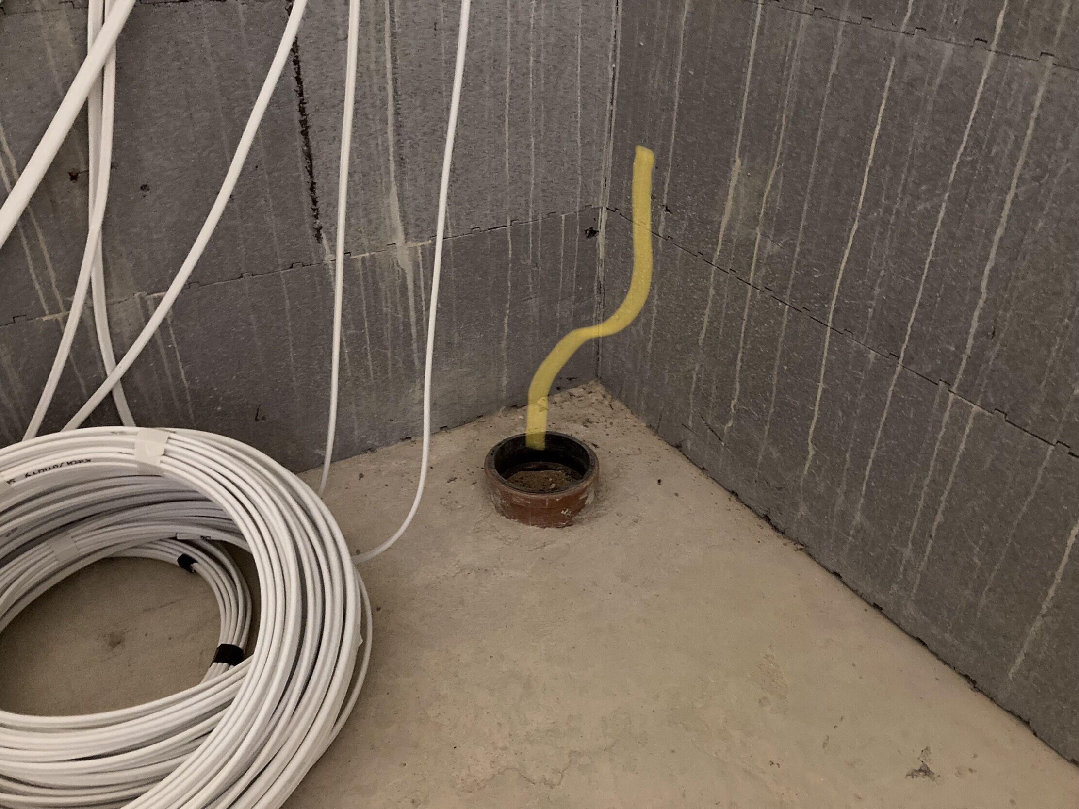

Yes of course that makes sense. This is a stack. I’m not sure exactly how much off the ceiling hole is with the SVP stub in the floor. But between a pair of 22° bends, and some widening of the hole, I’m sure I can make it work.
Peter, thank you for the advice. I will use 2 shallower angles and get the stack a little closer. I think it is about 150mm from the wall right now. I hadn’t considered how the fixing might affect this. I will take a look at your suggestions. I have a hole in the concrete ceiling above where the pipe needs to get to. Very hard to make the hole in the ceiling any larger because it is 100mm thick concrete with steel mesh. Is it a problem putting the stack at a 10° angle instead? The ceiling is 2.7m above the floor, so I can easily angle the stack.

I have a few of my vent stacks that need to be closer to the corner of the walls. I assume I use 2x45° To achieve this.
