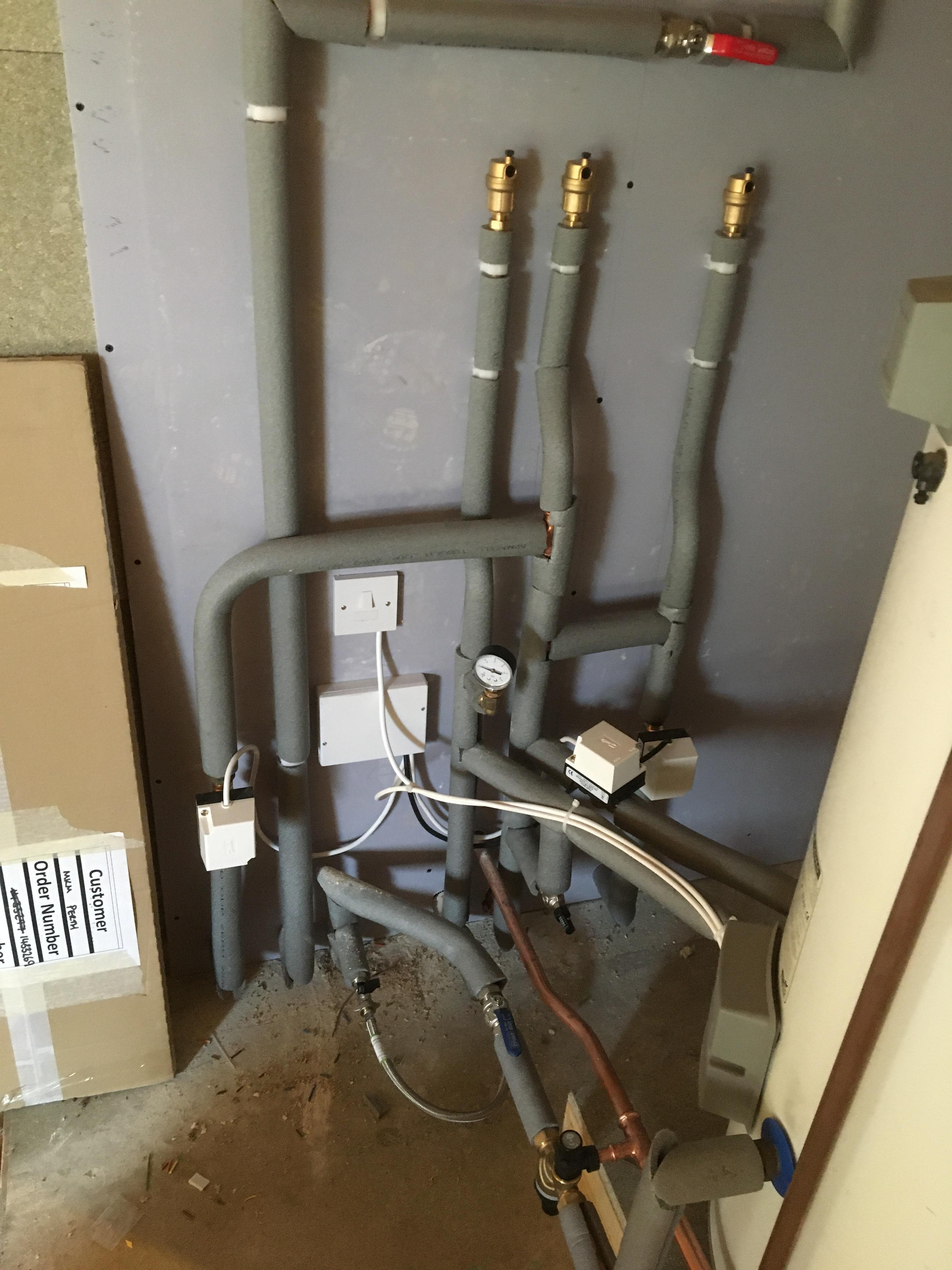

So sparky and plumber both came out, water out the hot tap was 82 degrees according to the sparkys thermometer so he did something at the thermostat and boiler has since started cutting out on its own after about 25 minutes and plumber recharged or set something in the cylinder that had gone wrong he says due to the heat of the water, since he’s done that there is no water running out of the copper pipe that goes outside when the boiler runs. Also the showers seem to be back to original pressure. So all is now good, should hopefully use less gas and can get the solar diverter wired in.
I’ve never used the immersion since we moved in so no idea if it works, it was the red dial that I turned down and boiler clicked of so unless it was just coincidence there may be an issue. I’ve phoned sparky that did the wiring up of it and he’s calling in Monday to check it. Left a message for plumber for any certs I need
presuming the bottom left red dial is stat boiler is wired through as did as you suggested, had hot water on demand and turned dial when on 3 the zone valve clicked and when got to the boiler it was off so presume it is wired properly and that the problem is the stat is set too high? Anybody no what temps the 1 2 3 4 5 relate to?

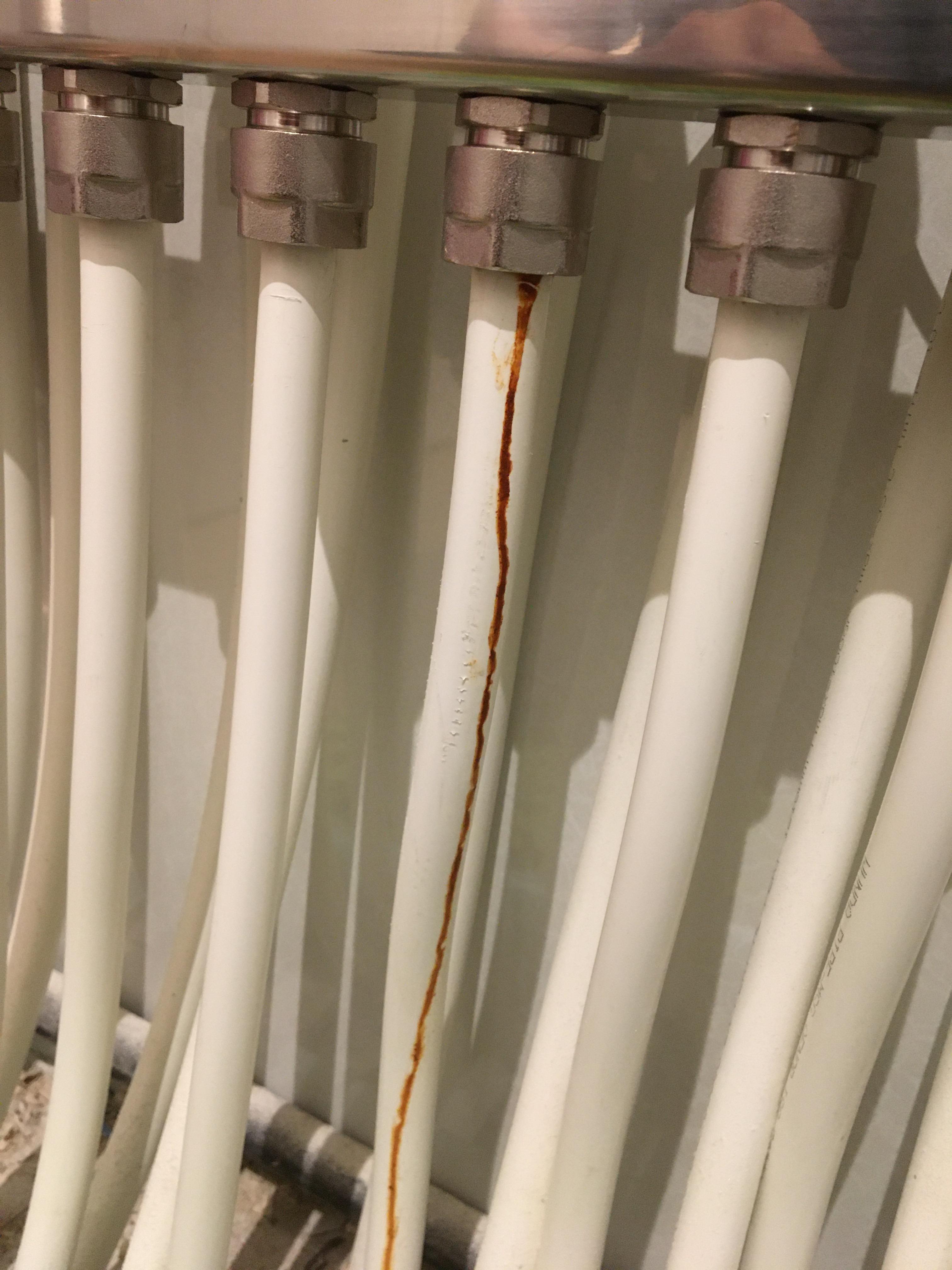

Just checked and not on that one but one is a bit damp at top with a rusty line, should I be worried that it looks rusty??
I asked the plumber what causes it to cut out when temp reached, his reply was the boiler cuts out when it sees the return temp at 70 which is what water should be to kill germs, in practice it’s never cut out unless turned off by the timer

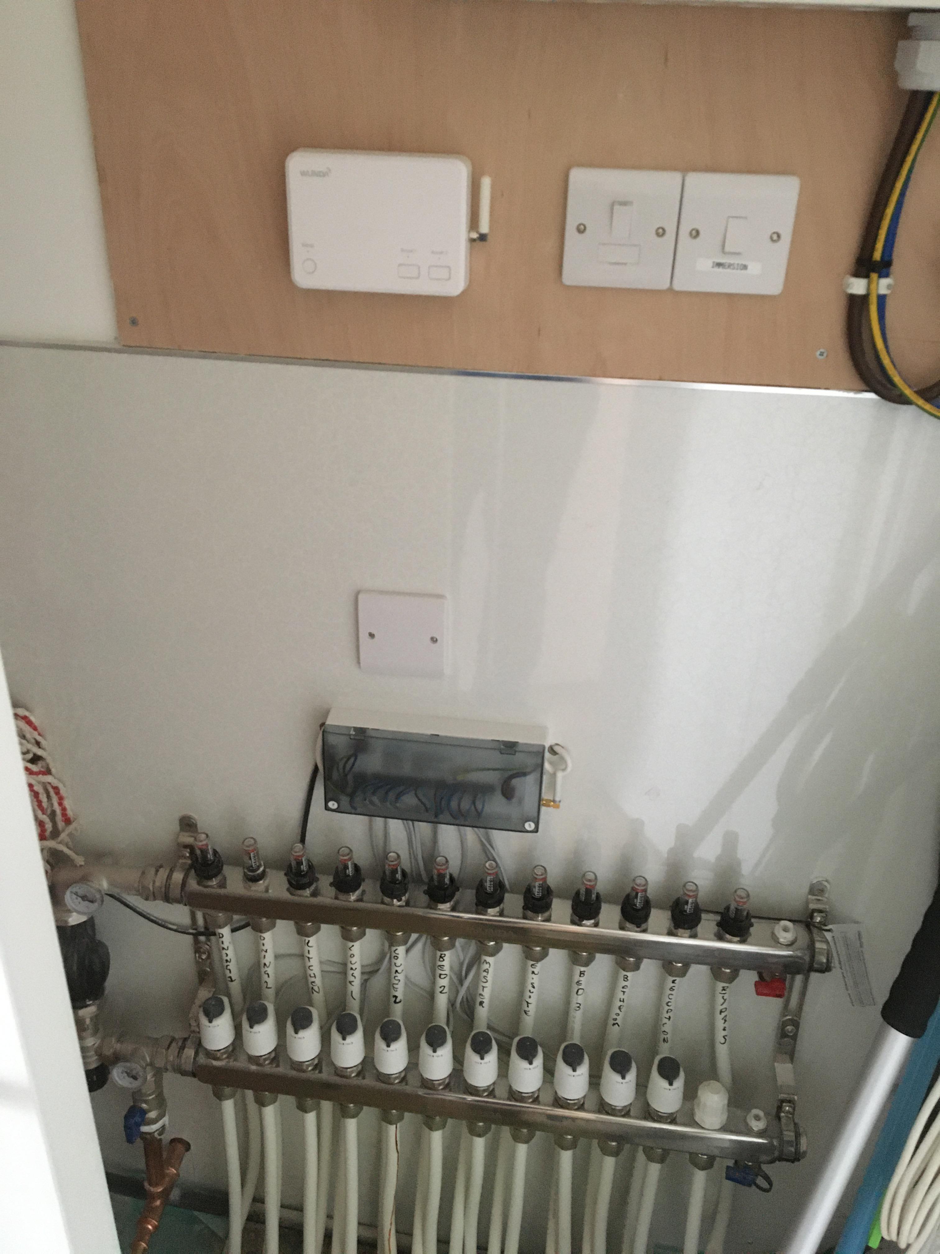

Wunda hub has three channels an each operates one of the valves. Hot water, towel rails, ufh manifold
I could do if I knew how hot the water was but no way of checking other than running a tap. Will add photos of the set up see if theres anything that can be done but without changing away from the Wunda set up I dont think there is.
Hot water is controlled via our wunda smart hub and as far as I can tell the only option is to have it on a timer, there is no way to monitor or control the actual hot water temperature other than the boiler is set to 70 degrees so if the return side of the boiler is at 70degrees it cuts out so in theory if its left on it should keep the water at 70degree but when ive tried this it never cuts out even after a few hours which may be because the tank is 20m worth of pipe away so its cooled enough by the time it gets from tank back to boiler to be below 70 degress even though hot water is now above 70? Im wanting to put a solar diverter onto my solar pv for any unused electric to heat the hot water but don't see how I can stop the boiler firing up on its usual timer settings when the water has already been heated by solar power. Its a gas system boiler and a pressurised 260l cylinder, 4 in the household and currently boiler is on for half hour in the morning and half hour at night which provides enough hot water for 4 showers and normal day to day needs. Also is it possible to have the towel rails which are on a seperate chanel kick in with the hot water?

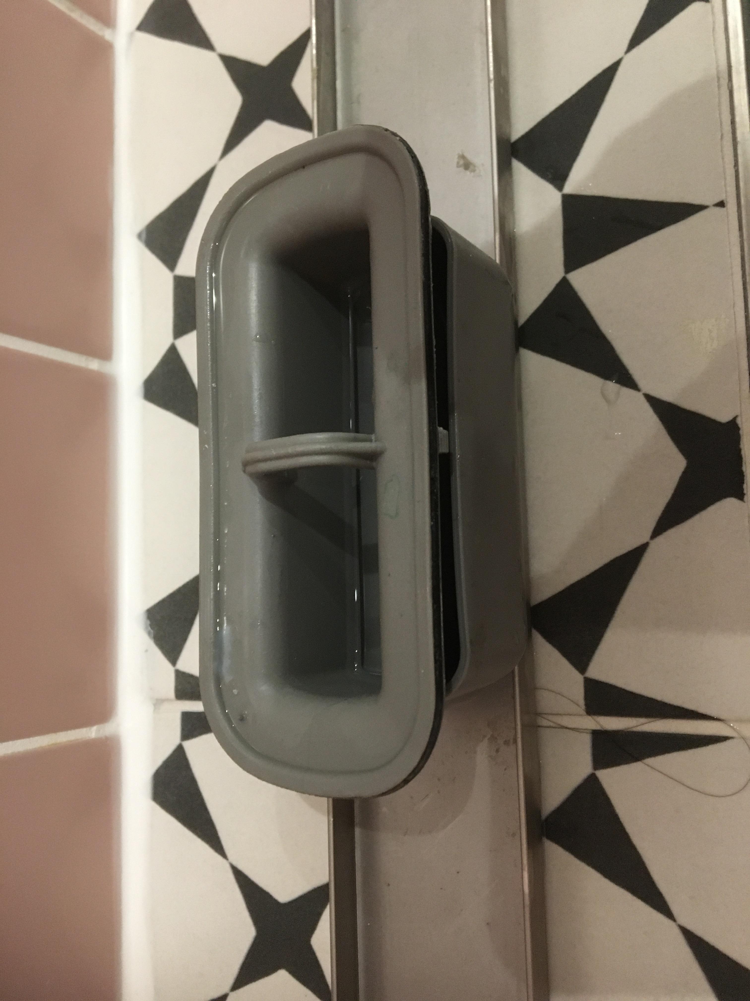

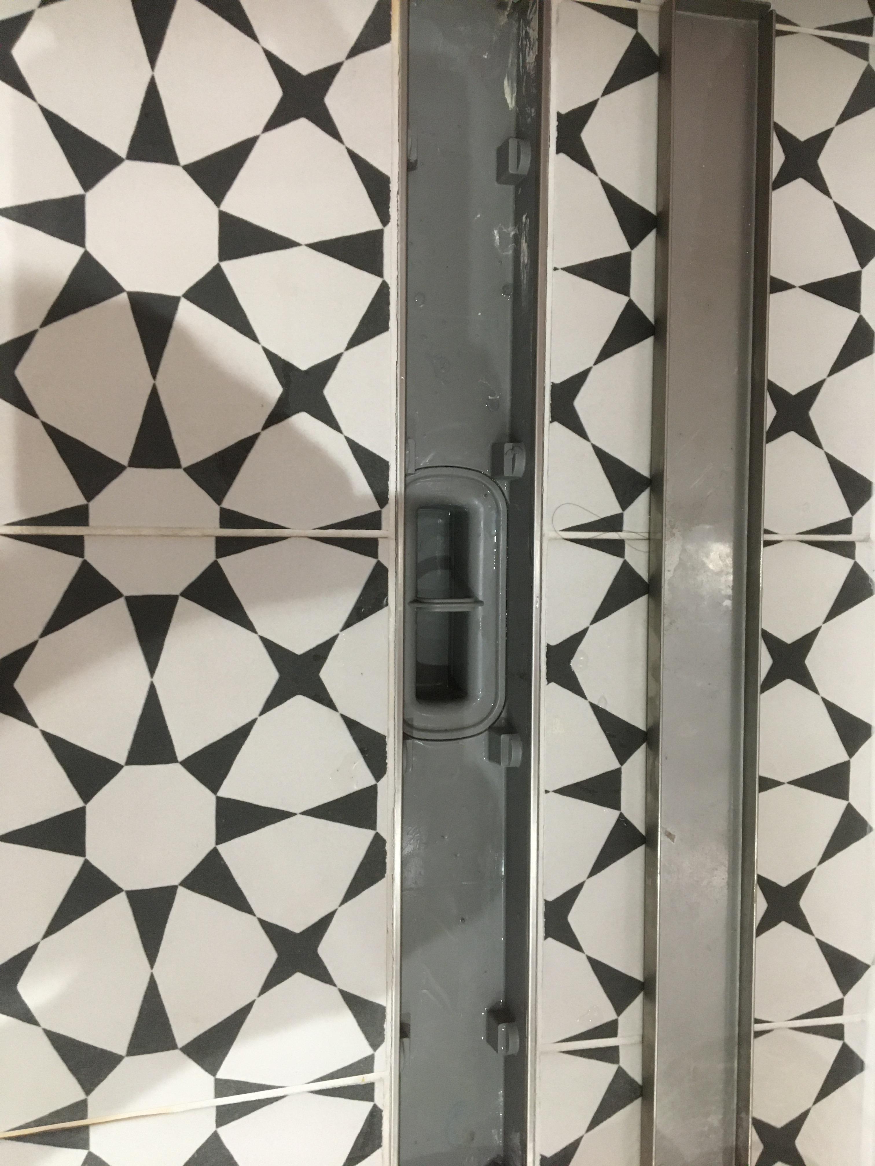

We do but it’s never been on but house is warm and trap only holds Half a ladle full so I’m thinking it must be evaporating as can’t be anything else.

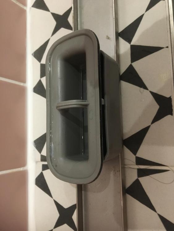

We have been moved in for 3 months now, starting from last week the shower trap has started emptying causing the on suite to stink. It’s a jackoboard linear drain and tray. Even when the house is empty for the day the trap empty’s so cant see it being sucked out and it can’t be evaporating that quick? Also when I’ve pulled the trap out to test it by filling it with water and checking for water leakage thinking it was maybe cracked (it holds water fine) I noticed what looks like a gap between shower tray waste and the cup on the end of the drainage pipe, is that normal or something that needs filled in? What else could cause trap to empty?
