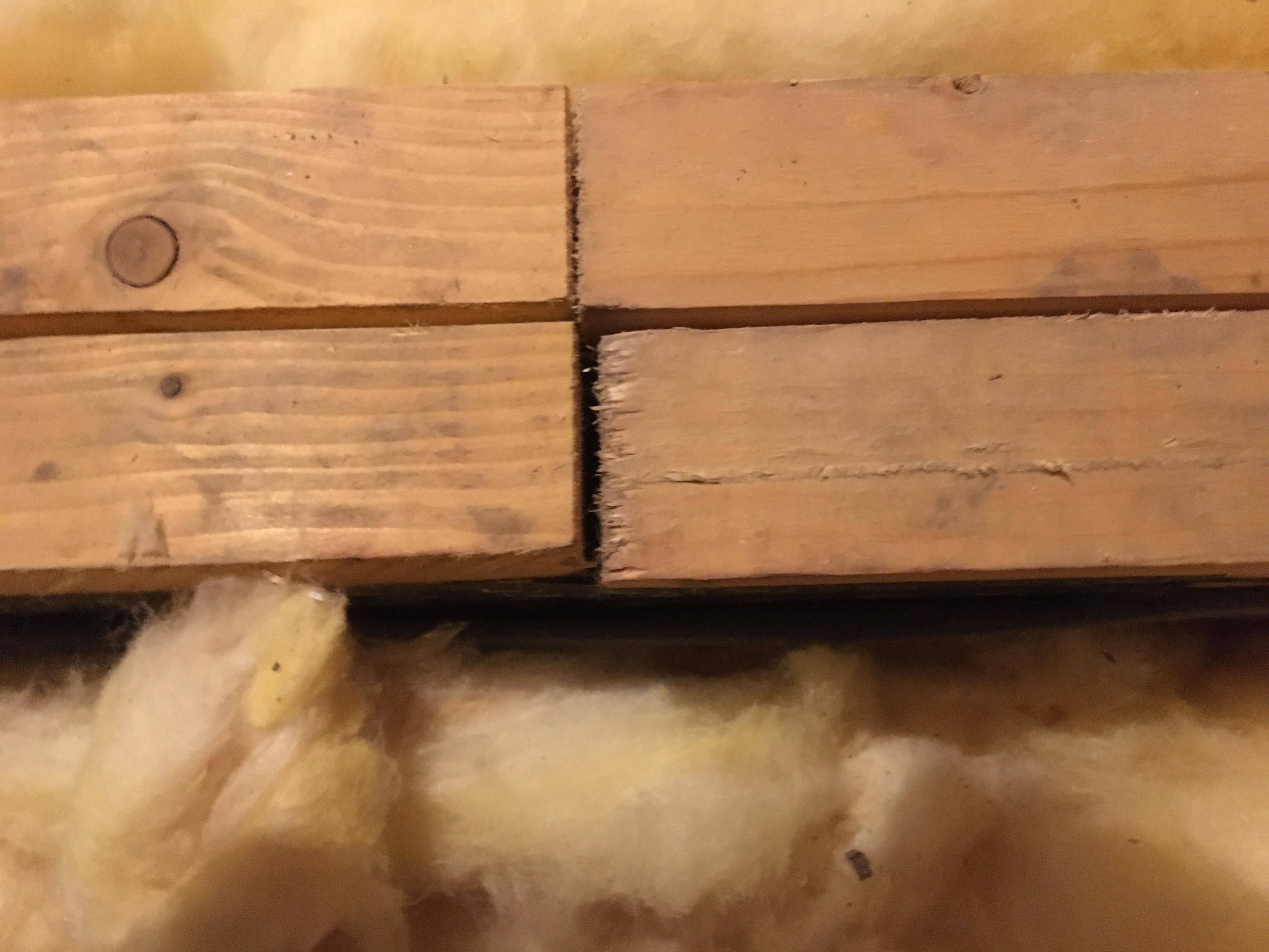

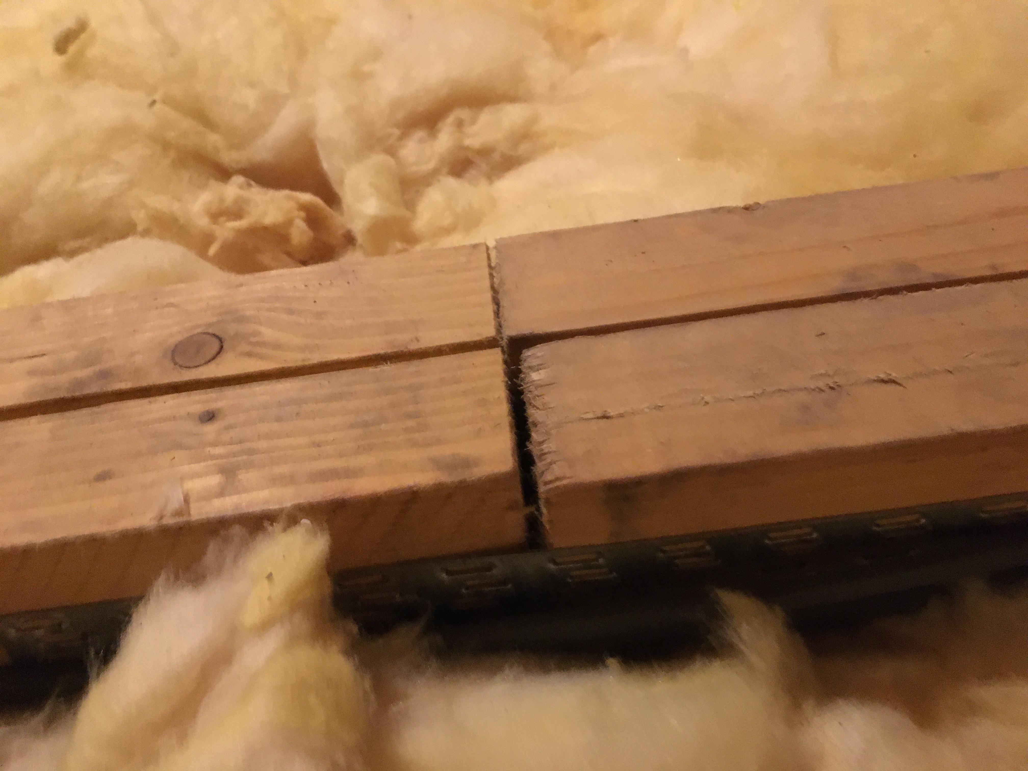

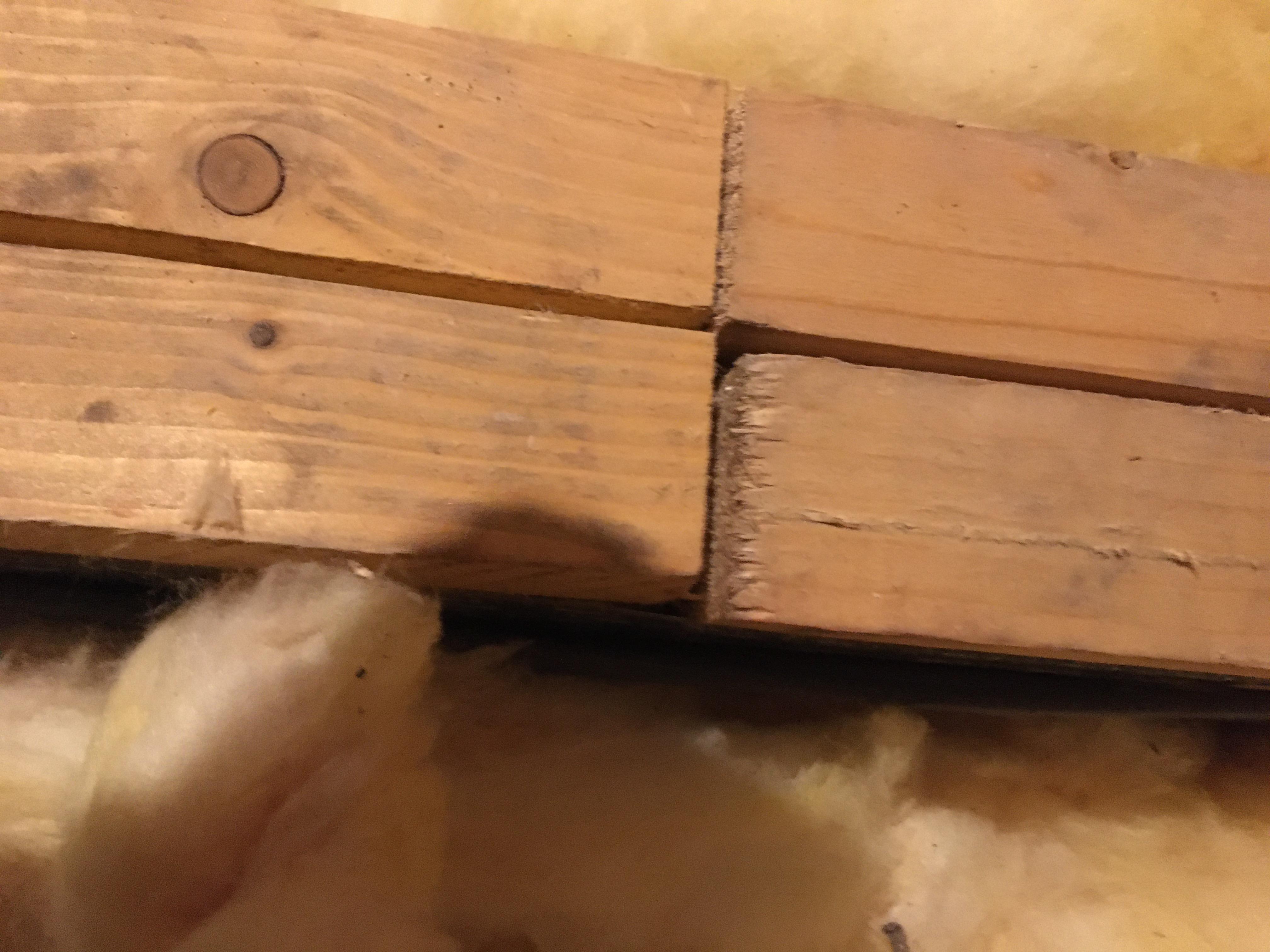

Is this a cause for concern or normal as the timber dries out? It’s on a roof truss that’s doubled up to support a raised ceiling .

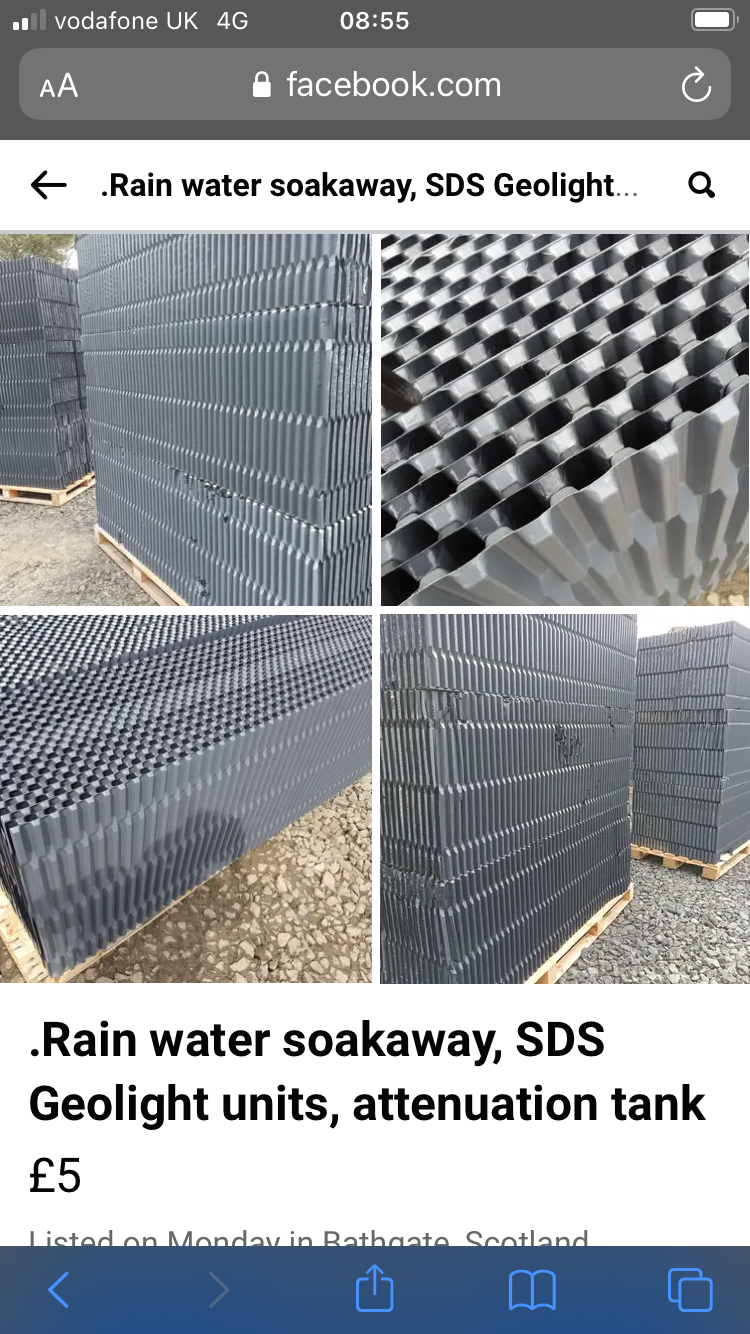

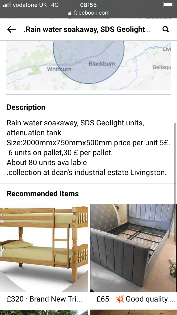

Anybody no if I can use these instead of soakaway crates? I realise they hold a wee bit less than crates so I’d need slightly bigger area but I’d save lots as these seem cheap. Area is going to be grass so heaviest thing on it will be be me sitting on a mower holding a beer.
