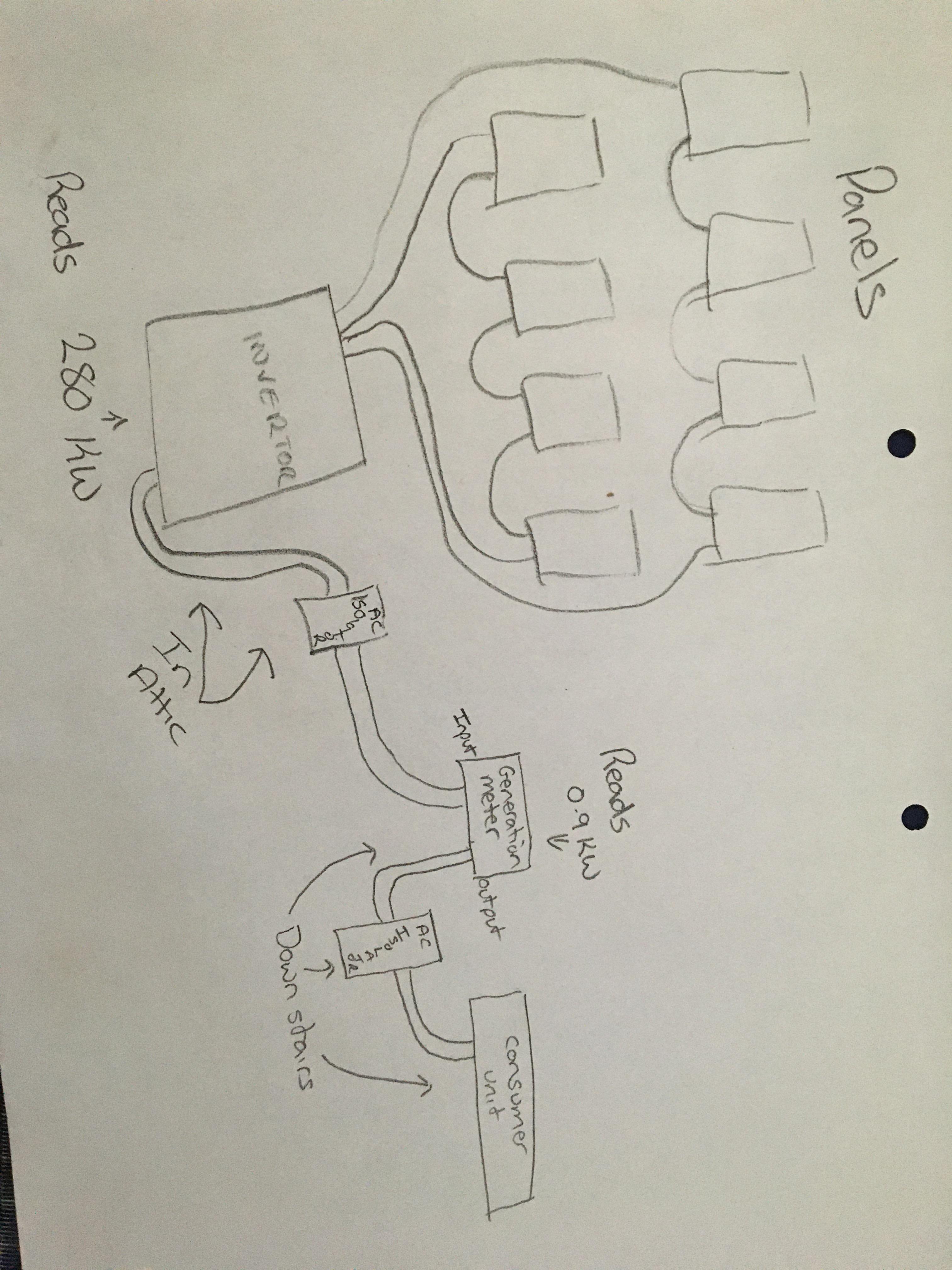

I think that might of been what was happening, I’ve swapped the input and output wires as suggested by a few people and the meter is going up much quicker so thinking it was just wired back to front.
That is how it is wired up. two left terminals are marked input and they are from solar invertor and the two on the right are marked output and they go into the consumer unit.
This is the meter and its wired the input from the solar and output is into meter. So if its reading low on the meter it just means we are using most of what we are producing? Thought that as power needed to 'pass through the meter' to get to the consumer unit so it could be used it would all register on the meter
Our install has been operational for about a month now but im not understanding why the generation meter is reading a total of .9kwh and the invertor is saying we have generated a total of 280 kw. Should the 2 not be the same?

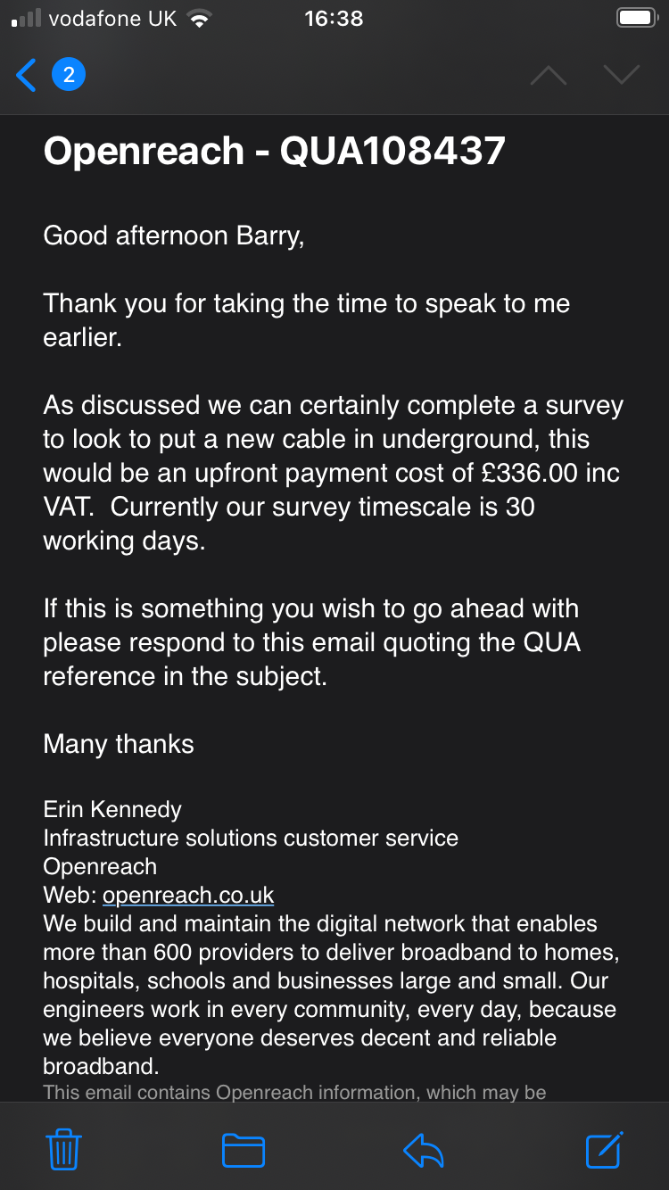

no landline yet, that’s what openreach want £330 to do a survey for before they quote to put in a line. we are using a 4g router in the caravan we are living in just now and will probably just end up using this in the house as well but if there was a grant available to put in a landline we would go for that.
Has anybody used this scheme to help with there broadband connections? We’ve been quoted a scary £330 by open reach just to do a survey after which they will give us a price to get a line to us. The r100 voucher scheme says it will provide help to get broadband to places there’s none but I can’t understand from there website how to go about applying.

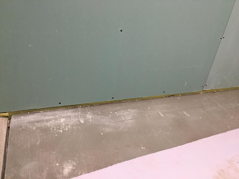

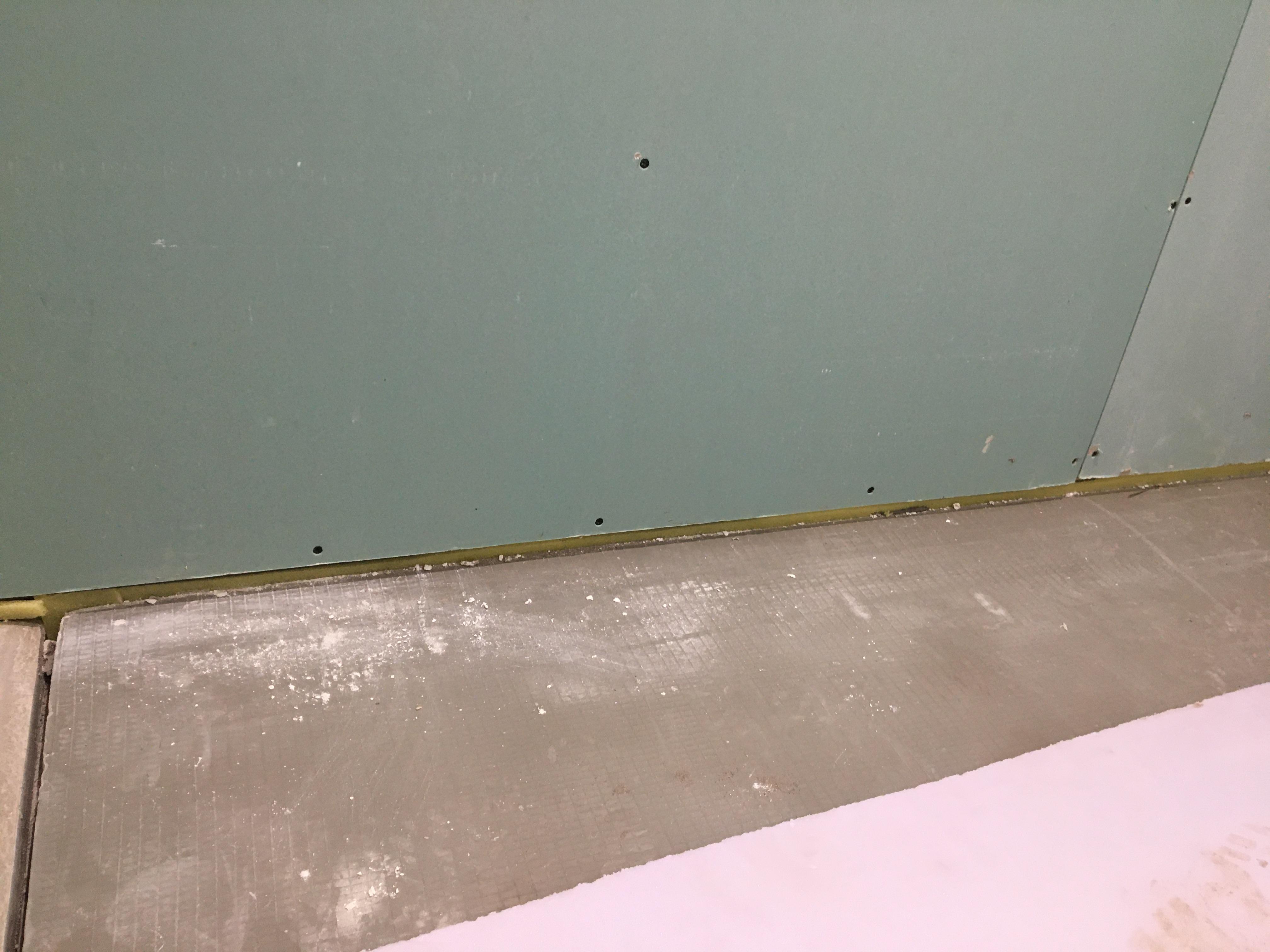

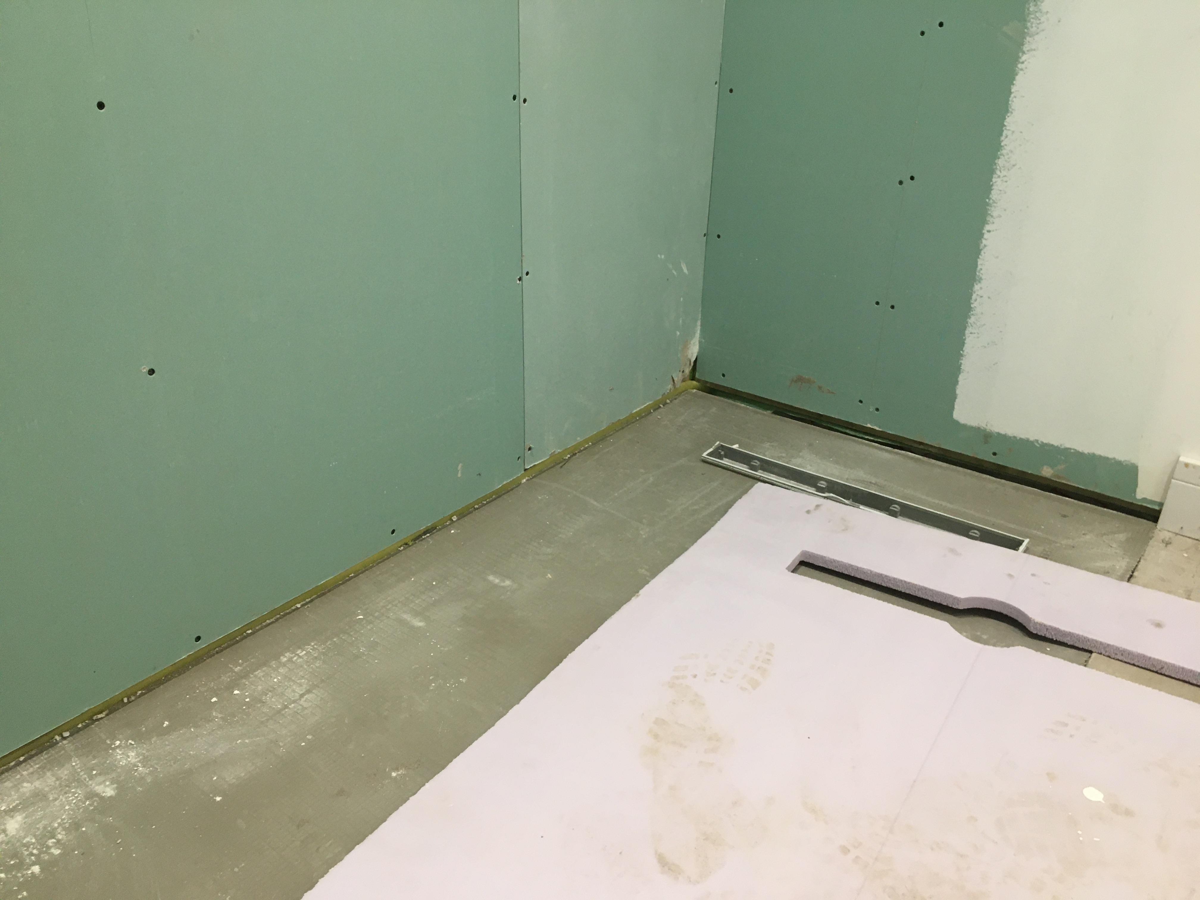

Left it to the tiler to do and he filled it with a foam then cut it flush before tanking it. -
What would you use to fill the gap between floor and plasterboard before tanking the tray? Just some expanding foam?
