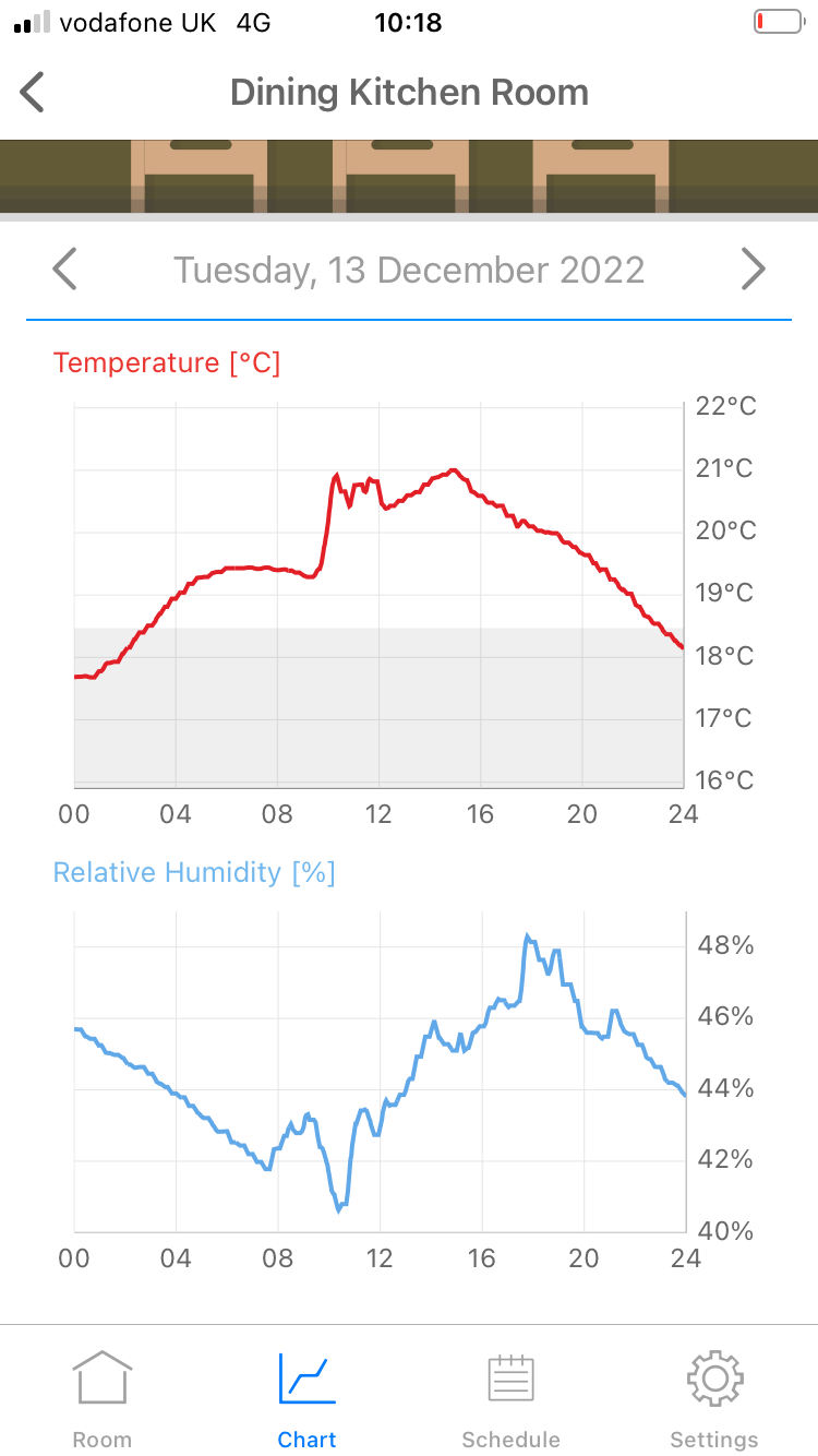

We are having the same issues and seems changing flow rates, boiler temp, blending valve temp makes no difference to how much gas we use or the spike in room temperature. I had a stat in each room but have now put the beds all on one, the kitchen, living, dining on one an bathrooms on another and just leave them set at 18 degrees. When each room was on its own stat it seemed like the boiler was constantly running. Boiler cuts out at 18 but some rooms still spike at 21, house temp is constantly fluctuating would be nice to get it to just stay at a constant temp. We are using less gas (still £170 a month) now we are just on the 3 stats and leaving them on a set temp instead of playing with them.

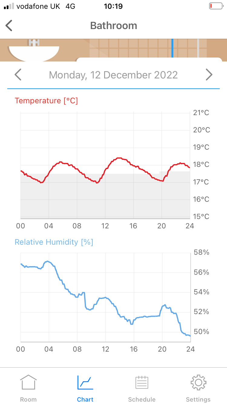

They haven't but maybe because there is two towel rails that have there own port that comes on with the bathroom stats and needs the higher temperature? I will lower the temp on the mixer on the UFH manifold and see if it makes any difference, also the return temp was the same as the feed after the boiler was on for a while so does that mean I need to turn the pump speed down so the screed has time to absorb the heat?

I have no doubt that if i let the boiler run longer we could get the house proper toasty, was often into the mid 30s during summer, sun makes a huge difference to the interior temp bit its been lacking this last month or two. No heat loss calcs done nor would I no how too
Alpha tec 20kw system boiler, wired S plan
So turn the temp on the mixer at the manifold down to what temp? Would that not just take longer to heat up and the boiler run longer?
Not alot if my house was warm but at least 60% of the 4 week period my house was below 16 degrees. Don't no the kwh or unit rate but my bill after submitting a reading was £202.54 for 4 weeks
Not really used our heating up till last month and we have managed to use £200 of gas in 1 month and that is with only occassional use and the stats set to 16 degrees when turned on. It seems to take around 2 hours of constant boiler running before the temp starts to lift from 14 degrees then another 2 - 3 hours to get to 16 degrees. Boiler then cuts of and temperature continues to rise to a minimum of 19 degrees which is a fine temp for us. Heating is then switched of untill it gets proper cold in the house a few days later and again switched on till it gets to 16 degrees. 20kw alpha gas boiler 55mm of cemfloor screed with 120mm insulation under it. Is it normal to take so long to heat up? Am I cheaper in the long run to have the boiler running more regularly rather than the slab cooling right down? Boiler is set to 65 degrees, flow at the mixer on manifold is 45 degrees, pump is on number 3 and flow rates are all at about 2.5l a minute, is this as it should be? Its a new build and achieved a low A EPC rating so thought it would be way cheaper and easier to heat than our old stone cottage Looking to install a stove as we have free wood but not going to happen for a few months yet due to a design cockup

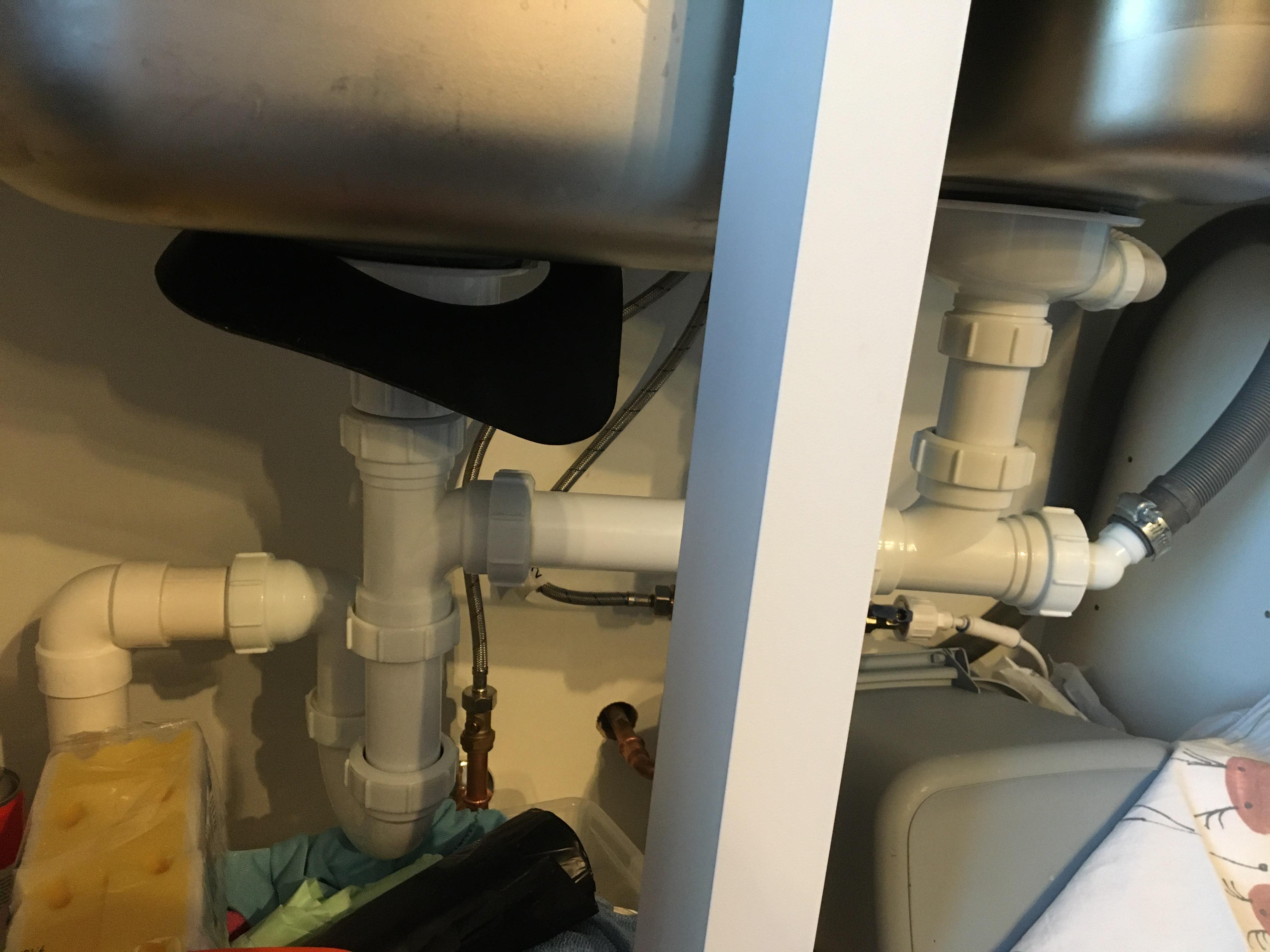

Cupboard under the sink is very smelly, same smell briefly comes out of the sink after it’s been drained. Thought it must be the dishwasher pipe as it’s in before the trap but it doesn’t smell. Took all pipework of an cleaned (wasn’t dirty tho) an smell still present, u bend was full of water so working. Took kickplate of an no smell under units. pipe goes into a 110 pipe in the floor then out of building, only thing in that leg of sewer is kitchen sink an dishwasher. As it’s smelling In the cupboard all the time does it have to be the pipe before the u bend causing it? Crack or bad seal?
