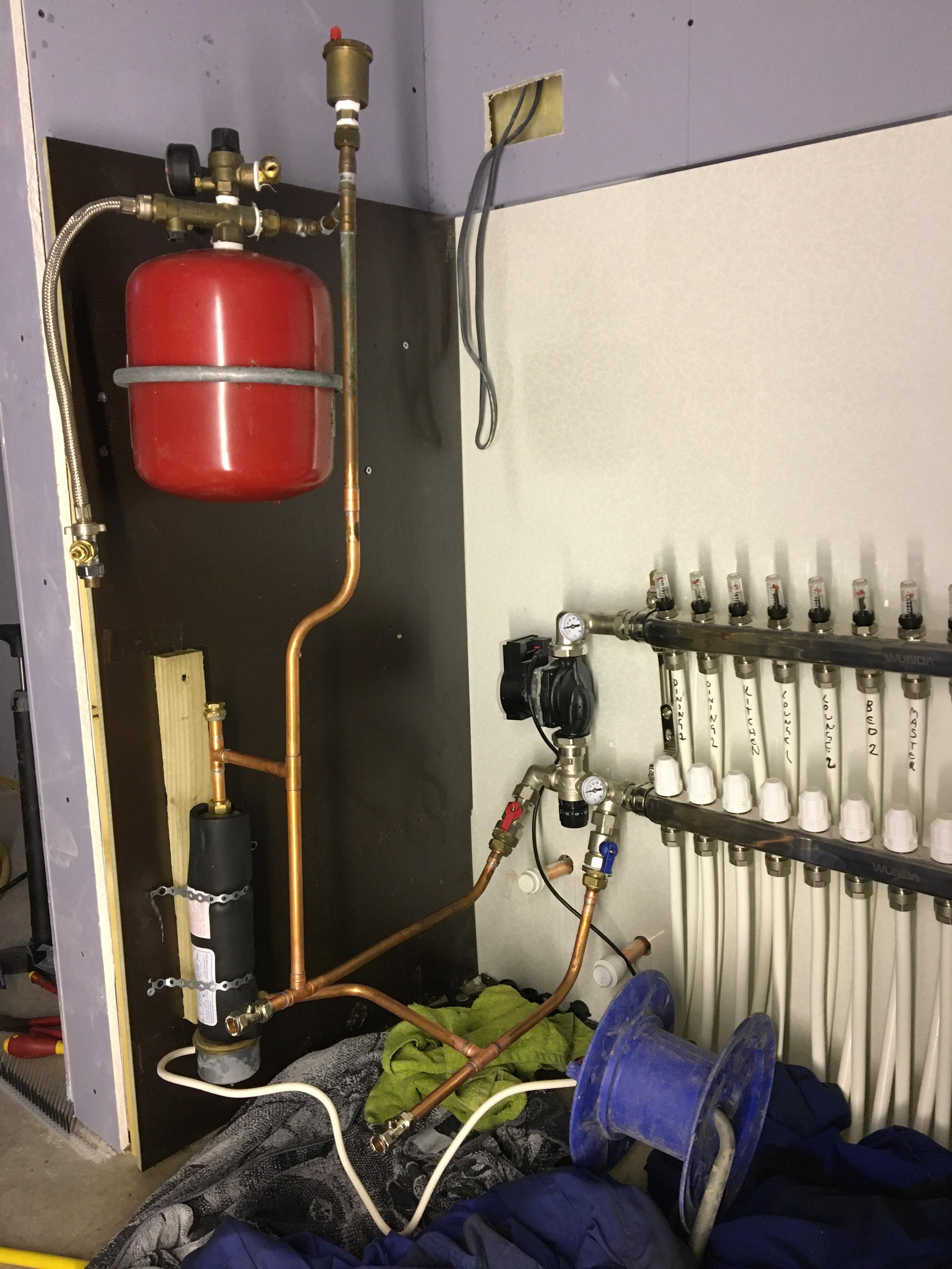

I was sceptical that the wee heater tube would make any difference to the heat of the house as was the joiner, builder n sparky however it’s currently -3 outside but inside the house is now 13 degrees and now that I’ve turned the flow valves down it has raised the input temperature to 35 degrees so I expect the temp to raise further in the house. So for the sake of £40 buy one. remains to be seen if I still recommend them after I’ve had my leccy bill tho.
I get that it’s a bit risky but in this instance I’ve got to go with what I’ve got for the time being, if it works an house gets warmer I will run another larger cable into house
I was going to pipe the prv to a bucket but it’s set at 3bar and I’ve got it running just under 1 so what’s the chances of it blowing? It’s 13amp fuse, no power in house yet so extension lead is all we’ve got but been on all night and only a little heat in plug so sure it’ll be fine…. Hopefully it is only very temporary. The plan was to wire it into an imersion timer, on a few hours n off a few once there’s warmth in house anyway point to doing this is house is getting taped n filled starting next week and we need warmth. I’ve had it on all night and the flow temp is only up to 24 degrees and the return is 12 degrees. Should I be turning the flow valves down to get the flow temp up or will it eventually warm up? I have the pump on its slowest setting. It’s warming up 70mm of cemfloor and it’s frosty outside
Anything obviously wrong other than the dodgy wiring? Should I have the flow valves all fully open? Think I’ve finally got all the air out so how long before it starts to show heat on the return side?

I decided for the sake of £40 it’s got to be worth trying so I’ve ordered a Tesla version of the Willis heater. I have an old expansion vessel with filler, bleed point etc on it and the pump is on the ufh manifold. Once I’ve plumbed it up, bled it any suggestion on pressure? Turn the pump as low as it will go and just leave it and heater on 24 - 7? There’s 160m2 so presuming I won’t need to worry about thermal cut outs? Any idea how long it will need to be on till we see any heat in the floor? Any advice welcomed
Can you send me a link for a wills heater, had a look but can’t find anything, ta
Taping and filling meant to be starting next week and would like to get some heat into the house. Has anybody plumbed anything into there ufh pre boiler install? I’ve seen the portable electric boilers but no hire company near us does them. Would a 3kw hot tub heater do anything? Any other easy options? Have a few electric heaters in there now but not really doing much. Our ceiling plasterboard also sat outside for a month and although it looks dry it’s bound to have a bit of moisture in it so another reason to get heat inside if possible
