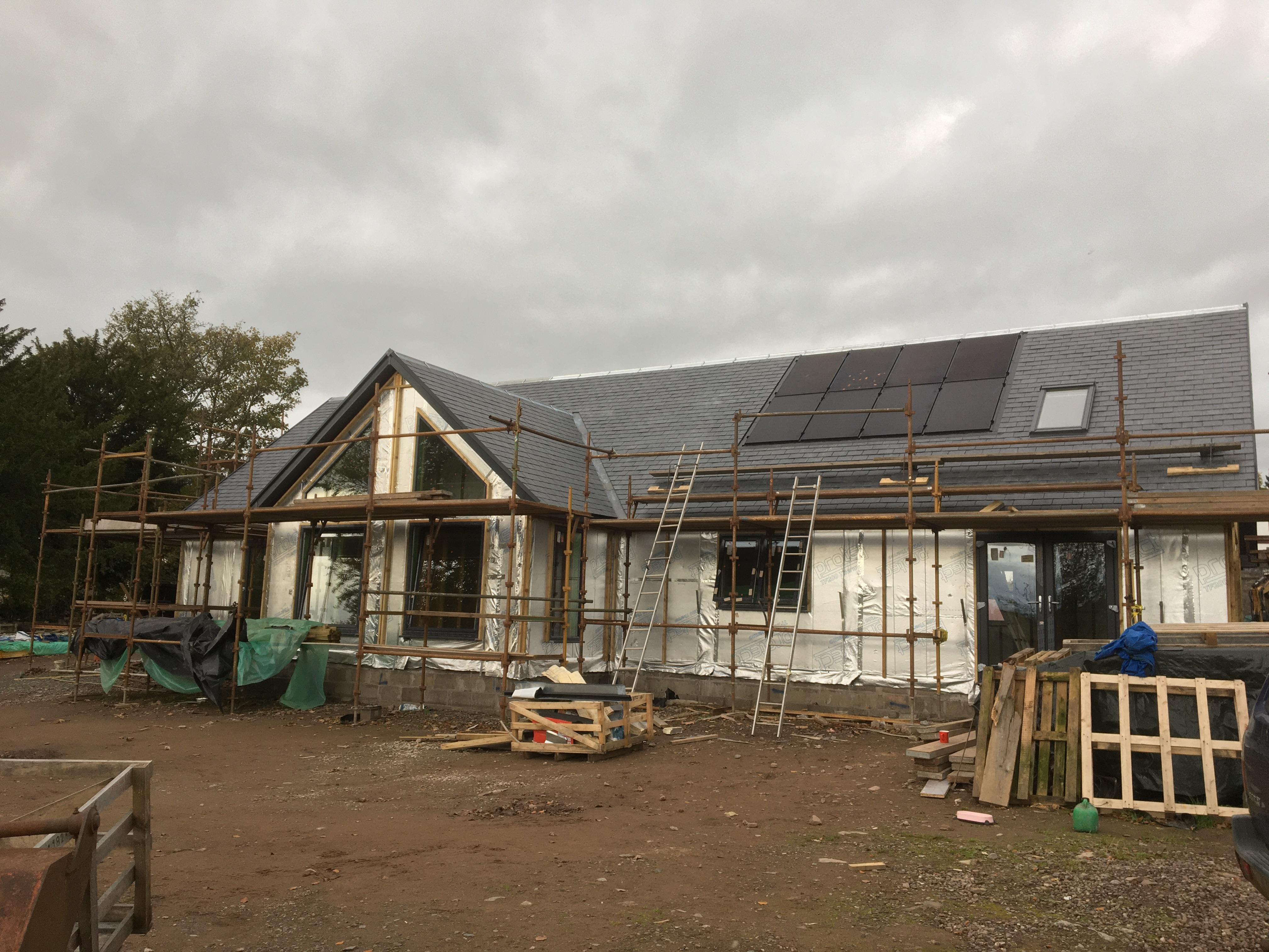

  23. Our kit didn't come with top or bottom metaL flashings just a roll of roofflex 330mm wide flexible sealing strip and a roll of deks fast flash 280mm wide. Anybody else use this instead of metal flashings? Which goes top and which bottom?
  24. If I strip the sarking away I'l be left with nothing but trusses and a giant opening straight into my attic space. Will speak to company that suppled the kit and the roofer, see what they recommend
  25. I'd thought if I made a frame from 25mm tile batton it would get it up enough to run the cables and wee bit of ventiliation to the panels, Then put a bend to suit the extra height in the lateral flashing. Would be alot easier to mount it straight onto the roof tho.
