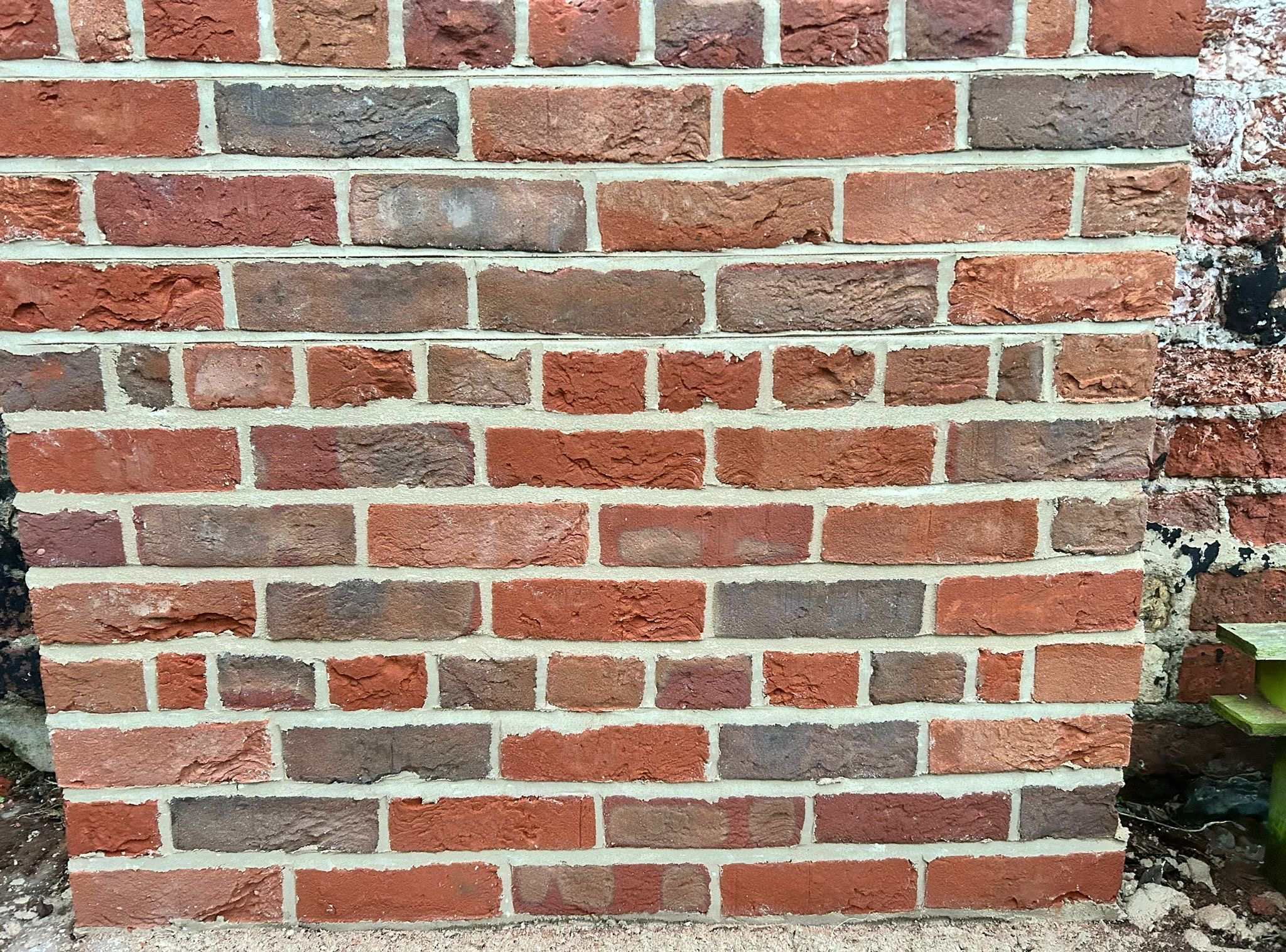

Red/Brown/Buff bricks
BadgerBodger replied to allthatpebbledash's topic in New House & Self Build Design
I think this is their budget (cheapest) brick but not entirely sure, my builder reckons he might be able to get seconds to mix in to reduce the cost. We’re happy to use seconds as it’s up against a 170 year old brick barn so there are quite a few less than perfect bricks in there. -
@Post and beam I like this brick a lot. How much we talking? -
