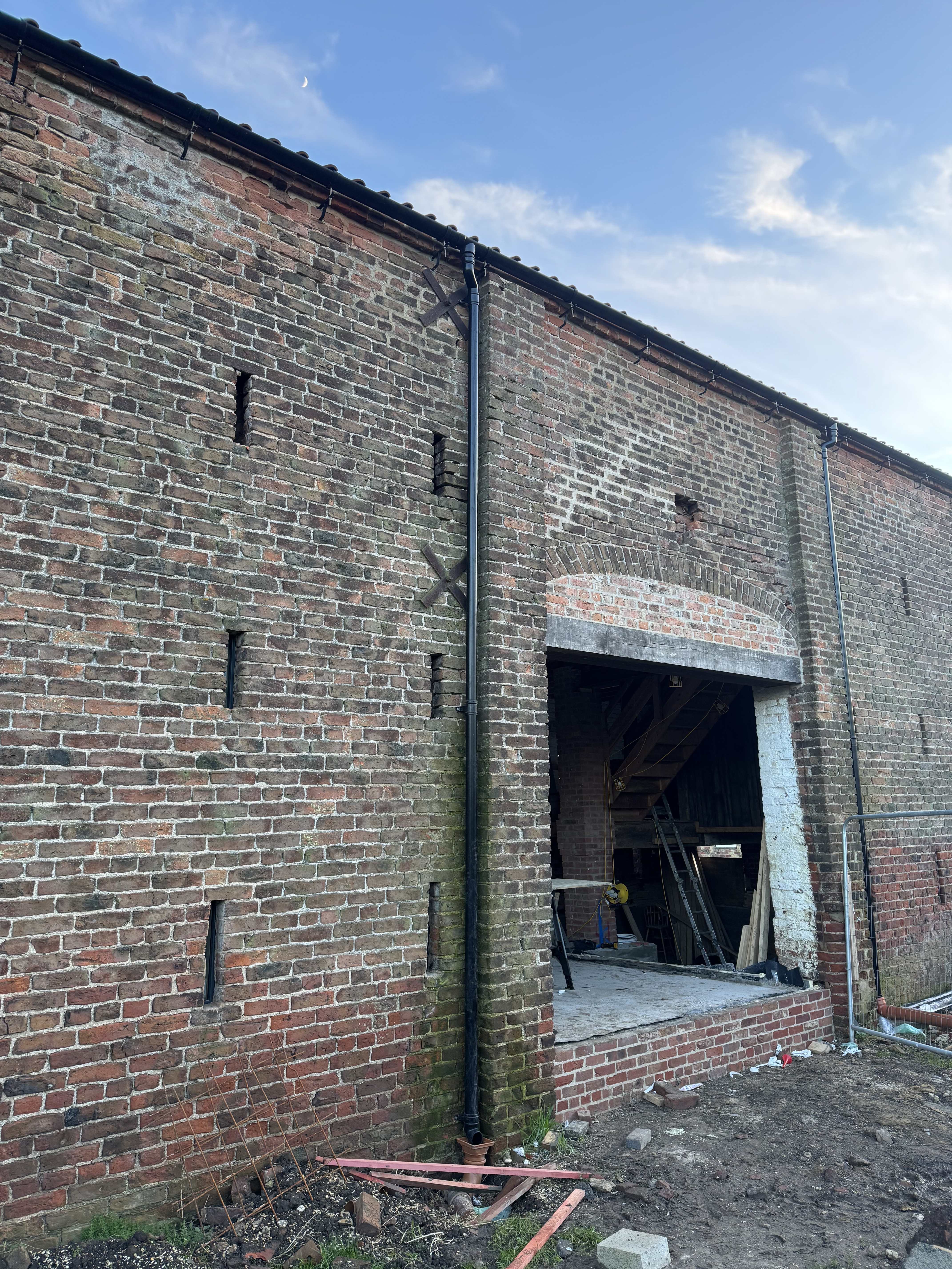

Longevity, they say 50 years+ (more with maintenance) mine was mandated by the conservation officer (listed building) I wouldn’t have used it if not. Material cost - £6,500 +/- if I recall. 70m 125mm 1/2 round with 40m downpipe inc brackets, fixings etc for cast effect plastic you can half that for straight plastic less than half again -
Aluminium guttering/downpipes recommendations?
BadgerBodger replied to Chris HB's topic in Rainwater, Guttering & SuDS
yes. In time. The quotes for pointing were wild. (380m2) so when all is said and done I’ll see what’s left and see what the best way of going about it is. likely nothing in left in the pot so it’ll be time to learn how to lime point. When I chose my scaffold tower I had this in mind and got something to reach everything. I’ve had the tops of the gables done while I had a scaffold up for the roof. I’m in two minds about this. it would essentially make the barn look a lot cleaner but it would also turn it bright red and, I think lose a lot of character. It’s got a burnish to the brick l, whether that’s age and „pollution” or how they were fired, I don’t know but inside the building they’re solid reds. I quite like how you can see how the old buildings abutted from the paint on the outside (which would have been in) I think I’ll just wire brush the most offensive areas as I point it. You can see the gables look great without -

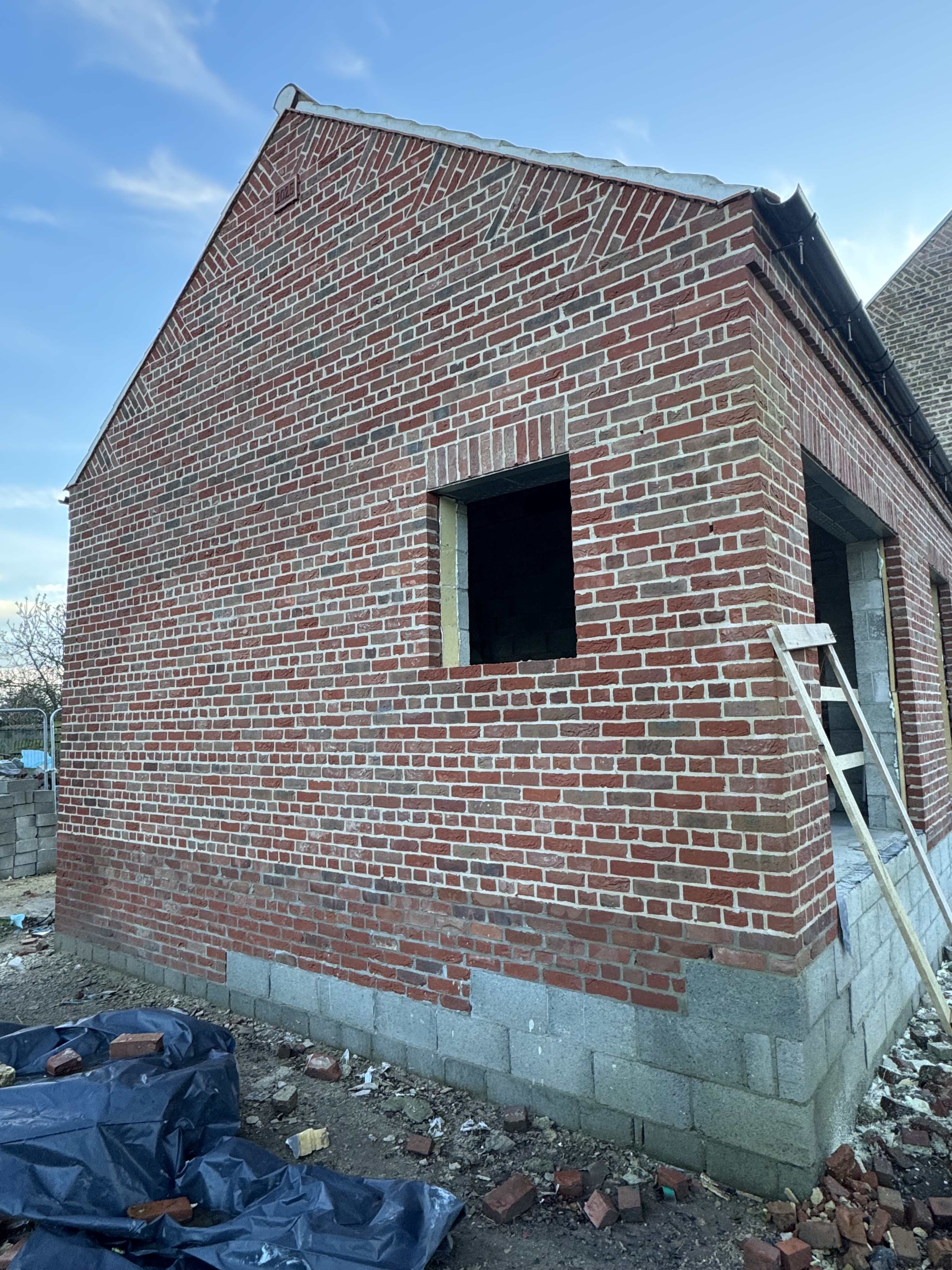

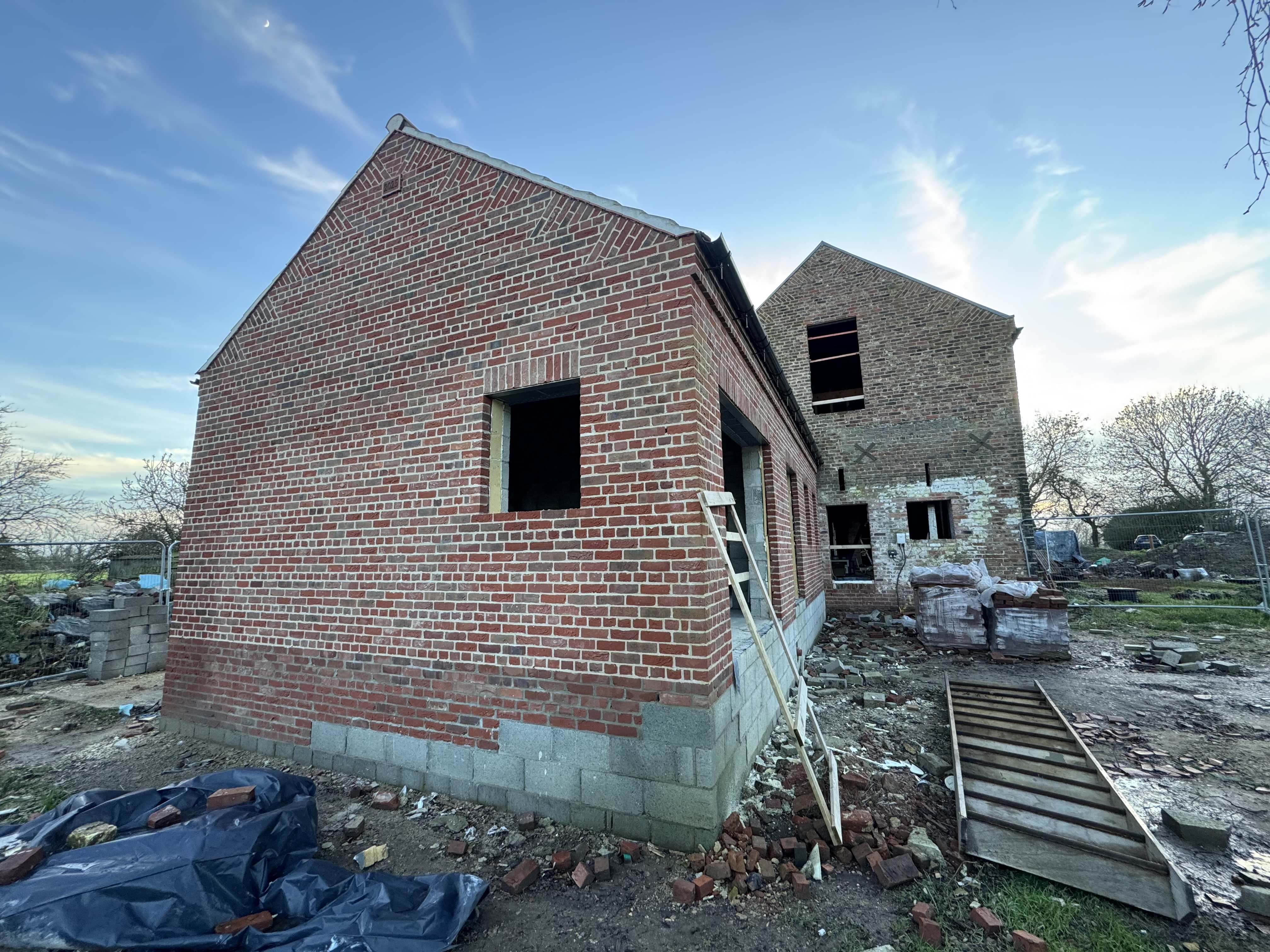

I’m so happy with they way it turned out. absolutey worth the small extra cost. you can see the below ground in OPC instead of white cement and the difference the white mortar makes -

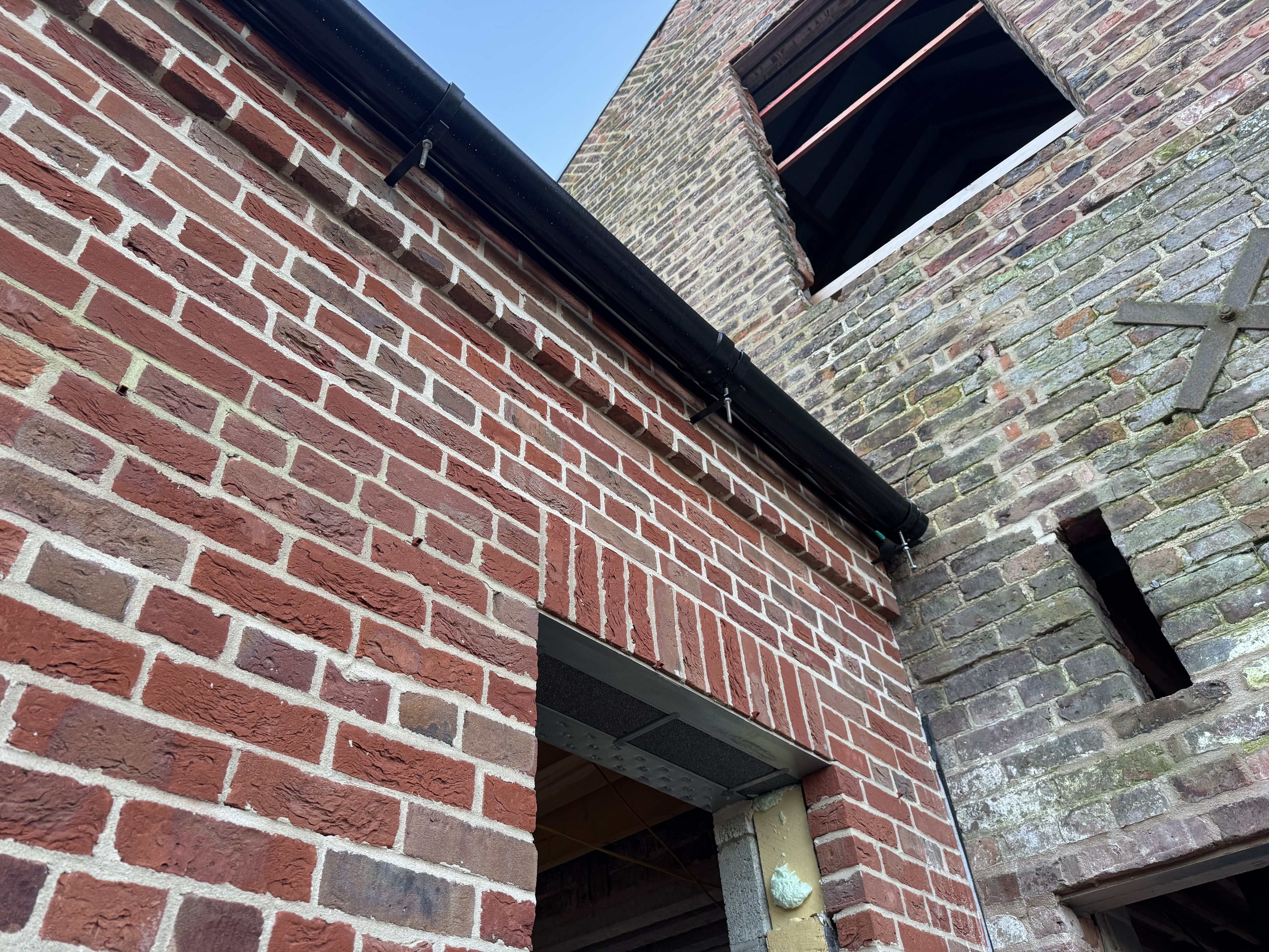

Better later than never. don’t mind the green, that’s on me for not connecting the bottom section for a month. -

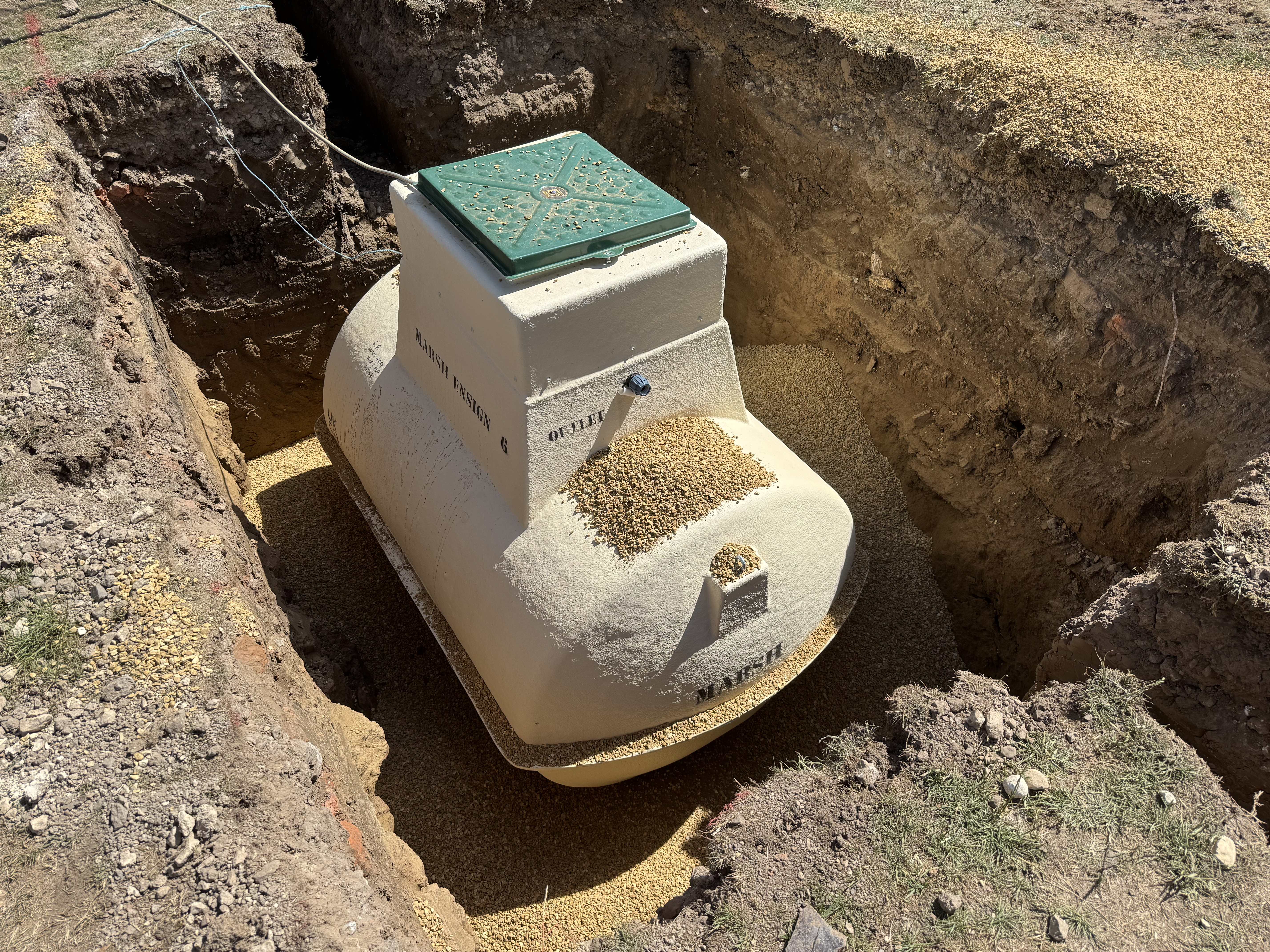

@saveasteading the bigger hole point is a good one, I spent another couple of hundred on the gravel backfill because of the over dig. Only by 250mm all sides due to exposing for archaeologist investigation and relief drawings but nonetheless… -

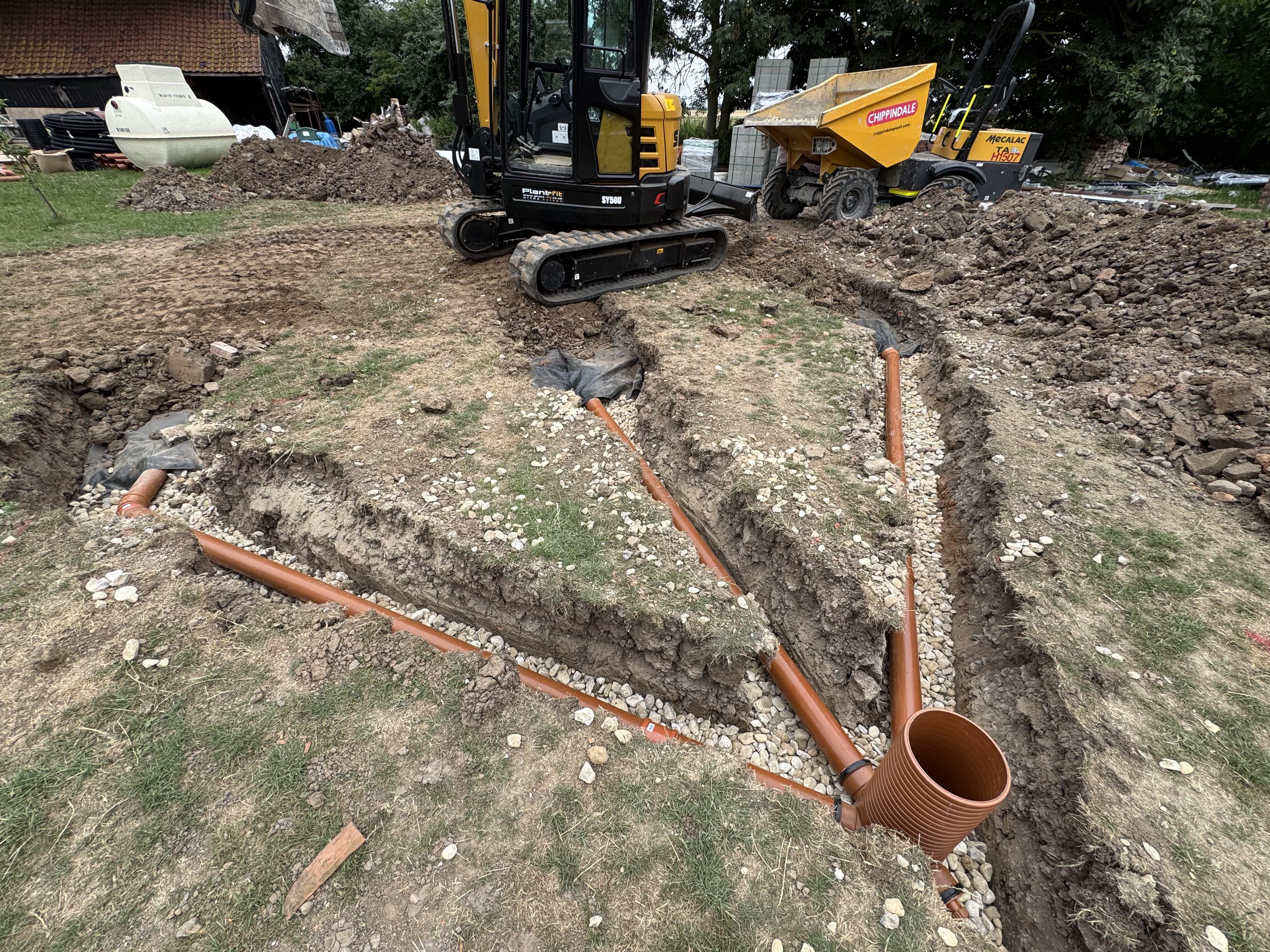

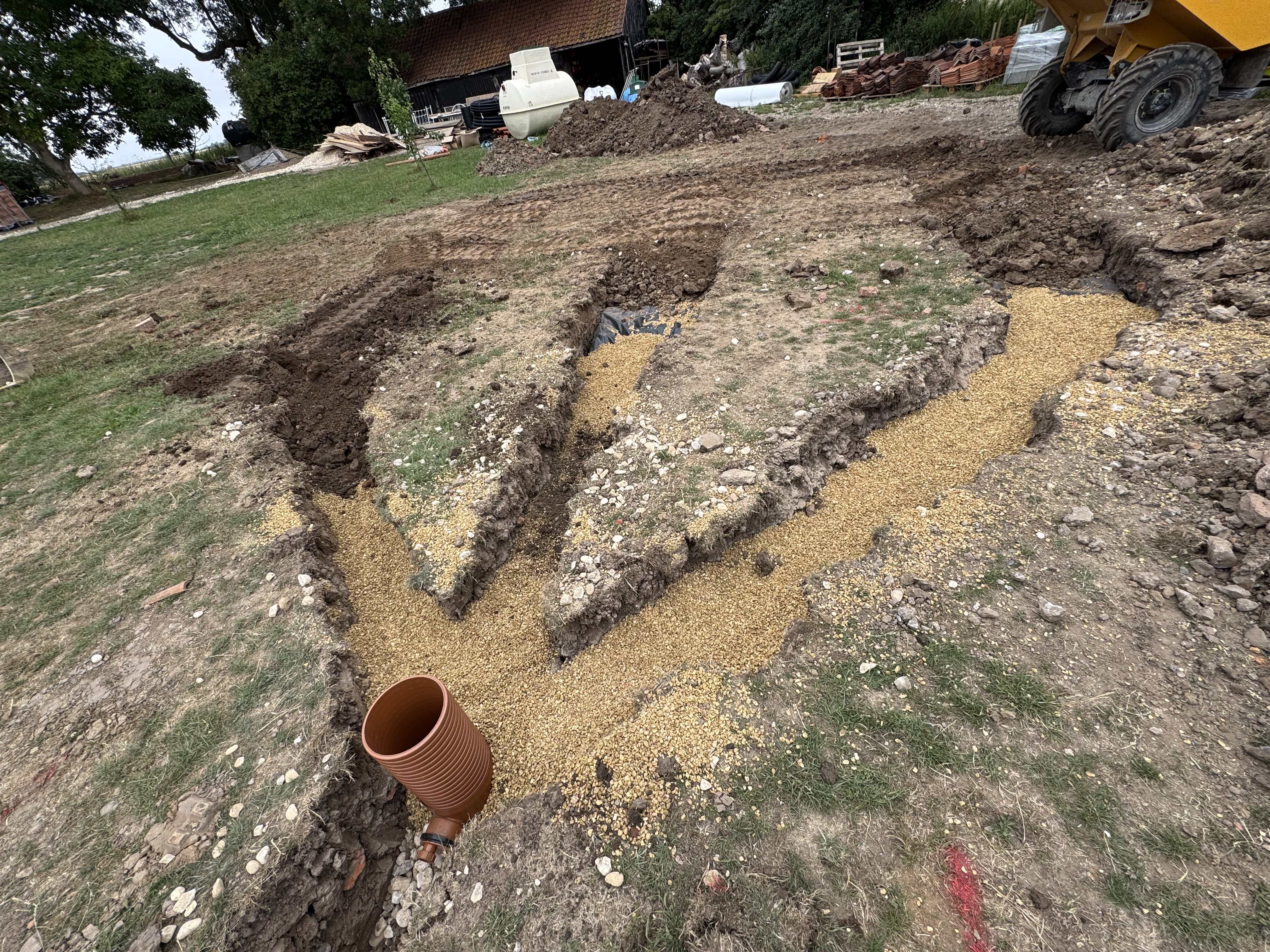

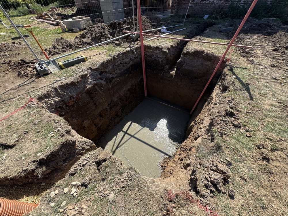

Nice. I like that so many people see the same opportunities. STP install is very easy. Same for drainage field. Wouldn’t like to do it at this time of year though. Hate claggy boots. Here’s mine with drainage field. Marsh ensign pumped so I didn’t have such a deep drainage field. 3 days on the hottest day of the year. digger, dumper, driver, plant, materials and yours truly just under 5700 not much better than muddy boots really! -
