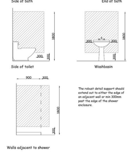

  1. One wall is a partition which is open on the corridor side for plumbing/wiring to go in so I can fit the ply in from that side with battening around edges, no problem. One side of the WC and 2 sides of the shower are on outside walls and have been p/boarded - it's just those that I'd like to confirm really need re-doing.
  2. Yes but I need to know the answer because the plasterboarding has been done in error without any in place and I am trying to minimise the disruption and cost of undoing the plasterboarding to correct. Really I want to save opening one of the shower side walls and maybe the shower back wall, where there is little point in having it as a grab rail would never be useful there, I think.
  3. Does anyone know if the requirement in Scottish regulation for reinforcing timber stud walls with plywood (eg. behind plasterboard) means it should be on both sides of the shower and WC or just on one side is sufficient? The regulation - 3.12.3 Accessible sanitary accommodation doesn't specifically state both sides.
