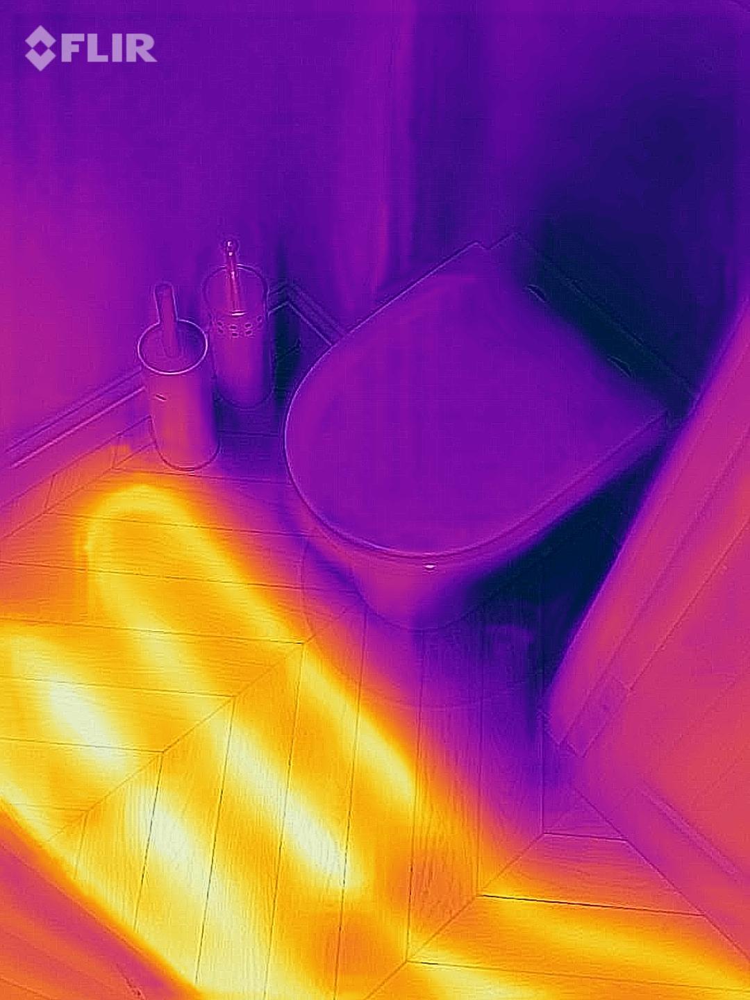

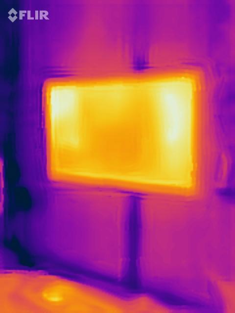

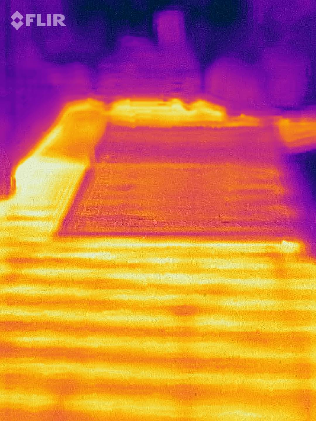

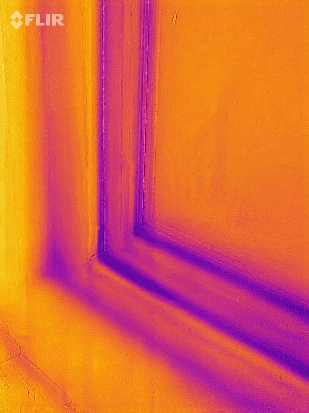

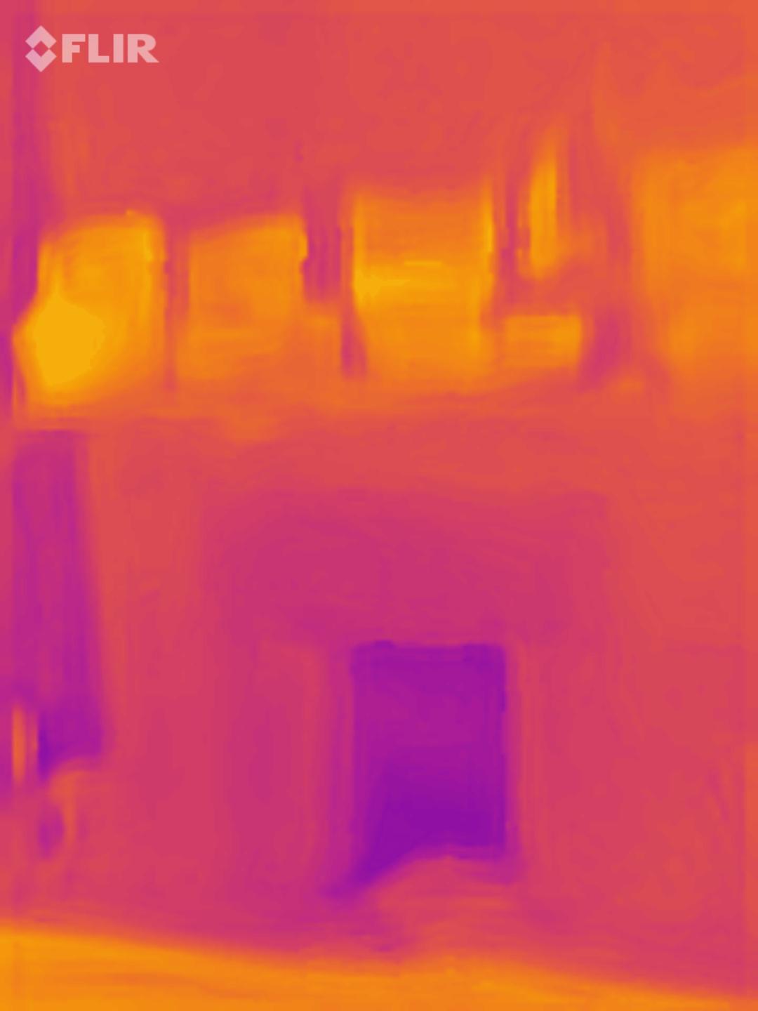

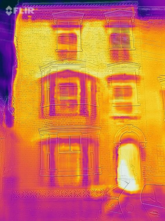

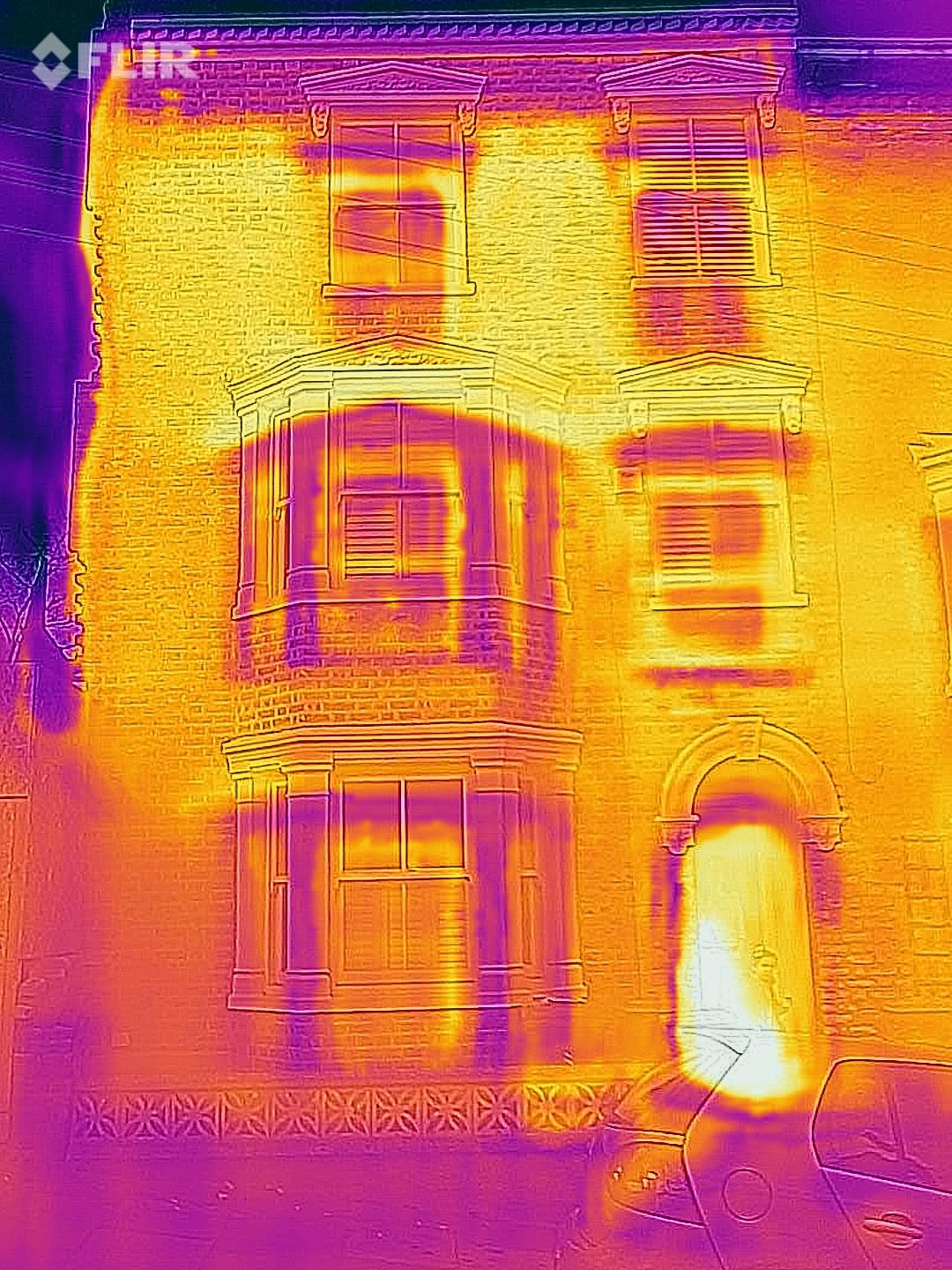

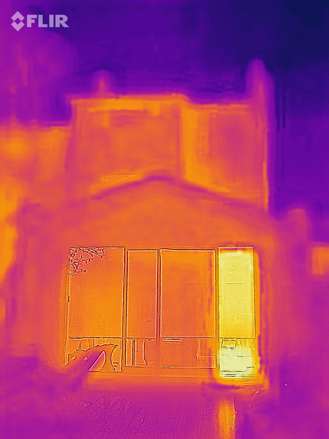

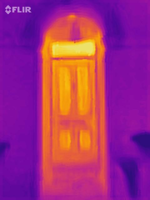

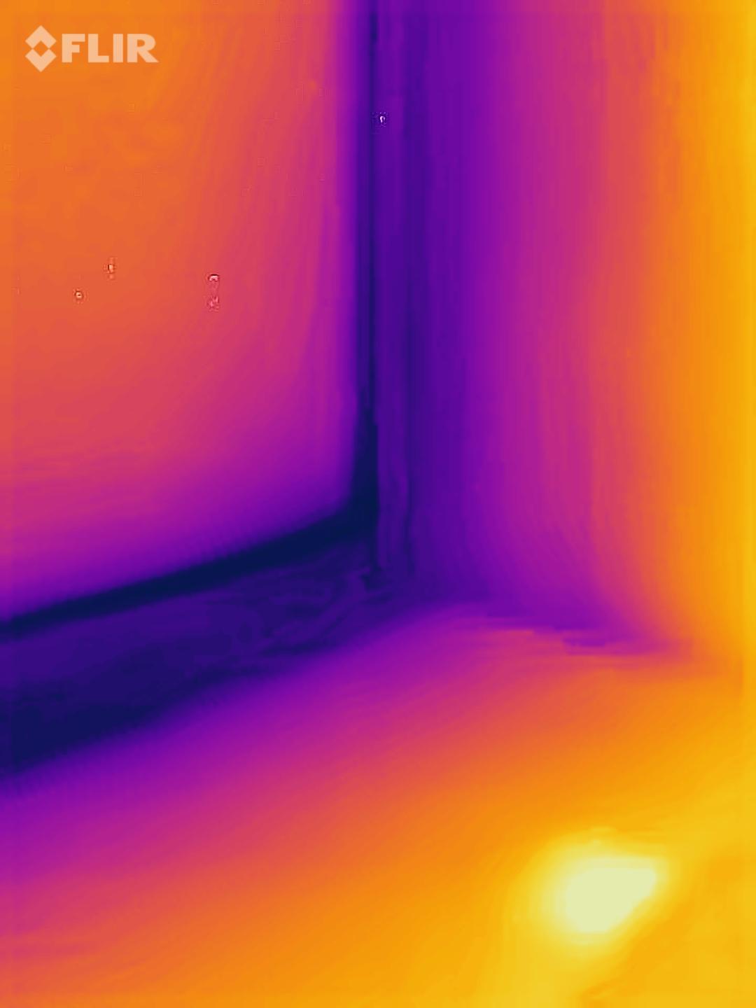

I have been loaned a Flir One Thermal imaging camera by the energy company. I took several photos but struggling to make heads or tails of it. Its a Victorian house with mixed levels of insulation but all new timber sash double glaze windows. Some rooms have full internal insulation with insulated plasterboards while, others are plain old solid brick house feels draughty but the thermal images are not telling me anything I don’t know some attached to help interpret. Thanks so far draughts are from - front door (key hole, surrounds etc) - skirting (feels bad) - electric points in plasterboard

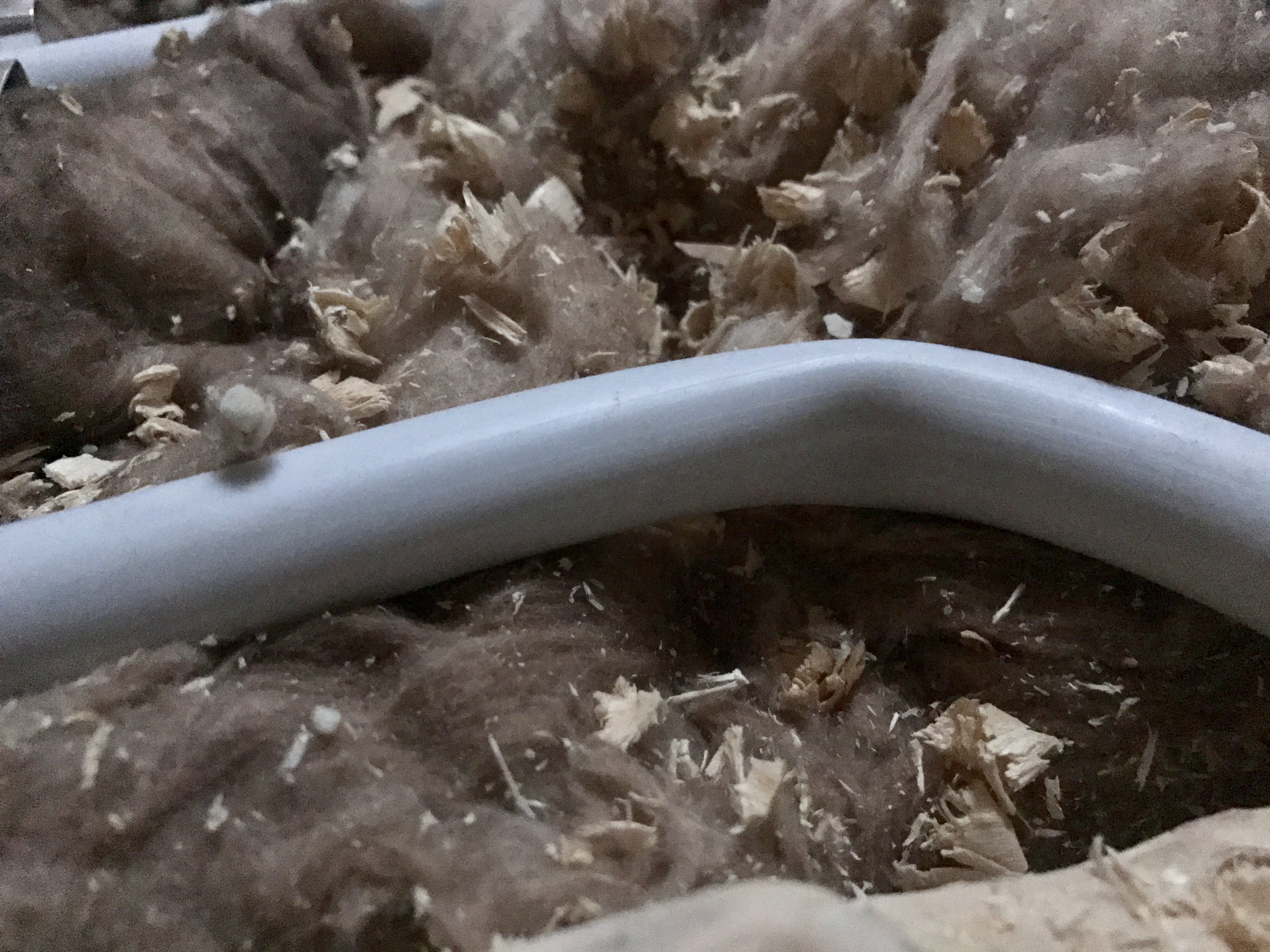

I could not run the al pert pex pipe without a kink or two but this photo shows the worst one. Pipe is 16mm Al Pex with 150 spreader plates making it very difficult to turn. Will i be ok? Floor is covered. If the pressure test fails I won't bother replacing the pipe. Will just give uo
