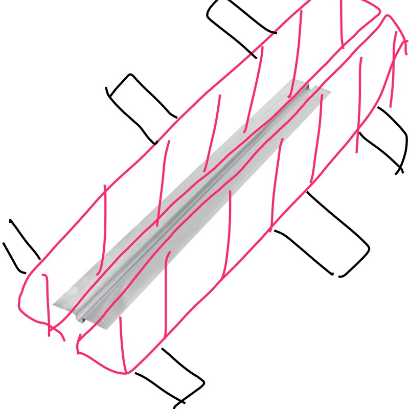

  19. I intend to leave the void underneath the joist for ventilation. I can get in 70mm PIR by using netting/quilt blanket instead battens, it will look similar to the photo here http://javitas.info/image.php?pic=http://constructionstudiesq1.weebly.com/uploads/1/6/4/9/16490624/1364413461.png This single spreader plate will sit on two normal period floor boards spaced to allow the groved part sit in the gap (pink bit are floor boards, black bits are joists under neath), the spreader plates sit on top, not under as it looks in the pic a backer boark like this to glue down the chevron flooring as would not want to glue to the original flooring, http://www.theunderfloorheatingstore.com/prowarm-backer-pro-tile-backer-board?

  21. I have just 70mm joists on sleeper walls in a victorian house, I can just about add at least 50mm celotex once they have been battened. This leaves me with the following solutions - Expensive- re joist the floor to accept spreader plates (irregular spacings), then 21mm structural plywood/chipboard and 11mm Chevron (lady is set on them) - tongue and grooved board with 12mm pipe, this requires 6mm ply glued on top for rigidity then chevron on top and my light bulb idea - 50mm celotex between joists - use existing original floorboards but space them (gaps) by about 15-16mm, - laydown singe run spreader plates for 15mm pipes - 6mm backer board on top as this will be less insulating, add a heat sink and allows for the chevron wood to be glues on top - lay the engineered chevron on top what could go wrong? no need to buy grooved boards... i feel i have missed something big here BTW - neighbour put underfloor heating under original solid floorboards 8 years ago and they have not warped.
