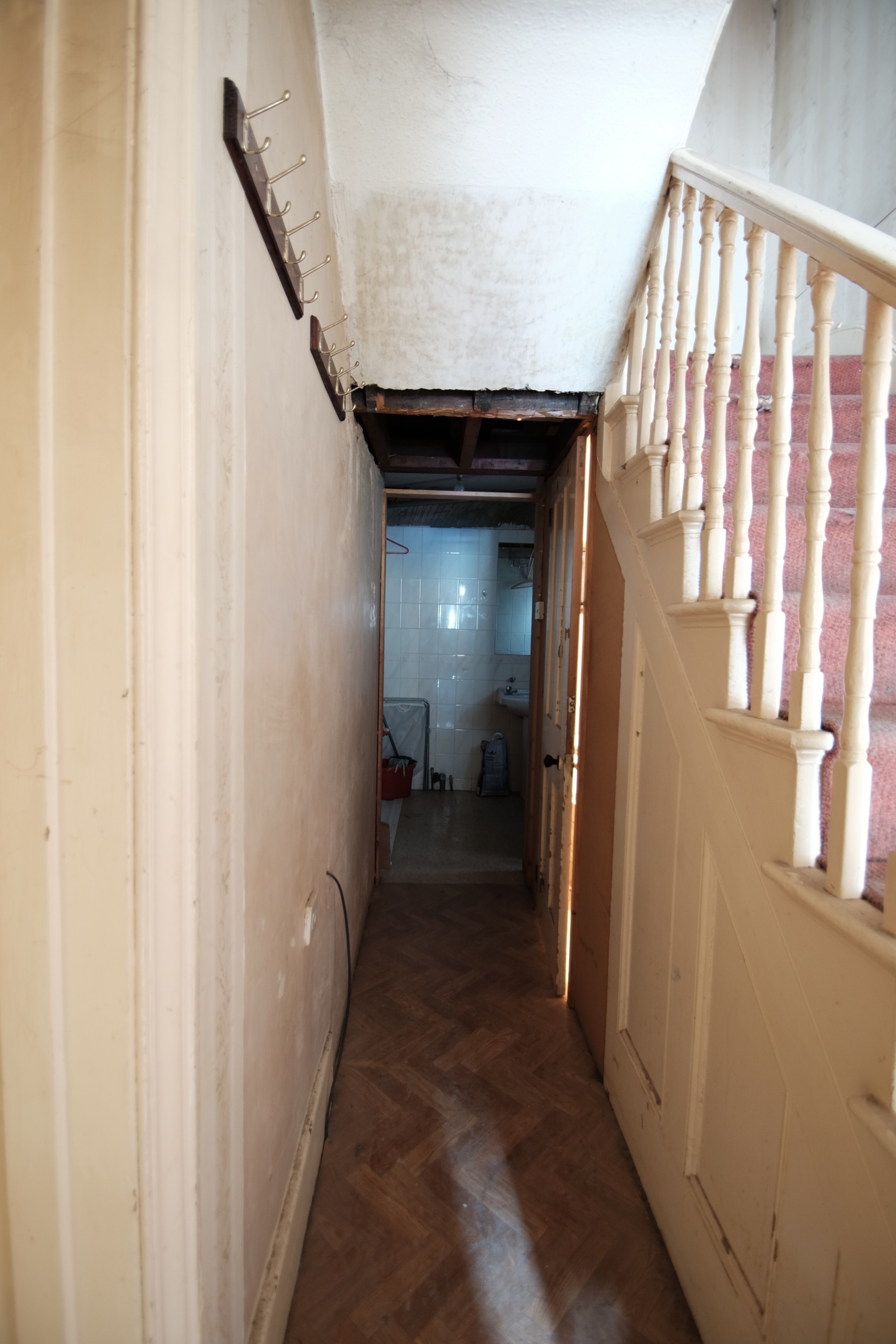

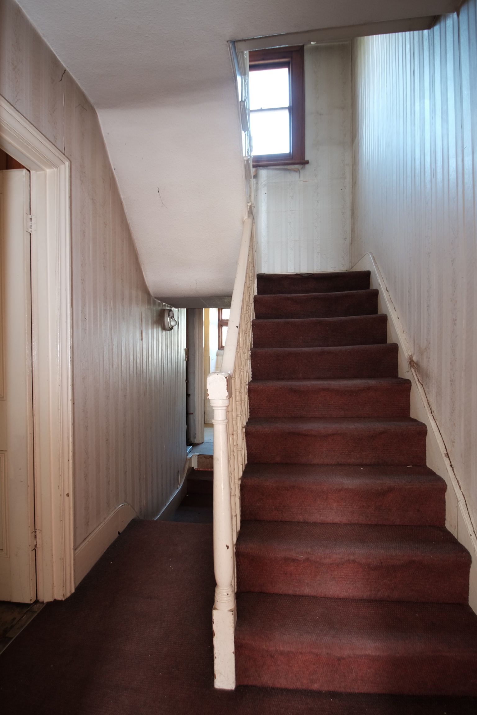

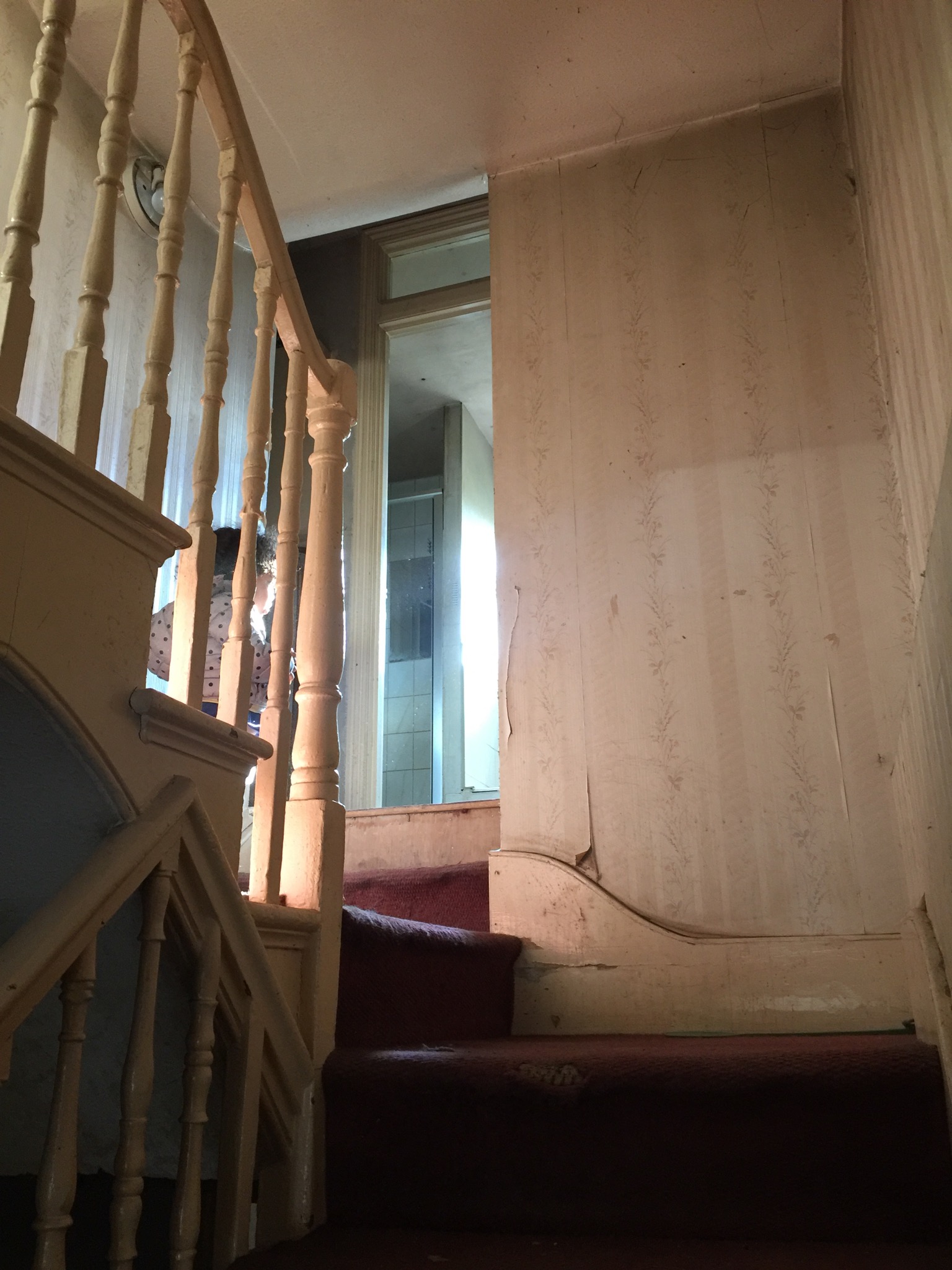

  1. I am trying to dismantle the stairs in a Victorian house so that the spindles and railings can be sent to a print stripping service (faster and not so expensive). The trouble is that I can see any screws and or nails and would not want to spend 2 months with a heat gun scrapping it down. Niether does the thought of ripping out and replacing appeal to me, feels wasteful to just replace them. Any idea or thoughts
