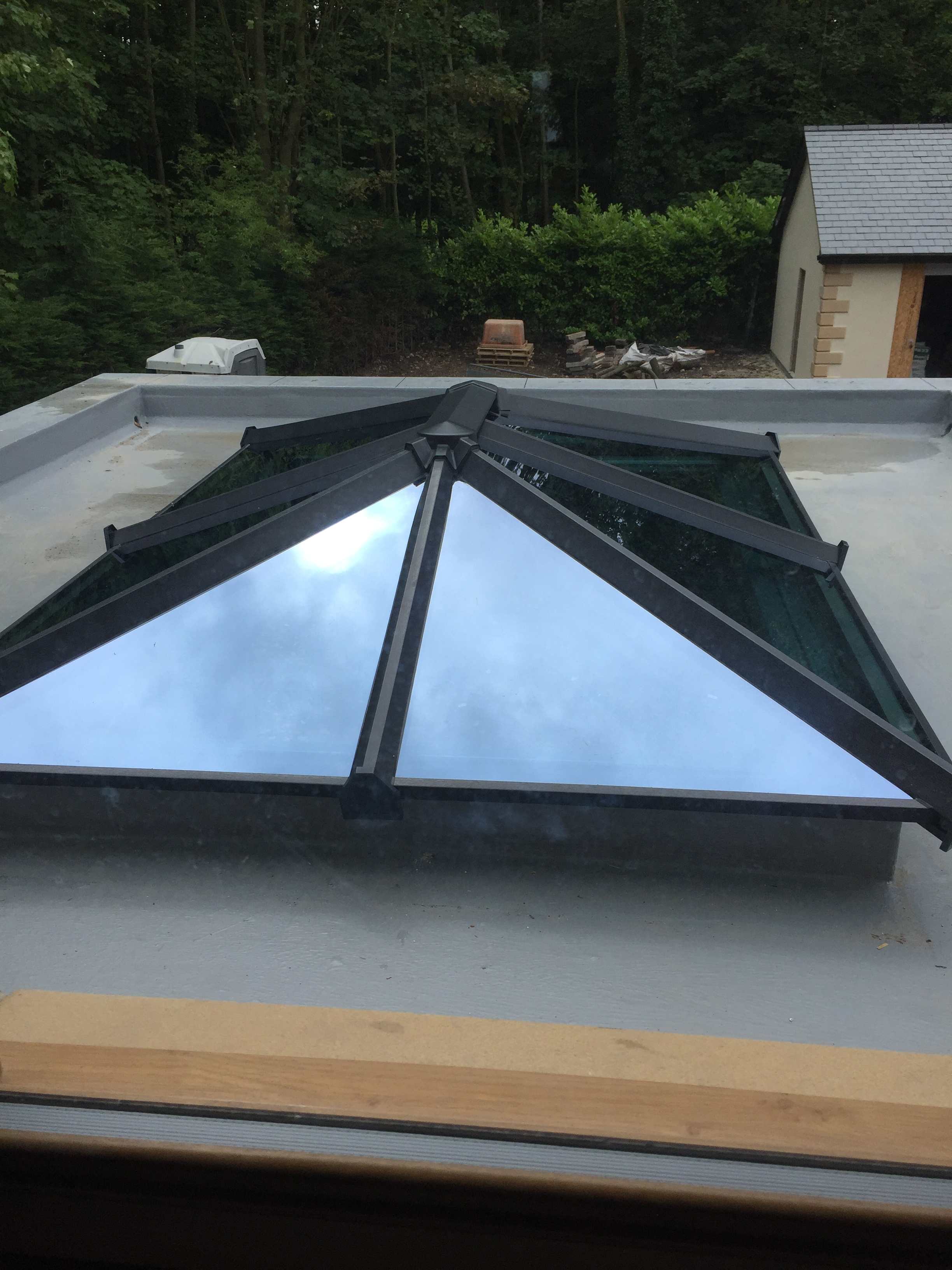

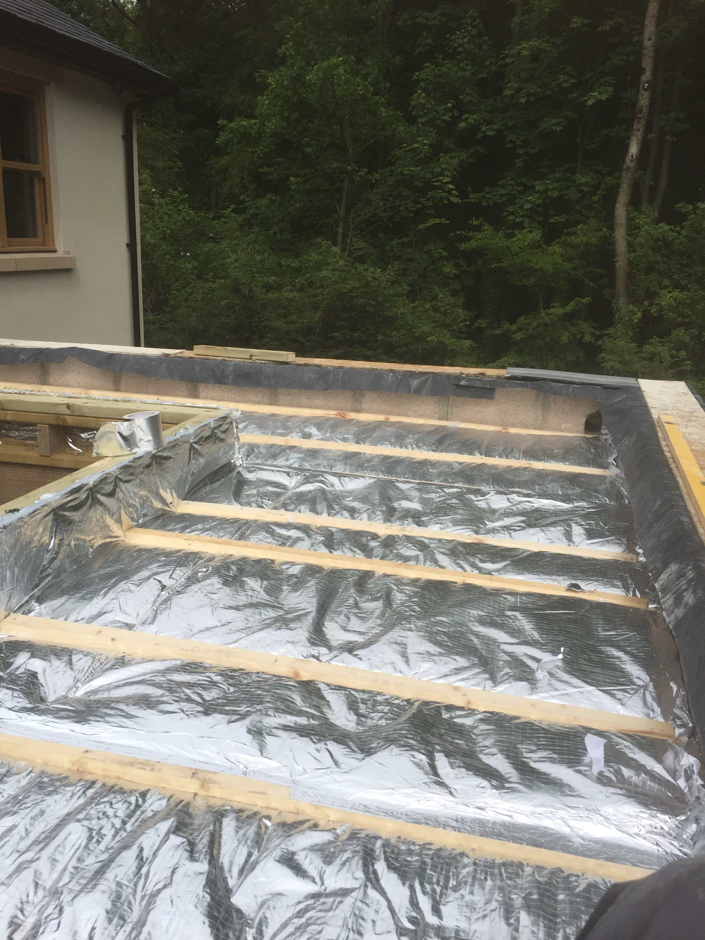

I used 9x2 joists boarded with ply Then a layer of multi foil Then fairings Toped with OSB 3 Plywood on the top of the blockwork and returned the fibreglass over to make a watertight seal First attempt at fibreglass 150 kingspan between the joists Then boarded with 15 mil duplex and then skimmed it over with a couple of coats of multifinish -
