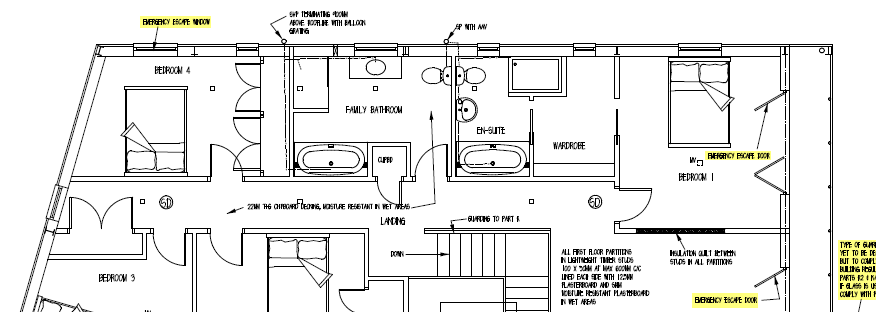

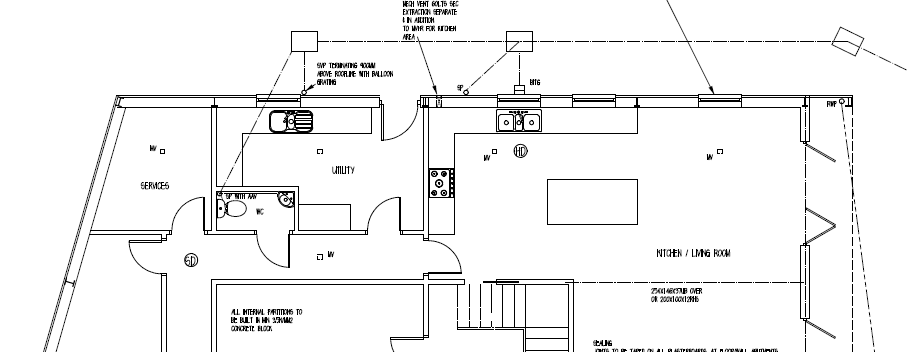

Wow thanks @Nickfromwales for this really useful advice. All this plumbing wizardly fries my brain! Can you explain what you mean by an air break? Also the pipe sizing - are you saying it's better to run in 50mm for all the bath/shower/basin or mix it up between 40 and 50mm.

Thanks @Temp. Any views on running them down through the concrete core of the ICF. Must say makes me nervous wrt access if anything went wrong but maybe that risk is so low that I'm worrying over nothing. In all the houses we've lived in over the years I can't recall a single issue where we've had to access a stack but then I'm no plumber and maybe it's more common than I realise.
Evening all! After some advice wrt the pipe layout that our draughtsman has proposed. The drawings show pipework going to 2 x external stacks. I'm not particularly keen on these being external as I think they'll spoil the clean building lines. Can anybody suggest a better layout? For instance do we need the SVP that connects to the first IC as I read that the vent on the treatment plant may suffice (appreciate I may have got that wrong though). We're using ICF and the thought has crossed my mind about running the stacks down between the EPS forms. Would/has anyone else done that? Thanks.

ah right of course, so just put them all in line, downstream of each other?
