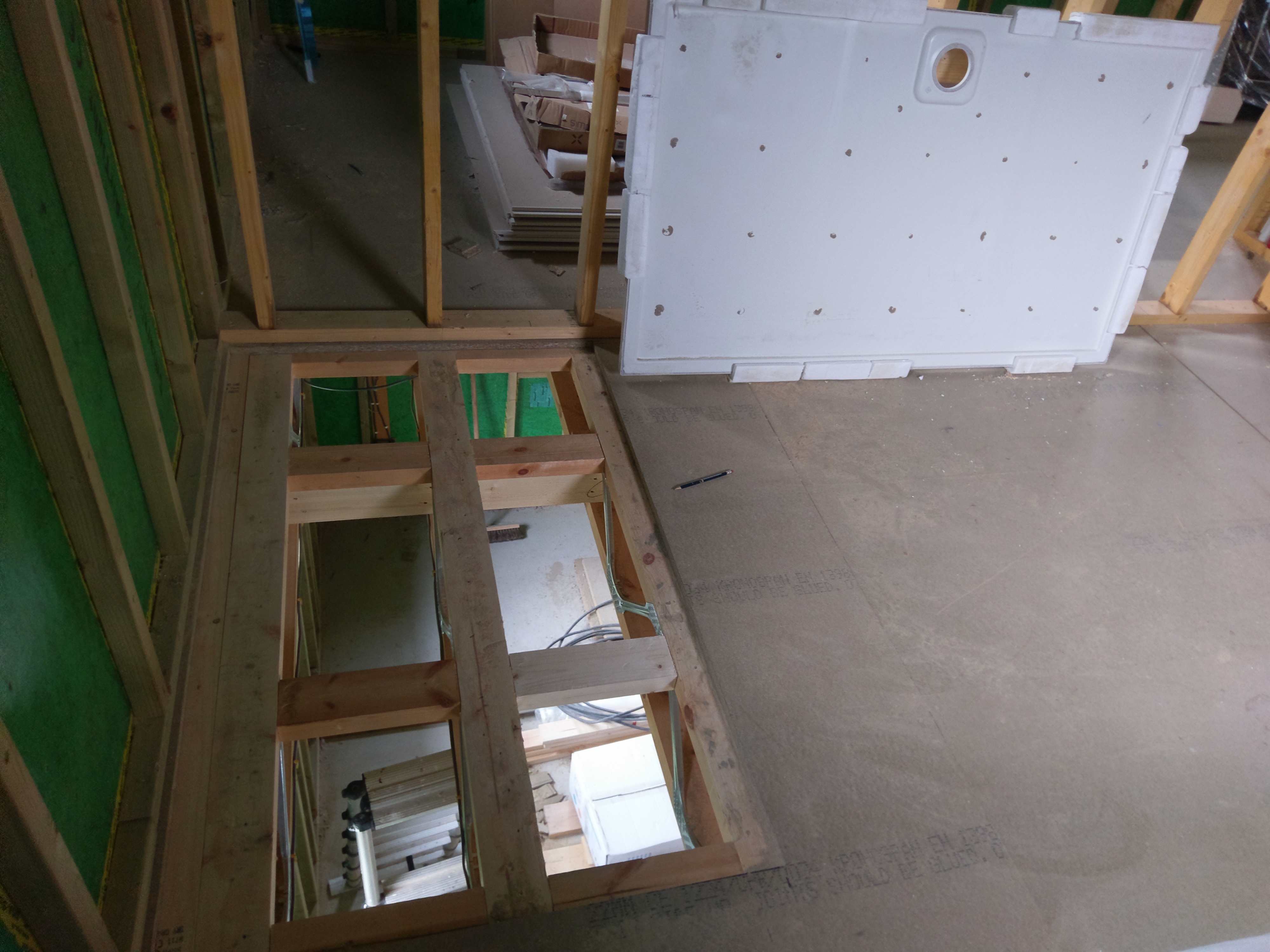

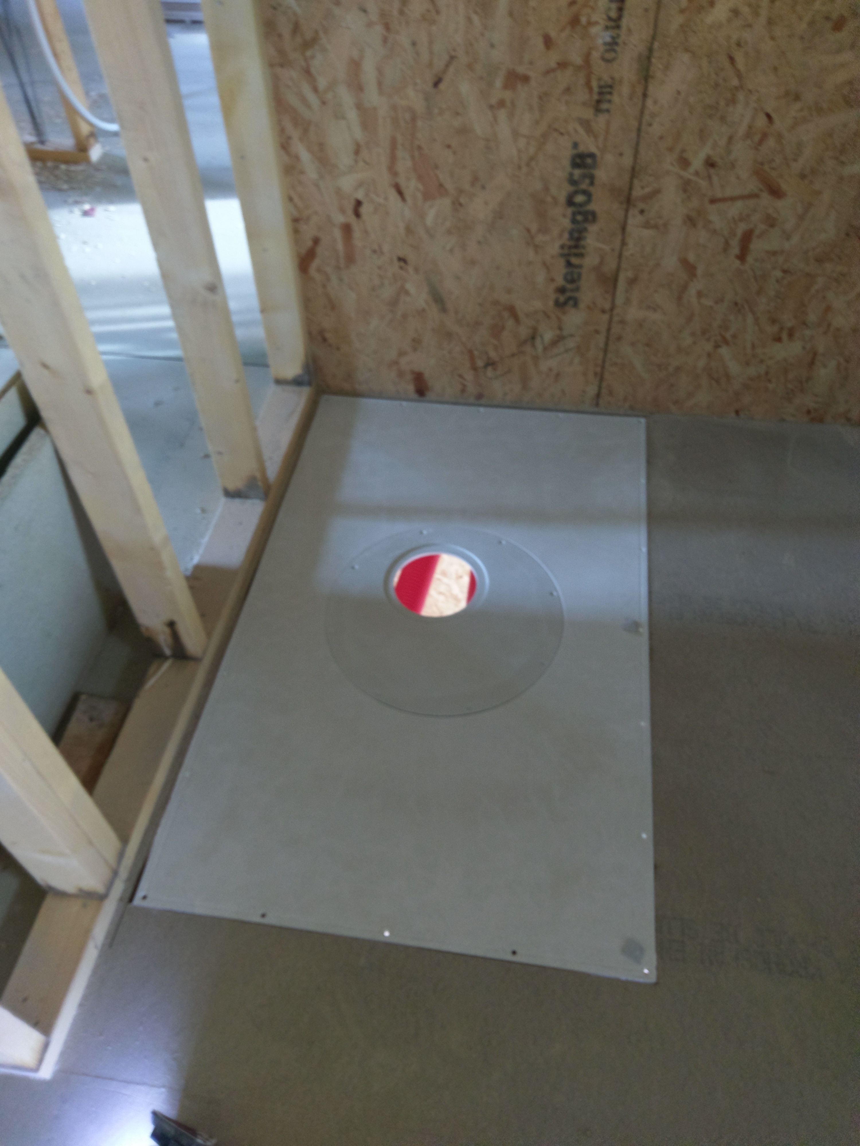

yes we have pozijoists that are about 100mm wide they run approx 1 each edge and one in the middle. as per instructions added extra support at each end as well don't have a picture of floor but this is what it looks like. the next picture is of the other bathroom that has a 25mm stone tray this has ply fitted on top of the joists it shows how i have framed the opening all supports are glued and screwed

Thanks an excellent post as normal Yes we are using the full impey system. will need to fill a couple of areas with ply as they didn't show that either but as we have yet to board the ceiling underneath its not an issue

Fitting my Impey wet room former and am ready to screw it down. However i have read the instructions and watched the video but cannot see them using mastic either under the tray or between the rotating ring and the tray. For those who have fitted an "easy fit" is this right?
