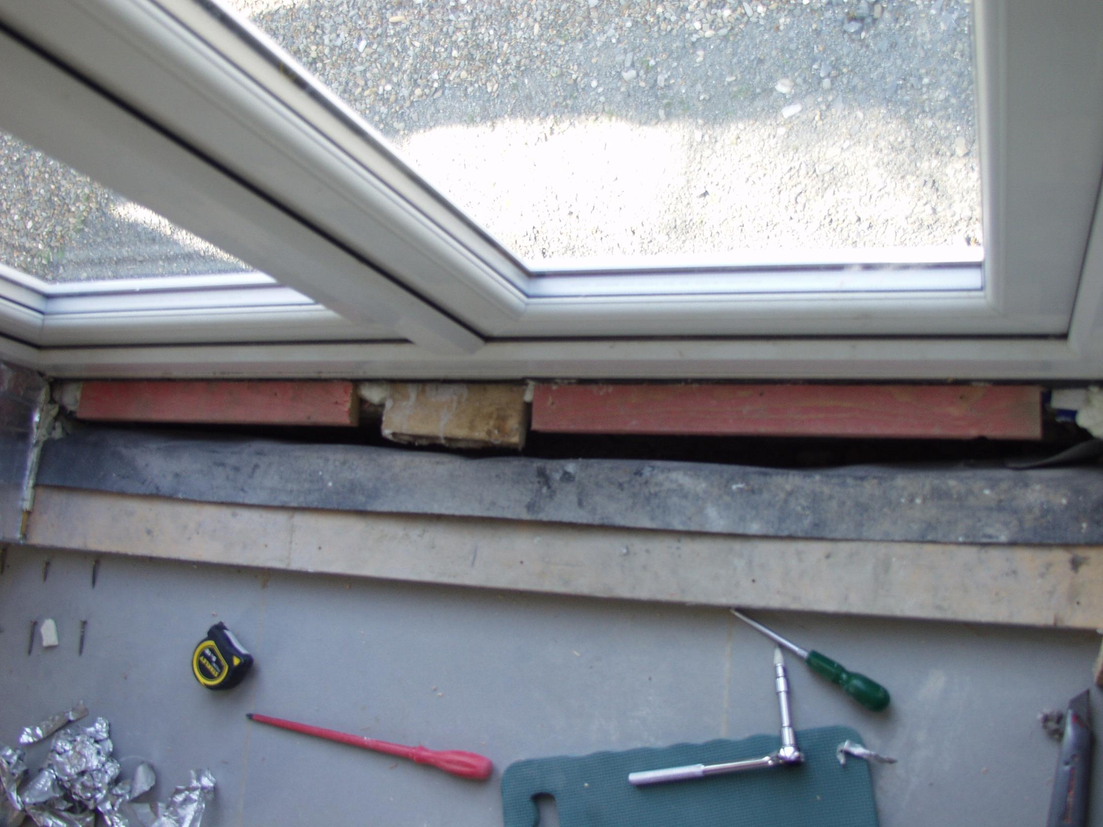

  1. Ok just about got the sods out. @Onoff if I could get your thoughts especially.. Ok now I find whats under the osb top. Nearest door frame: roof batten nailed I think into the block below, with a lip of dpm around it & going down into cavity. The cavity doesn't go down down all the way here as I anticipated to find: instead a dpm sheet seems(?) to come up from 1 block below door frame, up & diagonally across 'bridging' the cavity > stapled onto CLS. So I sort of have a dpm gap shaped in a sort of 'V' going down 6" or so.

  15. I cannot get these BFO screws out dpmiller, not even shift 1mm round. I think I'll have to hack osb top off, hacksaw screws off.. but I'm wondering whether its better just to leave the damn thing as is & carpet over. Damn builder's overall 1ft extra depth bodge up.. causing endless problems: there should -never ever- be a sodding step here at all.. but I was forced to ask for it to claw back some balcony height > IE put doors up a step prior to building it. I dont have experience to know you see, how big an achilles heel this bloody step is re. possible cold ingress, to make the decision. Ok another angle to ask: if there was no step & the french doors were sitting on the floor level.. how would the floor continue into this recess area? & surely the last 50mm of it (before the door frame, covering the cavity below) wouldn't have any insulation directly below anyway. just the cavity. which is effectively what I have at the moment, bar my covering being osb & this imagined-floor being (presumably) more 22mm caberfloor.
  16. @Onoff hi Onoff. Can I just pick up on this idea you suggested/ & or what I can do with this 'step' threshold area. Looking at your sketch again, I see you proposed put the PIR -ontop- of the existing OSB topped 'step/ threshold'. Only problem doing this, is the additional 60mm (let's call it) height, up to same level as the lower door frame you step over as your sketch suggests.. is I'll be uncomfortably skimming my head on the top part of frame going in/ out the door stepping from this heightened step. Builder bought me the lowest door possible you see (yet another £save to him it seems / infuriating thing for me to contend with) @ 1.85m H within the actual frame. So my idea was to add this step area (he hastily/ as cheap as poss made in 5mins).. but not any higher. The reason for this added 60mm step/ threshold (as it is now), is because I had to ask him to position the doors UP a bit (because he made the whole build WRONG by 1+ fkn foot low, as Ive outlined many times, so I had to scrimp & claw back every 50mm I could at any possible juncture: in this case claw back a bit of balcony height.. by placing the doors UP a wee bit > so they'll skim the deck by mm's opening out. Countless ramifications of the build error.. continuously hampering me at every stage: the balcony build, the last job, being the most fraught with consequense if I cannot get it cm perfect. "Oh it'll be fine, what's the difference anyway?".. I'm still fuming with anger!!

  22. Ok thanks alot for that.. I feel calmer when I get one of your sketches, its Onoff opium! theyre ace. Ok understand the idea better now. Only thing missing tho in 1st profile sketch, is that the cls isn't up to the line of the door frame: its 100mm short of it @ 140mm (sill as I call it is all of 240mm to the door frame, set FAR back so door can open out 180*). So I have a 100mm gap.. I assume so/ assuming he didn't fill it with timber too.. over which the osb is hiding. This is why I was gonna hack the fkr off. Actually I could drill thru osb top couldn't I & see if anything solid below, just thinking as I type my spiel.
  23. I'm not quite getting the need to support the timber top. As far as I can tell, its a solid bit of CLS (all used seem to have been 140mm for the studs, but the base [the horizontals you can see generally around the pic] onto which this scrap of osb is screwed. That's it. If I could get the top off.. but I can't the huge screws are put in with lord knows what strong thing. If I get the top off, hack it off then angle grind the screws off (cant think how else to do).. then I have 140mm of CLS timber > then a gap of 100mm (presumably builder didn't put in any more timber here) > door frame.
  24. I cannot take a better photo, I do not have a better photo. That is why I state "its good enough". Not from a lazy opinion.. but bc my old slr cameras unable to take a pic now, & I cannot afford another. esp right now. We're not guessing as to the section. As I said its just one layer of CLS (is it?), & a scrap of OSB whacked on (you can see in the pic, even if its in the btm RH corner.. its clearly two bits of wood). I was only wondering really if A) it needed to be insulated from a regs pov, & B) how this could be done. I mean the sill on the door below, into the workshop: my builder put in a slate sill, looks good. But its not got a fart of insulation under it, or air-tight xyz on. He couldn't have put slate onto anything but a solid piece of either block or timber anyway I would suggest, so this door sill wouldn't ever be insulated.. so why I ask myself would the sill to the door(s) upstairs would need to be? only difference is its 2 (narrow) doors opening, not 1. Isn't it?
  25. @Onoff that's as good an eg/ pic as is needed. No black gap, just some dpm lip coming up/ trimmed that off, & foiled the wood fwiw. Is it imperative I put even PIR on, can't it just be left as is > put on something/ not sure what ply is a good suggestion, but without insulating below it 1st?
