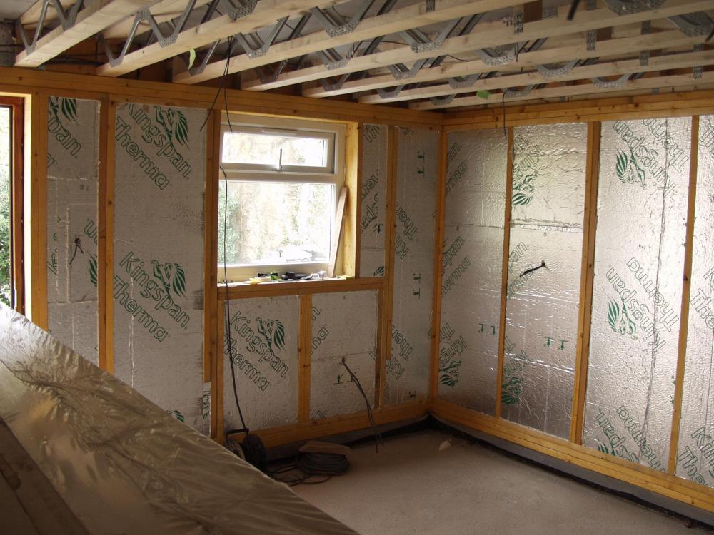

  1. Thanks for suggestions: as I'm on a budget I'll rule out buying a circ saw new blade, tho I'd sure like one. I'll try my jigsaw it might do half the thickness, then a handsaw.. if not do all with it. I've just got to make a high-edged guide rail for my magic pink saw then can jump in. Ok once ive cut my tall sections, Ive then got to cut it to navigate around cables. Is it a Q of trimming off a 45* from back edge to allow say a good 1" clearance for cables? or can the PIR go right up to, just nip say 1/2" of the lower back edge corner off? I recall Onoff giving me a b*ll*king for running my ext cable in a wee trench I cut in my kitchen 25mm PIR (redundant on tues Onoff: my spark's fitting a proper outside socket out from the back of my socket as you suggested ~yr ago). And Ive got socket cables going across up 500mm H from floor (in upper room), meeting together in middle: I have to drill a hole in the PIR for these to protrude thru I think. I need to check the upper room sockets -minimum- height they can be: if anyone can concur with.. is 450mm min to bottom of socket the std min figure? (if so I'm going 500mm to centre, to be safe).
  2. Jigsaw is an interesting idea.. I was just mulling on that (going along a straight edge-?). The depth would only get me halfway is the only thing.
  3. That's a good tip MJN.. got the ideal one for job (I use it for bread, & for cutting turf last spring too!) so its now a multi-tool-bread-knife then.
  4. Thanks alot chaps. The Onoff YouTube clip is ideal info (Id never have found such a good eg/ chap seems a boss), using the timber for a straight edge, marking with the tape (ace tip), friction fit I'm going for & if needed fill any gaps after with sudal LE foam.. & I too have a magic pink saw. I just can't face attacking with a circ saw/ dust & noise too much.. & I dont have a tablesaw. Handsaw it is. Ok that's a basic plan of attack. Ideally as PeterW says 2x 70mm would have been wiser now, but £more (& PIR bought before xmas before £hike in january.. saved £80 alone). Great help- zoot. I'll keep reading the replies before I wade in though.
  5. I'm just about to jump in & fit 140mm kingspan into my new timber frame walls. My bco has specified full 140mm (sigh). I've fitted 25mm celotex before in 2x kitchen walls, easily cut with a sharpie.. but this is behemoth thick in comparison so I'm a bit daunted by the prospect of the job. Are there any tips? or is it only a case of measure, saw, stuff it in? I have approx (25x) 2300m H x 500mm W sections/ gaps between my 140mm timber verticals to do. Electric wiring all done, & generally pushed/ clipped at the back or in corners: navigating around cables I could do with a few tips on. Any help much appreciated- zoot.
