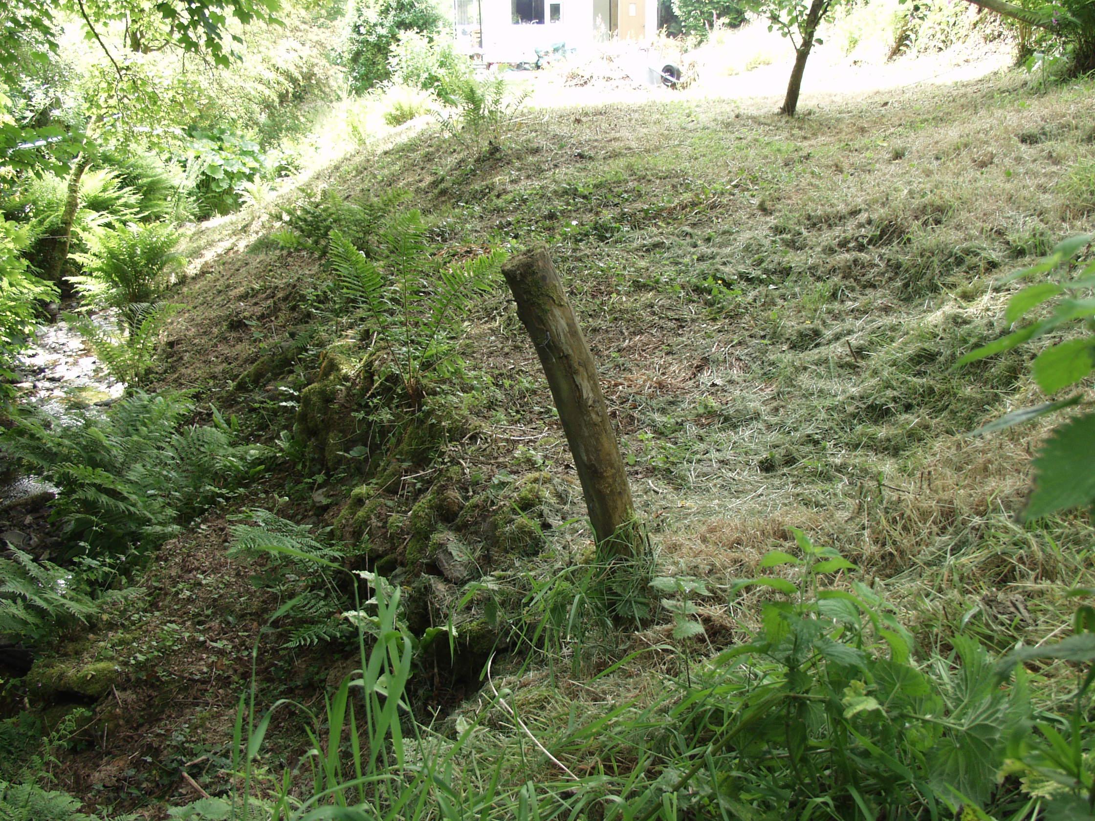

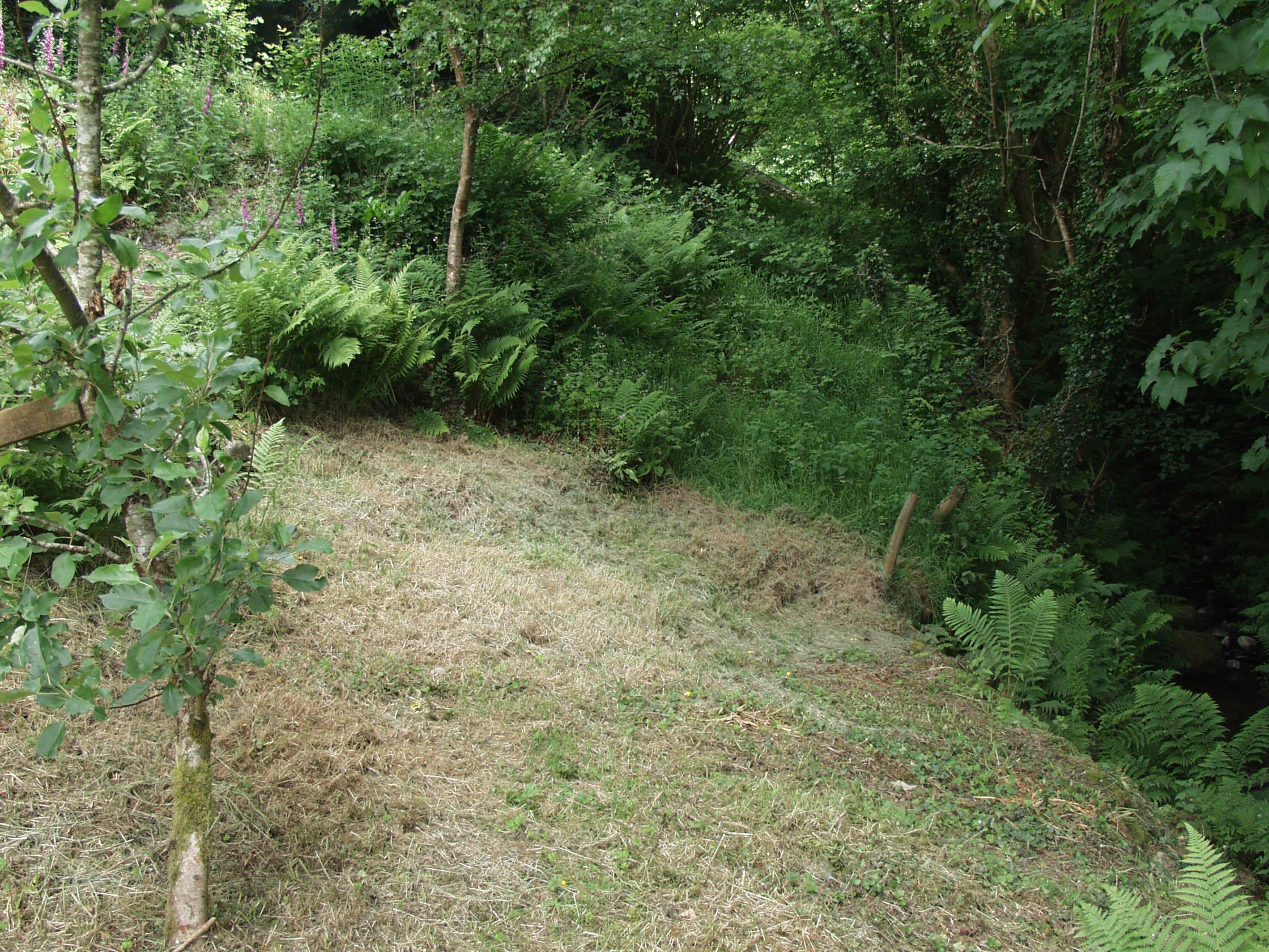

  7. Its soft ground.. but if you look at my 2nd pic, the hole would need to be twds very edge of the 'step'/ where the wonky post is on edge of. How coukld a hole be dug here without the side collapsing? I thought of those mini digger probs too.

  12. Hi all- my 1st thread. My lower garden is narrow 15m with a tricky ~45* slope, down to a stream: a near unuseable area due to profile. My plan to best use it, is to put a 3.5x3.5m log cabin 'across' it, making best use of area & 'covering over' the slope visually. The left side/ easy surely.. but the right side's slope away is the issue, to create support for a base ontop up from here. My builder had 2 ideas (& a hefty quote not inc a base optop- £900). Idea1: exacvate & "shutter 4 300x300mm concrete columns, 2 shallow, 2 deep stream side". Idea2: excavate, nip/ pull one side across, to a barrier (posts/ stacked gravel boards?)/ filling up this side.. to create a level patch. So 4 coners 'pillars' idea? My concern is as ground is not the most stable on slope side, wouldn't a block maybe 'shift' over time pulling the base down & sideways? My concern with Idea2 is the pressure/ weight against the boards, & the new levelled ground 'settling/ sinking a bit over time, with concrete base on > cabin ontop of. Any other ideas? a pic of the lower end, looking to where the front of cabin would be (2nd pic reverse view). Thanks zH
