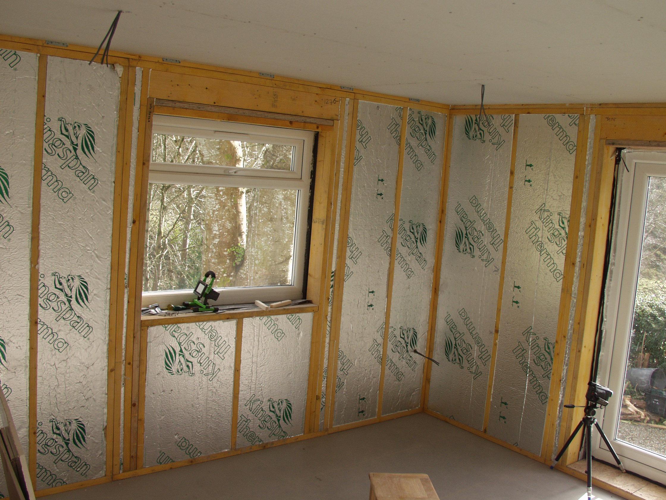

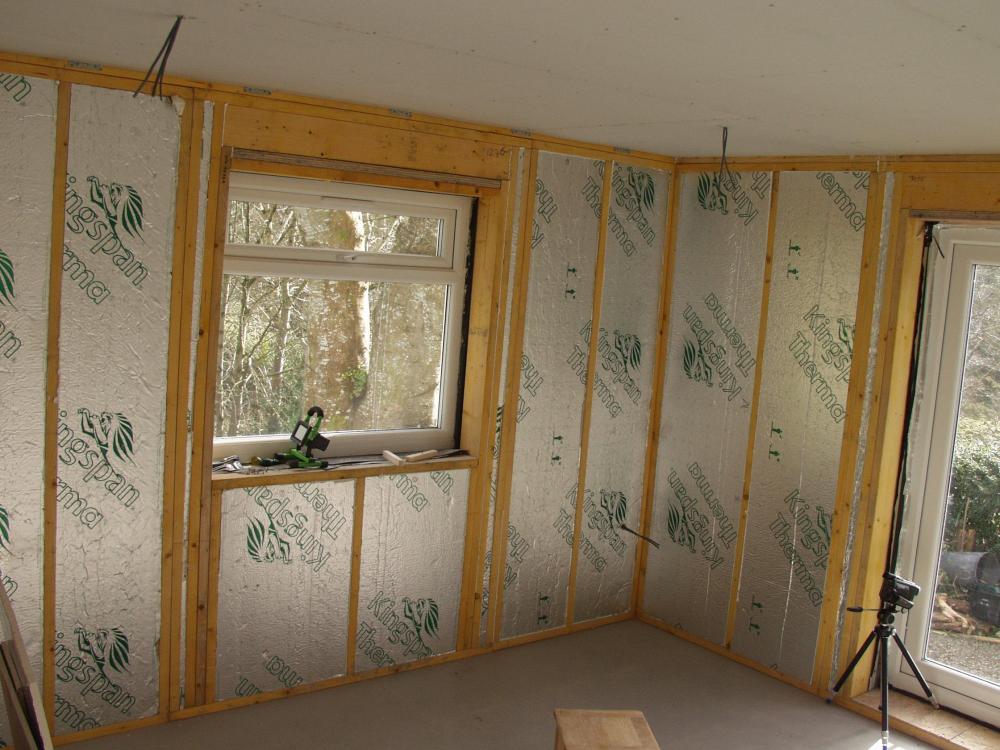

  1. You see the thing was, my builder used so much timber 'packers' (horizontal layers top & btm of room) Ive got alot more studs going on than I should. Seemingly around the window/ door too.. alot of timber going on.
  2. Ok great I'm gonna call the vapour box TICKed. Andy do I even need to PIR line the reveals, at the sides?? could I just do top/ btm with a full 25mm PIR, pB on top.. sill on lower (I have enough room to do this, its only the sides I'm restricted due to narrow width). Then the window will all sit symmetrically 'correct' to the walls around it.
  3. I was wondering if I even need to line the reveals at all. I mean they're all "lined" with 100mm of timber as it is being a TF build, plus a sandwiched 25mm PIR layer I put in next to this 'frame' around the window, then another 50mm timber stud outside of that. The window would look 'correct' if I could just put pB directly onto the timber sides. I could then just PIR line the top/ btm with a full 25mm. Surely timber has thermal properties itself of a sort, or big log houses wouldn't be inherrantly warm.. chalet I was once in switz was warmest house Ive ever known.. just one skin of big logs afaik.
  4. Hi dpmiller.. the pozi-joists/ ceiling shown in pic top of page 2.
  5. Hi @andyscotland I thought the idea was to foil -and also- placcy sheet, a belt & braces plan? I'll be very relieved if what I've done is even a fairly-sufficient barrier, & I've negated the need to placcy sheet it. Can you confirm this? Re. the reveals. Ok I've got 2sqM of 25mm of PIR left from kitchen job. So instead of buying costly insulated-pB.. which I'd need a full sheet of just to effectively do 4 reveal sides).. & the fact that I can literally only get 12.5mm IE half thickness of any PIR in (+12.5mm pB offcuts to use up too, makes sense = 1" total material, MAX, due to my builder not giving me much room L&R).. so I was thinking foam-stick my PIR cut halves (only 20cm wide of course, so cutting w'breadknife doable).. then screw-on my pB. I can't think how else to line these sides, with at least some insulation, if its even needed, to max 25mm total material.. without doing my plan.

  10. Been foil taping mad. Done top room reveal: builder left me with not enough either side of window, to line the reveal (sides) with even 25mm PIR > pB over. So my plan is cut a 25mm PIR in half (tricky) > foam fix it to the foiled reveal sides > pB with long drywall screws, thru PIR, into timber. Is this a good plan? I just can't deal with plastic-lining the upstairs room, let alone both (its a job too much for just me).. so tried to foil really well instead. Foil job alone took me 2 days. I did look at one screwfix sheet roll but couldn't see it properly, so couldn't guage how tricky the job might be.
