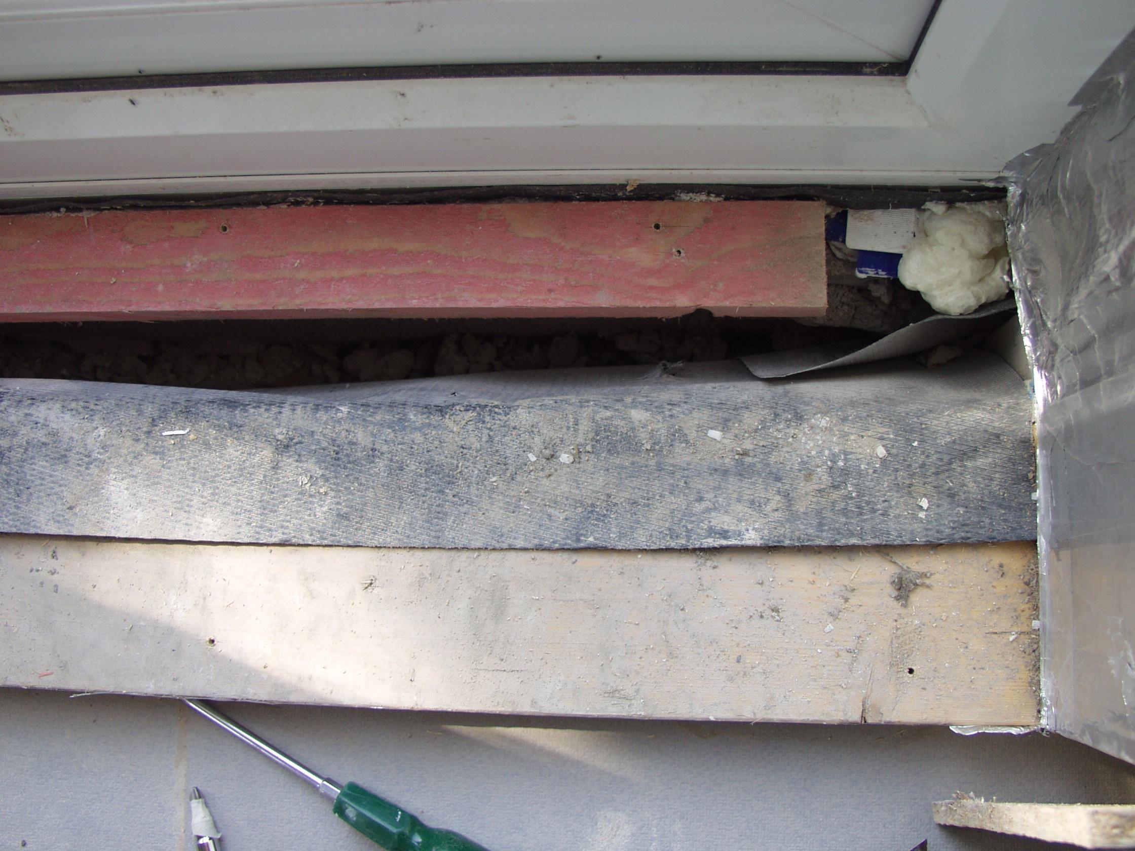

  1. Hi andy.. done as you suggested/ filled up the 'V' shaped space, foil sealed the top > osb back on/ foil sealed this too, as I reckon the whole step area's fiddly corners & gap will have at the least air ingress weakspots if not some cold too. Done as best I could. Is it usual to now put something like a window 'sill' affair ontop the osb to make a proper threshold? as it is its a very shallow (height) step relative to the door frame to step over onto the balcony, plus, its 230mm depth is small too. I'm thinking a rounded edged step sill, well screwed onto osb & protruding say 50mm into the room to give the added height + added depth in one go. Then carpet can go neatly under the lip flush with room edge. Does that sound daft?
  2. Yes its just simply how to introduce insulation/ as per your suggestion is what I was considering Andy.. I just wasn't sure filling this space up wasn't creating a moisture bridge / cavity thing I guess, so I was reticent to go ahead. But won't I still have 'cold weak ingress areas' where the pink battens are tho? this is my main concern: but I can't see a way around it, as I can't remove & refit bits of these pink battens back like Onoff's suggestion (putting PIR there instead adjacent to door frame), as they're nailed with some dpm sandwiched under: only way I could refix is with rawlplugs into the top of the block below.. & I haven't enough top (1") to do this.

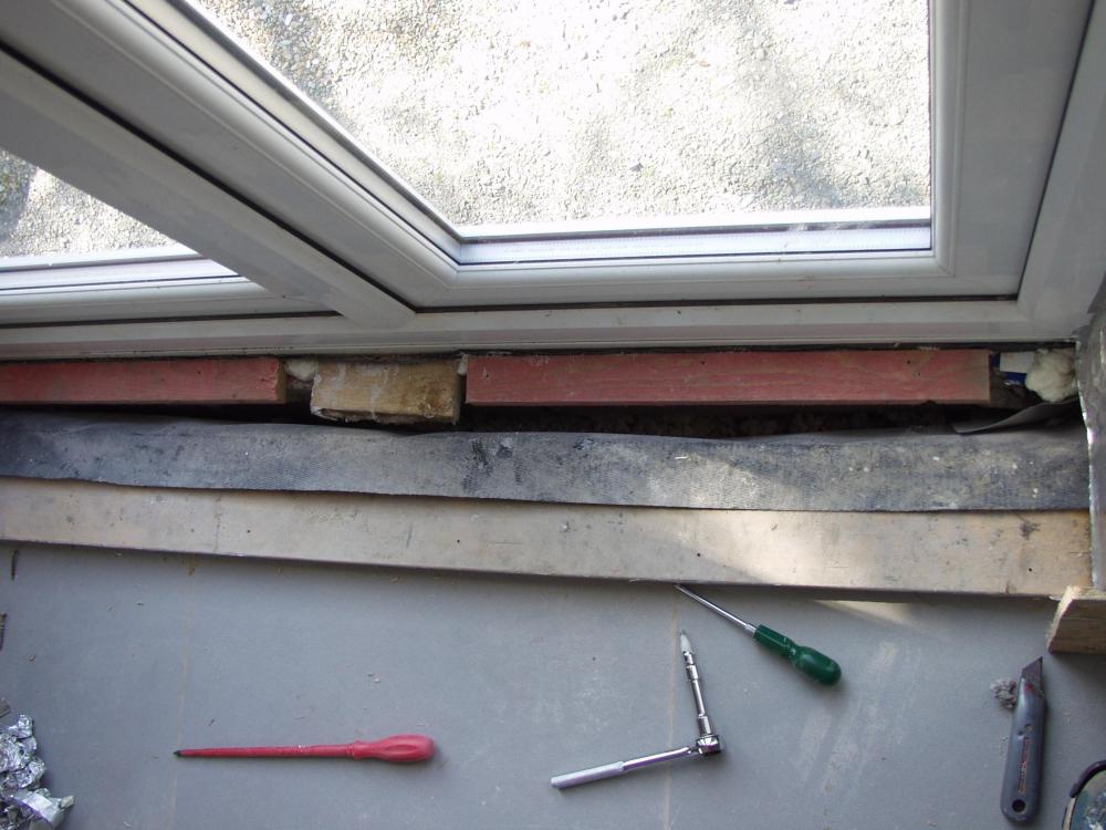

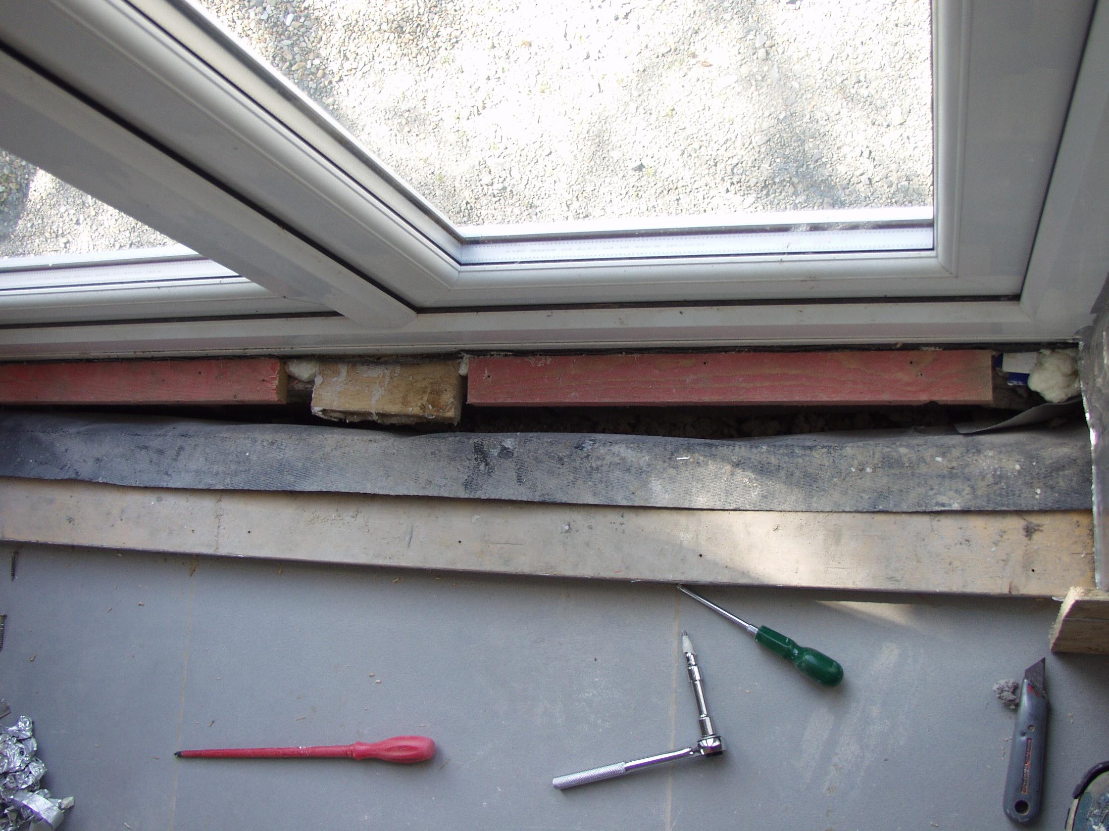

  3. Can anyone help? better pics here. Seems there's just the one dpm in the foreground attatched to the CLS: it goes down, 1 block deep & originates from between blocks (as far as I can tell). I do not want to remove pink battens, as they're nailed into block top, & even if I could remove/ redo (with PIR between like Onoff's suggestion) I could never attatch back solidly so would never be a good base for the osb top.
  4. Ok just about got the sods out. @Onoff if I could get your thoughts especially.. Ok now I find whats under the osb top. Nearest door frame: roof batten nailed I think into the block below, with a lip of dpm around it & going down into cavity. The cavity doesn't go down down all the way here as I anticipated to find: instead a dpm sheet seems(?) to come up from 1 block below door frame, up & diagonally across 'bridging' the cavity > stapled onto CLS. So I sort of have a dpm gap shaped in a sort of 'V' going down 6" or so.

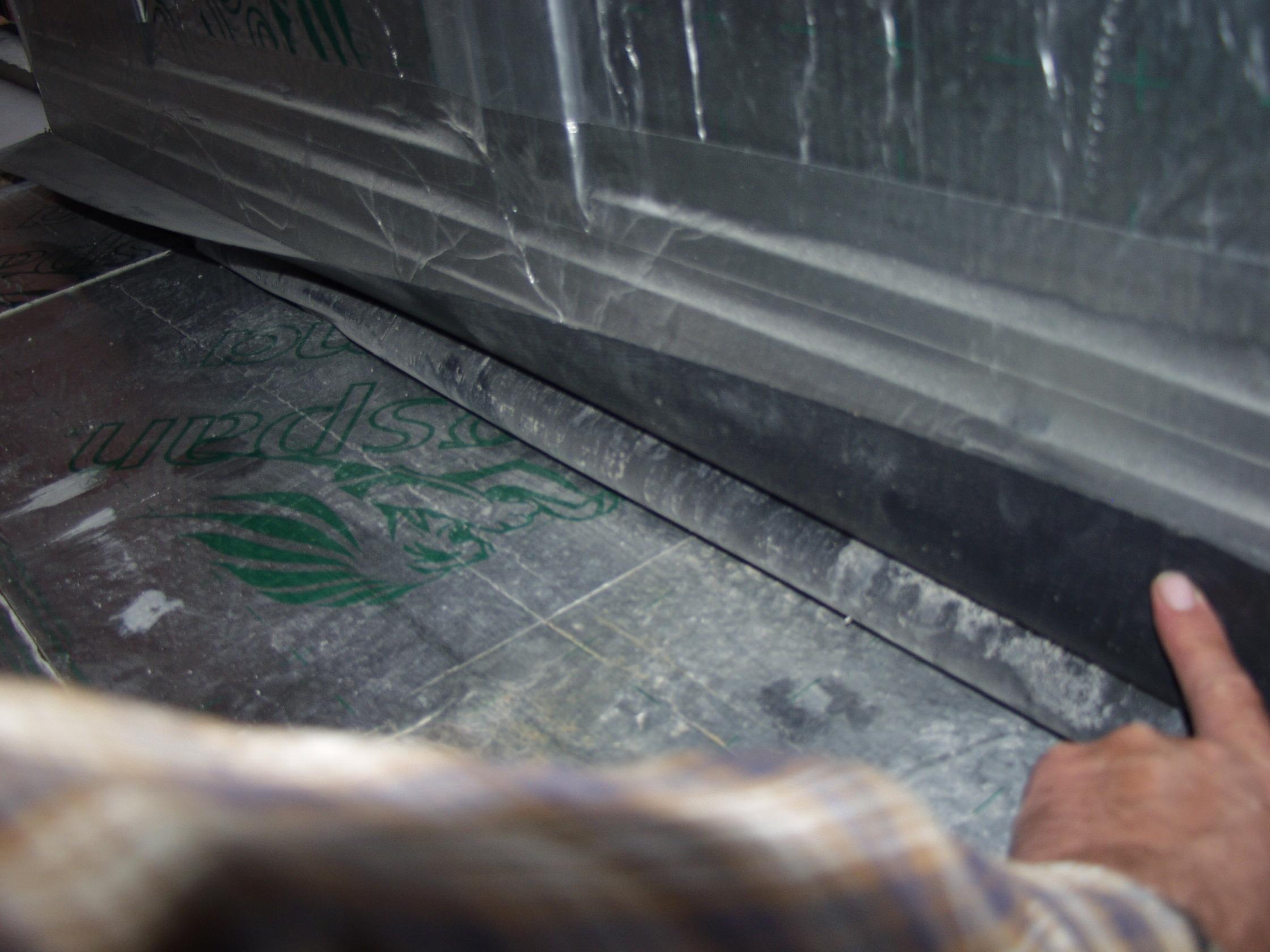

  14. Ok thanks for the help- done the job (600mm W rockwool @ 140mm thick.. breadknife cut in half to 300mm W). So whether or not it has -any- noise containing properties after all that.. who knows.. IE the innitial idea of putting something 'sound containing' in was ultimately totally n/a it seems, as I was constrained fully in terms of what stuff I had to use, by the 300mm W of my joists it seems to me. And whether or not I've done it right- who knows. The many cables at the sides Ive done my best to avoid touching.. but these areas are voids/ I've especially no idea if this is correct here, above door area pic 3.

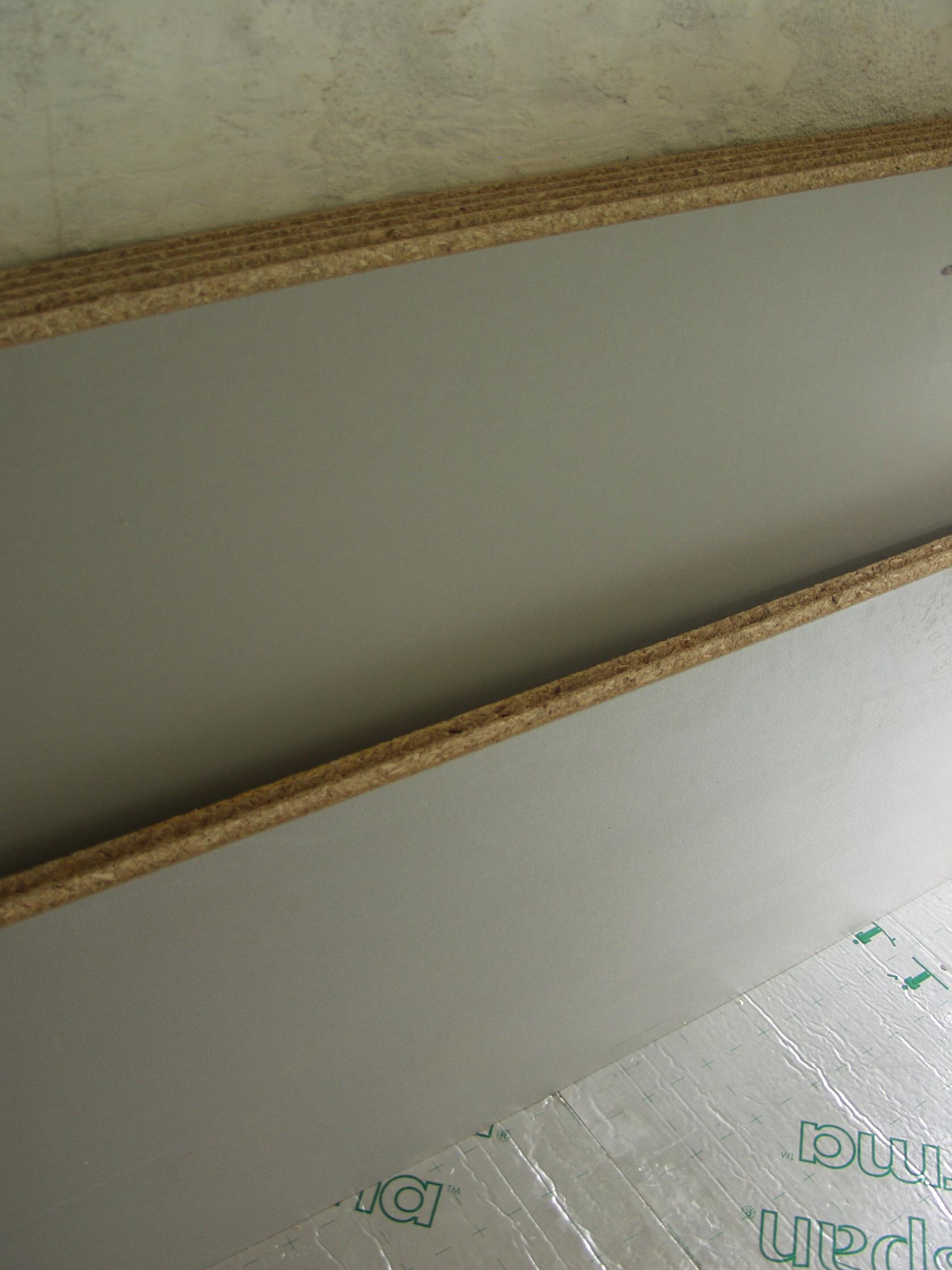

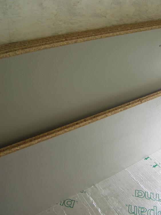

  15. Hi ProDave. Its not so much the shape of the bits to cut (they're simple long rectangles), but how to cut & separate these thin rectangles from the majority left, without ruining them. Or is it just a case of doing it best like you would any normal shaped bit.. IE score one side (presumably the insulated side in my case) lift onto a batten & press > it snaps ? but then somehow I have to haul it upright > score down reverse side to complete the cut: this you see I'd imagine a n'mare of the cut bit likely just falling/ breaking. Or worse the main bit. Its just me doing it you see.
  16. yes sorry/ got that wrong: actually looking at my diagram.. I have the 1st cut being the length of the board, by only 235mm W. Then two 1900 x 235. Next two 1900 x 130. So after the 1st trickiest cut (as its longest) I have a number of long thin bits to cut. Its how to cut mainly the 1st long section, without it falling off or snapping etc. When you say a saw.. are you suggesting laying board flat on a surface & get thru it like so? or propping it up & somehow supporting the thin width cut section/ all along it? I just can't think how if so.
  17. Hi chaps. I am an idiot & I'm stood looking at my (9mm pB) 27mm insulated plasterboard.. how not to bodge up cutting it is the Q. I got -only- one 8'x4' sheet with all my 3 window/ 2 door reveals all marked out.. just squeezed all on this 1 sheet, great.. but some are long 920 x 200mm sections (door reveal sides).. so possibliity of breaking is high. And I can't get another sheet: I can't fk this up. Can I get some advice of safest way to do this? thanks- zoot.

  20. I could.. but isn't this 100mm x 50mm (height) gap -the half nearest the frame specifically- a continuation of the wall cavity below though? IE you foam or bead into it.. & a 'never-ending' job ensues.

  22. Hi Onoff. my cam can barely take a pic anymore/ unreliable, or Id do just that.. sorry. No your red arrow is vertical. My red arrow would be on the osb top, horizontally, up to the frame.. & from a point 1/3rd lets call it back of the osb top's 240mm depth. So where my tripod leg's up ~50mm on the osb: bang under here is the 100mm gap. Because the TF walls are a constant 140mm in depth, everywhere, so is this 'base' layer of CLS timber. So if you took this osb bit off, the tripod leg would fall down over the end of the CLS, into gap.
