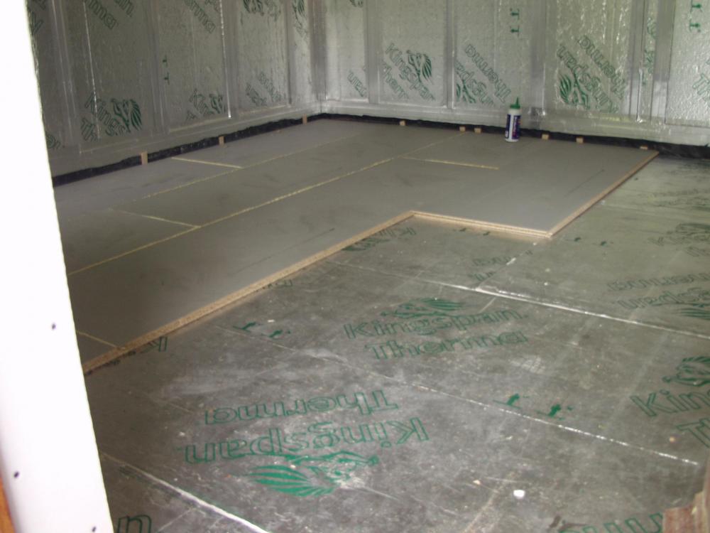

  6. Spot the difference?

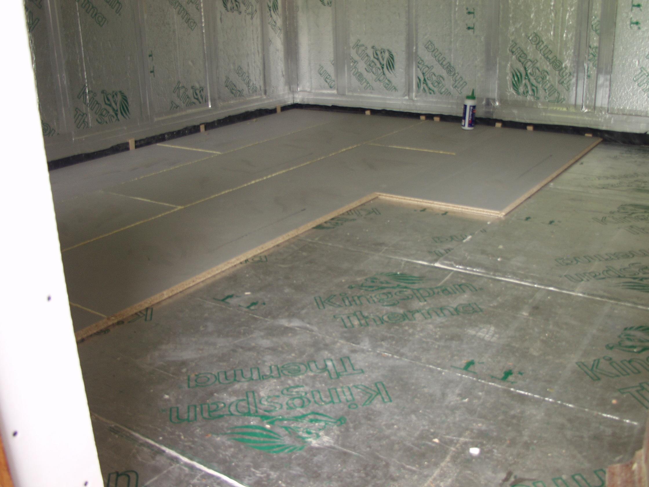

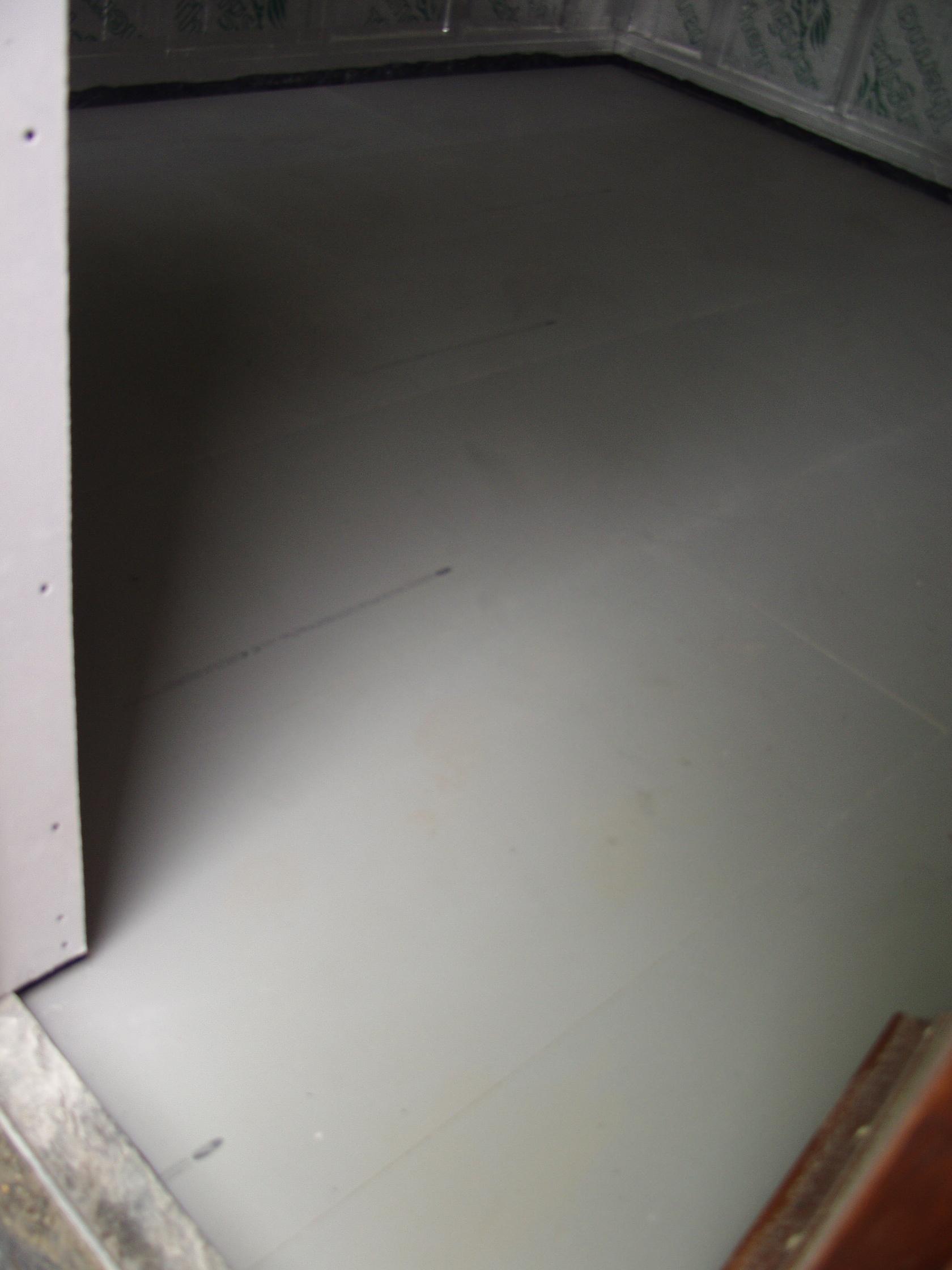

  12. As far as I can work out, I have 2 rows which repeat. The 1st row is easy, LHS one full board @ 2400mm + most of a board @ 1500mm. The second row is doing my nut in. If I do as Russell suggests -& seems perfectly logical re. the grooves' orientation- I take my 900mm offcut from the 1st row, to start the 2nd row, I have left to right: my offcut @ 900mm + full board @ 2400mm + *another offcut @ 600mm. Its this *final offcut I can't understand what to do, if its too small etc, where to get it from. It just does my nut in visualising it (especially the grooves to factor in) until my head literally hurts. This is why it takes me 10x the time of anyone whose done it before.

  15. Can anyone advise here? I guess I have 3 options as far as I can tell. 1) join two boards longways together, wait a day for glue to dry.. then position a few inches away from prior two boards (joined longways, in position) > glue the looooong two sections together. But I've no idea how the glue will bond the 2 boards, to be then lifted as one into position/ whether it might likely break. 2) or I have to contend with a big ~2" gap each alternate end, where I've fixed in a short offcut in (& how I get access to tap it home if the wall's in the way). Or 3) do I fix the one full board in, then angle-in the offcut & fix? this aleiviates the gap (if I can cut it perfectly) but I still have the wall in the way so I cannot get it in tight.
  16. @PeterW useful clip. Was just about to start but more Q's arise. This is why its imperative I don't just crack on without massive time spent prepping/ researching taking me maybe days' worth of prep time in order to proceed with the simplest job, even if it might take only a few hrs. For eg in this case I have my 1st board -in theory- placed. I measure to the wall to get my offcut's L known. I cut it. But because of the wall I cannot get it in . So, I cut a bit off in order to join the t&g. So also needing an extra bit of room to insert it prior to slotting it home.. I'm left with 2 problems: the gap to the wall.. & how I can 'tap' the join together, if I cannot get access to the side. Its all fine to do this like the clip, or in my case upstairs done by builders onto joists with no surrounding walls.. but its a whole different job with walls around the floor.
  17. Understood- good tip re. wedges. Is there a wiggle room period, or is the glue superfast set stuff?

  22. Hi Peter. I'm at last ready to do this caber+ 22mm boards. I've laid the 50mm PIR. (Pic below before last bits put in). First I have two dpm/ dpc's to tackle: the edges where PIR pushes up against has a thinner black dpm- its coming up from below the concrete layer below the PIR, up around the PIR edge, & goes back into timber wall (~50mm above the PIR). At this same entry point, I have what seems to be 100mm of excess (it seems) all round the 4 walls, exiting/ sticking out into the room: this is the other/ the much THICKER textured black dpm. Can anyone advise on what to do with these? bthanks, zoot.
