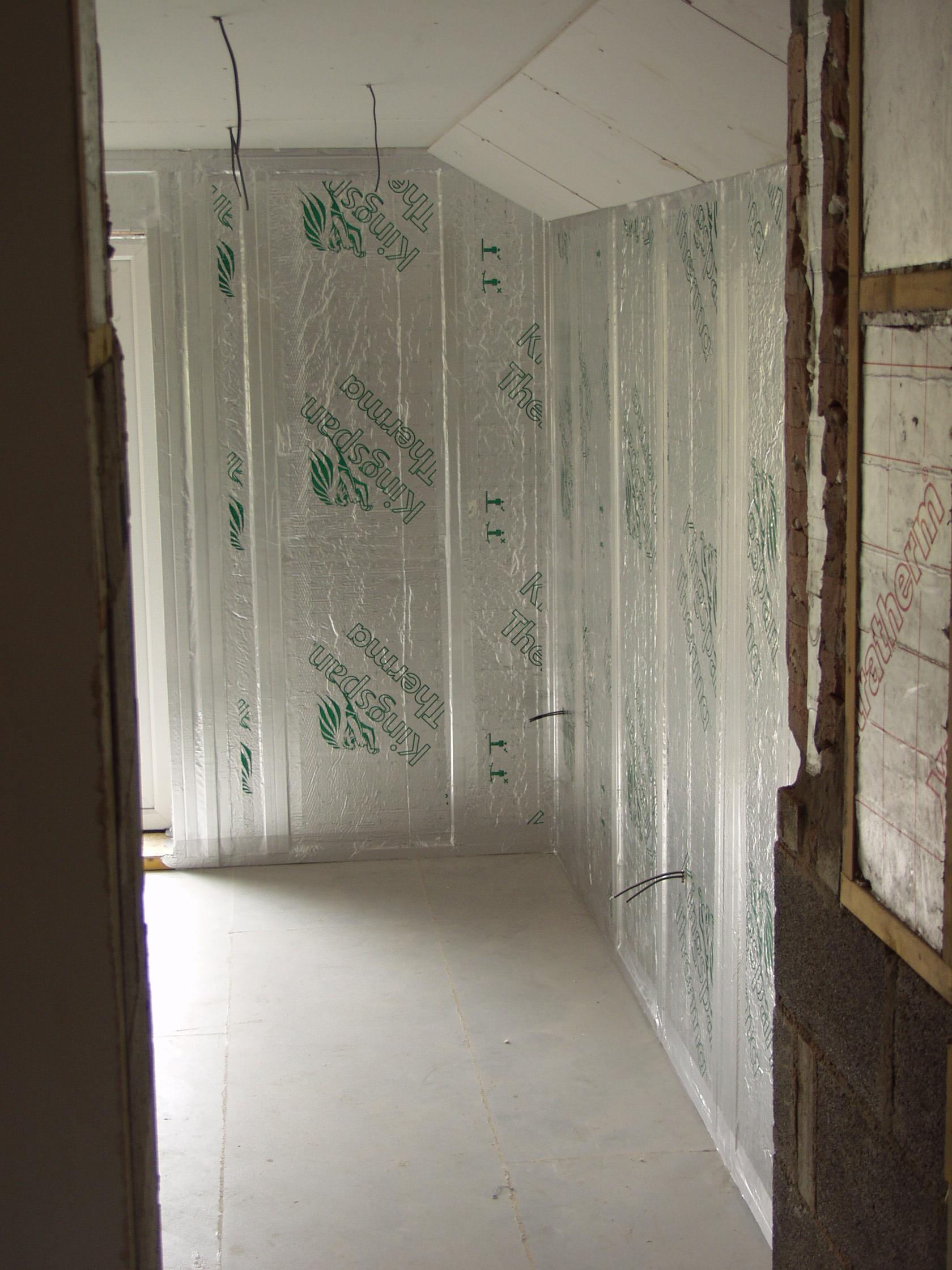

Hi andyscotland. Understand majority of the post thanks. Ok so if as Peter suggests I can can get some stuff from screwfix, then of course it makes sense to consider doing this additional job. But how its done I have no idea. Your last paragraph above: when you say cold side of the insulation, do you mean the backside (foil-back) of the PIR? or the thick shiny vcl outside of the timber frame, in the cavity? or do you mean the face-side of the PIR? (showing in my photo #1)?

I think I need to call the BCO to ask.. but I was putting off calling as he'll likely ask 'whose your electrician?' (I dont want to jeapordise him knowing me & chap doing 1st & 2nd fix.. then a part-p reg'd other chap is jumping on board to check all > give me the doc). Is there no-one on here that knows if a vcl layer over my PIR is compulsory with a timber frame build-?
£15?? ok so the cost is no issue then.. great. But Peter, I can't decide to add it or not.. if I don't know if its needed or not. If its needed > I add it. If its not needed > I don't. (I'll get to the foil tape stuff wtf it is & where it might go once I can establish if a vcl is to be done, or not).

Hi Roundtuit. Ok, I understand that it might not be a biggie to 95% of folks on here.. but to me whose never seen a vcl, totally on my own, it is a biggie (& it also might cost +£600.. I've no idea whatsoever). I just need to establish if, in order to pass Building Regs, it is compulsory or not. Once I know the answer to this, I can research A) what it is B) how maybe to do it, & C) why on earth its needed at all.
