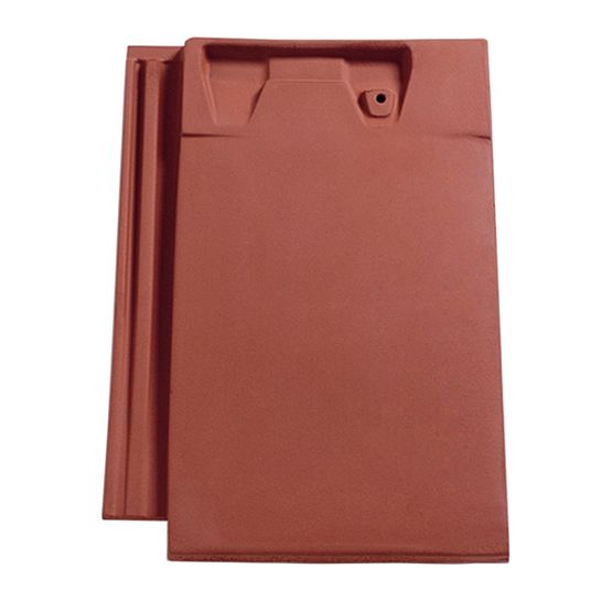

I believe this is the tile. The lead soaker would cover the indents at the top but not much more or it would be visible. Is that enough to ensure its waterproof on a low pitch? -

I've got a feeling not all interlocking tiles can be done with soakers. The soaker messes with the way they interlock. Perhaps get a few samples and do a mockup? Generally flat tiles must have lead soakers not just a flashing strip over the top. Pantiles can get away with just a strip on top if it's wide enough to cover one hump in the tile. Their guide on low pitch roof also says.. -
