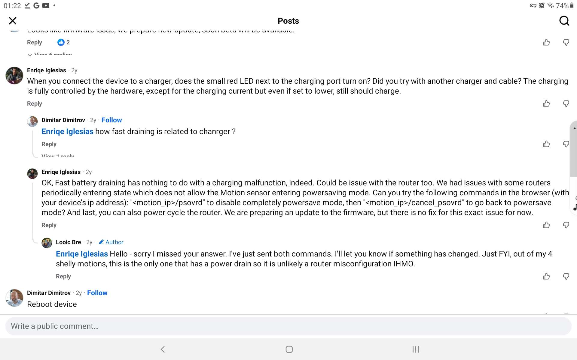

Battery life on Shelly Motion sensor not good
Temp replied to Adsibob's topic in Networks, AV, Security & Automation
Yes it appears to suggest you just browse to the URL.. <motion_IP>/psovrd (replace <motion_IP> with the IP address of the device) then to <motion_IP>/cancel_psovrd. I don't know if it will actually return a web page each time. -
Seems others have had similar issues but I couldn't find a recommended solution. Some say firmware, some say WiFi range etc. https://community.home-assistant.io/t/shelly-motion-sensor-battery-draining-fast/568442 https://www.facebook.com/groups/ShellyIoTCommunitySupport/posts/7363638563735444/ https://www.facebook.com/groups/ShellyIoTCommunitySupport/posts/5593851320714186/ I wondered if something was trying to talk to it too frequently increasing power consumption due to increased WiFi traffic? Found this on that last link above.. -
