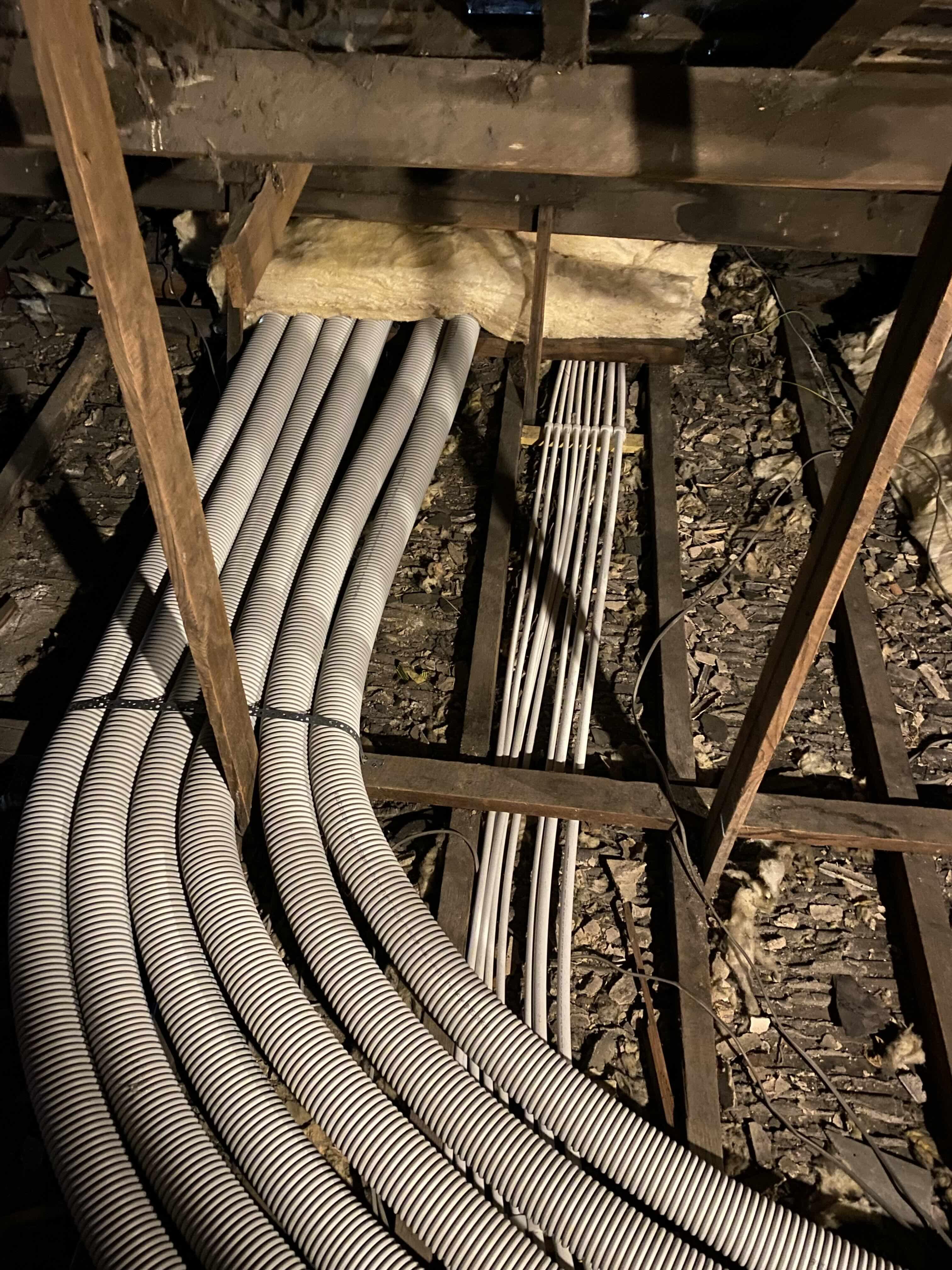

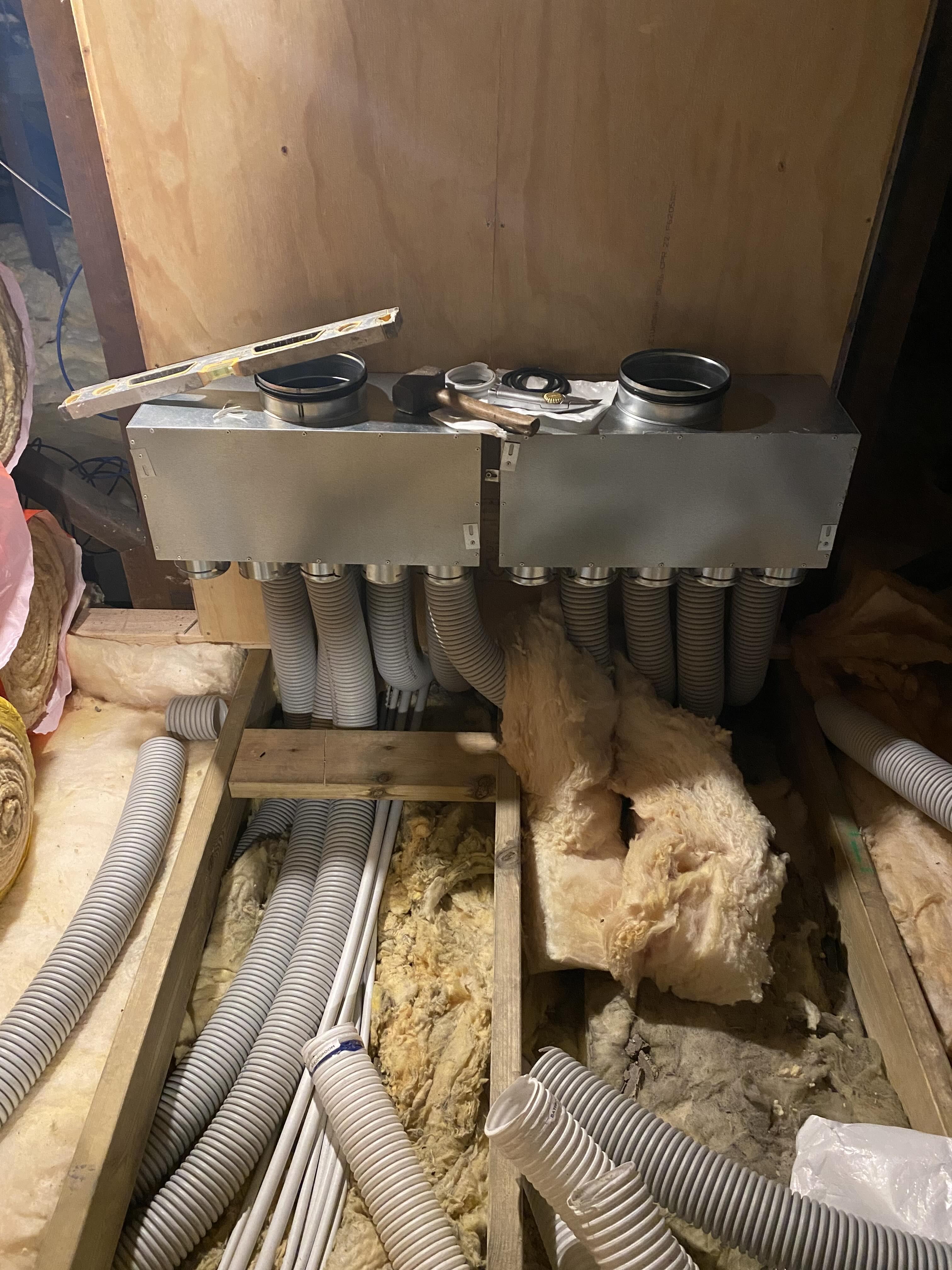

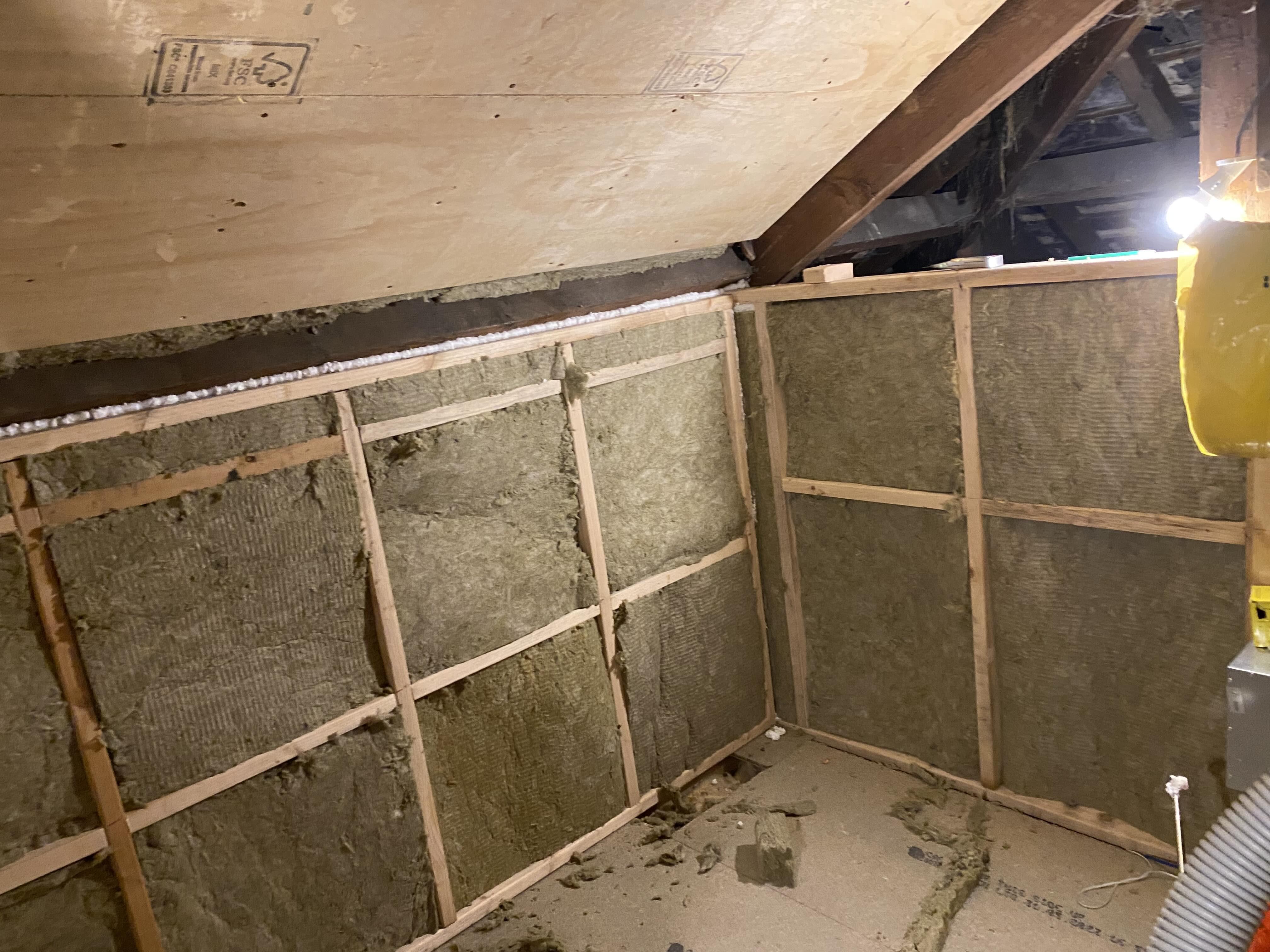

  21. I ran them under the loft insulation and built an insulated "room" in the loft for the MVHR unit, water manifolds and any other, lightweight, plant I may need (comms etc)
  22. It probably took me a week to run 7x supplies and 8x extracts in my renovation, that was traversing solid joists, hiding them in stud walls etc. fitting all the plenums (inc. sealing the first floor penetrations), creating a stud wall to mount the 2x distribution boxes on and hooking everything up. Certainly DIYable, but it depends how much you value your time, £1,500 isn't a massive amount in the grand scheme of things and it could allow you to be cracking on with something that's far more expensive to have done by someone else.
