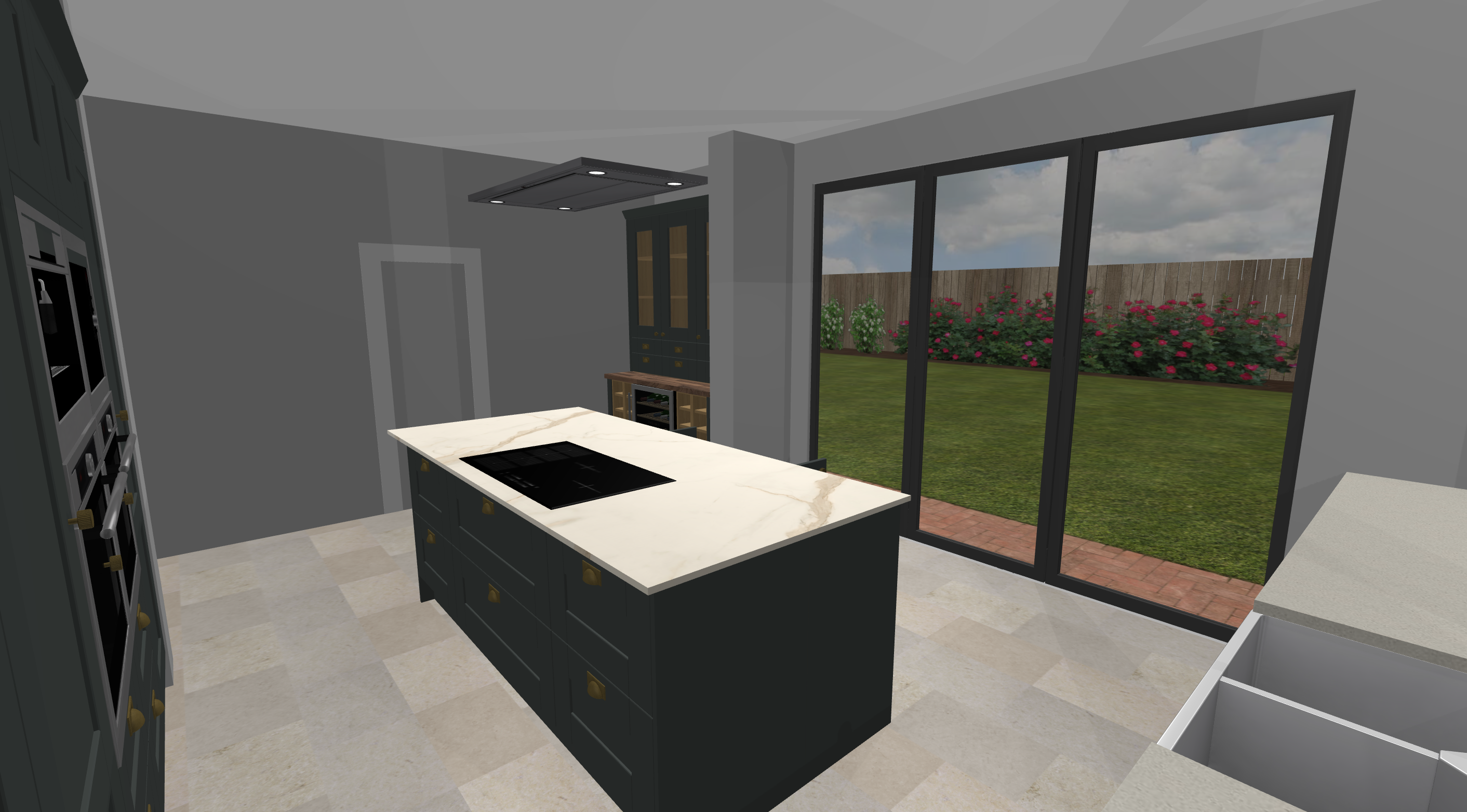

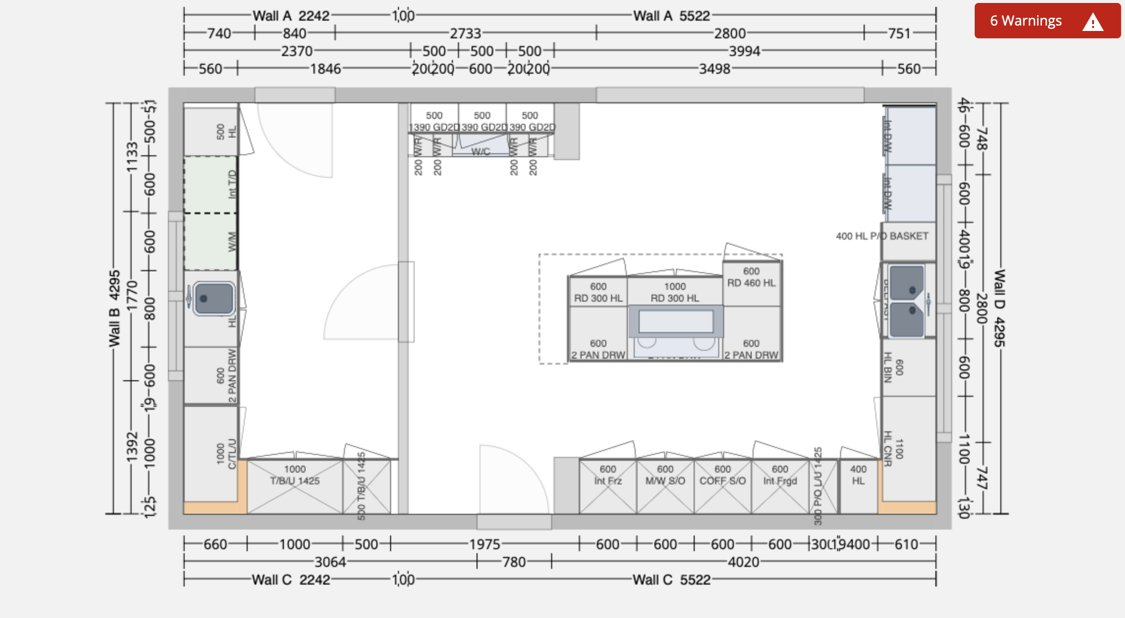

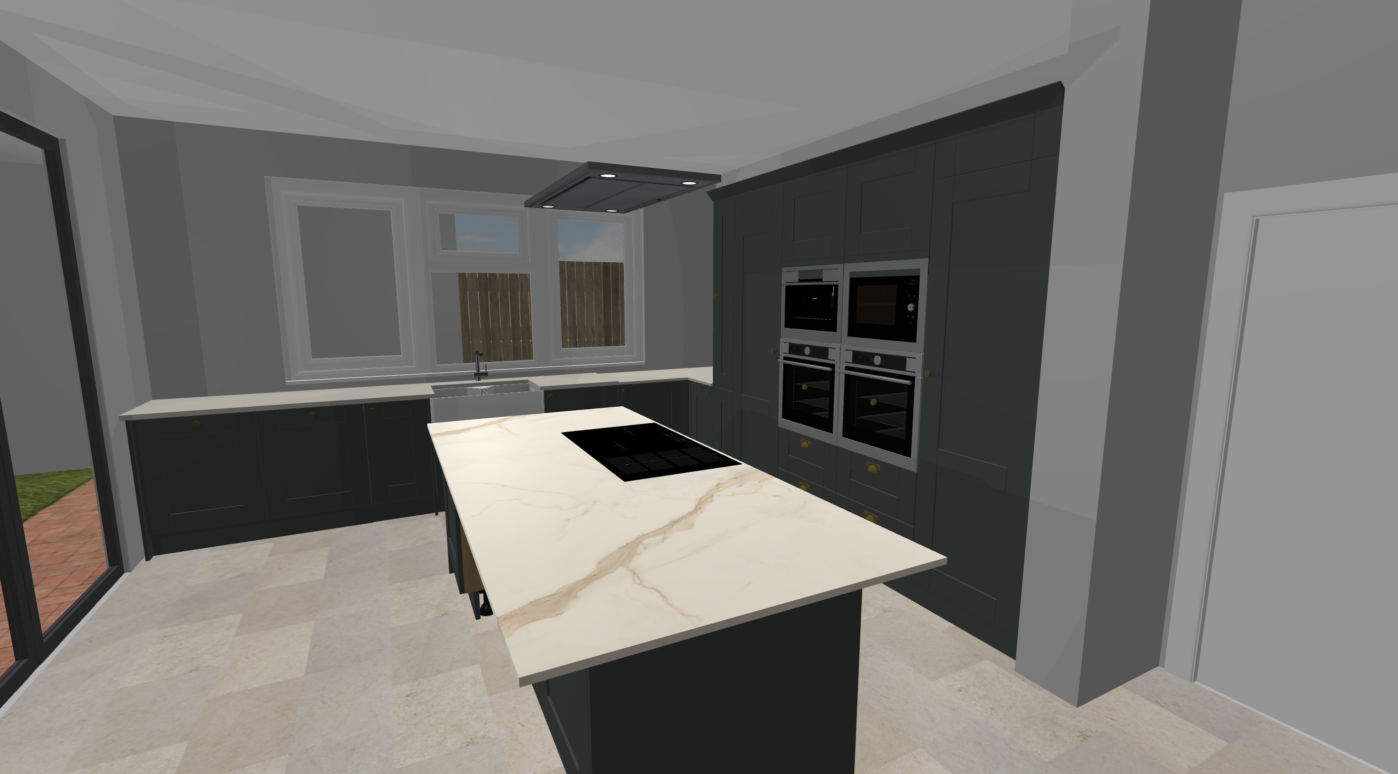

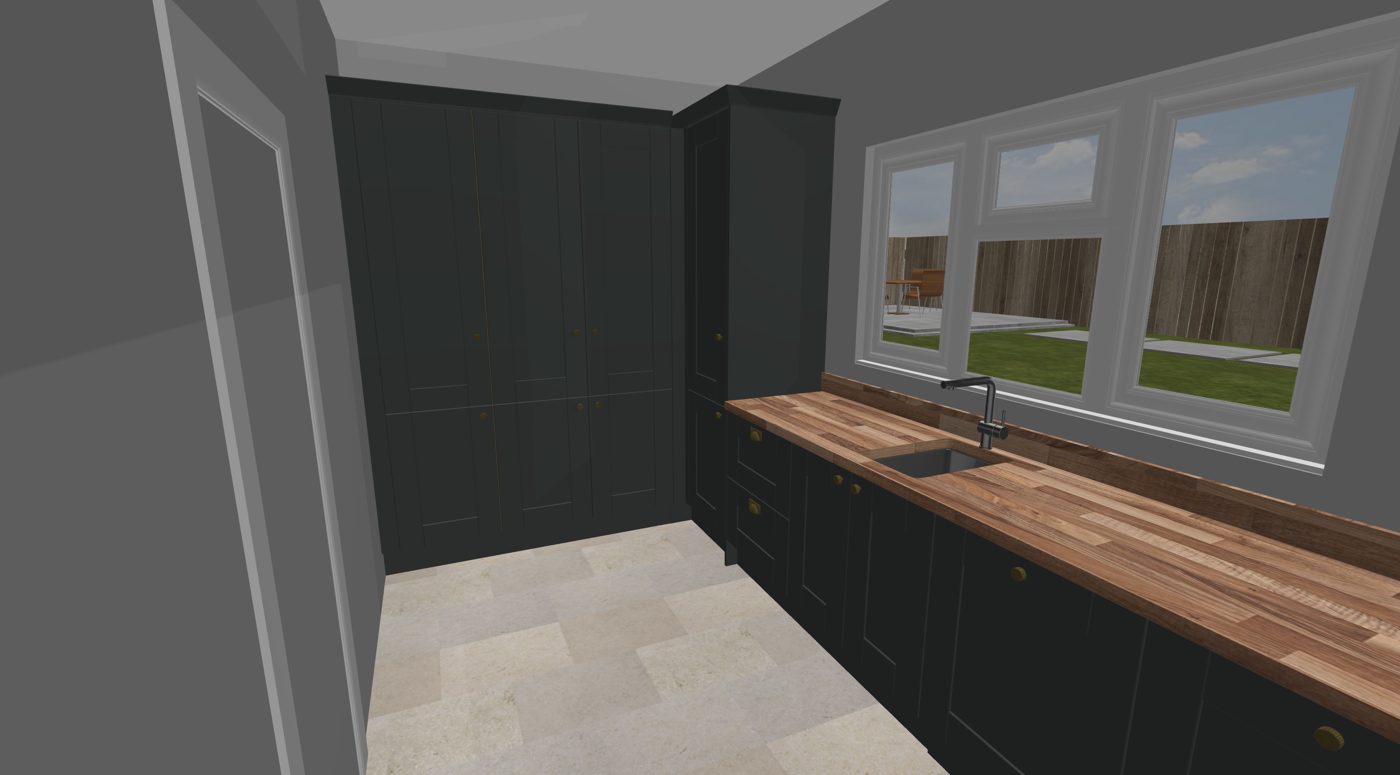

Been toying with this for a while now and think we're finally ready to pull the trigger. Would appreciate any and all constructive criticism before we do. For context; Clearance around the island is 1050mm, would have liked more but to get the units we needed in a layout we liked this was the best I could come up with. All services, where possible will be overhead and dropped down, of course services to the island will be in the slab. Service voids overhead and to the West and North/West side of the North wall (up to the column), rest is cavity wall, wet plaster on brickwork. Plan is to run a 110mm waste pipe left to right, picking up with utility and kitchen drains, leaving the house under the kitchen sink (which is nearest to the mains sewerage connection) House has MVHR, hob will be induction, not quite landed on the type of ceiling extractor yet (after reading a handful of threads on here), will probably opt for a cheap-ish recirculating extractor and grease filter cone in the kitchen plenum to catch anything else.
