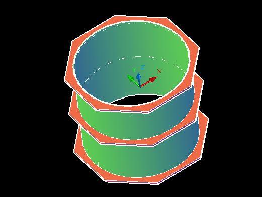

Make accurate 4-piece sandwiches for each "ring"? Then all bolts & glues together. Circle here is 1830mm dia but can change easily

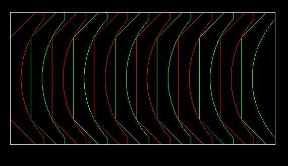

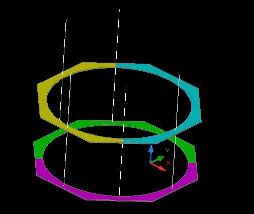

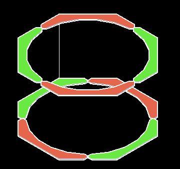

Say 3 "support" rings, each made from 8 identical bits of "mdf or ply.
12 bits per sheet so two sheets gives 24 pieces - enough for 3 rings:
Little wastage. Could clamp two sheets together and jigsaw but cries out for laser or water jet imo:
Orientate:

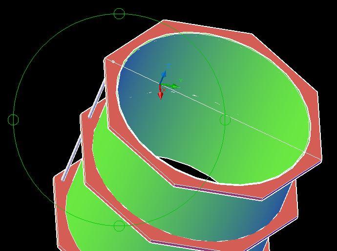

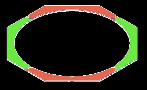

Clamp/glue/screw. They're 1830 across flats. Inner circle to suit:

Ply as drawn is 25mm as in each "eigth" is 12.5mm ply. Work in progress this but I can CAD it up. Well worth thinking about asking a local water jet cutter to you. You'd get a super accurate kit of parts to just assemble. I could do a DXF file the water jetters could put straight on their machine.

Have a phone around and see who'll cut MDF/ply. Just a quick Google near you and there's London Water Jet, Rapid Laser, Middlesex Laser and so on. Engraving type places might not be able to cope with an 8'x4" sheet btw. Out of interest if you cut MDF with a water jet the edges swell a tad then shrink back!
We can easily knock up something on CAD if you want and I'm sure the collective will have plenty of input.
HTF will you get it up? Scaffold tower and assemble in situ?
I'd likely Sikaflx and pin the MDF to the 25mm edges. Bendy pb to that with pb screws and let the spread do his magic after.
