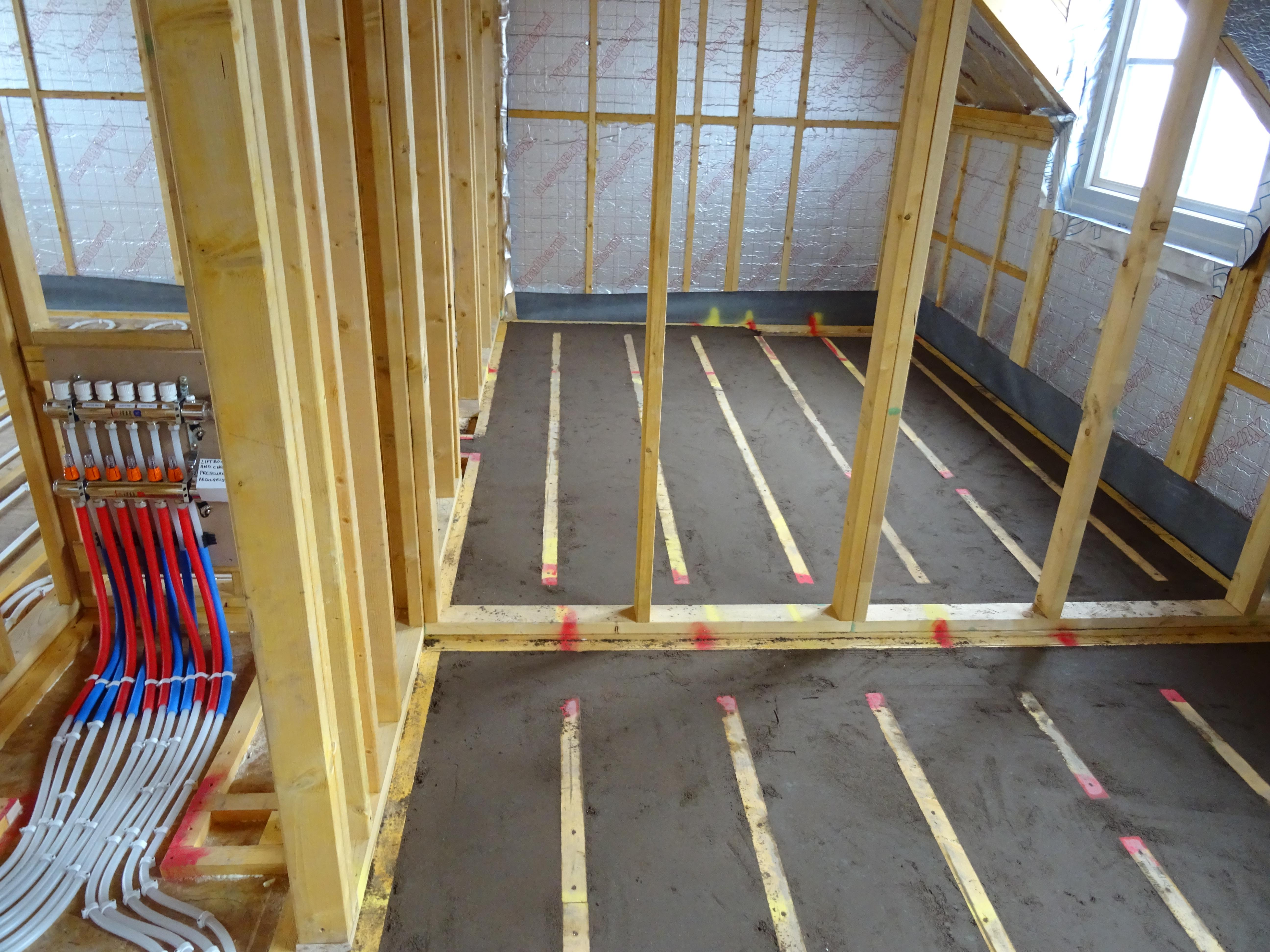

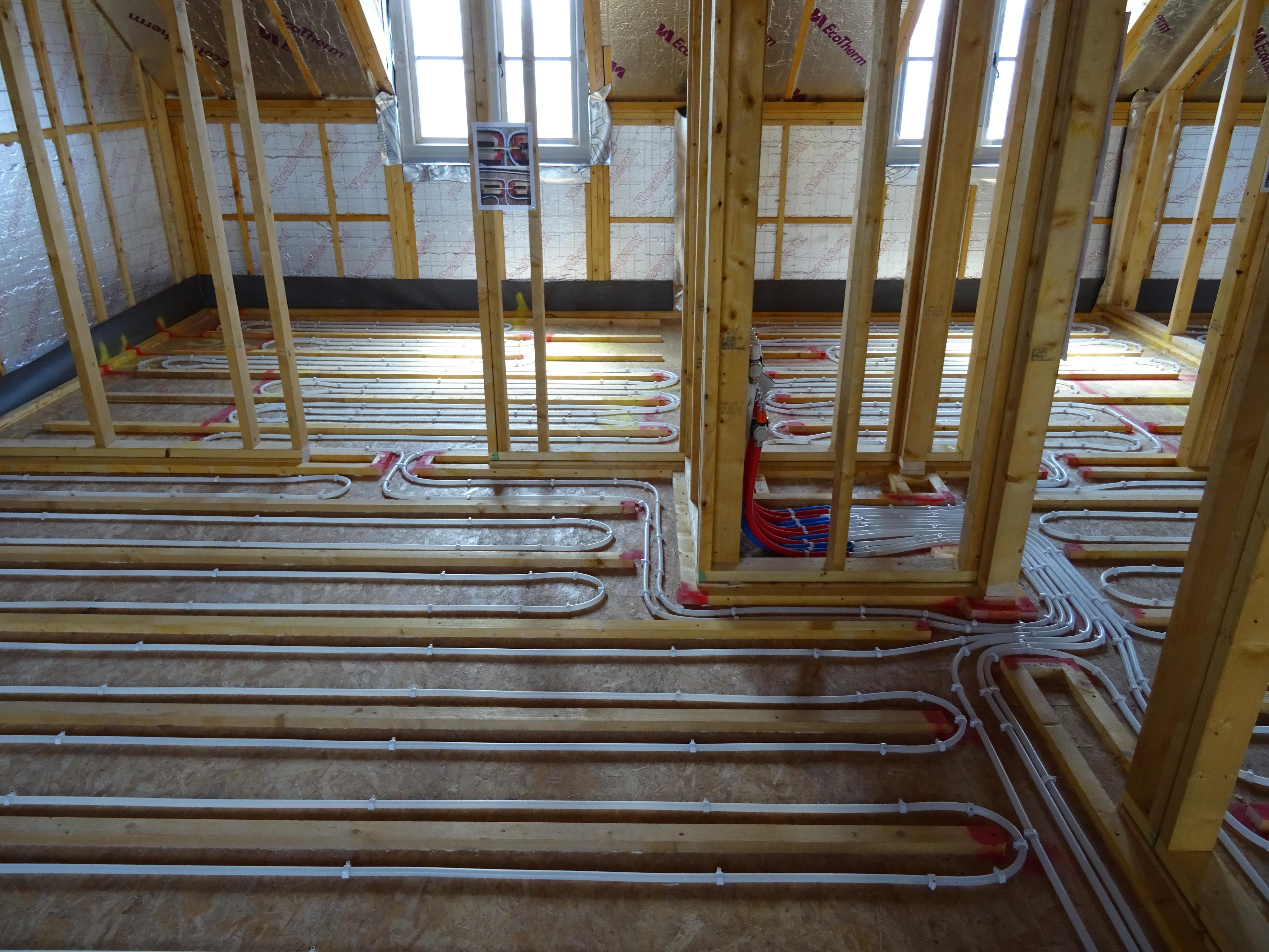

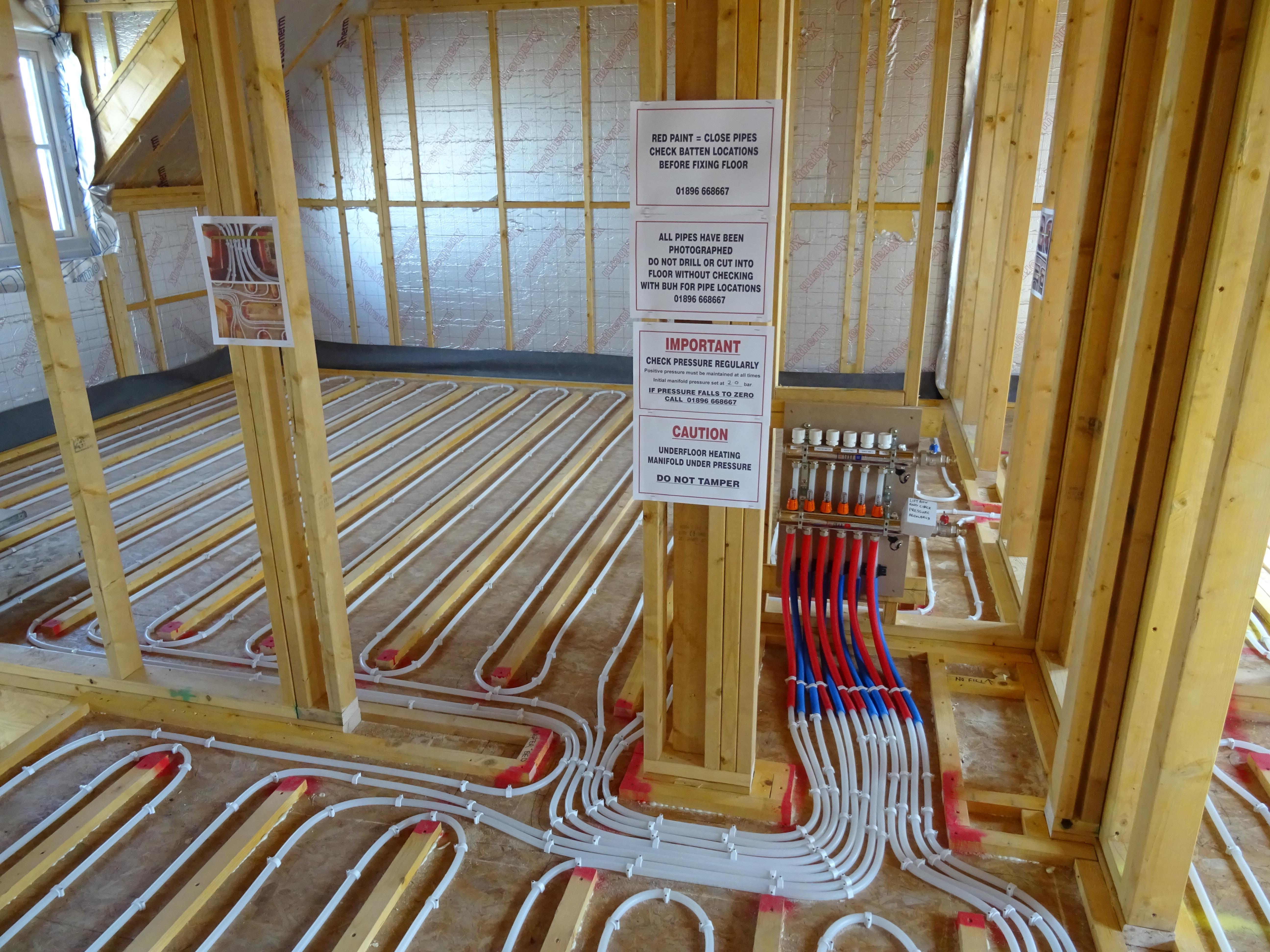

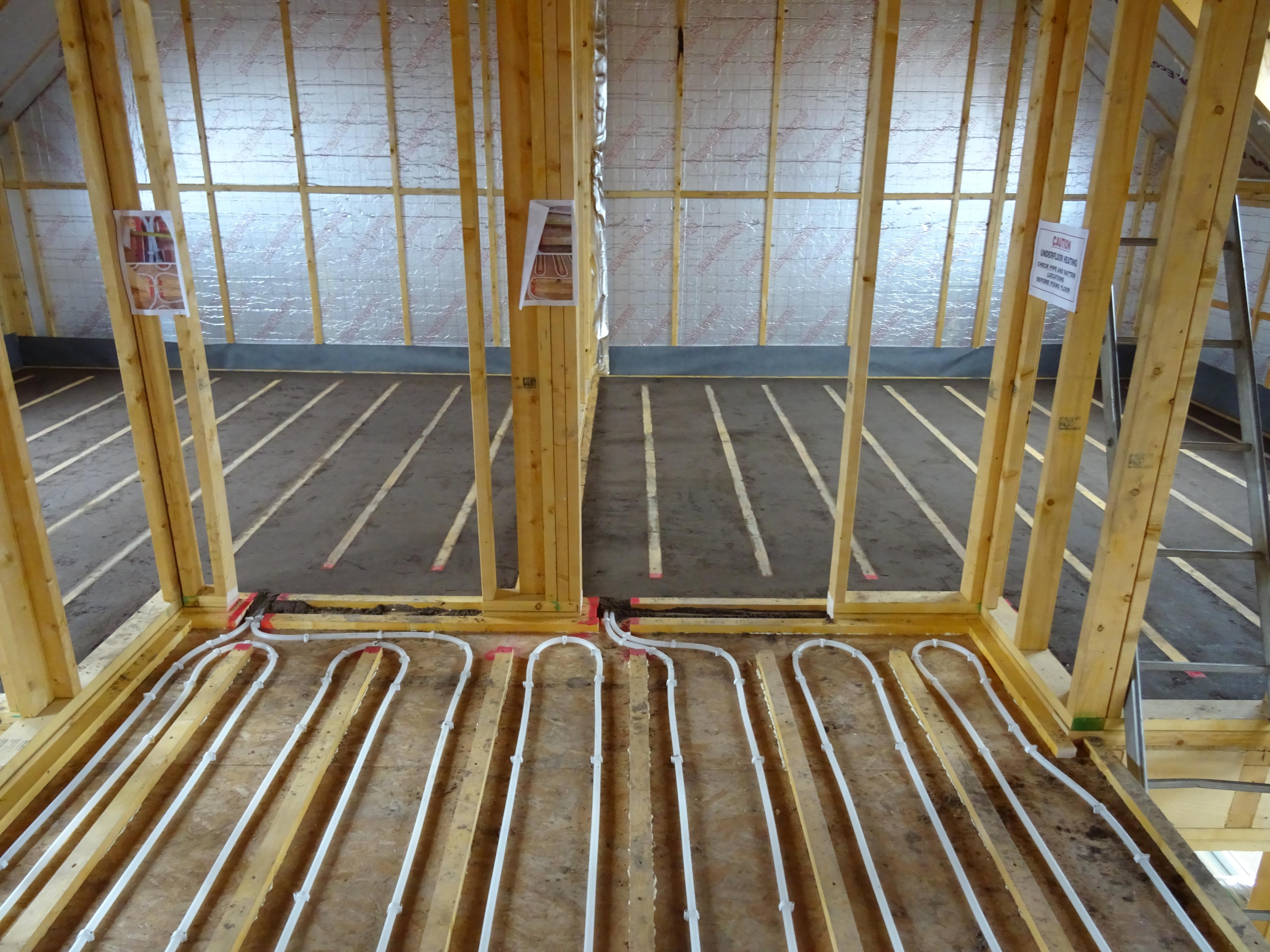

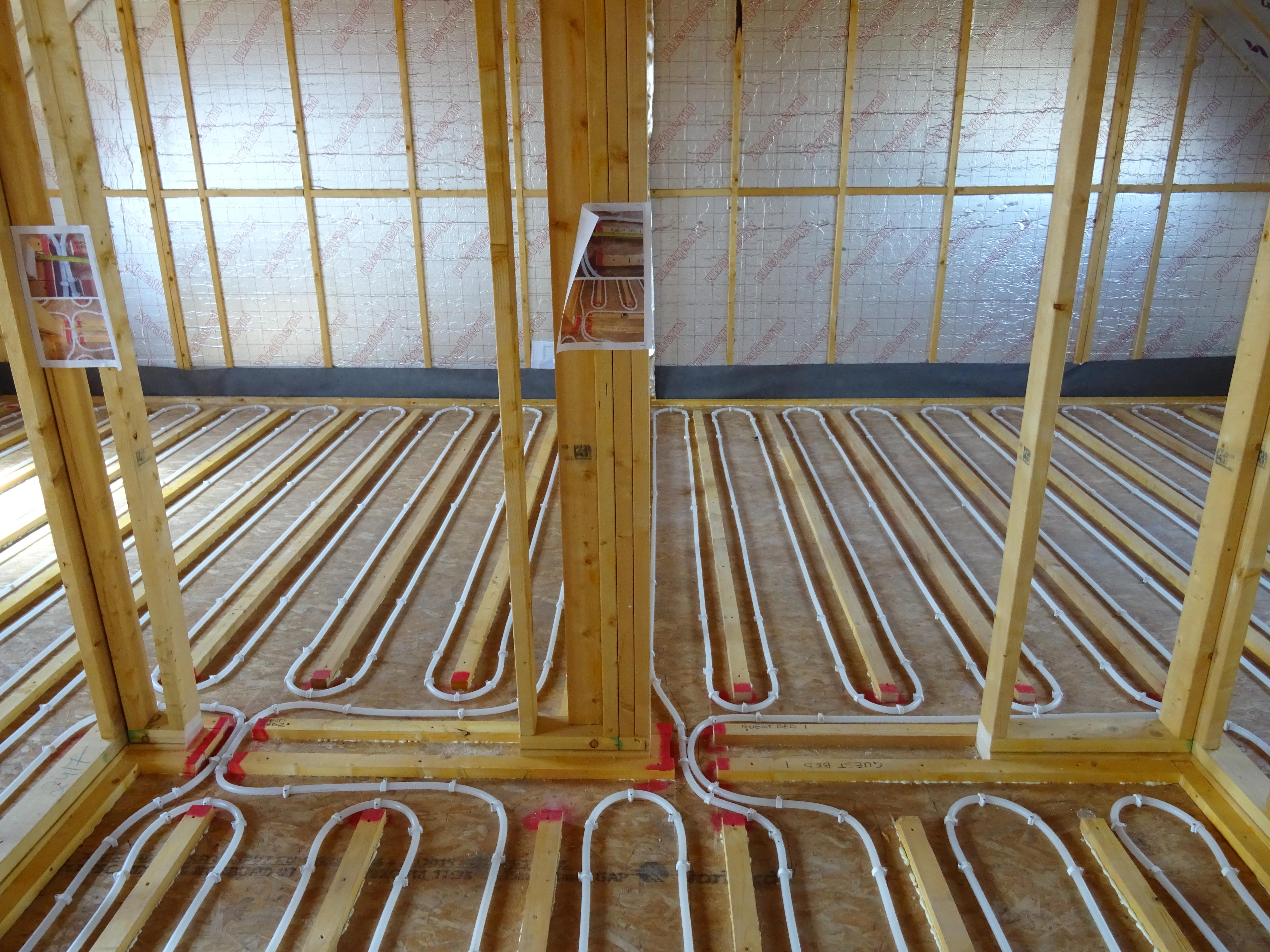

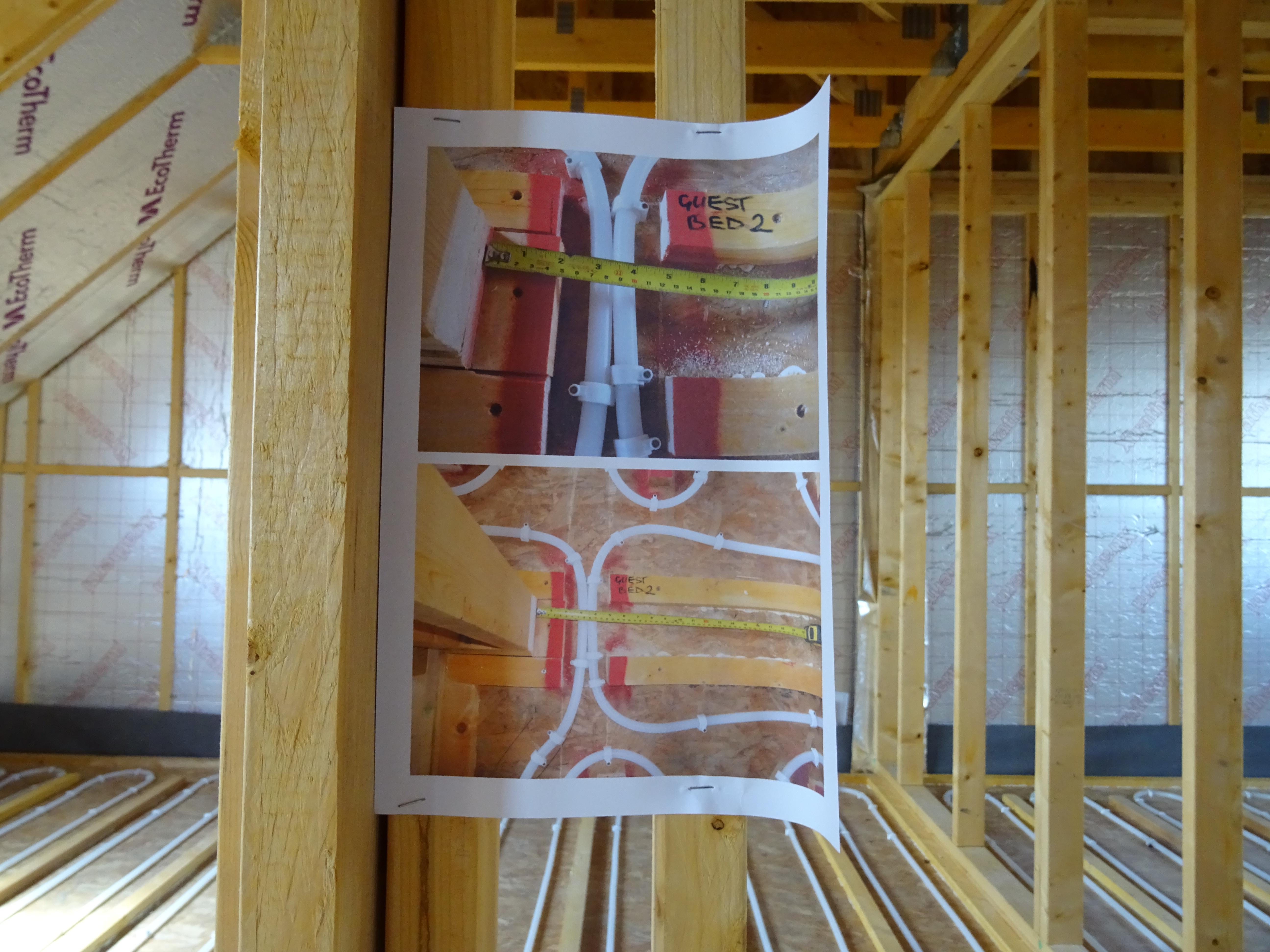

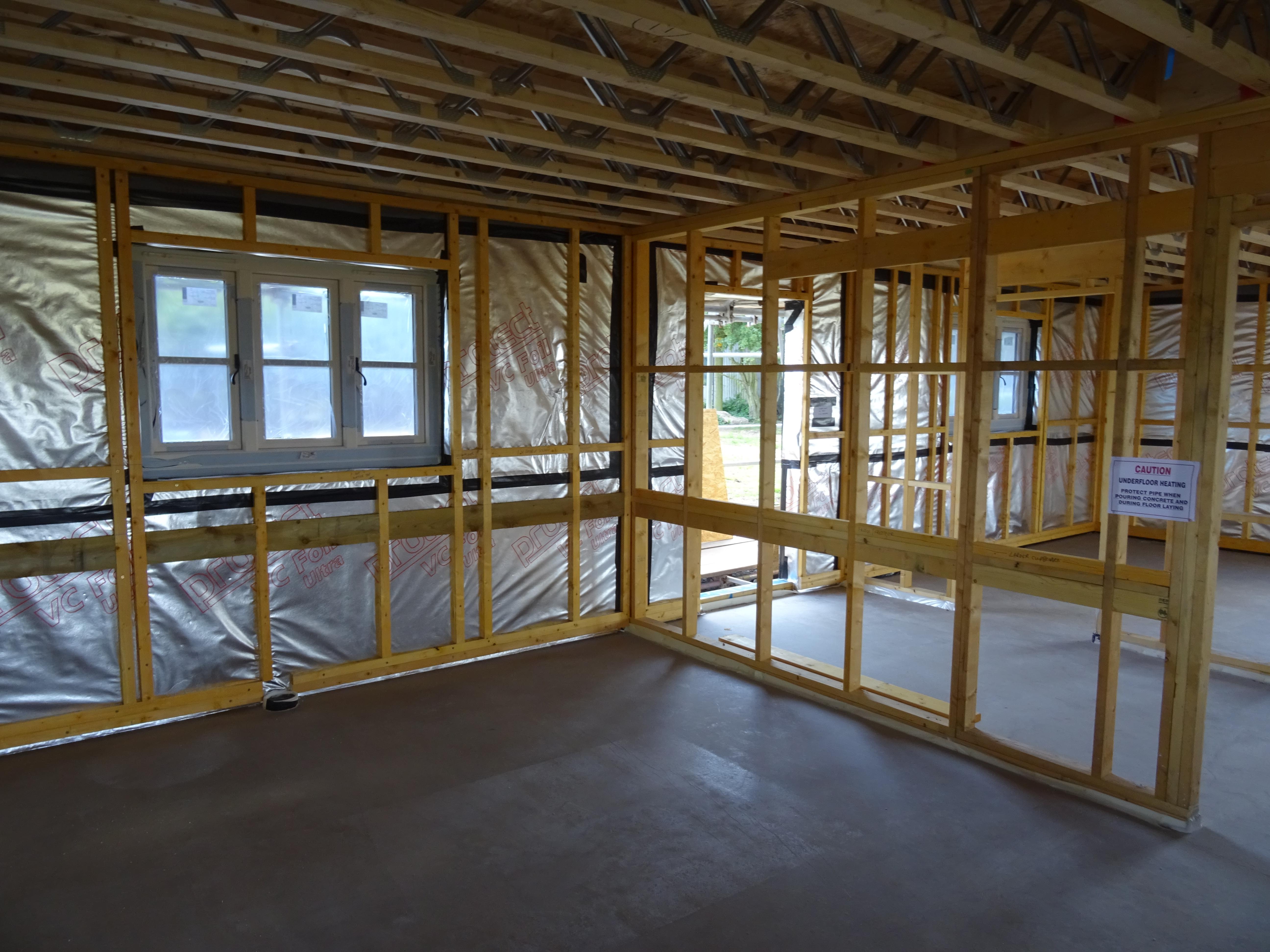

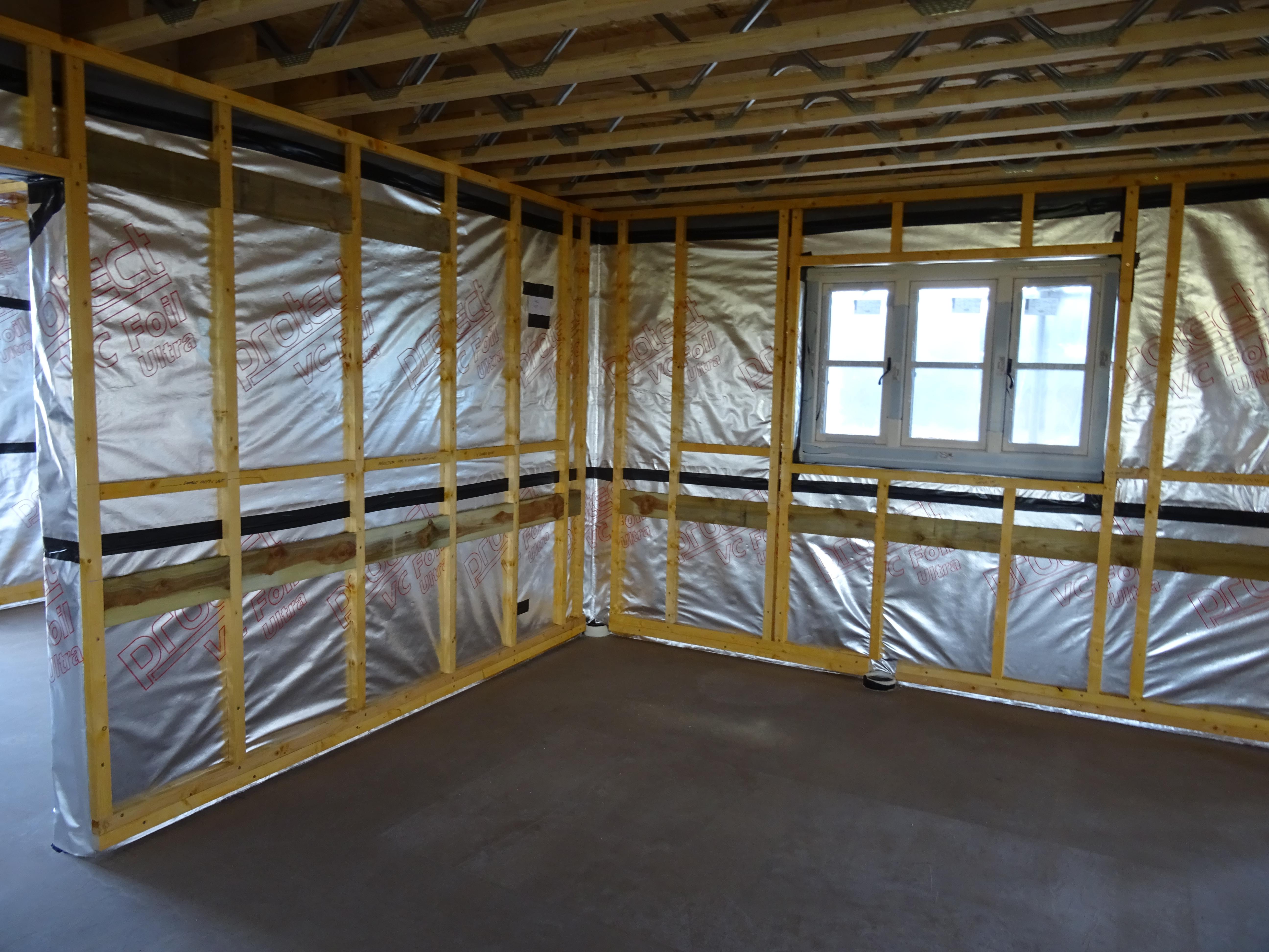

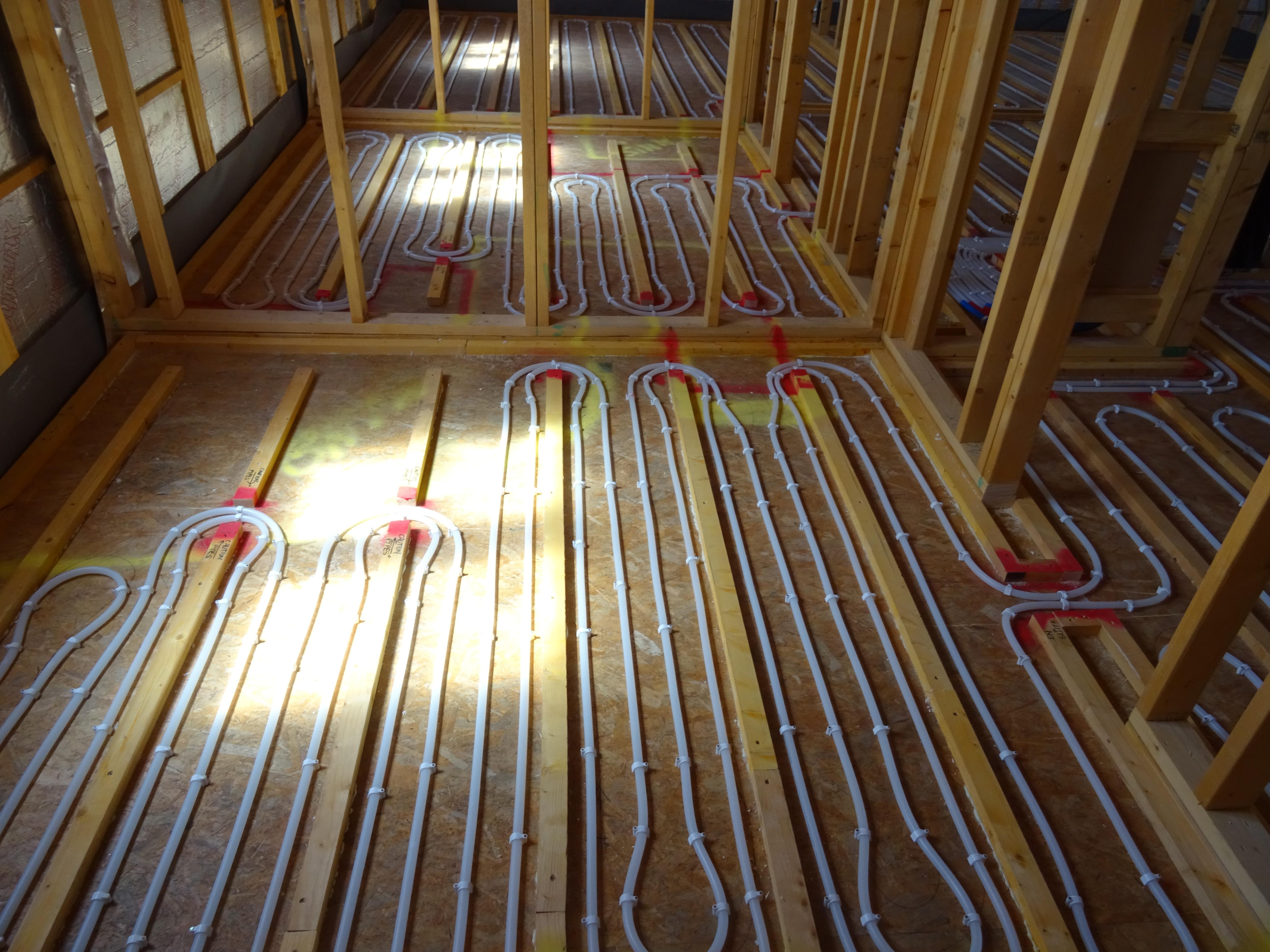

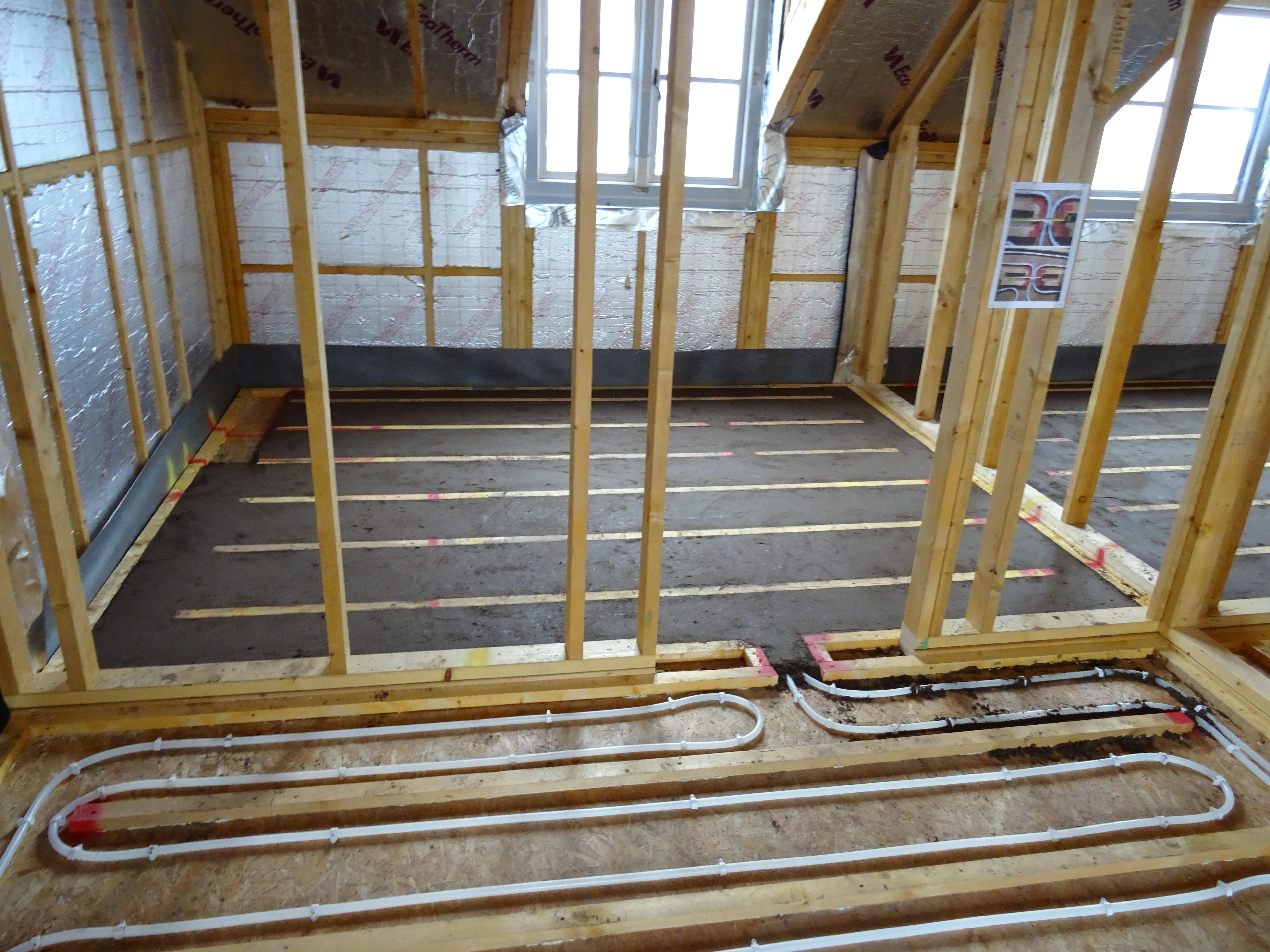

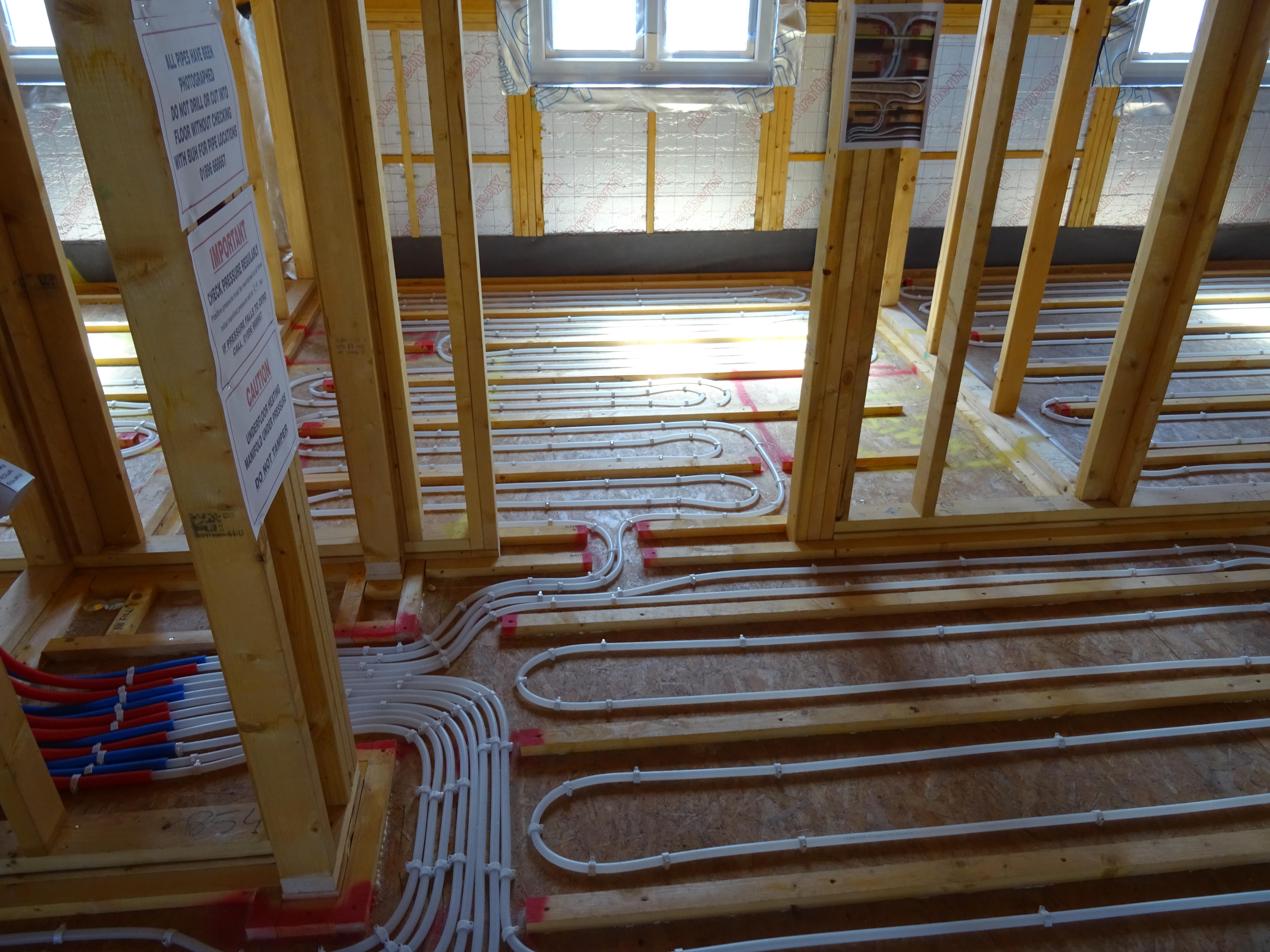

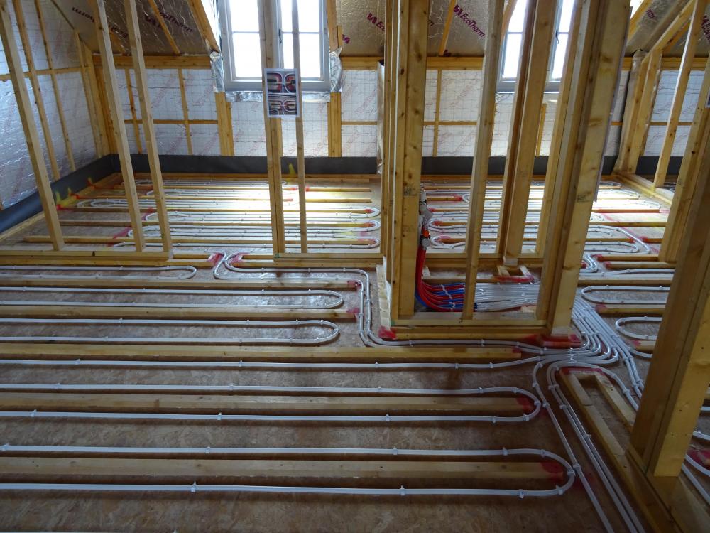

A few more images showing the completed UFH network for upstairs, the servicing battens downstairs and also some additional "supports" to accommodate the fitted kitchen units.
I have really been impressed with the UFH fitter - he has even supplied photos of vulnerable positions so there should be no excuse for puncturing a pipe after the screed and boarding has gone down. You will see the areas left "unpiped" in the en-suite and bathroom areas. The manifold is stored in the landing cupboard.

That is a very tidy job.  I wonder will they leave out the screed upstairs on the bits where lots of pipes run together to the manifolds?  That's what I did otherwise that area might get too warm.

That’s very tidy ..! Surprised he used ordinary nail in pipe clips but they’ve done the job. And the floor fitters can’t exactly say they didn’t know where the pipes were ...
Good point @ProDave I will discuss this with the UFH  fitter and screed layers Monday - thanks.

that is a really neat job - lot of attention to detail from what I can see; I wish our frame erector had done a job half that good.
Upstairs - what depth were the battens you put down and what thickness of board did you put on top of it? (I'm assuming you screeded between the battens).
Looks really good so far - you must spend some time on cleaning and tidying!

Was going to ask about the lack of spreader plates. Neat job :)
The battens are 33mm deep and the eggerboards going on top will be 22mm The screed is a lengthy job as it has to be transported upstairs in buckets by yours truly whilst the lad is mixing and the builder spreading ! Should be finished tomorrow though. These pictures might also assist.

Yes sorry @CC45 forgot to mention last time round - It is 8 parts sand and 1 part cement with a splash of water. Tested it today and what was laid yesterday is rock solid.

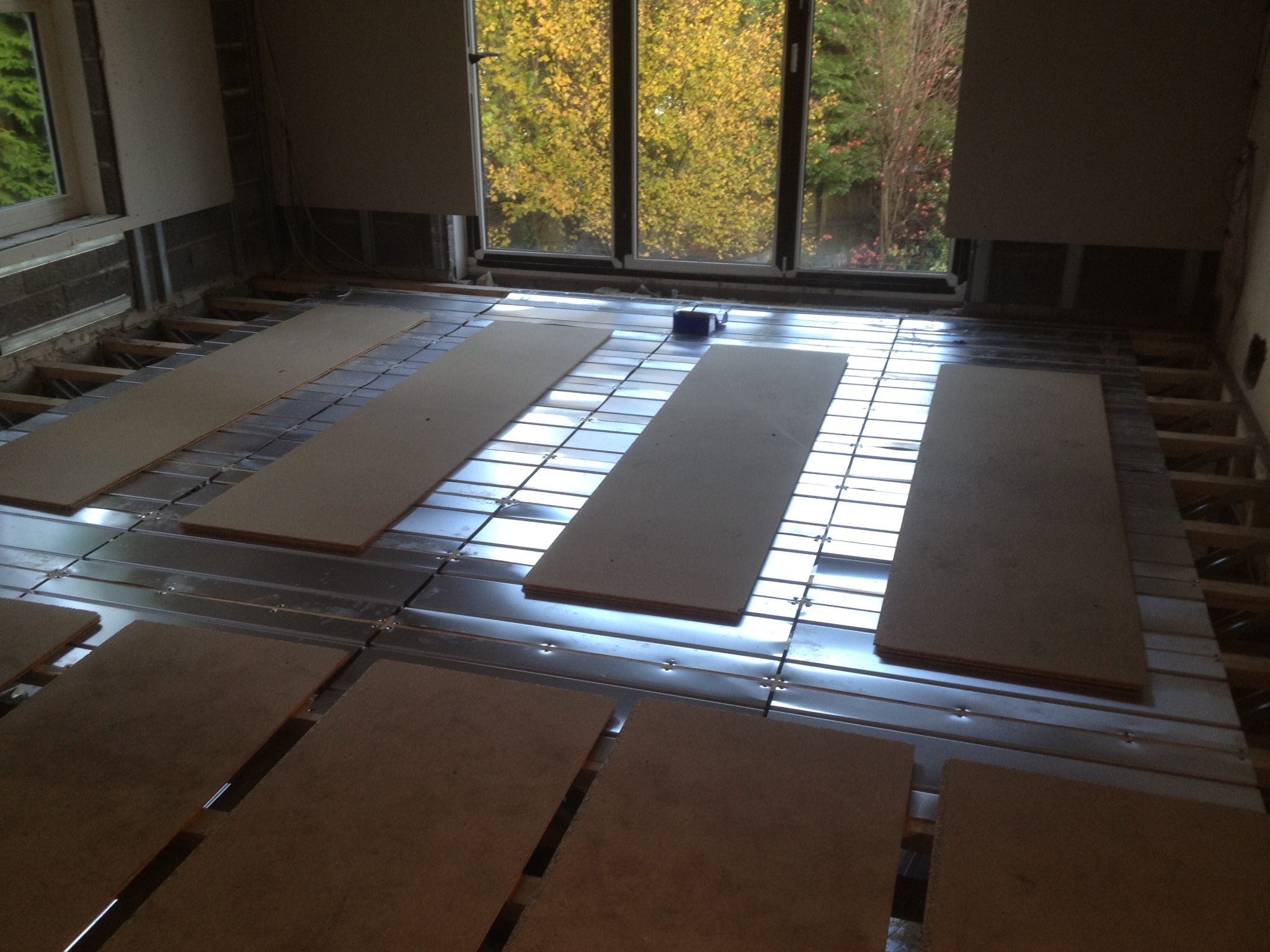

I still don't see the attraction of the pug mix for UFH when spreader plates are so quick and simple.
And not a bucket or cement mixer in sight. Plates, pipes and boarded in a day and a half.
Agree though, neat job and a good clean workplace. What's the intended floor covering over the pug mix?

The covering will be 22mm egger boarding which went down today - a combination of nails via a nail gun and glue.

Surprised you had 38mm battens. I found 25mm is plenty for 16mm pipes and the pug mix.  I fixed mine down with plastic P clips (cheap as chips from CPC) and large headed screws.  Last time I used the nail in clips and found they had a tendancy to pull out easily when just nailed into OSB
Our first house had the same UFH system and just had standard timber joists. The frame designer was aware of the UFH method.  This time round they specified JJI joists downstairs and and Posi joists upstairs.
I did our UFH mix 5 parts sand to 1 part cement, and to do our living room took just over a ton of sand. That was a dry mix, well just using the moisture in the sand no water added. It has set hard. Easy to mix in a mixer and barrow in, and because you are mixing dry, a joy to clean the mixer afterwards.
I chose the pug mix method as we had the sand and cement left over, so cost was £0  I would have had to buy some spreader plates, and then dispose of all that spare sand and left over cement.
Of you paid £4K extra to upgrade the josts for pug mix UFH, I think I would instead have bought the spreader plates.

Oh, and all the photos of the pipes / timbers / intersections will be invaluable for the ongoing trades. Top idea.
