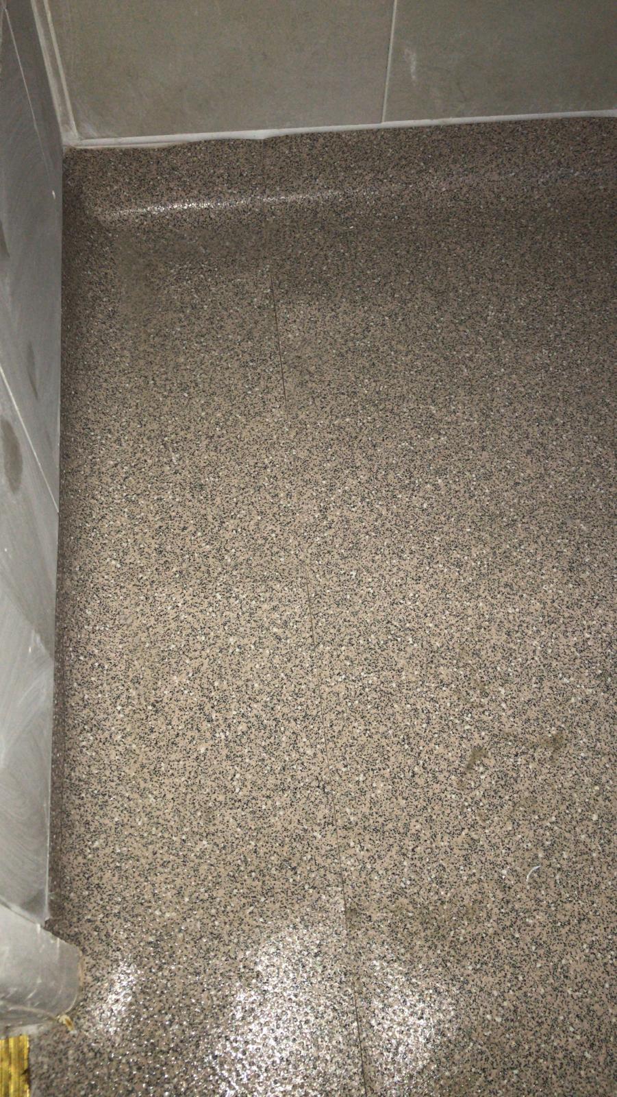

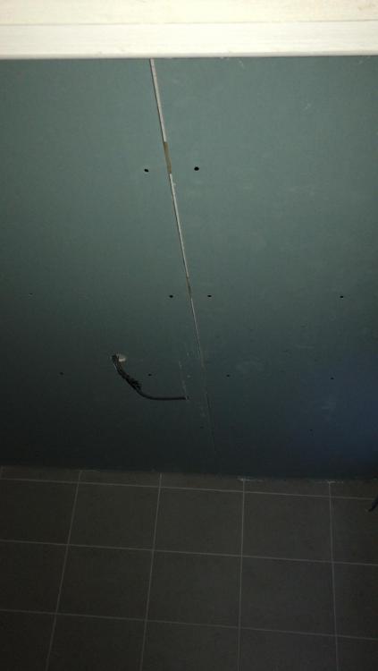

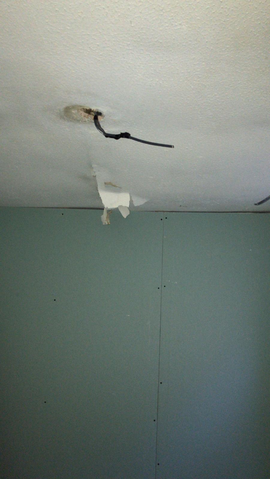

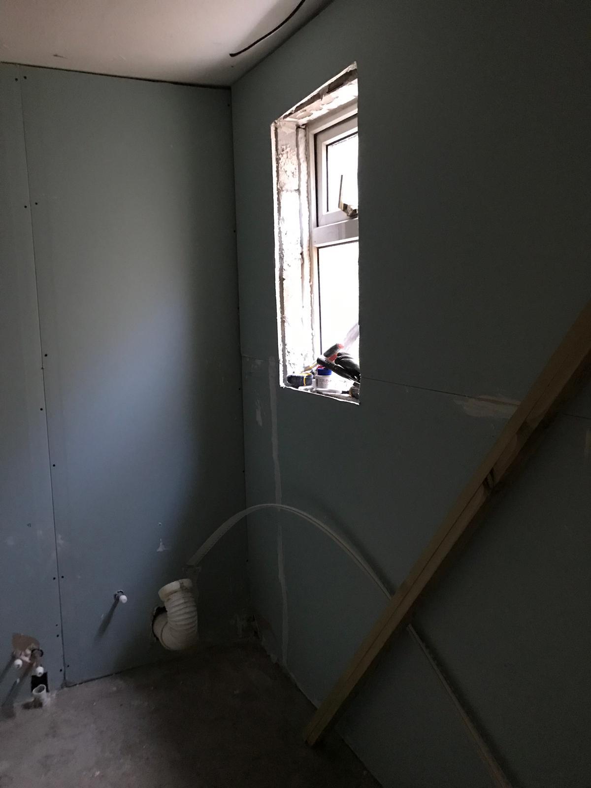

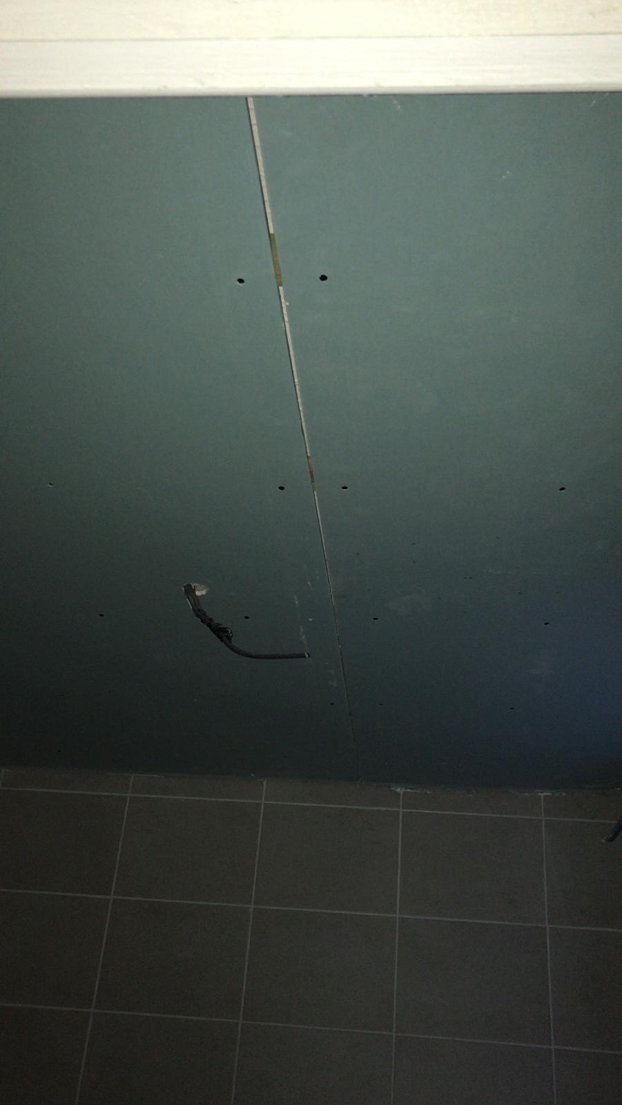

The attached photos are of a ground floor bathroom that is being converted into a fully tiled wet room for a disabled child.

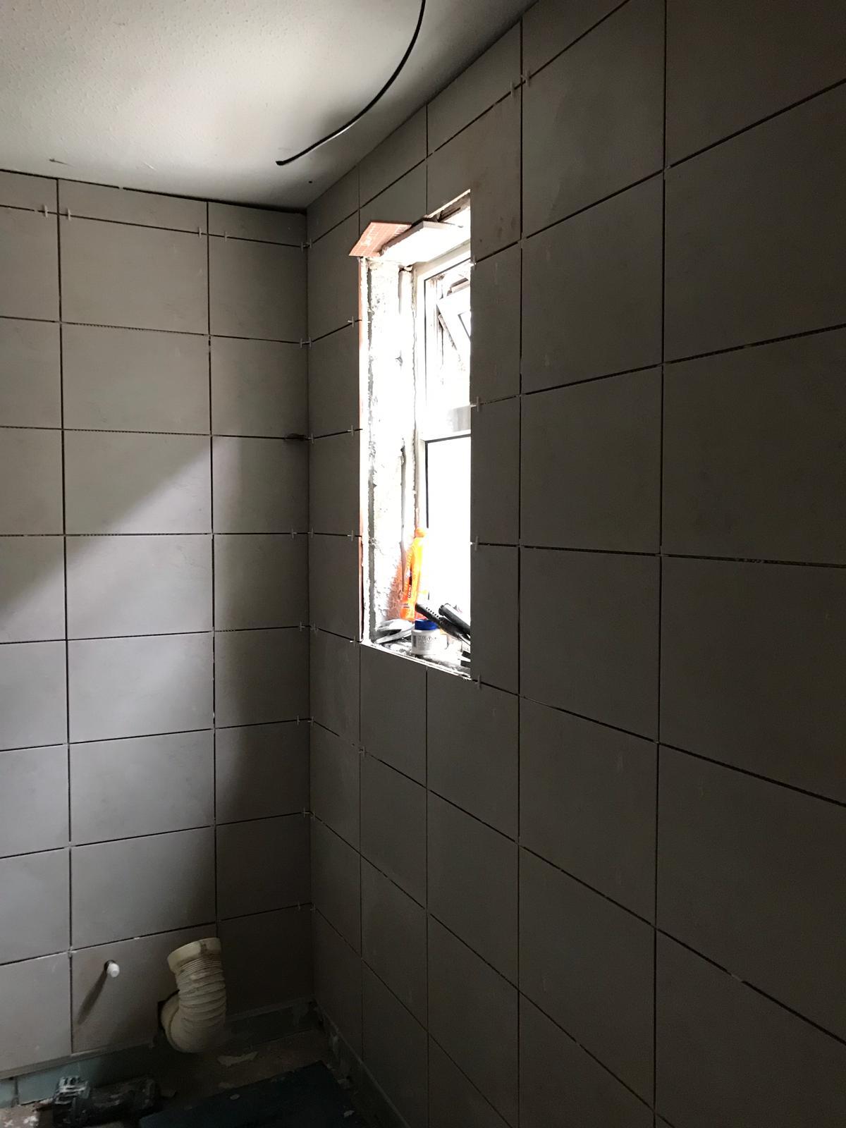

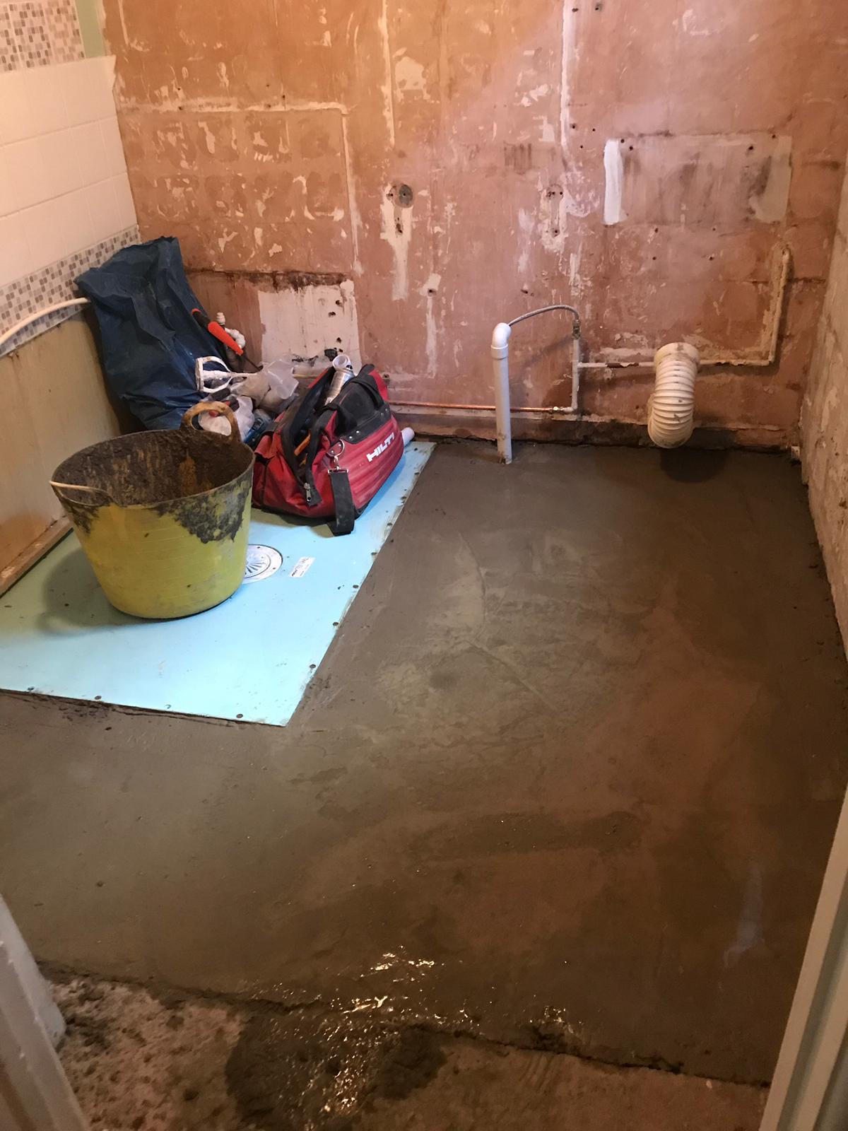

It has been totally stripped back to bare (block) walls. The ceiling is to be overboarded.  The whole floor has been dug out several inches and had some sort of screed laid and a pump for drainage.

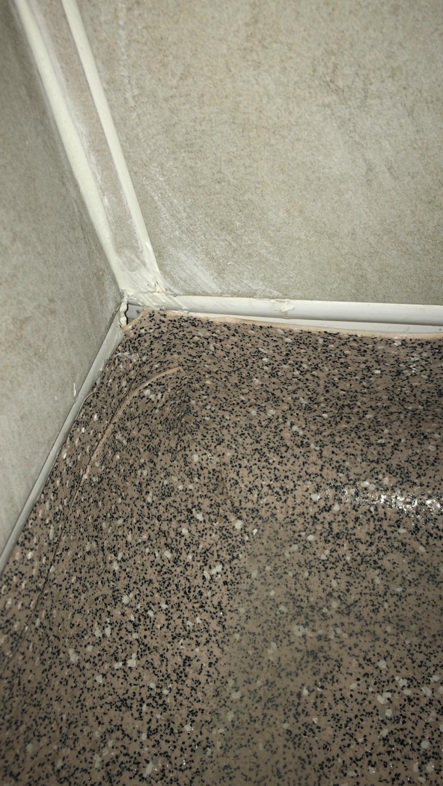

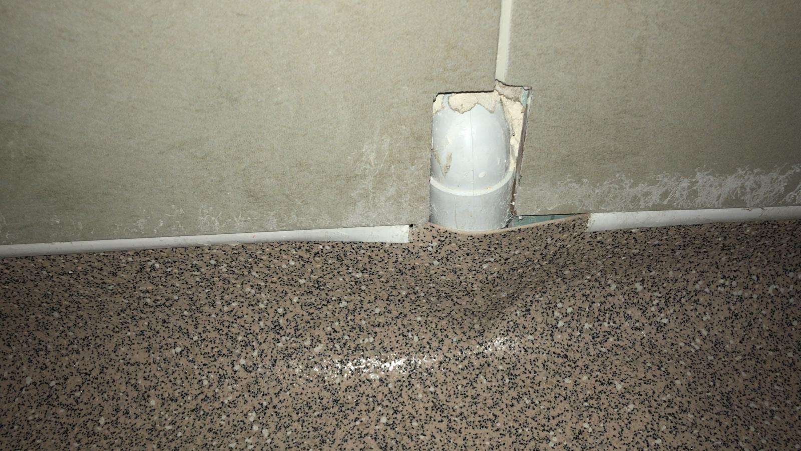

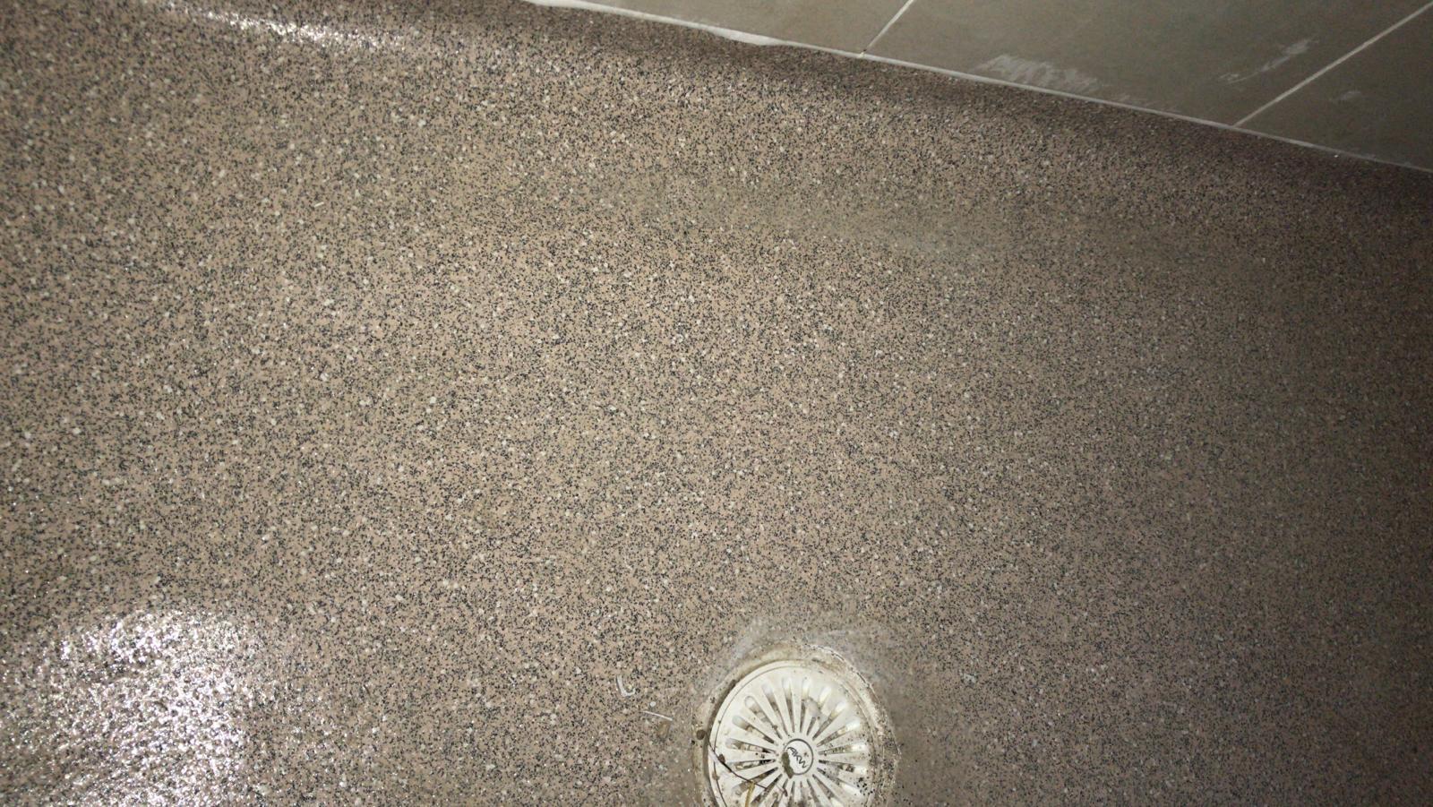

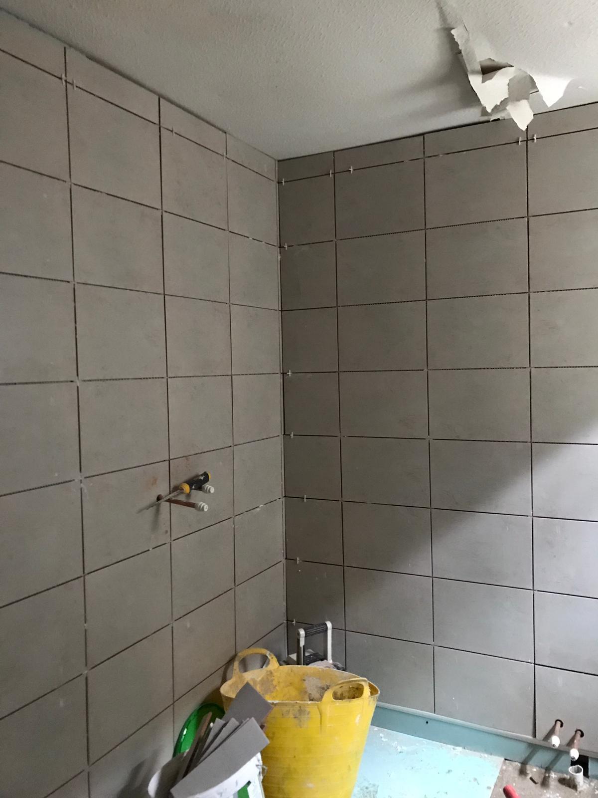

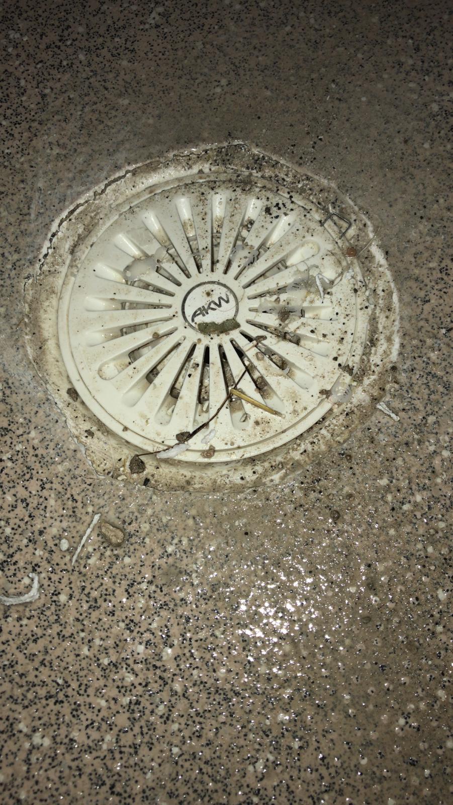

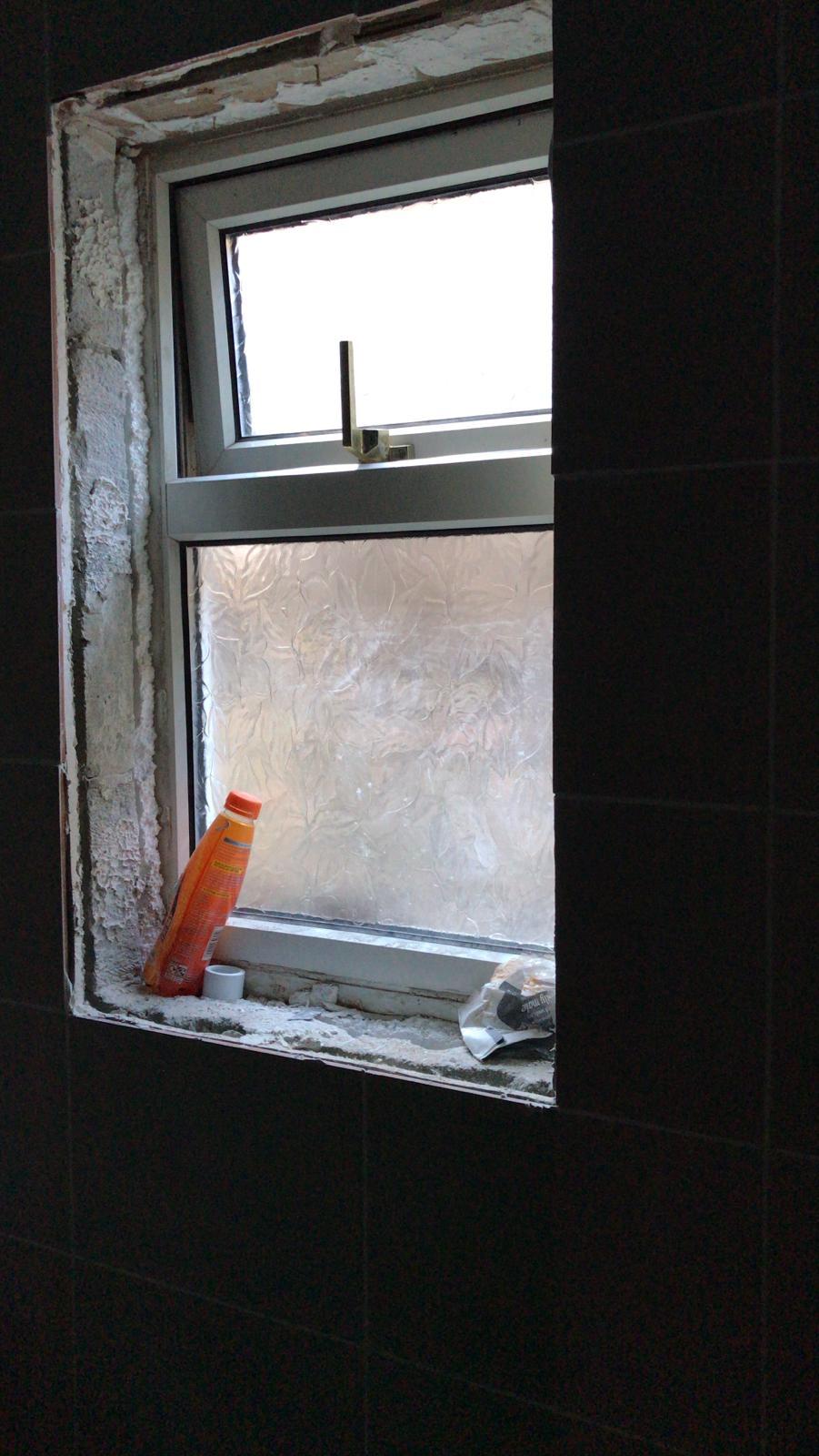

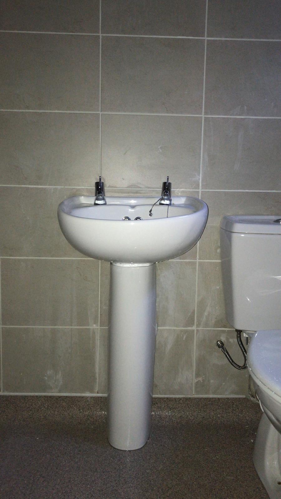

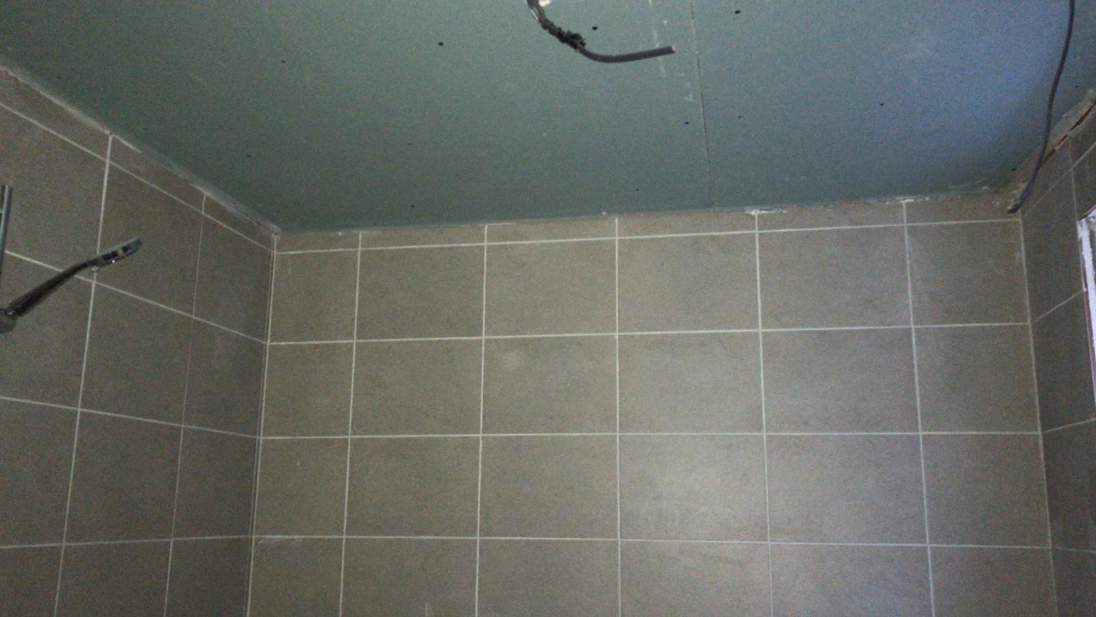

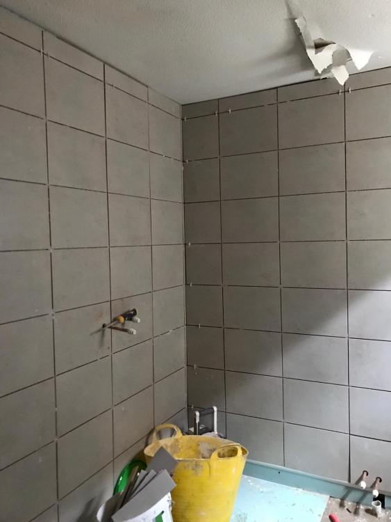

IMHO the quality of the work is awful.  This is being funded by a grant and is being done by contractors appointed by the local authority (child is long term foster), the property is owned by the foster carer. A full schedule of works was provided to the property owner but seems contractors have not read it.....the ceiling over boarding has been done once all wall tiling complete....plastering of ceiling now being done after 2nd fix, window reveals not boarded or tiled as yet but the rest of the room already grouted.  The non slip floor is rucked, it is not bonded to the wall and watertight, the drain is a mess, no extractor fitted....yet....sanitary ware fixed lop sided, shower valve not straight, odd pipe jutting out of wall at floor level, tiles and waterproof floor cut around it....hopefully pics show all this.
The plasterer is due to plaster ceiling tomorrow and contractors finishing off tomorrow too.  I have said do not allow any more work without boss coming out to look and also advise people paying the bill of the mess. It cant meet  building regs never mind be safe for the child not to mention the quality of the work could devalue the property.

Terrible. From what I can see the tiling looks to be the best thing.
The waste pipe behind the floor covering and the little sliver of flooring is bad bad bad - looks like the ceiling is not flat - for the sake of a ripped down batten the ceiling could have been over-boarded level, the tile pieces get bigger over towards the right and would do my head in. Plasterboard is a bit sparse on screws. Floor to tile mating is messy looking with little care for a good intersection of materials.
There is clearly a bad case of don'tgiveafeckitis here.
I am not sure how many trades were involved but really it looks like there was no schedule or it was compromised and ended up in the wrong order, plumbing/electrical first fix, then framing and boarding, possibly a bit more first fix to core for lighting and vents in ceiling, then paint the ceiling, then install vents and lighting then a careful program between flooring contractor and tiler to work out best way round depending on various details. Then plumber and electric second fix - then someone ought to take responsibility for pulling it all together making sure everything is neat and properly cleaned up.

It is quite poor. Nobody has done a decent job and it has not been managed properly. Not sure of the tanking design and junction detailing if this is supposed to be a wetroom. If they can't say I would take the tiling off.
When I have tiling done the tiler is responsible to clean grout and polish tiles.
I don't know how the floor drain works or if there is something else to go over it?  I imagine the stub of waste pipe is behind the sink? I would want flooring replaced but please do it after the ceiling is plastered and painted and the extract hole done.
Bodgetastic but it really did not need to be.
Guessing they've set the basin too high? Thought the pedestal was supposed to sit in a recess under the basin? Looks like the gap has been made up with silicone.

That stub of pipe is not under the basin its in the middle of the wet area wall.....the mind boggles! There were a lot more issues but I didn't want to bore with too many pics.

Imo they've even scrimped on the plasterboard screws. Should be about 150mm max spacing I think.
Guessing they didn't tank the walls and floor...
the middle of the waste comes out and the flooring goes into the trap then a cover plate is screwed over the top and sandwiches the flooring in place, they can be a bit tricky and you need someone fitting the flooring who isnt useless 9_9  https://www.google.com/search?q=akw+medicare+waste&rlz=1C1NHXL_en-gbGB781GB782&source=lnms&tbm=isch&sa=X&ved=0ahUKEwiy4a7ssMLiAhWQVxUIHV3RBooQ_AUIDygC&biw=1920&bih=937#imgrc=q5pD-fCJ-EThrM:
