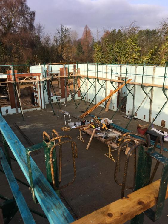

Stones Posted May 30, 2019 Share Posted May 30, 2019 On 28/05/2019 at 21:06, jamiehamy said: Agreed however were not talking about bursts, rather stability and safety during build and during pour. In short @scottishjohn is advocating building this type of icf without bracing, implying that experience makes this possible. Where we are we often get 30mph gusting 50mph winds when the wind comes from the east. Something to do with the warm air on the Moor gathering speed coming down the Glen. It happened on the day of our pour incidentally. It's careless and worrying to suggest something can be done a certain way without cautioning on the limitations, hence my question on windspeed. I'm confident that this particular product and many other icf products would not withstand a night of strong wind without either major damage or movement. That's not a criticism of any product either. And I'm certain that if it fell on you from the first storey just before pour, you'd get seriously injured. @AnonymousBosch will concur. Icf builders will weigh up the costs and risks when deciding on bracing. It didn't even enter my head to build our icf without bracing just to save a few hundred quid. As much if not more time was spent bracing our walls and the corners than actually building the blocks to wallplate. My contractor was very clear that attention here was critical to ensuring a successful pour. Have a look at my blog for more info and pictures. On 29/05/2019 at 09:23, Alexphd1 said: Regarding attaching ewi to eps icf have a look at @Stones blog, he mentions it there. I do indeed! Link to comment Share on other sites More sharing options...

ToughButterCup Posted September 5, 2020 Share Posted September 5, 2020 5 hours ago, Gus Potter said: ... Have you had a chance to finish it all off and look at it holistically, installing the services and so on. How future proof is it.. can you run an extra cable in the wall without major drama or are you a bit stuck on any alteration / extension you may want to make? ... Just to touch briefly on ICF bracing. ... Better to brace it to death and save the aggro. Yes, its (Durisol) easy to mess about with: our extension will (4 years from now) be easy - already planned, piles driven in anticipation, two years ago. Services to the extension are already in place. Bracing - its a faff. I've seen bracing as a simple Europallet, other bracing that was two layers of 22mm sandwiched between 2 lots of 4 by 4s , and proper professional steel bracing (on Durisol). And of course, the most common of all: none. We had seven blow-outs, 6 very small, quickly sorted - jam a shovel against it - screw a bit of timber aginst it - that sort of thing , and one that was caused by the combination of criminal damage and failure to brace. I am a bit annoyed with myself still - because I saw the guy hitting the blocks with a lump hammer - that I did not insist on bracing. Brace it to death as @Gus Potter says - and I would add, plan for what you are going to do with the bracing when its taken down. We are still re-using the 4 by 4s and sheets of ply. Overall, the bracing cost us nothing extra. We would have needed the 4 by 4 and the ply anyway. Link to comment Share on other sites More sharing options...
