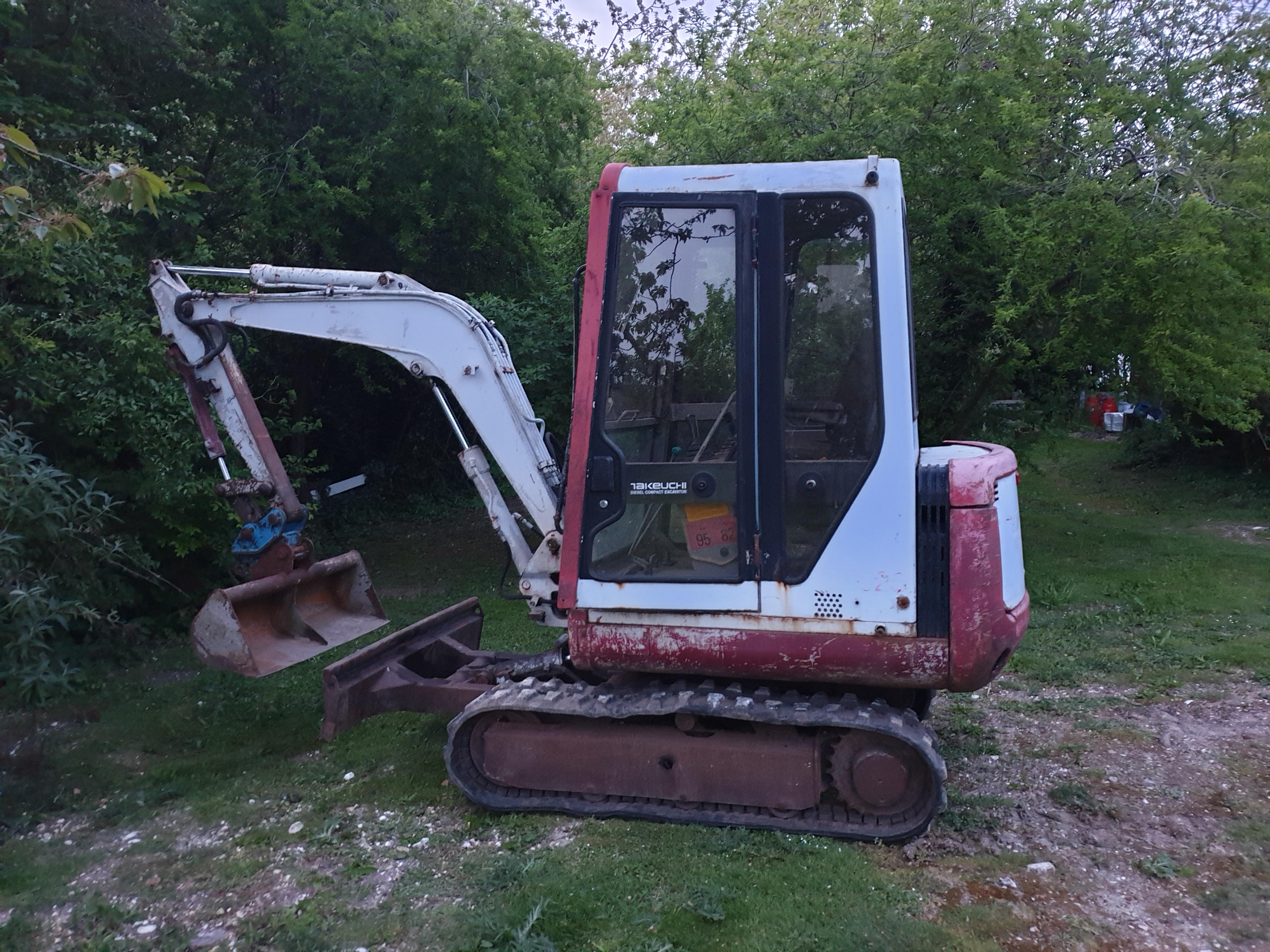

I'm going to hire a post hole auger attachment for my digger when I tackle some fencing at scale. Did I mention I'd bought a digger? Doesn't hurt to mention again, you know, just in case anyone missed it. There's so much that suddenly becomes doable with this thing, everyone should own one. And I'm having so much fun operating it that I may need plastic surgery to remove my smile.

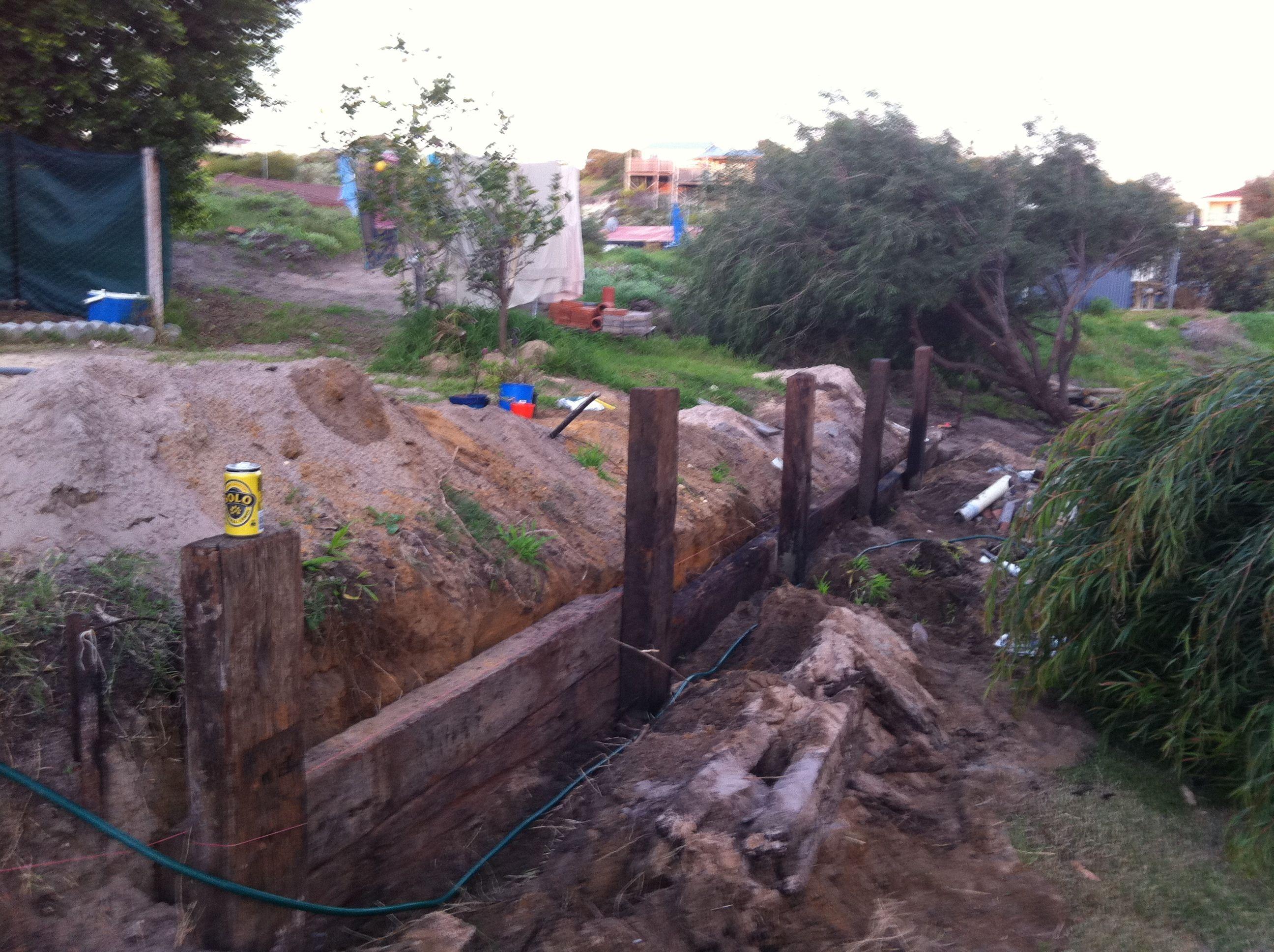

@Onoff that's an interesting pic.. I was veering twds PeterW's idea of the metal brackets fixed onto a set concrete block, going the walkway plan. But your pic of the retaining wall with sleepers, is the best idea I've seen re. the retaining wall plan.
How are those verticals fixed in & depth? my slope ground/ soil is pretty soft & squidgy tbh, hard ground the least thing to worry about.. does that mean I'd need to set the b'stards in deeper then? I guess capillary action sucks brook water up into bank, so could get wetter: things such as this to consider are prime reasons Ive been tentative & not jumped hammer & tongs you see, until I know a sure-as-dammit approach so it'll not shift badly, or even collapse.. that'll be an awful job to ruin lawn top, heave 3 tons of soil out/ up, to redo the pillars etc.

@Onoff can you run me thru the sleeper uprights, how these were anchored/ in your pic eg-

As for the sleepers...dig a hole, drop in sleeper. Maybe ram with pea shingle around the sides and bottom rather than concrete.
I'd STILL be digging a test hole to assess the ground.
