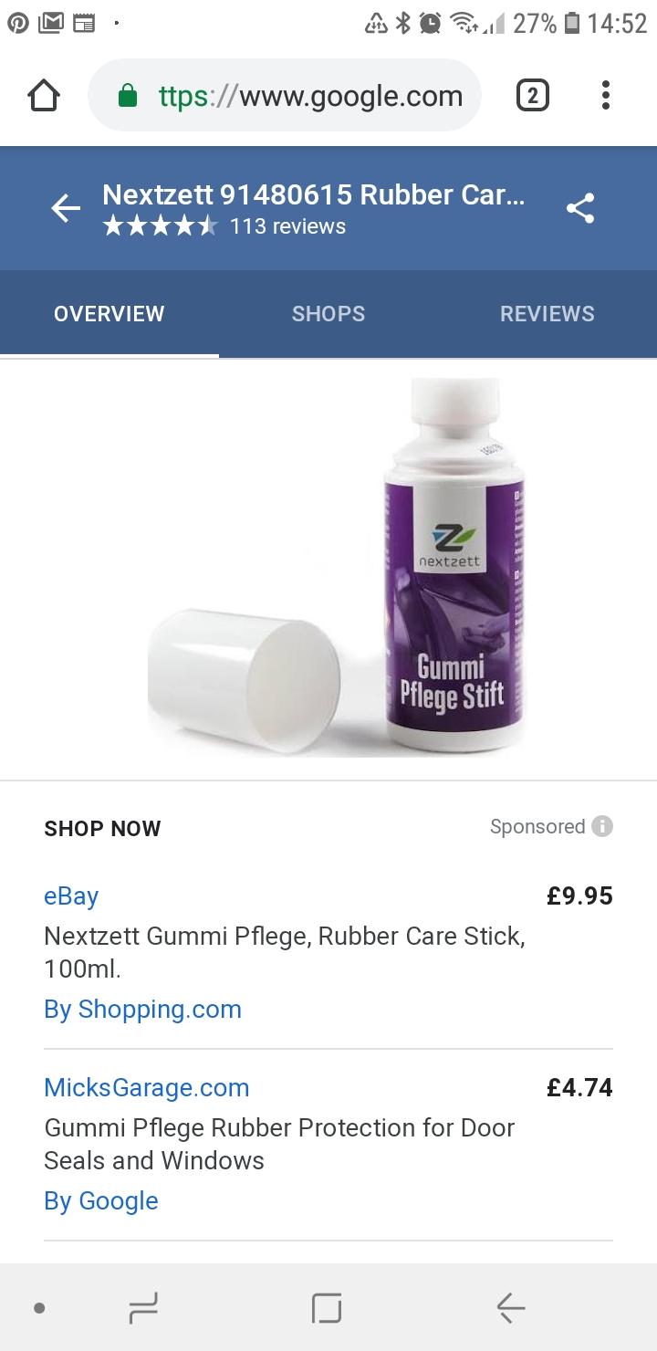

craig Posted May 14, 2019 Share Posted May 14, 2019 (edited) A good test is to get a piece of paper and put it between the sash of the window and the frame of the window. Close the window, if you can pull the paper out, then the seal is not hitting the frame hard enough and your going to get air leakage through there. You'll need to adjust the pressure of the sash against the frame if possible with the type of window. If you can't pull it out without a good bit of resistance or not at all, then it's a good seal. Handles with spindles are a weak point & key holes are a weak point, put some vaseline/silicon over the key hole. You can also put some lubricant over the seals on the windows and doors, it creates good contact and can be wiped off after the test but does no harm being left ? Edited May 14, 2019 by craig 1 Link to comment Share on other sites More sharing options...

Onoff Posted May 14, 2019 Share Posted May 14, 2019 44 minutes ago, craig said: You can also put some lubricant over the seals on the windows and doors, it creates good contact and can be wiped off after the test but does no harm being left I use this on car door rubbers. I wonder if it would help on window rubbers? Link to comment Share on other sites More sharing options...
